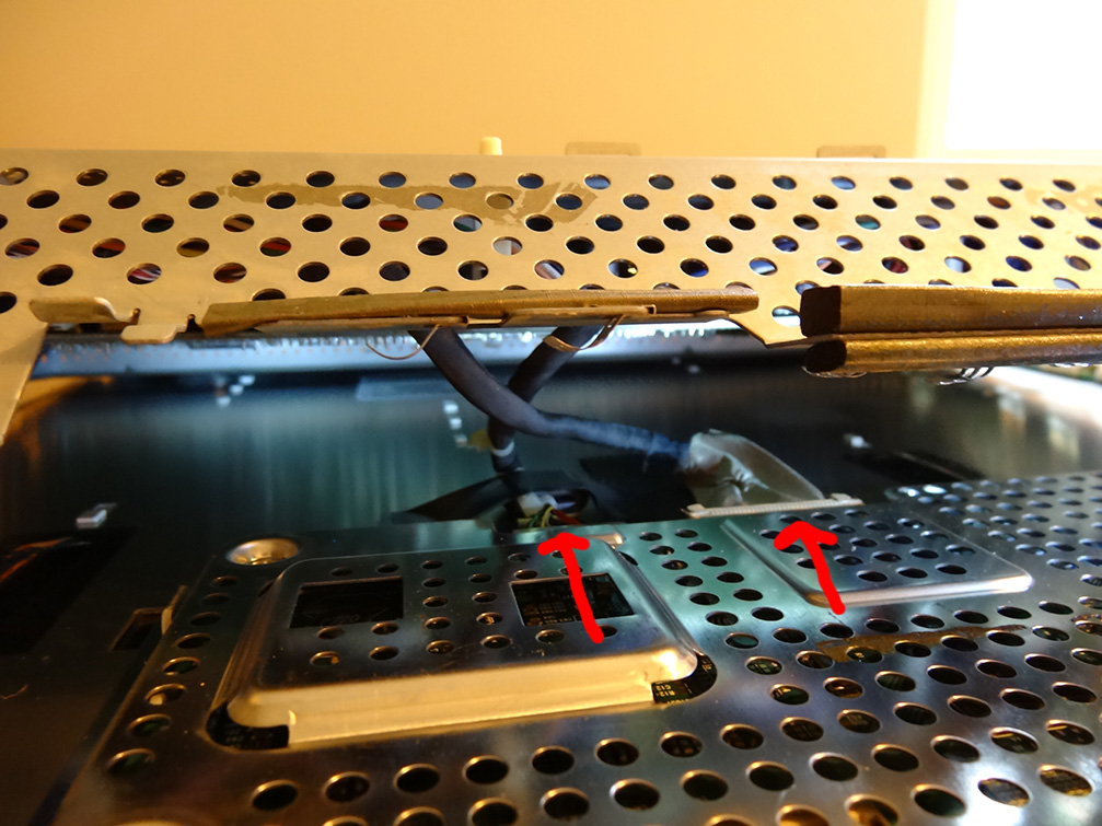

                                    • Lumberjack777
                                      • Dec 2010
                                      • 464
                                      #418
                                      Re: Dell 3008wfp faulty power supply
                                      If the original problem was no power, the chances are you didn't plug the LVDS cable and the one next to it in all the way.
                                      You'll need to open it up, and reattach those. The 2 in this picture. Also, check all connectors to and from the power board.
                                      • gorg
                                        • Jun 2014
                                        • 4
                                        • Greece
                                        #419
                                        I couldn't believe that was it! One of these 2 cables got partially unplugged while trying to put the back (holding the board and the psu) in place as the cables are rather short. It was from the other end (inside the monitors back). Regrettably I didn't take a photo while at it. Hint: check the pins of the sockets to make sure which way does the LVDS cable and its neighbour go (I had the monitor open for too long waiting for that extra PSU to arrive and couldn't remember the allignment).
                                        The monitor seems to work now.
                                        Thanks.
