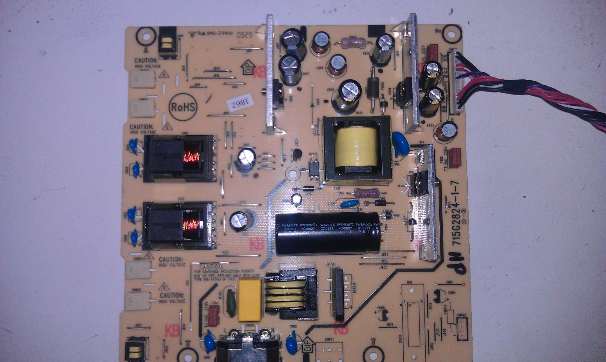

    23" HP FN747AA no Backlight (board# 715G2824-1-7)
    Ok so i have a 23" LCD TFT HP monitor, with a backlight problem. The backlight comes on for about a second, then goes off. It does this a second time about 45sec. to a minute later and then the screen goes into stby mode. The LCD panel itself works, as i can see images when i hold a flashlight up to the LCD. I have changed all the caps in the power circuit, even though none of them showed signs of being bad. I have tested power at the, large filter cap, and at the bridge rectifier, both test good. Im new to the LCD repair and can not seem to find the Power IC on this board to test, if someone could point it out that would be great! Also, i tested all 4 backlight ports with a know good backlight i use for testing. I have included a picture of the board and the model number sticker of the monitor. any sugestions on where to go from here would be very helpfull. thanks in advance for your help!
  • retiredcaps
    • Apr 2010
    • 9271
    Re: 23" HP FN747AA no Backlight (board# 715G2824-1-7)
    This sounds like "2 seconds to black" from your description.
    Possible causes are
    1) bad caps
    2) bad ccfl and/or wiring
    3) bad inverter transformer
    4) bad inverter sense circuitry
    Since you already replaced the caps and verified the ccfls are okay, that leaves 3 and 4.
    For 3, measure the resistance of the secondary inverter transformer pins for T601 and T602. Report the ohms readings. They should be within 3% of each other.

        OK so i tested the 2 pins on the primary side and both transformers tested at .46 on the 20k ohm setting. is this good? i will assume so since they both tested the same. what next?
        • retiredcaps
          • Apr 2010
          • 9271
          We are interested in the secondary side. Put your multimeter on 2000 (2k) ohms, if manual.
          edit: The secondary side are the ones "going into" the blue caps.

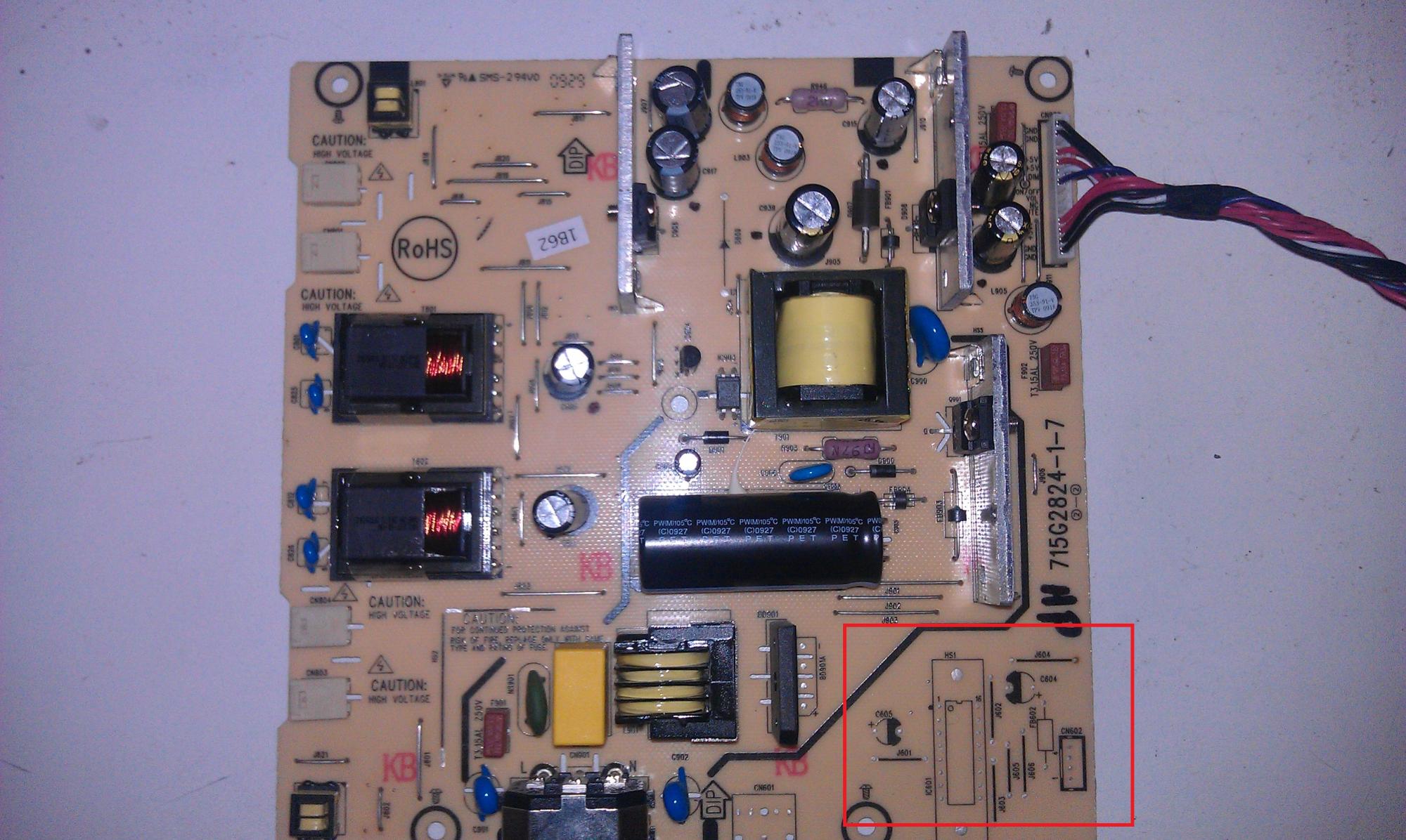

                    OK so i believe i found the power IC its the only IC on the board and i am reading ~85vDC from the VCC pin on the Power IC(pin at dot) to hot ground of large filter cap. i have read that this should be between 16-20vDC. have i found something or am i measuring wrong?
                    Posted a pic am i missing components in the red square? BTW this was one of those "white van" monitors......it came from a old co-worker of mine.....
                    • jsog
                      • Feb 2011
                      • 220
                      What IC are you looking at? There might be surface-mount chips on the bottom of the board.
                      That red-outlined section appears to be for an optional audio amp circuitry. CN601 would be the headphone jack.

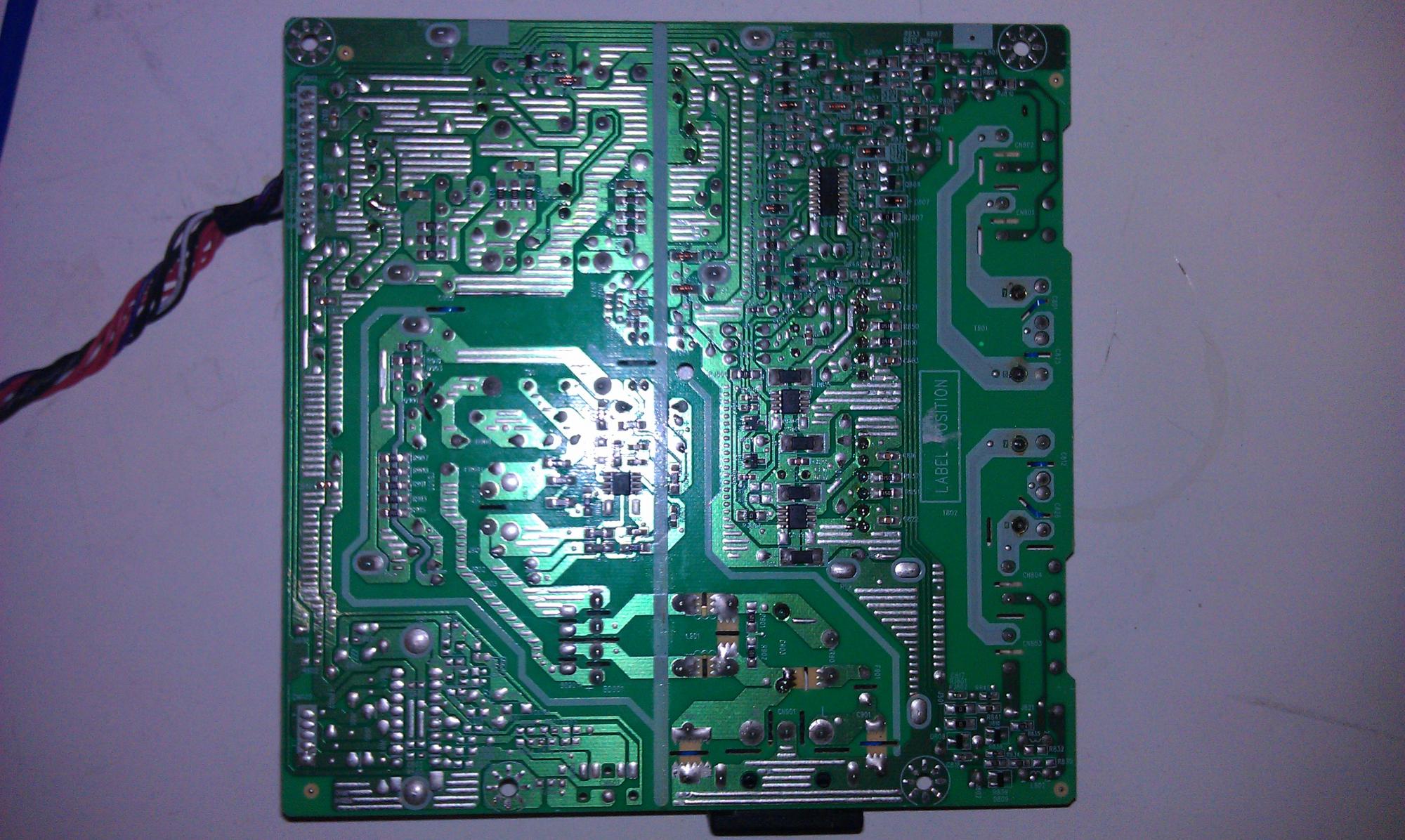

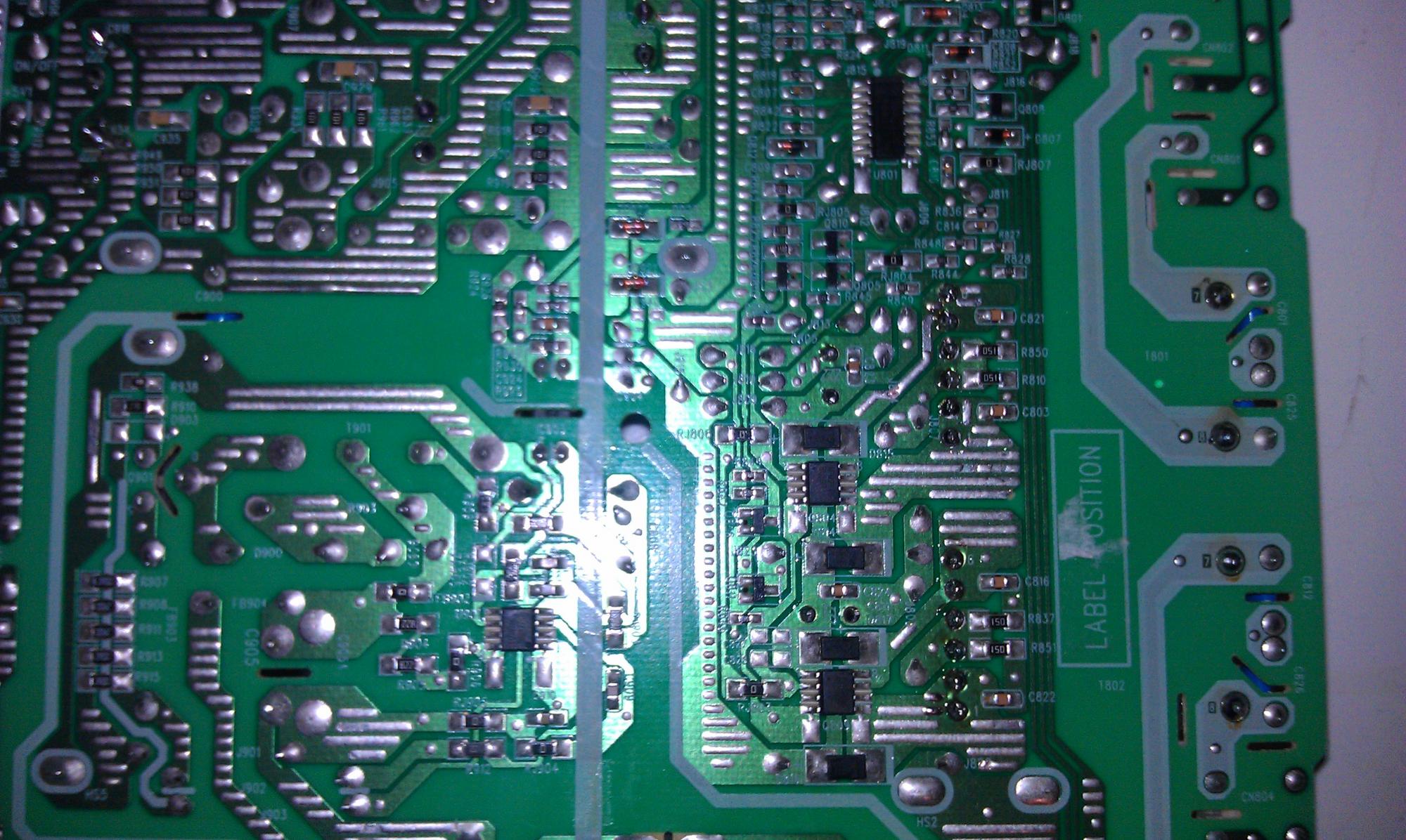

                        i did not even think of looking on the bottom of the board.....here are two pictures of the bottom of the board. i believe the IC on the left is my power IC as it is under the large filter cap.....Is this correct?
                        • Rtech
                          • Jul 2010
                          • 1095
                          Thats would seem to be it, but as you have LED, and can see images, then it it should be fine, try to find the datasheet if you really want to look closer at it. Have you meaured to output of the Schottky diode, providing the inverter voltage ?
