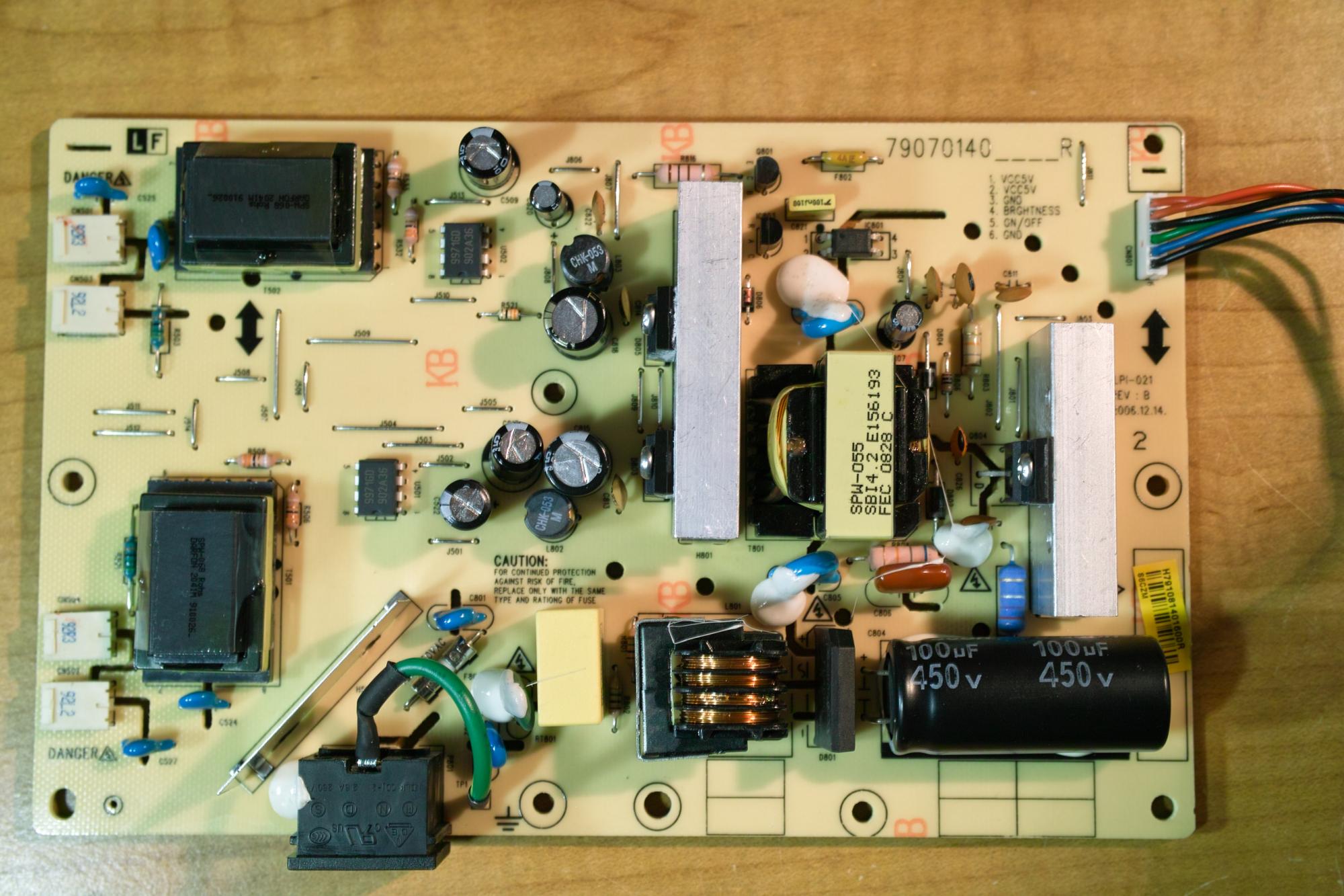

    Hello, I'm trying to repair a monitor for a friend and I'm hoping someone here can point me in the right direction. Here are the symptoms: The backlight will only stay on for 4-5 minutes before going out. Once the lamps turn off, I can get them to turn back on if I power cycle the monitor - but the lamps wont stay on as long as they did from a cold start. Normally just a few seconds after first failure. Also, before the lamps go out the screen will start to flicker. So far I have replaced all the capacitors on the inverter board except two: the 450v 100uF, and a 35v 150uF Lelon. None of the caps were blown or looked even slightly bloated before I replaced them.
    I don't know much about electronics, but it seems to me like something is overheating (mosfets?). However, I see no discoloration on the board. The model number is: ILPI-021 - I will post pictures later this evening.

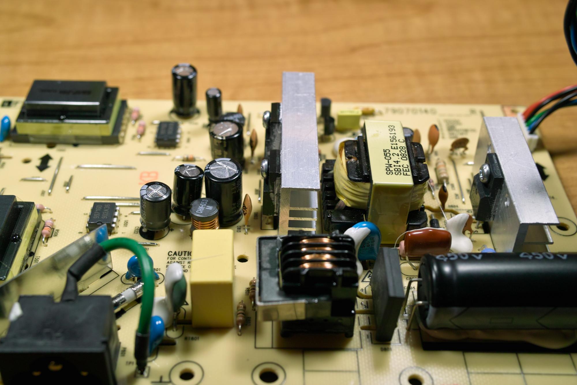

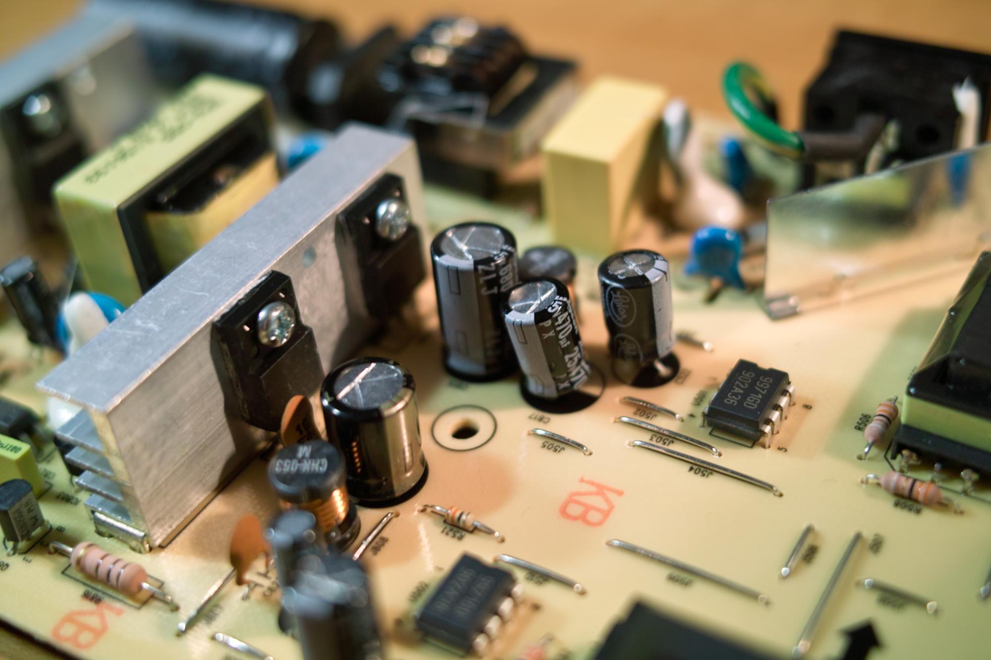

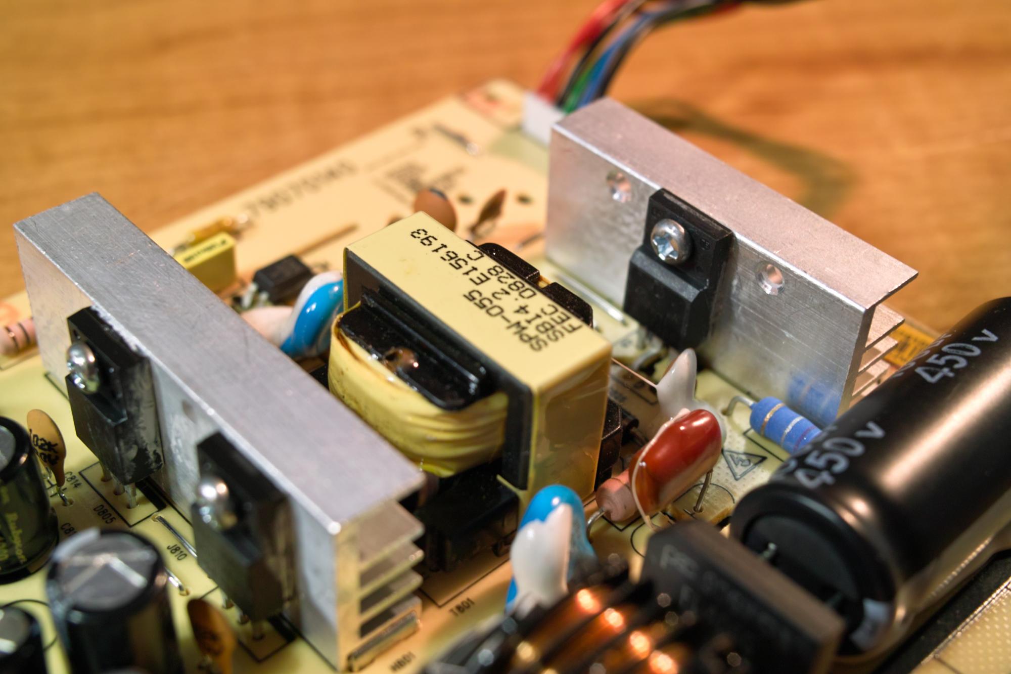

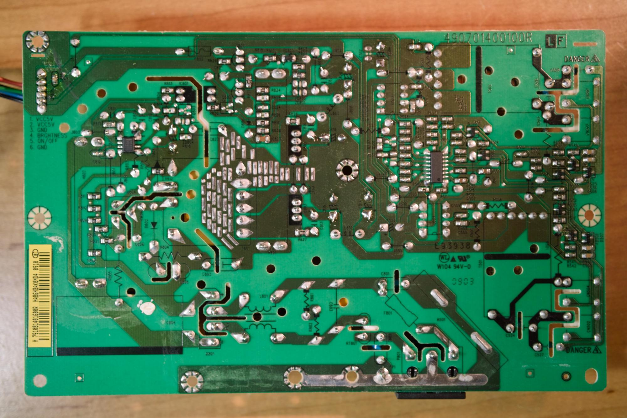

            I hope these pictures are to your liking. Let me know if you need close-ups of a component.
            Thank you.
              Re: eMachine 19" HDMonitor LE1987
              Are you sure you have a LED monitor, the connectors look the same as a LCD type.
              The only reason I ask is there is another LED monitor being worked on in the forum, I can't tell for sure but it looks like that monitor is using a ribbon cable for the Lamps.
              I haven't had the opportunity to look inside a LED monitor so I am just wondering
              Whatever I do, I consider it a success, if in the end I am breathing, seeing, feeling and hearing!
                I agree with alexanna. It looks like a ccfl power board complete with the inverter transformers and 4 ccfl outputs.
                Also looks like you used general purpose caps instead of low-esr caps.
                Could be a bad solder joint. Try checking for a thermal problem by taking a hair dryer and heating up parts of the board to see if you can accelerate the shutdown process. Hopefully, you can isolate an area and we can go from there.

                  Looks like a ccfl setup as jetadm123 and alexanna mentioned.
                  We have only seen 1 LED power/inverter board here.
