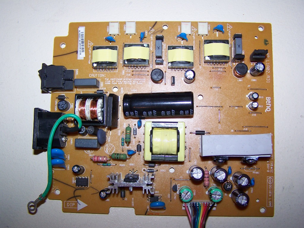

                            Thanks For The Info. I Opened You Attachment And Notice You Board Is Slightly Different To My Board But The Basic Pricipal And Layout Is The Same. I Find The Picture Quality And Overall Screen On The L1955 Is Better Than The Samsung 203b I Bought. I Have Attached A Pic Of My Board For You To See. I Am Of To Our Local Supply Store To See What Parts They Got!!!

                              From your picture this board has been repaired before. The inverter to the right has mismatched transistors, not a good idea at all (replace in pairs). Best to get 2SC5707 parts from eBay. Also the original MOSFET on the same inverter has also been replaced was originally like the one at centre of board (for the other inverter). This MOSFET change should not matter if well chosen. Have you measured and found any short circuited transistors? This is likely in the right inverter.

                                It seems that they eliminated one of the heatsinks that my monitor had with the two rectifiers on it.
                                On the original board they probably wired lower value parts together to get a higher value on your board they probably used higher value parts thus eliminating the extra rectifiers and the extra heatsink.
                                I guess the bean counters found a way to save a few cents.
                                Davmax you beat me to it I was thinking that transistor isn't right .
                                Measure the 4 output transistors they are right above and below those gray capacitors. On my board they convienently labeled collector, base, and emitter for me.
                                Set your meter to Diode Check and measure from base to collector if you get nothing one way reverse the probes. Do the same from base to emitter you will probably measure a short on one of them (0.00).
                                Due to the way they are wired it may seem that two are blown when testing in circuit so once you find the set that shows a short remove them both and test them out of circuit.
                                To be safe its best to replace both in the set its even better to replace all four.
                                Also as Davmax said replace any of the substitutes with genuine Sanyo C5707s.
                                They can be purchased off E-bay cheaply.
                                http://cgi.ebay.com/2SC5707-C5707-Tr...QQcmdZViewItem
                                One guy who posted in the Benq thread installed counterfeit components on his board they got really hot and didn't work.
                                Installing a substitute without careful consideration on these monitors can cause them to not work or fail prematurely.
