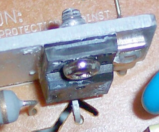

            is it my imagination, or does that mosfet in the center there look a little burned?
            • Scenic
              o.O
              • Sep 2007
              • 2642
              Re: Cap Testing
              looks more like heatsink compound all over the place..
              • Uranium-235
                Comrade Glimmer
                • Aug 2007
                • 5042
                • US
                Re: Cap Testing
                kinda dark spot on the left side? dosen't look like compound

                  Still waiting on the caps to come in. That photo isn't a picture of my actual board but the same board with identical layout.
