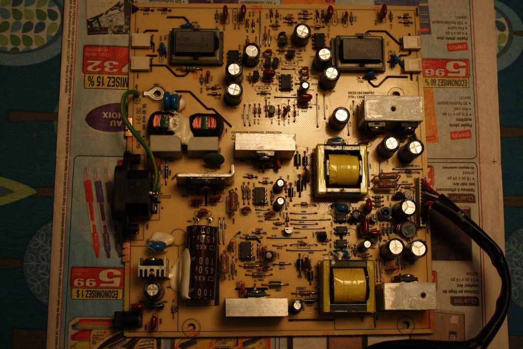

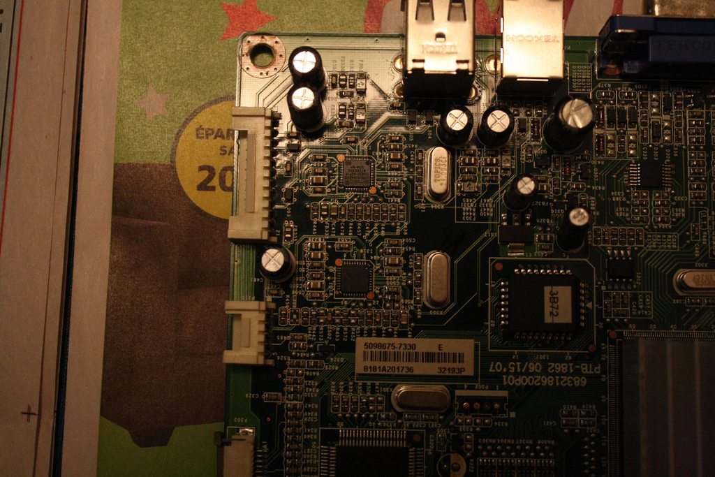

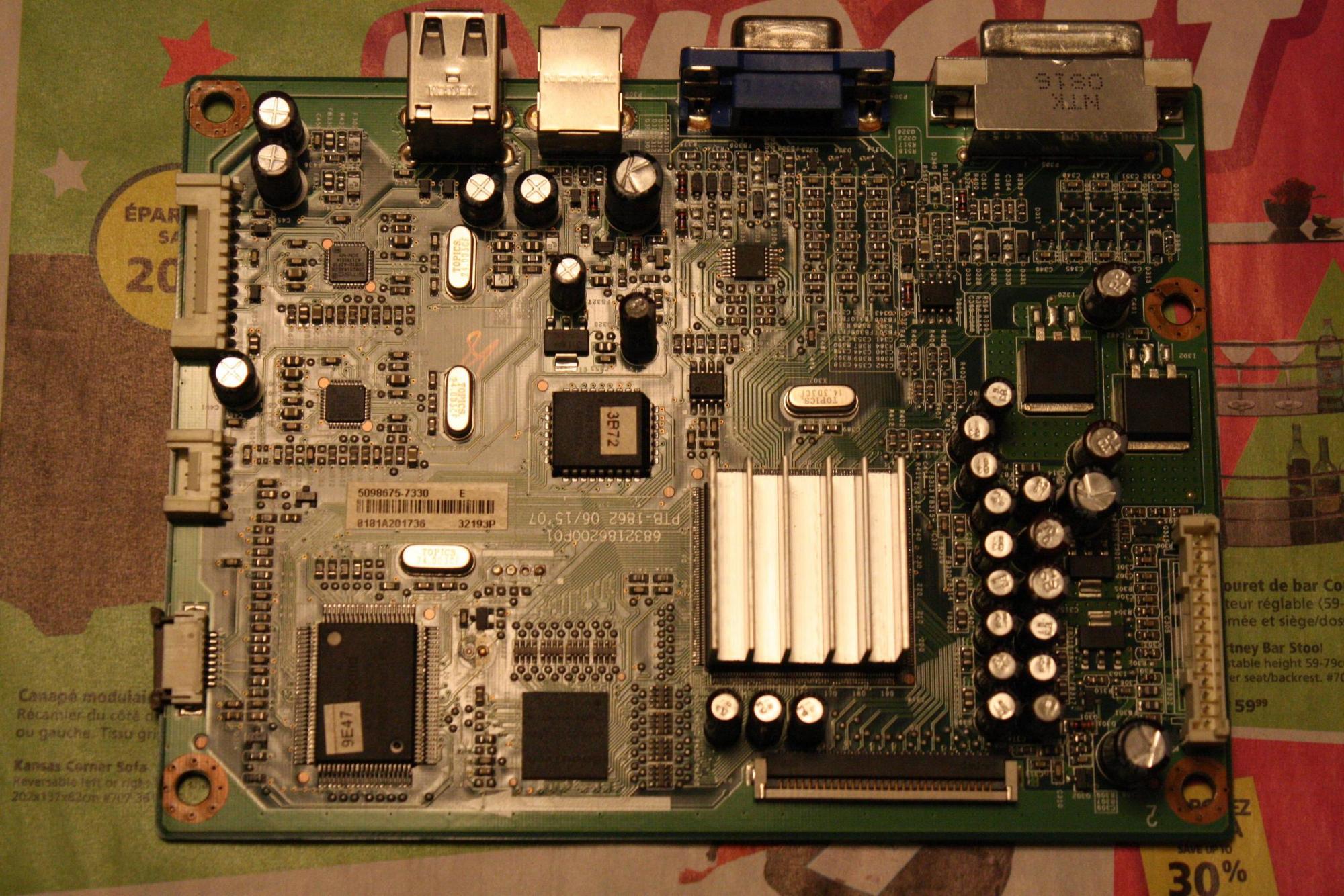

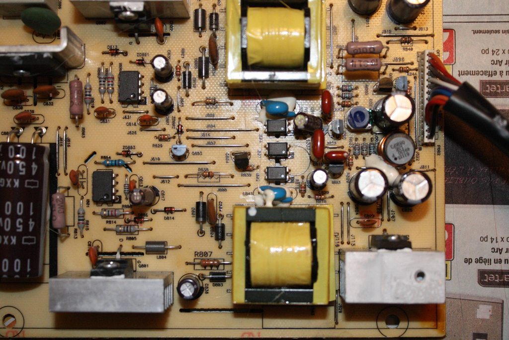

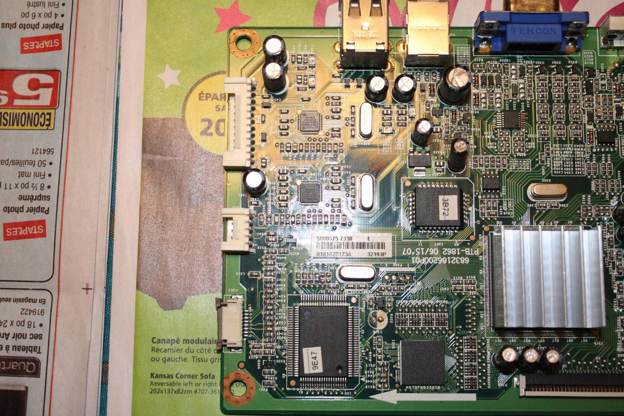

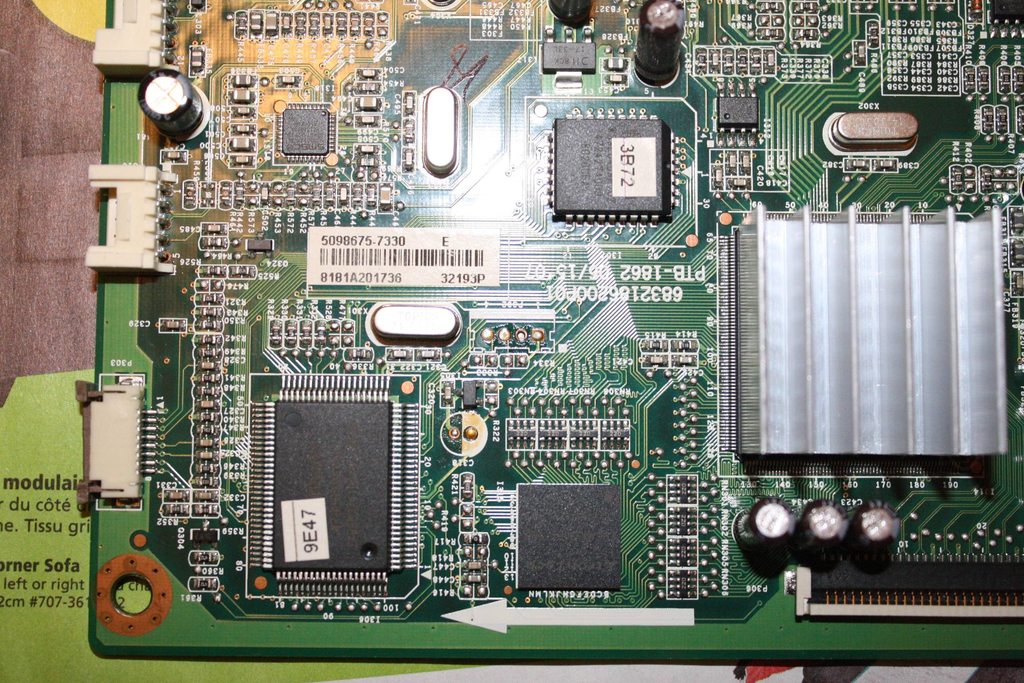

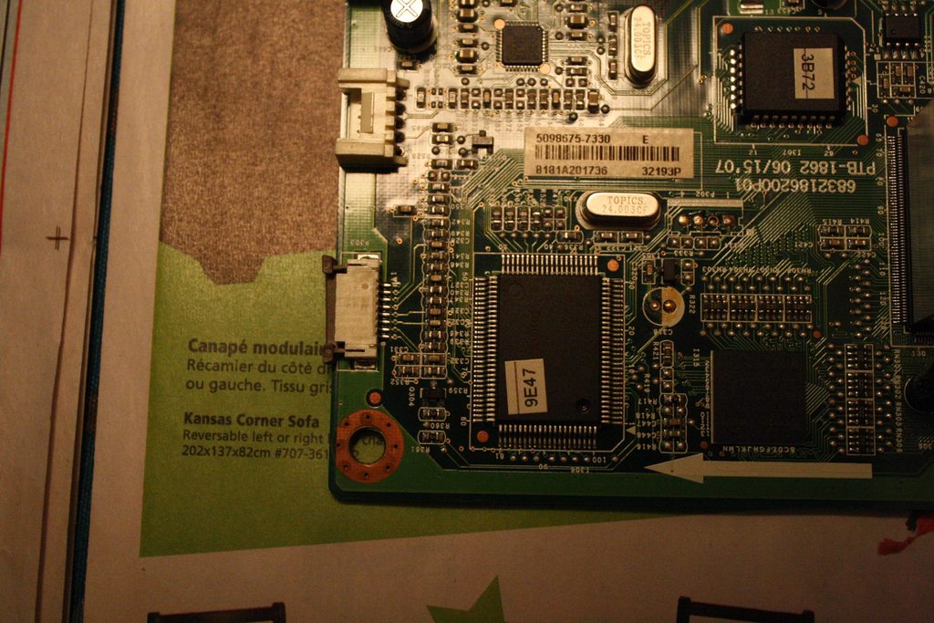

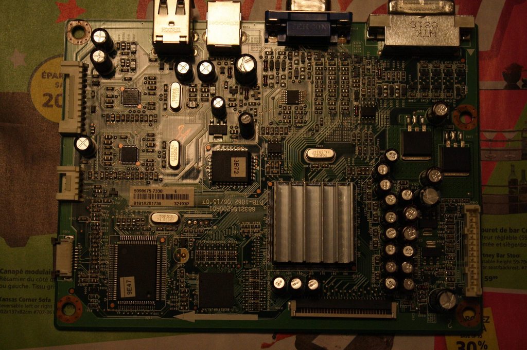

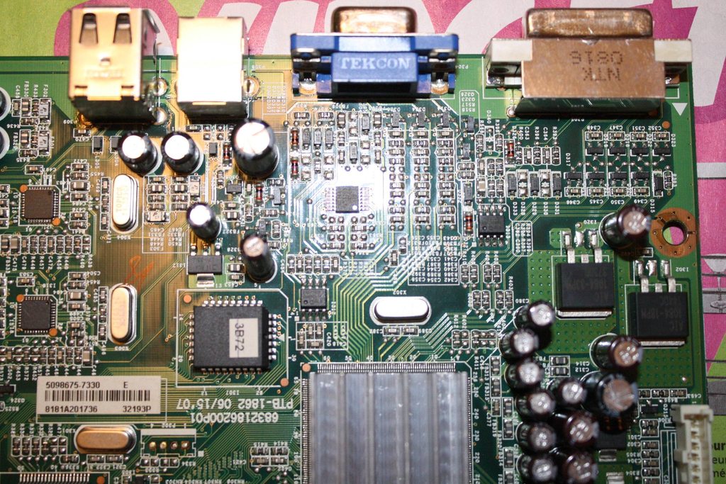

    I have a used Dell SP2008WFPt 20 inches monitor with USB hub and webcam that doesn't work anymore.
    When I plug it in, the power button light blinks blue, but pressing it doesn't do anything.

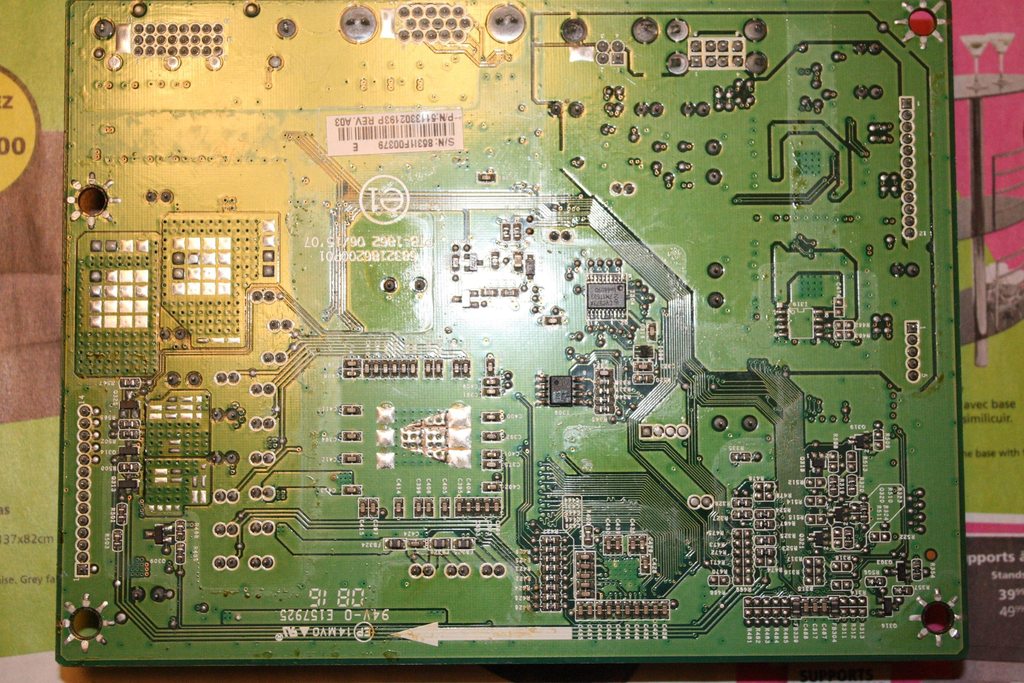

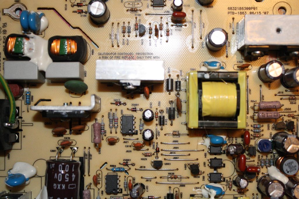

    I disassembled it and took pictures of the two boards. I tested the power supply board (yellow-ish one) with my multimeter and the +5V points do indeed output 5 volts when the power cable is plugged in.
    On the other board, I haven't tested the points because I don't know what any of it does. I did look at all the capacitors and they all seem fine to me.
    Tools I have access to: soldering iron, digital multimeter
    I've attached a few pictures. If they are unclear or if close shots of particular areas are required, I can add some more. I do have access to a flatbed scanner, but since there are some fairly high components, I don't think the picture would be any good.
    I uploaded the full resolution pictures on imgur: http://imgur.com/a/CUTze

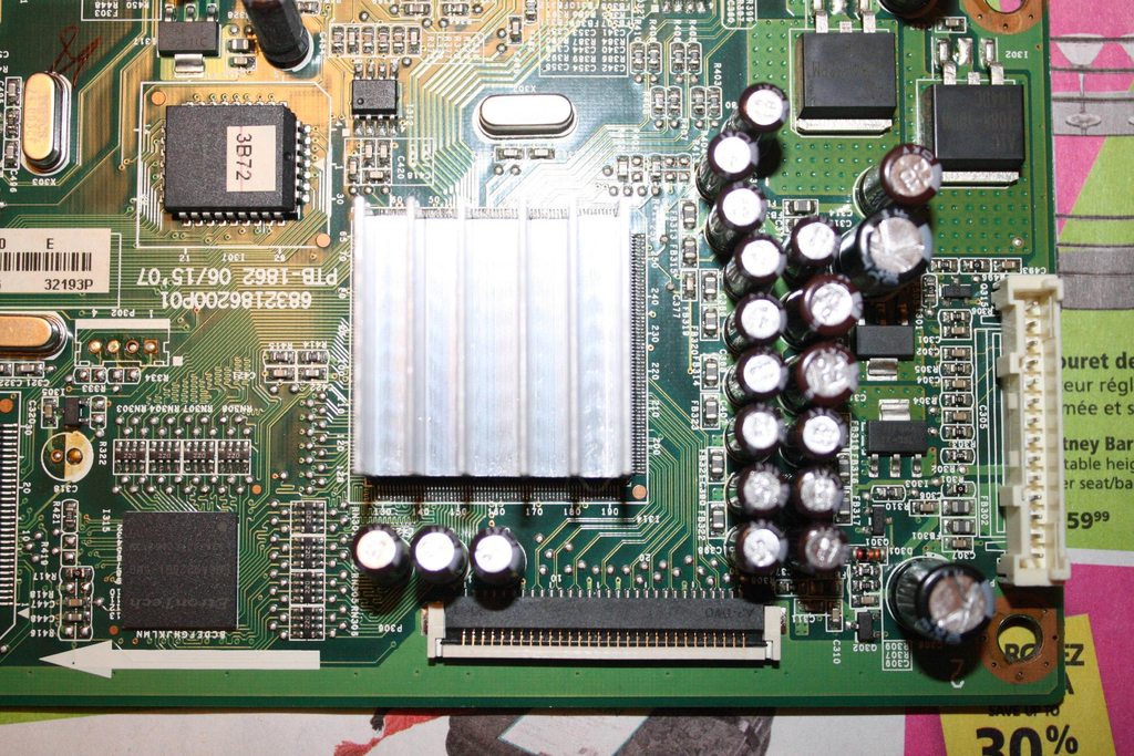

      Re: Dell SP2008WFPt no picture

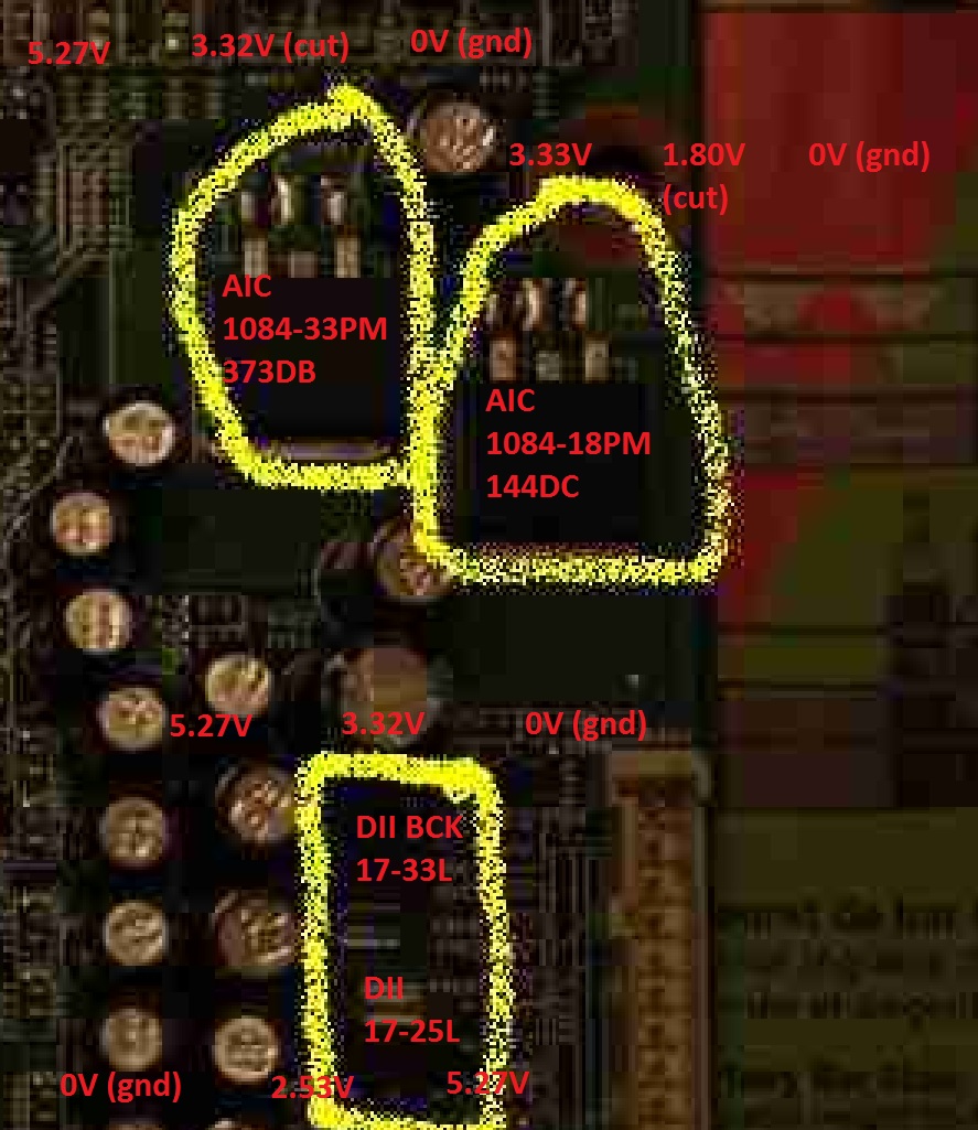

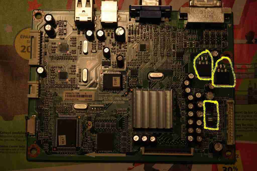

      There are voltage regulators on the logic board. I have circled them in yellow.
      Use a ground screw on the logic board for the black probe. Put your multimeter on 20V DC (if manual).
      1) What are the part numbers of each regulator?
      2) What is the DC voltage of each pin?

      • jetadm123
        • 2169

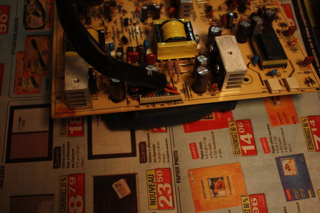

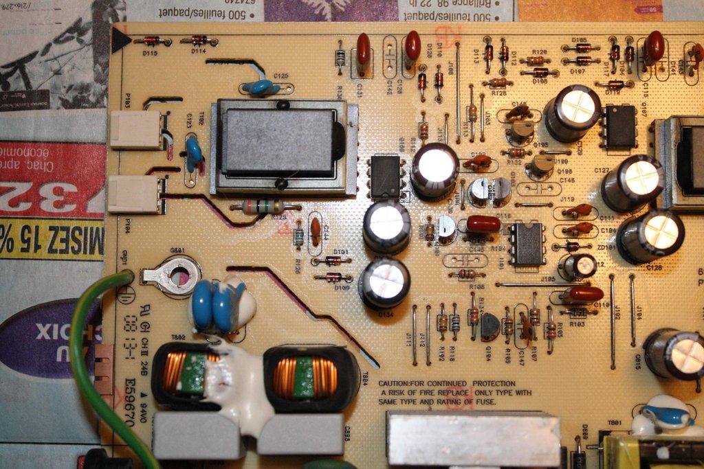

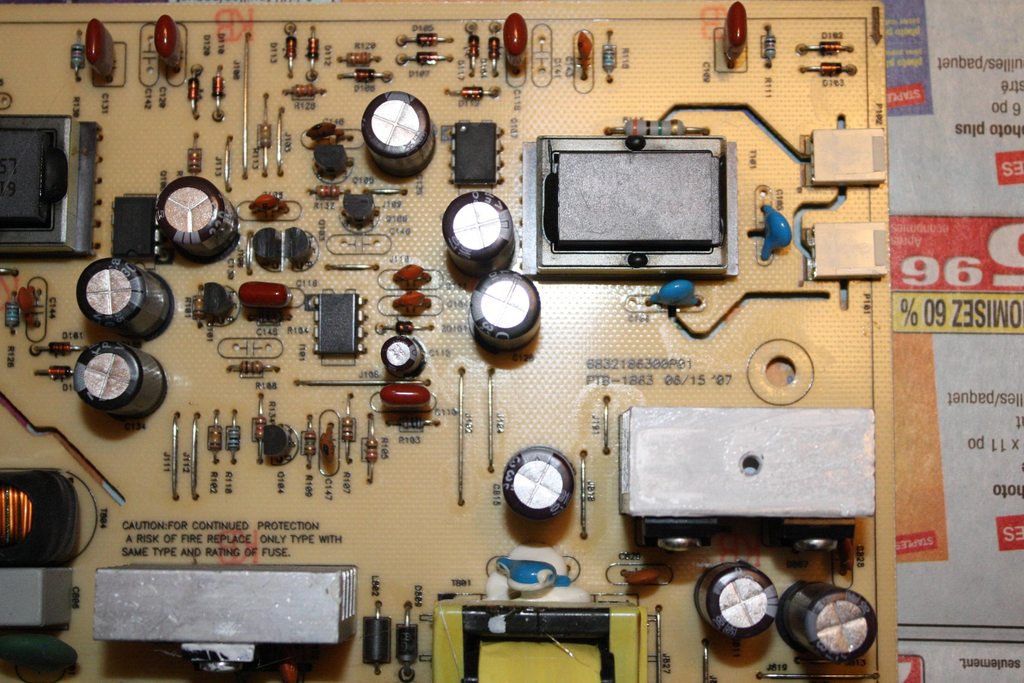

        Is there a legend silk screened next to the wiring harness on the power board identifying voltages, ena, on/off, etc?
        • kynax
          • Sep 2010
          • 33
          Yes, you can see it in the 6th picture. If you check the imgur files, the resolution is high enough to see it.
          The picture is upside-down, but the order is:
          OFF | BRI | ON-OFF | A-EN | A-DET | GND (4) | +5V- RTN | 5V (4)
          I already checked that the 4 5V pins do have 5V compared to the 4 GND pins.
              Here are the readings I get:

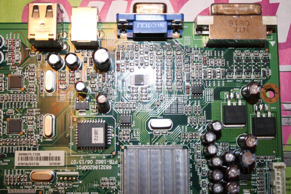

                Those readings look good.
                I missed one voltage regulator. Report and measure I317 (just above chip labeled 3B72).
                For the future, one good clear focused picture top down view of each board is sufficient. Having the logic board chopped up in 4 quadrants is difficult to view.

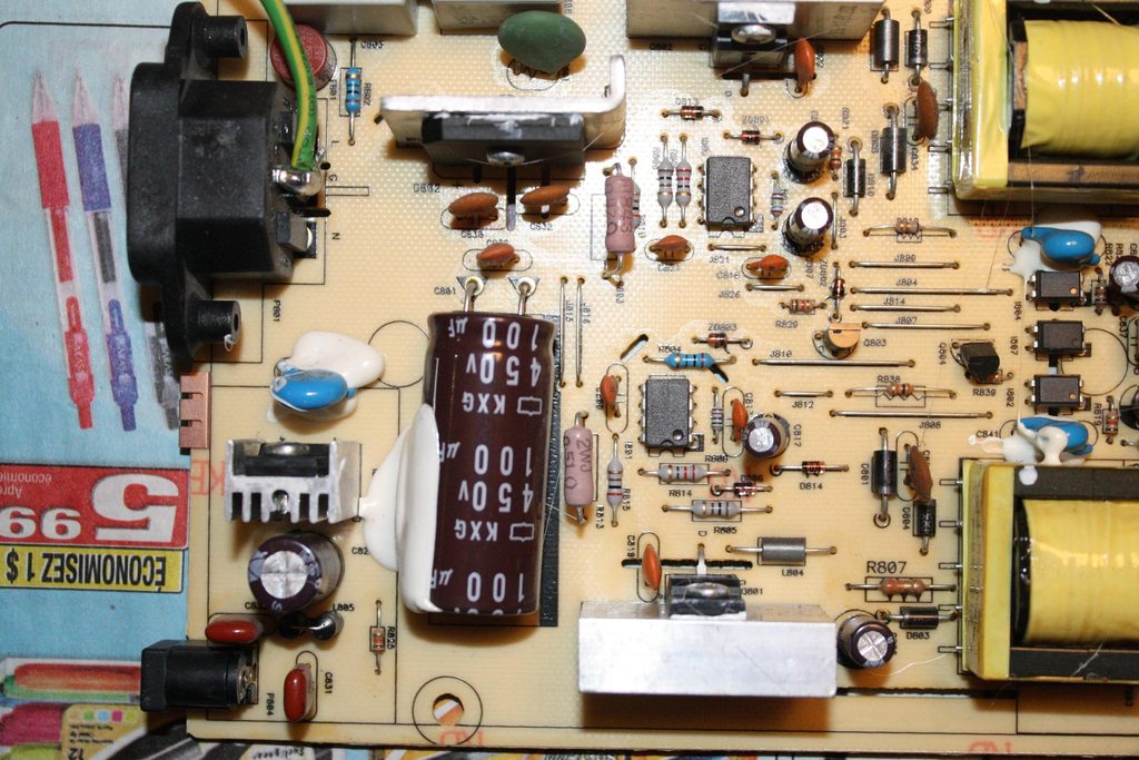

                • jetadm123
                  • 2169
                  Many members here avoid (myself included) photos posted on external sites for fear of catching a virus on their computer.
                  Can you please measure the voltages of BRI,ON-OFF,A-EN and A-DET?
                  Also, it looks like you missed a voltage reg (circled in yellow). Measure and report the voltages and part number. There seems to be a number of fuses (circled in red). Check them for continuity. Check around the board for additional fuses. They are generally marked FXXX (XXX=number).
                  • kynax
                    • Sep 2010
                    • 33
                    I don't get anything on any of the pins.
                    It's a 17-33L like the other one.

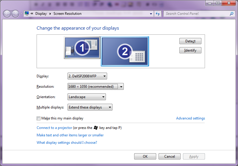

                    One thing I did notice with the VGA cable plugged into my laptop is that Windows does recognize the monitor:
                    • kynax
                      • Sep 2010
                      • 33
                      BRI: oscillates between 0 and 2.7V every 0.5 seconds
                      ON-OFF: 0.12V
                      A-EN: 0.12V
                      A-DET: 0V
                      • jetadm123
                        • 2169
                        ON-OFF: 0.12V
                        A-EN: 0.12V
                        A-DET: 0V
                        What about the fuses I asked you to check?
                        • kynax
                          • Sep 2010
                          • 33
                          I tested all I could find (over 15) and they all worked fine (continuity).
                          • retiredcaps
                            • Apr 2010
                            • 9271
                            Assuming the fuses around that component are all working, then this voltage regulator is bad. You should get some DC voltage readings on the pins.

                              • kynax
                                • Sep 2010
                                • 33
                                Is this a component that fails fairly often? As in, is there a good chance that this is the problem?
                                I'm pretty sure I can buy a replacement locally and change it.

                                  • retiredcaps
                                    • Apr 2010
                                    • 9271
                                    Voltage regulators do fail. How often? I don't know.
                                    You can look for replacements on junk boards and reuse the old ones.
                                    PS. You should retest it one more time.

                                      • kynax
                                        • Sep 2010
                                        • 33
                                        That's also what I though.
                                        I still get 0V on all pins.
                                        I compared with the other regulator and that one is still working.
                                        EDIT: Is is possible that this regulator is there for the USB hub, in which nothing is plugged right now, explaining the lack of voltage in there?
