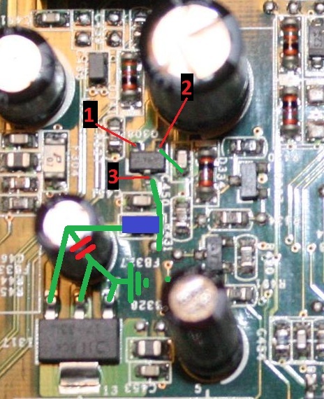

        Did some more investigating.
        See attached picture.
        Point 1 has 5.27V, point 2 has 5.07V, point 3 has 0V.
        Point 3 then goes to a fuse (blue box) and to a test point.
        It then goes into a capacitor and into the input of the big regulator.
        The output of the regulator is connected to the other side of the capacitor and to the ground.
        The small box on top (with point 1, 2 and 3) is too small for me to read the text on top, but is labelled Q308 on the board.

          I would like to make a suggestion.
          It would be a good idea to verify you have a ground on the regulator. What voltage reading do you get with the red lead on pin 1 and the black lead on pin 3?
            Those pins are in reference to my picture above right?
            I get 5.23V between pin 1 and pin 3 (the configuration you asked for) and 5.04V between pin 2 and pin 3.

                I don't get anything (0V), which doesn't suprise me since the input pin doesn't show anything when tested with the ground.

                        #31
                        Re: Dell SP2008WFPt no picture
                        The rightmost pin is indeed connected to ground.
                        The leftmost has 1200 ohms of resistance with pin 3, but that might be through a charged capacitor somewhere else since it starts low and goes up in about 2 seconds.

                          FYI- the "F" and "FB" designators mean two different things: The "F" designates a fuse as mentioned earlier. "FB" designates a Ferrite Bead, which is not a fuse, but a bead of ferrite over a piece of wire.
                          As for Q308, it's some type of transistor. Since you can't read the part number, I'll take a WAG and using your numbering scheme for the legs and with power off, try measuring for shorts across legs 1-3, 2-3 and 1-2.
                            1-3 427 ohms
                            2-3 infinite ohms
                            1-2 infinite ohms
                            I'm pretty sure some of these combinations charge a capacitor since 1-3 will sometimes show infinite resistance right after testing another combination. Does that make sense?
                              I looked at your photo a little more closely. From your drawing you stated that the the output of the regulator is connected to one side of the capacitor and to ground. How can the output be connected to ground?
                              It would make more sense if the output of the reg is connected to the "+" side of the cap and the ground leg of the reg is connected to ground, but not connected to the output leg of the reg.
