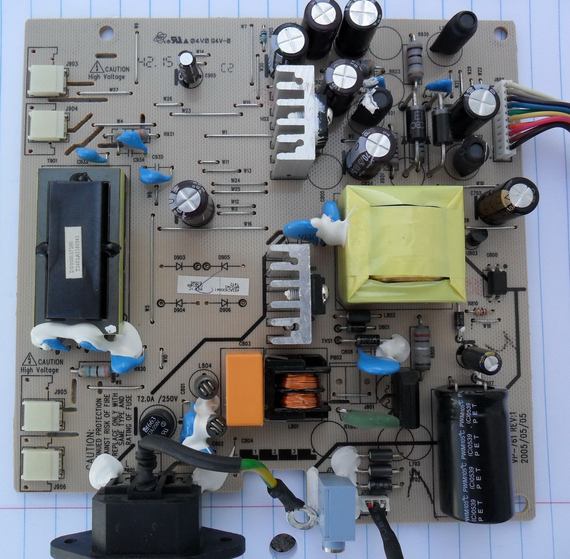

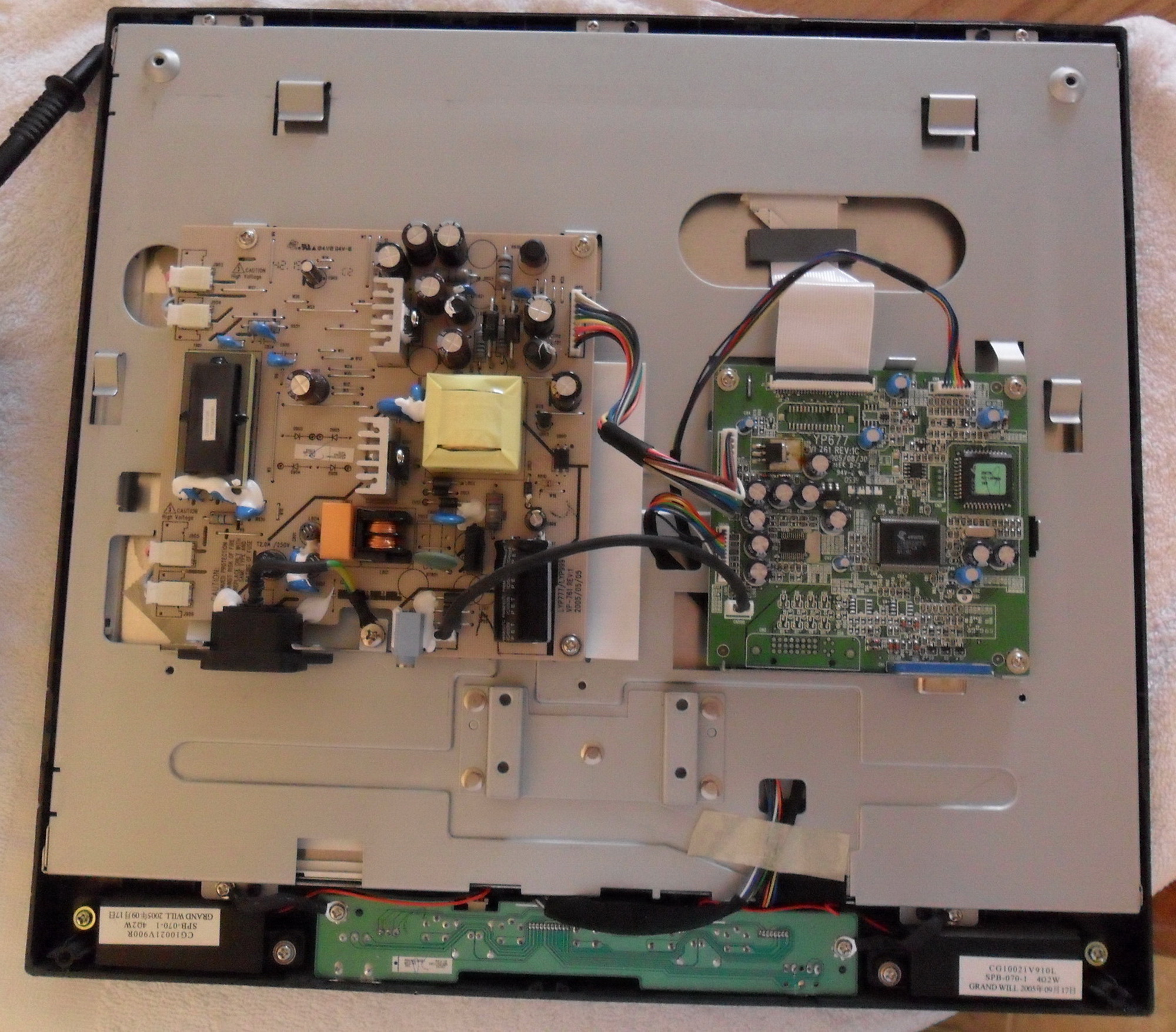

    I picked up this monitor for free. When it's plugged in the power light comes on and that's it, the power button doesn't turn it off (have to unplug). I don't get a flash from the backlights and there is no image even with a flashlight. I replaced all the caps on the power/inverter board, checked the fuse its ok.
    Voltages from power board, there is nothing on the board that say what they're for.
    Pin 1 – 10, looking at picture 10 is the top
    1 – 5.15
    2 – 0
    3 – 0
    4 – 0
    5 – 0.3
    6 – 0
    7 – 0.07
    8 – 5.14
    9 – 5.14
    10 – 5.14
    Should there 12V somewhere?
    Also checked the voltage regulators on the logic card
    U10 pin 1 – 5.13, pin 2 – 3.29, pin 3 – 0
    U11 pin 1 – 3.8, pin 2 – 1.8, pin 3 – 0
    I even checked the power button, it has 3.53v to it and when I push it, it goes to 0
    I don't know what to check next, looks to me like the problem is somewhere on the logic card?

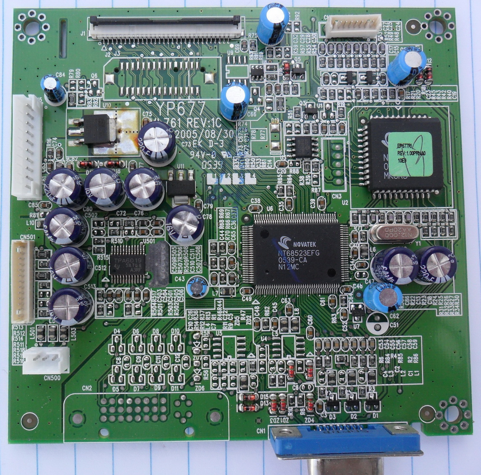

    Most likely on the signal (logic) card. What is the part number of U7, (lower right corner of the Novatek chip)?
    PlainBill
      Re: Planar PL1700M-BK
      U7 is
      AC3NP
      037C9
      I googled it and think I got the datasheet. I can't upload the pdf
      http://www.alldatasheet.com/view.jsp...L431APUN(AC3NP)
      Getting 2.49v on the two legs and 0v on the single side

        The TL431 is supposed to deliver 2.5 volts. Move on. Yes there should be 12v somewhere and it's missing.

          For the missing 12V, try disconnecting everything from the power board and remeasure the voltages at the connector.
          If the 12V is still missing, then measure the DC V at the middle pin of the dual diode (just above C800 in your excellent clear focused pics).

            OK, with everything disconnected from the power supply board and the white wire being the top
            5.21
            5.21
            5.21
            0
            0
            1.66
            0
            0
            0
            5.21
            and I get 15.68v on the middle leg of the dual diode

              Which means the 12v rail is getting lost somewhere before the connector. Look for damaged traces, cracked joints and burnt resistors. Trace the path from the diode and see where it stops.

                Okay, just right of R821 are two diodes. Test them "in circuit" with your multimeter on diode test functionality.
                They should read 0.3 to 0.7V in one direction and 0L or "1" in the other direction. Report both directions for both diodes.
                There are also 4 resistors in the upper right area. You may want to measure the ohms to see if they match their rated capacity.

                  Also for the new caps that you replaced in the upper right hand section, see if the 15.68V DC from the dual diode are present across the capacitors. I count 6 of them in that area.

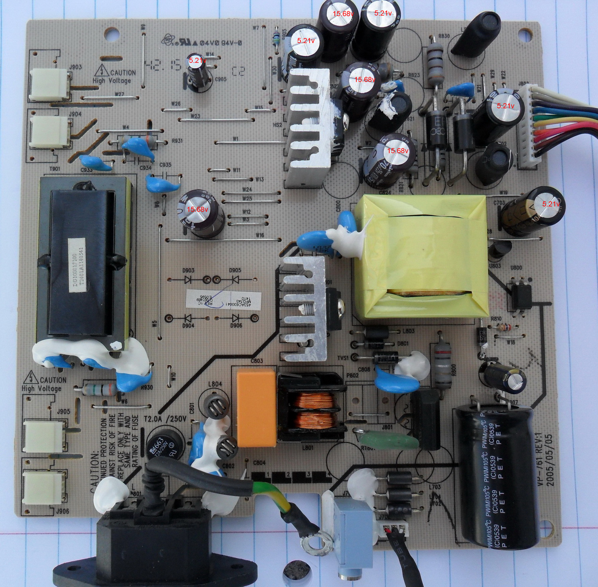

                            Getting 15.68 on 3 and 5.21 on 3(see pic)

                              oops didn't attach pic
                                Hmm, all the voltages on the caps look okay and it appears the inverter is getting its 12V DC (when loaded).
                                For whatever reason, the logic card is not telling the power/inverter to turn on via some signal (probably 3V DC on the connector??).

                                  Hmm, I forgot you have another Planar. Looking at the pics, the logic board is different, but maybe open up the working one and figure out which of the 10 pins is the on/off signal. I believe that connector pin will measure 3V DC.
                                  Once the on/off signal pin is determined on the good one, maybe you can "backtrace" the circuit and figure out where the voltage is disappearing on the bad one? This assumes the connector pins are laid out the same way.

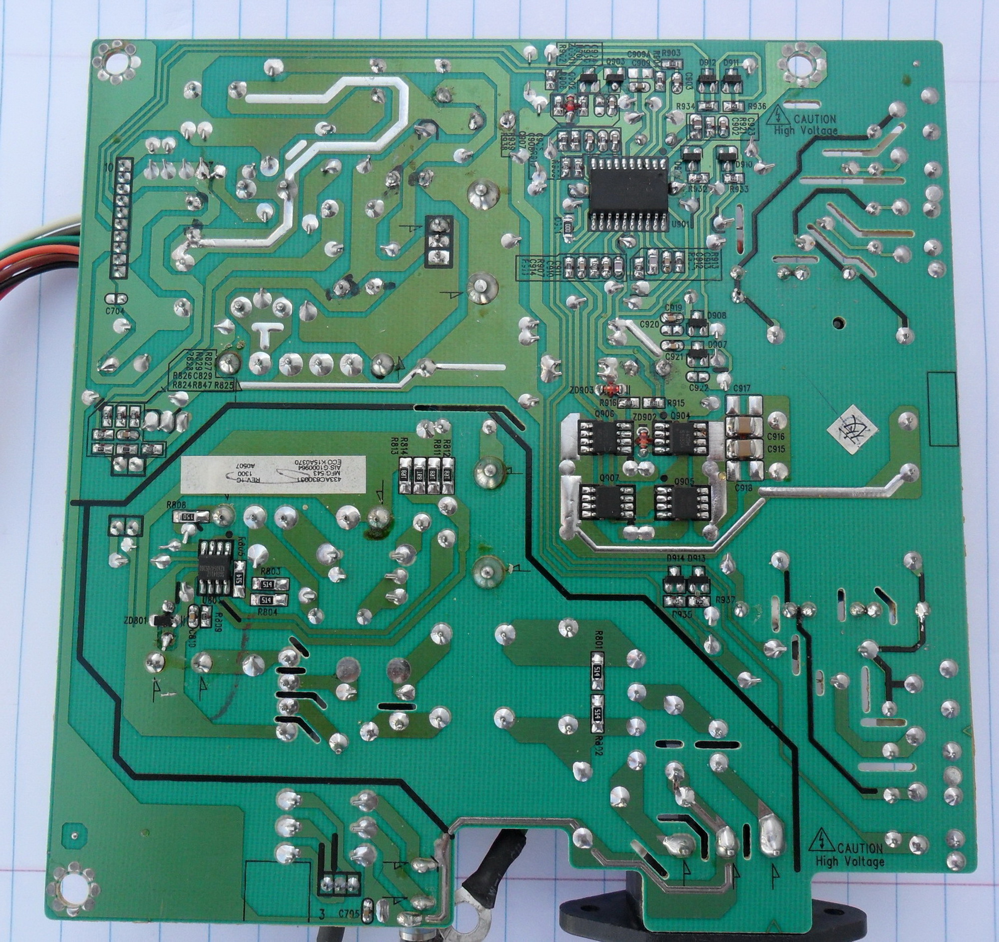

                                    Nice photos! How about testing the 4 mosfets, Q904-Q906 for shorts? They are located in a cluster on the bottom of the board. Usually, there's a fuse that blows if one of these mosfets shorts, but it look like there's no fuse for the inverter section.

                                      The logic board from the other one worked in this one. It powered up, the backlights came on and the osd was displayed, then it went into standby(Works normal). So I took voltages at the connector from the power board while pressing the power button.
                                      Here is what I got from the top pin down
                                      5.17v when off then down to 5.02 when power on then up to 5.22 then to5.17
                                      0v when off and 0 when on
                                      1.33v when off then 1.28 on then to 1.33
                                      0.05 when off then 5.15 when on then back down(standby)
                                      5.17 when off then 5.17 on
                                      5.17 when off then 4.99 on then back up to 5.17

                                        looks like the power board is fine. I'm trying to find the power on from the logic card. I think it's the 0.05 pin(am I right)?
