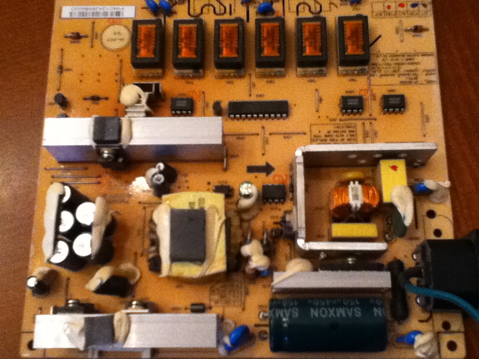

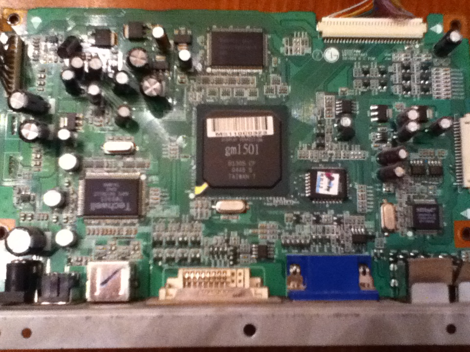

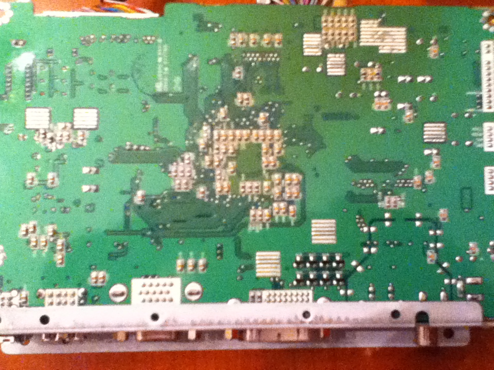

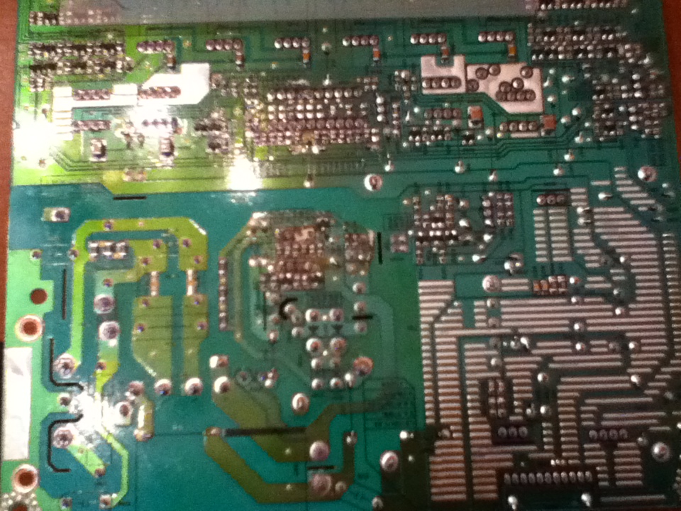

    Things first started going bad with it when the screen would have horizontal lines all over it, looking all jumbled also, after turning it on. It also flickered while doing this, but went back to normal after a minute or two.
    Then I noticed the screen would start to get really (trying to remember here, might be incorrect) pixelated? Best way I can think to describe it. I'd move the mouse really fast and it'd slowly bring the screen back to normal.
    The pixelated screen after being turned on just continued to get worse and over time it took longer and longer for the screen to normalize, so eventually I just kept it on 24/7. Kept it on for months. However, one day someone in the house decided to turn it off and that was the end of it. Couldn't be turned back on.
    I've included front/back pictures of the board with the power supply on it (I believe) but if anyone needs anymore closer up detailed shots let me know.
    Also from the description I tried my best to provide.. does it sound like this is a repairable issue?
    Thanks for any help.
    edit: just realized these pictures might not of the highest quality. If not, I'll see if my gf has a digicam.

    Please provide pictures of the logic board as well.

          https://www.badcaps.net/forum/newrep...ote=1&p=149442
          Originally posted by billstvs
          I have the same model with the rolling problem.
          Narrowed it down to C637 470/16v on video/logic board.

              Can you please provide some clearer focused photos of the power and logic boards. It's very difficult to see the parts.

                  LED lights do not turn on at all.
                  With no power LED at all, it is time to take voltage measurements and check the fuses
                  1) plug in lcd
                  2) put your multimeter on 200V DC
                  3) CAREFULLY measure the voltage across the large main filter capacitor lying on its side (Samxon)
                  The voltage should be 120V (if you are in the USA) x 1.414 or roughly 165V DC.
                  4) With power off and lcd unplugged, check the fuses on your board. Set your multimeter to 200 ohms (if manual). A good fuse should read less than 1.0 ohms.

                    Before I attempt any of this, should I rehook it all up? Or do I just need the board with the power supply plug on it hooked up to the LCD?
                    • retiredcaps
                      • Apr 2010
                      • 9271
                      Re: Can my 2005FPW be repaired?
                      It is best to hookup as many boards as possible to get a "load". You don't need the cover back on.
