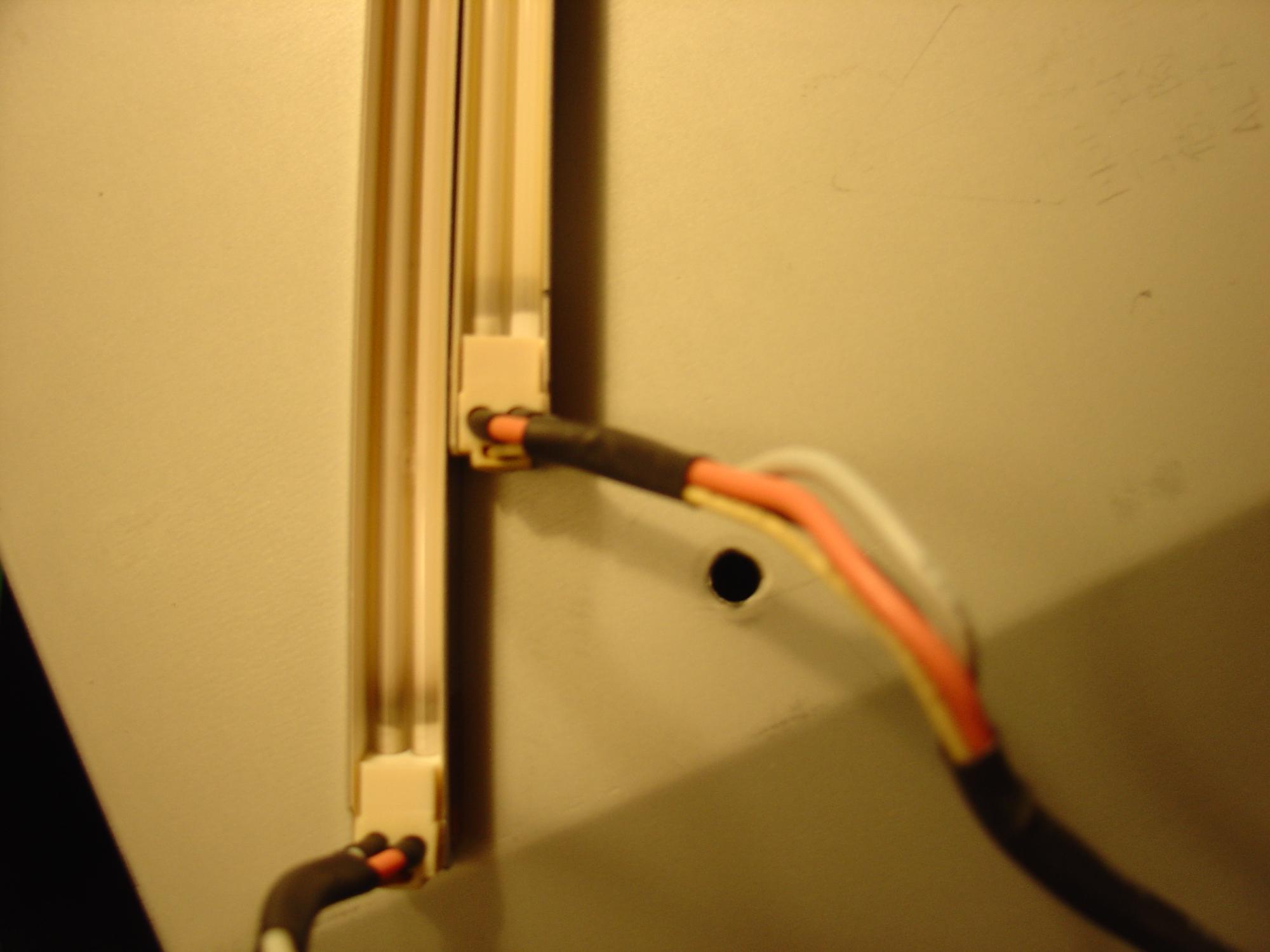

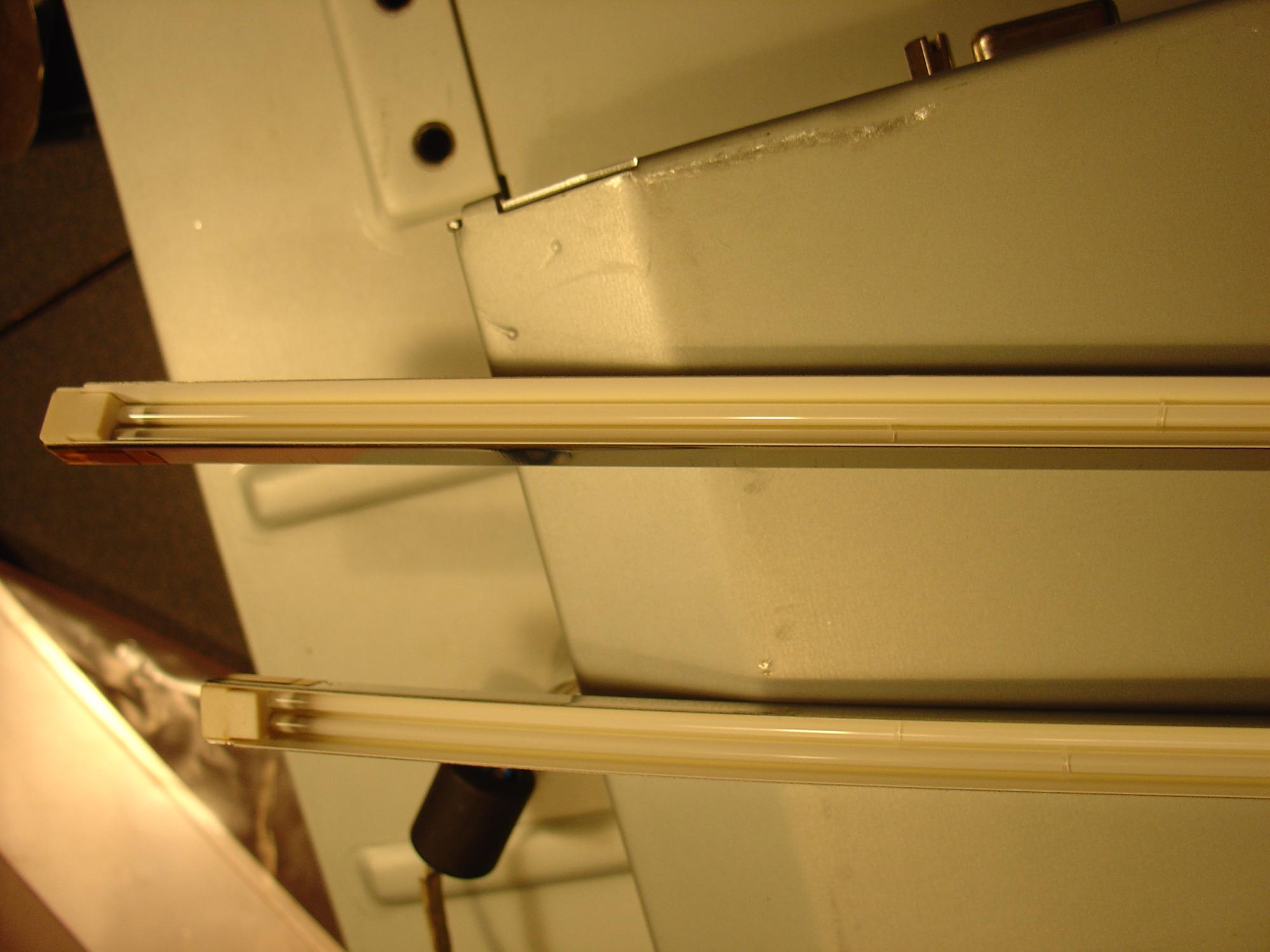

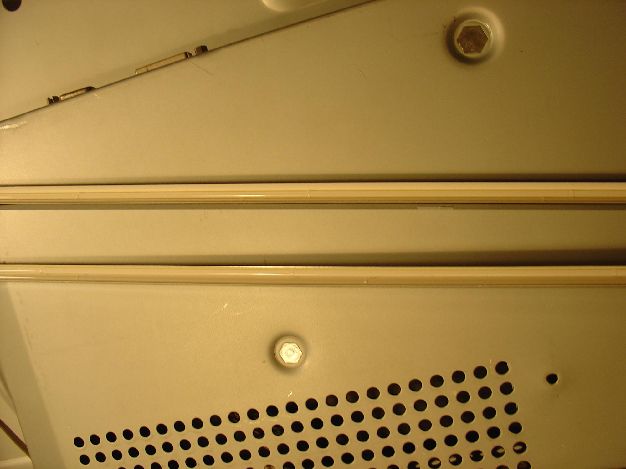

        k so decided to take one apart since gotta learn and always thought they were literally behind the monitor...one set of two is top and another on bottom...not sure if theres a way to tell but heres the pics

            IMO - You have 1 or more failing tubes. It seems the inverter controller chip is doing one of 2 things. It sees an over-current -or- an excessive strike-time (too long to fire) and shuts down. If you have a working unit of the same size, you could swap them to that. Or one of the cheap-o PC case lights, that should at least give you a clue as to the weak tube(s).
            I would start swapping tube assemblies to the unit that's still together and see if it will run. No need to disassemble, just plug them in one at a time to each output.
            Toast

                I've got a cracked Chi Mei M220Z1-L01 22" LCD Panel here (out of an Acer X223W).
                CCFLs are fine. If you want them, let me know
                They're already out of the panel.
                please note that replacing them on that specific panel is anything but easy. you have to remove the metal back plate and disassemble the panel to get to them.
                no easy slide-out on the side as i've seen on other panels, like LG/Philips
