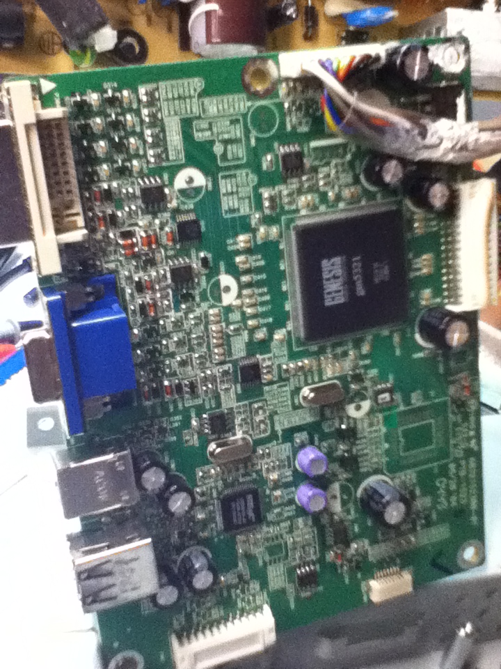

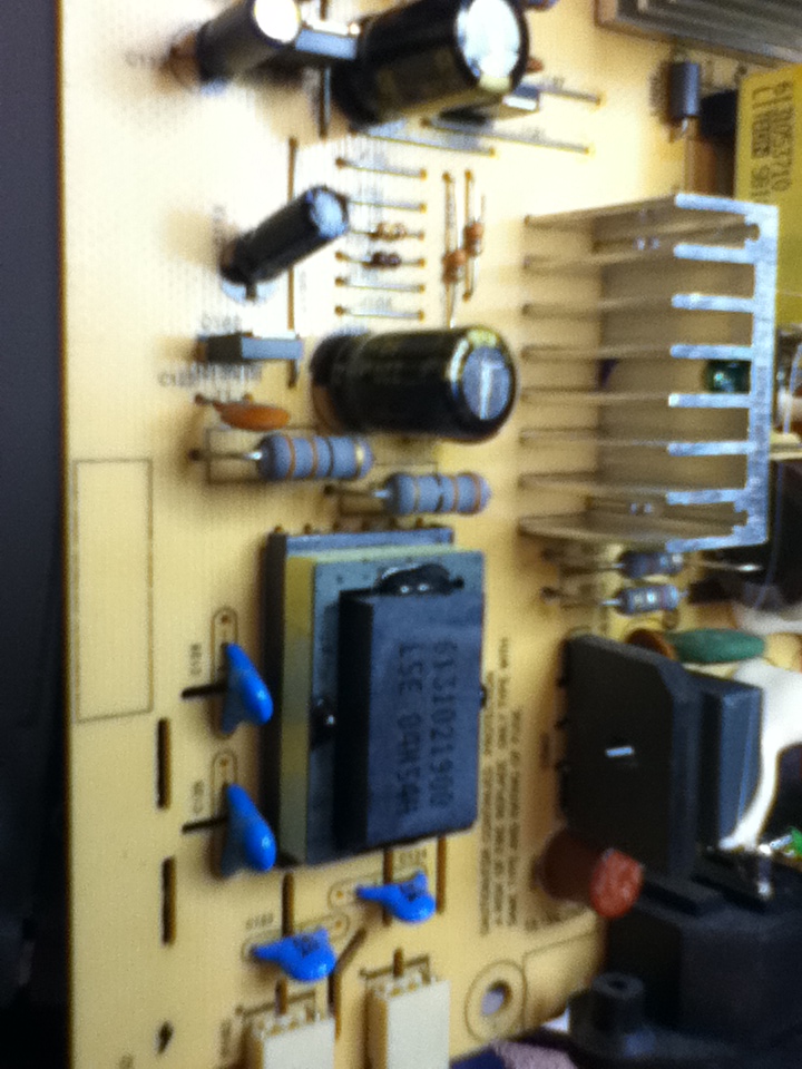

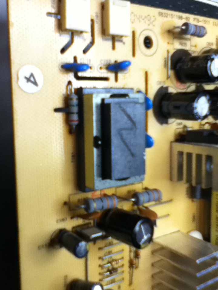

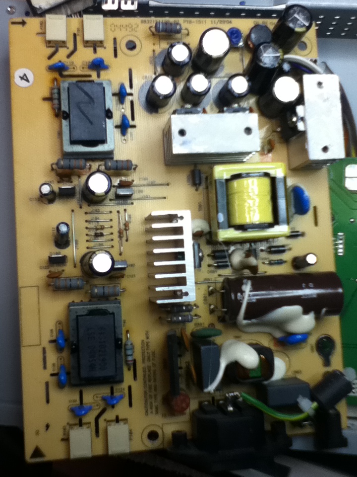

                    I uploaded a number of photos of the boards.
                    • retiredcaps
                      • Apr 2010
                      • 9271
                      #50
                      Re: Dell 1905FP Won't Turn On
                      You have 4 transistors sandwiched in between the 2 transformers, but I can't make out the PCB designation because your photos are not clear enough.
                      They might be c5707s. You can test them "in circuit" without desoldering them for shorts. Measure the ohms between B-C, C-E, B-E. Any reading less than 30 ohms suggests a shorted transistor.

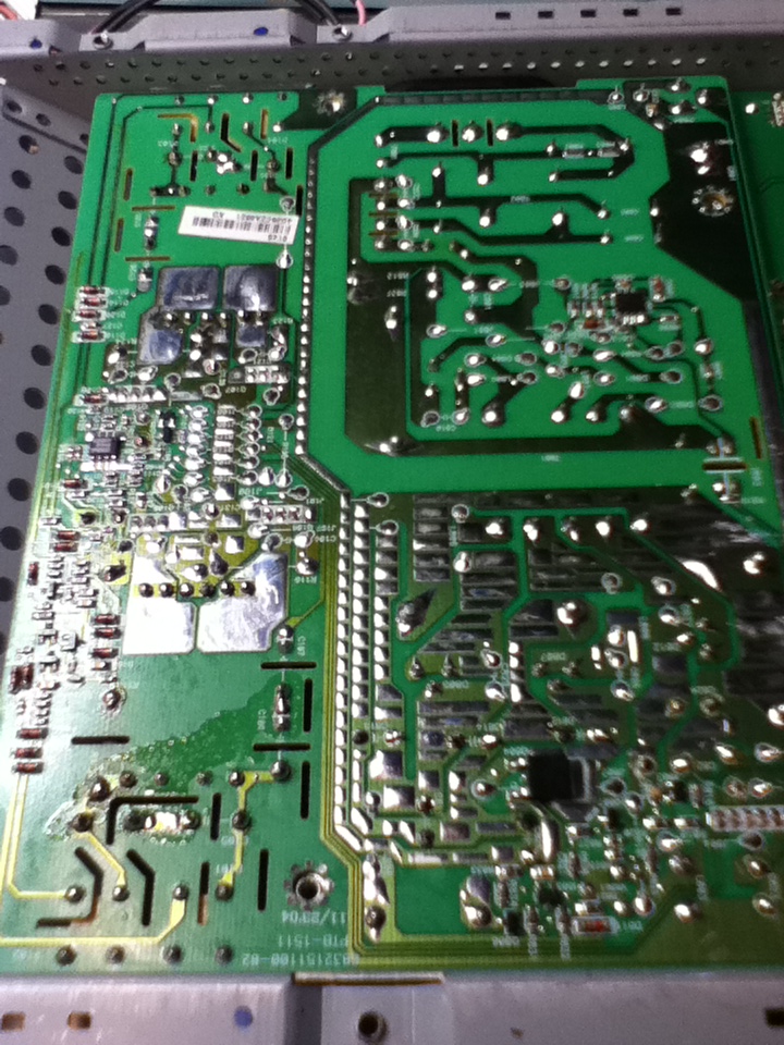

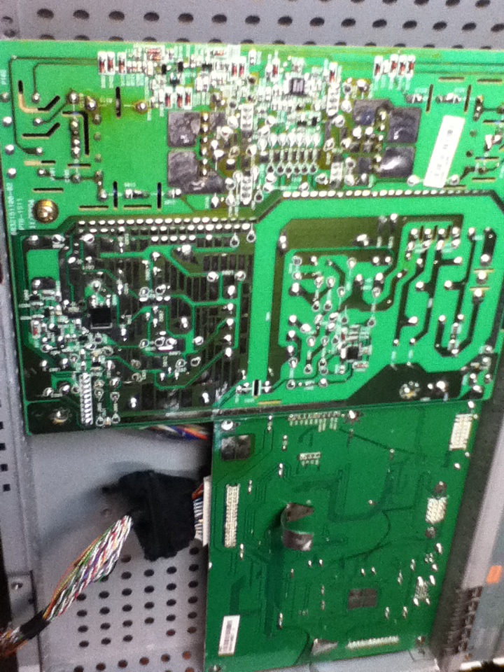

                                  Could you try to get a better picture of the bottom side of the Inv/PS
                                  Overall straight down without a flash, and more in focus?
                                  Whatever I do, I consider it a success, if in the end I am breathing, seeing, feeling and hearing!
                                  • ryszardx
                                    • Feb 2011
                                    • 20
                                    #57
                                    Here's a back and front of the board. The board was slightly tilted. I can reshoot if you need it. Ran out of time today. Thanks Rich
