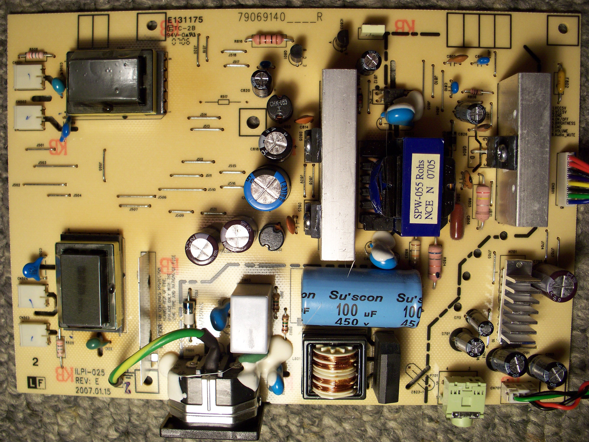

    Classic 2 second on then off. I can usually turn it on/off a few times and it'll eventually function normally. This morning I finally got tired of dealing with it and pulled the thing apart. Below is a high-res of the power board.
    The only capacitor that was obviously bad was C815 (1000uF with blue coat in center) which had a bulging top. I swapped it out with Radioshack's finest (garbage) just to see if that was the problem. Now I get a grainulated picture with a heavy red tint but it does appear to be (somewhat) stable.
    First and foremost, does anything else stick out as being a problem?
    I would also like help in finding a real replacement for the 1000uF cap that was bad. The original has the following markings:
    C818 is likely to be bad, but not bulging. Both C818 and C815 take the brunt of the heat from the diodes that are mounted on the heatsink.
    Having said that, most here will recommend that you recap the entire board except the biggest capacitor which rarely, but not never, fails.
    Capacitors die from age, heat, and shoddy build quality. Capacitors DO NOT have to be visibly bloated in order to bad. They can be out of tolerance uF (a 1000uF measures 20uF) and/or have high ESR (ohm). A multimeter will be insufficient to test for ESR. For that you need an ESR tester which costs between $50 and $300.
    Most members here will recommend that you replace ALL capacitors with reputable brands from reputable sellers. Brands like Rubycon, Panasonic, and United Chemicon are suggested. A list of recommended caps can be found at
    https://www.badcaps.net/forum/showthread.php?t=2280
    If you are in the USA, you can follow PlainBill's instructions on how to order Panasonic FM or FR caps. FC is the alternative if neither of the former are available. See
    https://www.badcaps.net/forum/showpo...33&postcount=2
    I'm guessing the entire order should be around $10 USD (that includes shipping if you choose USPS first class) and you should get it in about 48 hours.
    PS. Try going into the monitor's menu and set everything back to factory defaults to see if the red goes away.

          For thoroughness, below are the replacement parts for my model of Q19WB.
          Originally posted by mockingbird View Post
          Here are suitable replacements, all by Panasonic (Except for the primary), from Digikey, all in stock:
          1) http://search.digikey.com/scripts/Dk...name=P12388-ND
          2) http://search.digikey.com/scripts/Dk...name=P12388-ND
          3) http://search.digikey.com/scripts/Dk...name=P12379-ND
          4) http://search.digikey.com/scripts/Dk...name=P11203-ND
          5) http://search.digikey.com/scripts/Dk...&name=P5151-ND
          6) http://search.digikey.com/scripts/Dk...&name=P5151-ND
          7) http://search.digikey.com/scripts/Dk...&name=P5151-ND
          8) http://search.digikey.com/scripts/Dk...name=P12388-ND
          9) http://search.digikey.com/scripts/Dk...&name=P5161-ND
          10) http://search.digikey.com/scripts/Dk...me=P10370TB-ND
          11) http://search.digikey.com/scripts/Dk...&name=P5543-ND
          12) http://search.digikey.com/scripts/Dk...&name=P5543-ND
          And the primary, if you're interested in replacing it too:
          http://search.digikey.com/scripts/Dk...me=565-1481-ND
          Highest length I went was 20mm, which is the height of the two larger heatsinks, so they should fit just fine.
          On my board C701 is "Suscon SK" not "Teapo SH". I still have that one original on my board. Not to worry, they're both general purpose caps anyways, most likely interchangeable, all I had to do was either match or slightly exceed the ripple with a higher quality part.

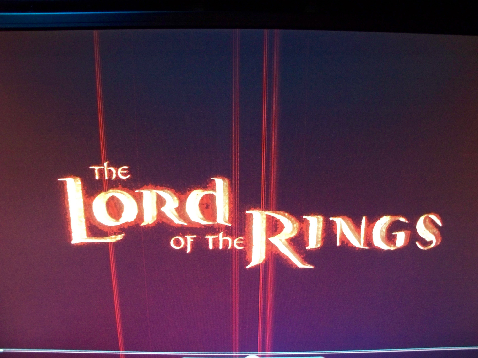

            I replaced all but the biggest cap and reset the monitor settings but still have a heavy red hue.
            Any ideas?
            Could the larger cap be causing that?

                  First thing I checked was the cable. Same problem using a different cable on a different computer.
                  Isn't the pinkish hue supposed to only affect white and bright colors? Is there any way to test the CCFLs without canniablizing another LCD?

                      Re: Viewsonic Q19WB
                      No, it's nowhere near that.
                      Below is a pic of what it looks like. Note that the vertical bars are NOT present when a normal picture (ie my background) is on it and the background hue sort of flows from right to left.
                      Aside from a few flakey pixels that unstick with a light tap, the screen itself should be fine.

                            Re: Viewsonic Q19WB
                            Ok found the problem. Got to looking and it appears I bent a pin for the video cable on the logic board
                            Having been down this route with warehouse-bought CPUs at work I'm pretty sure I can't fix it without a pin straighten tool, not without breaking it anyway.
                            Anywho, thanks for the help.
                              Re: Viewsonic Q19WB
                              The pins are on the board, not on the cable. The cable should be a female connector.
                              Anyways, I got to looking at what you're speaking of, and you could fix this with a sewing needle. Be patient though.
