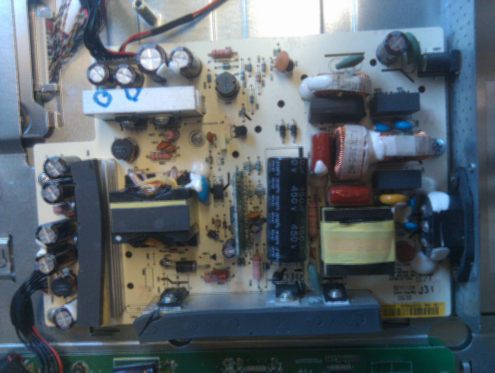

    HI i have a fpd2485w gateway monitor that when i turn it on cycles solid colors on the screen over whole screen. the whole screen is a solid color then it cycles threw differnt colors over and over. i looked at all the caps and dont see any that are bulged or leaking. does any one have an idea of what could be causing this. when i turn it on the power button turns blue and the menu button comes on for 2 seconds then goes out and none of the other buttons are lit except the power button.
    any help would be greatly appreciated!

      1. Interesting handle. Did that happen sliding down the pole?
      2. It sounds like the monitor may be in test mode. No, I have no idea how to get it out of test mode.
      3. With all due respect, I no longer trust a statement that the caps look perfect. I've gotten burned on that once on the identical monitor. Note the links in my signature on how to take superior pictures, and how to attach them.

          It does it with nothing or computer hooked up with differnt inputs. i will try to get pictures up tommarow. it does kinda seem like some kind of test mode. i see they have a cap kit for this monitor on ebay with all the caps needed. do you think this is worth a try?

              I agree. If you are going to replace caps, replace those on the signal (logic) board too.

                  I will get some pics up when I get home from work today.

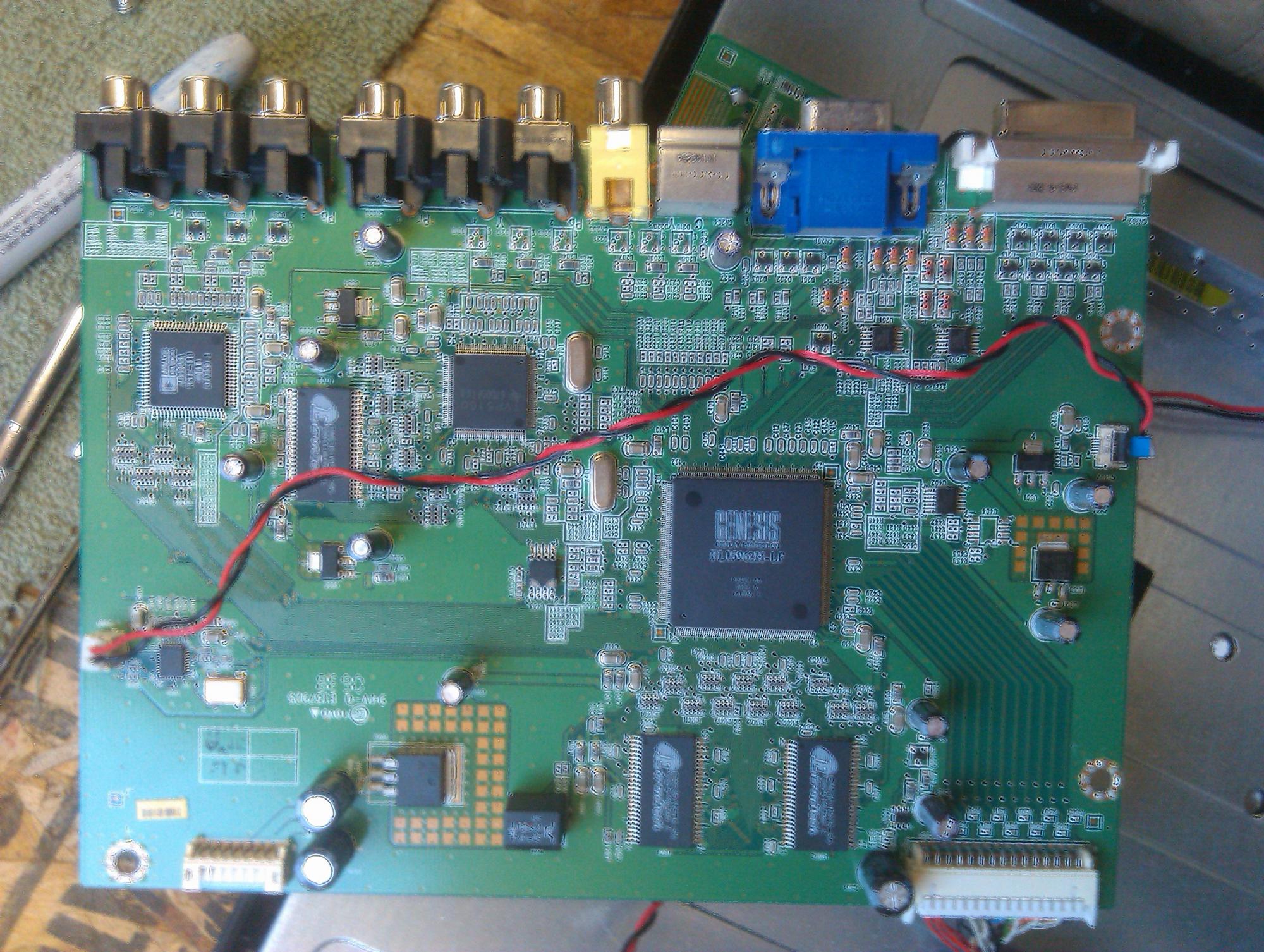

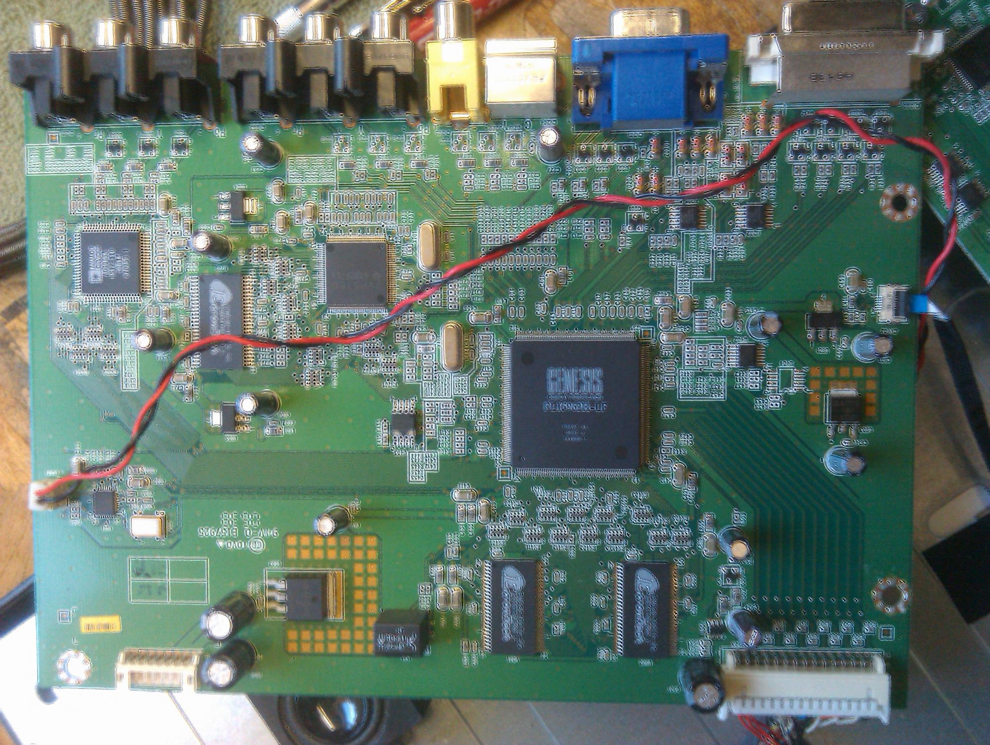

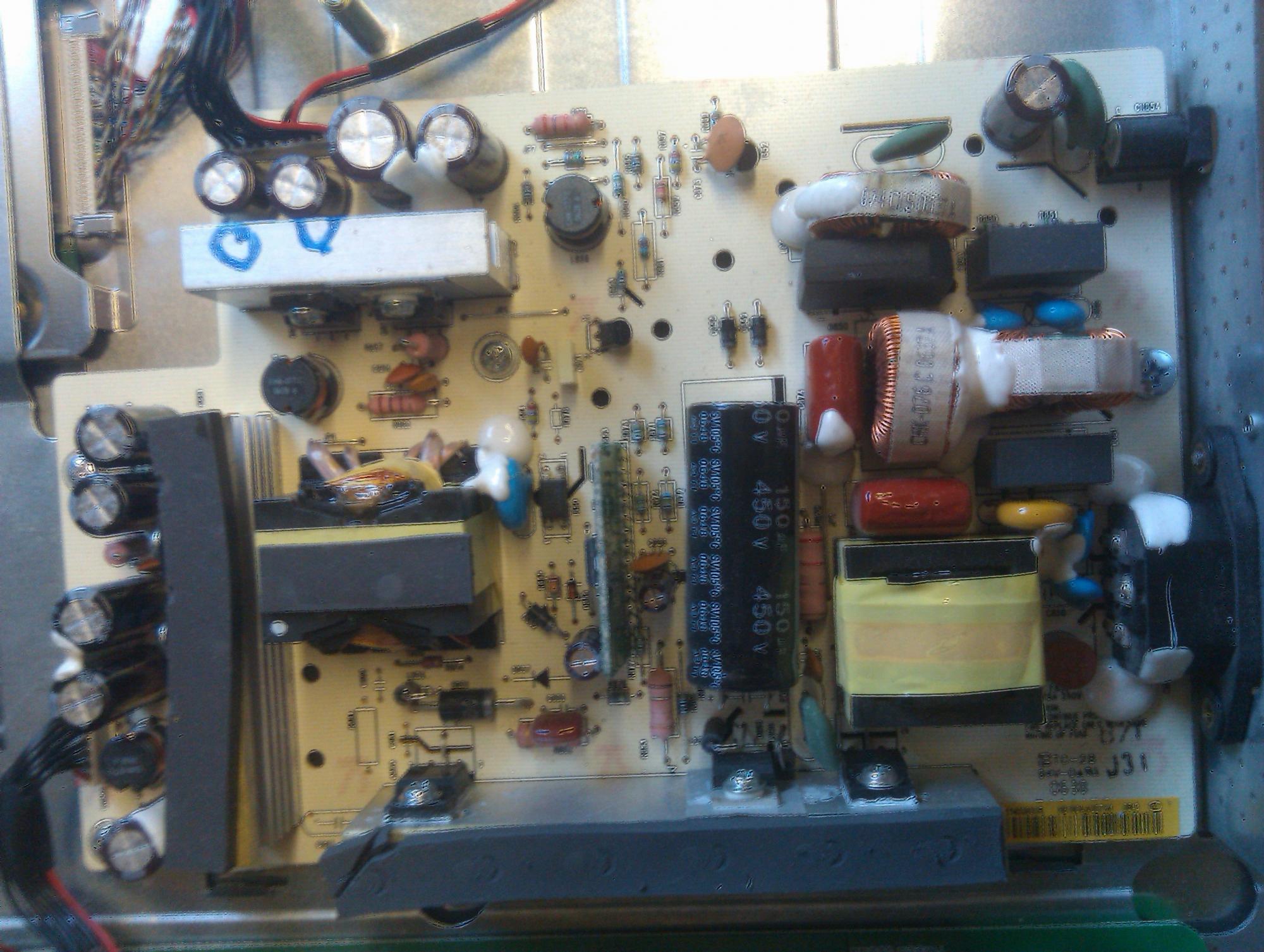

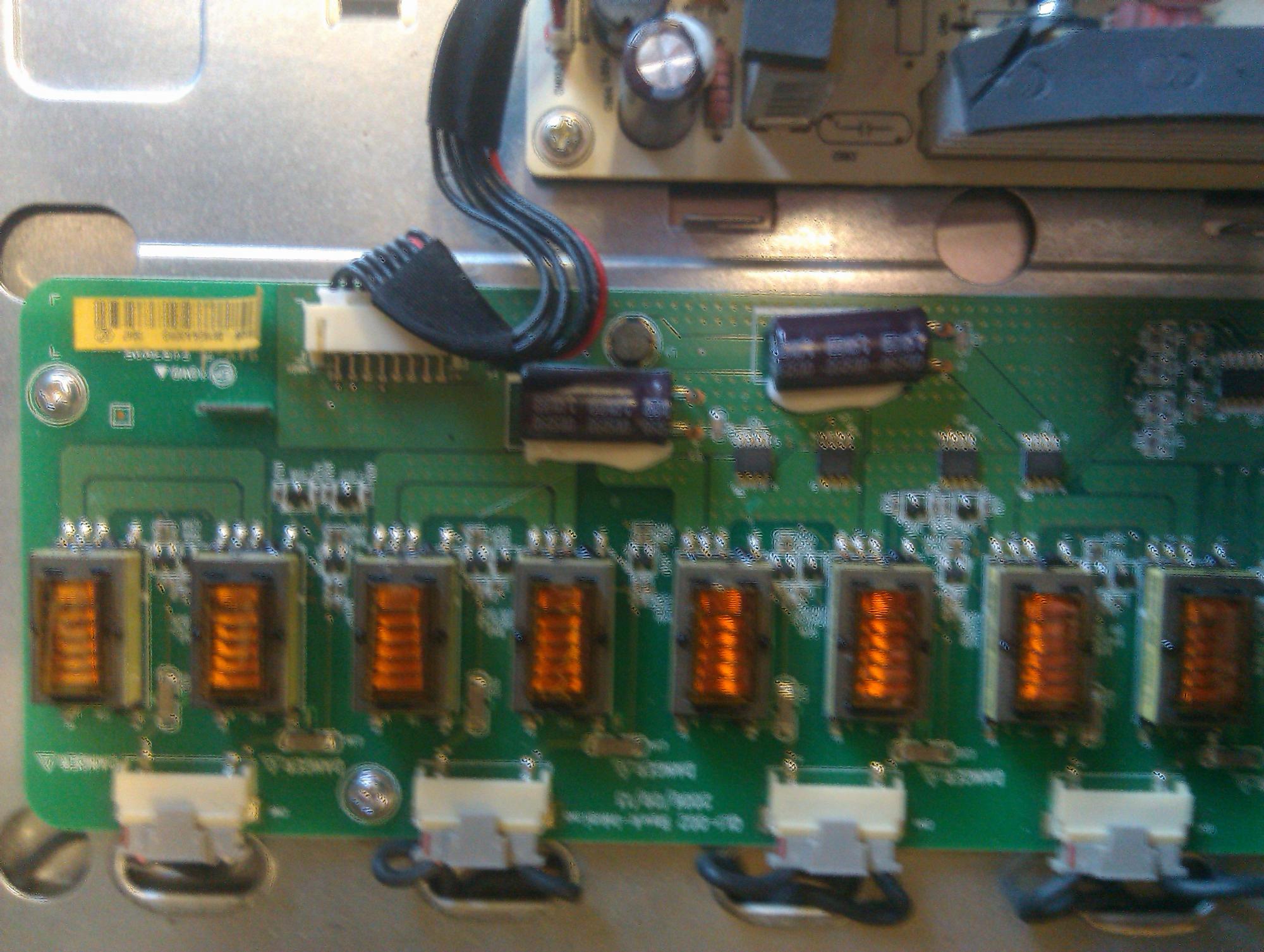

                    Re: fpd2485w cycling solid colors
                    here are those pics hope they help!

                      I think you are jinxed. The photos look like they have been through some artsy photo effect.
