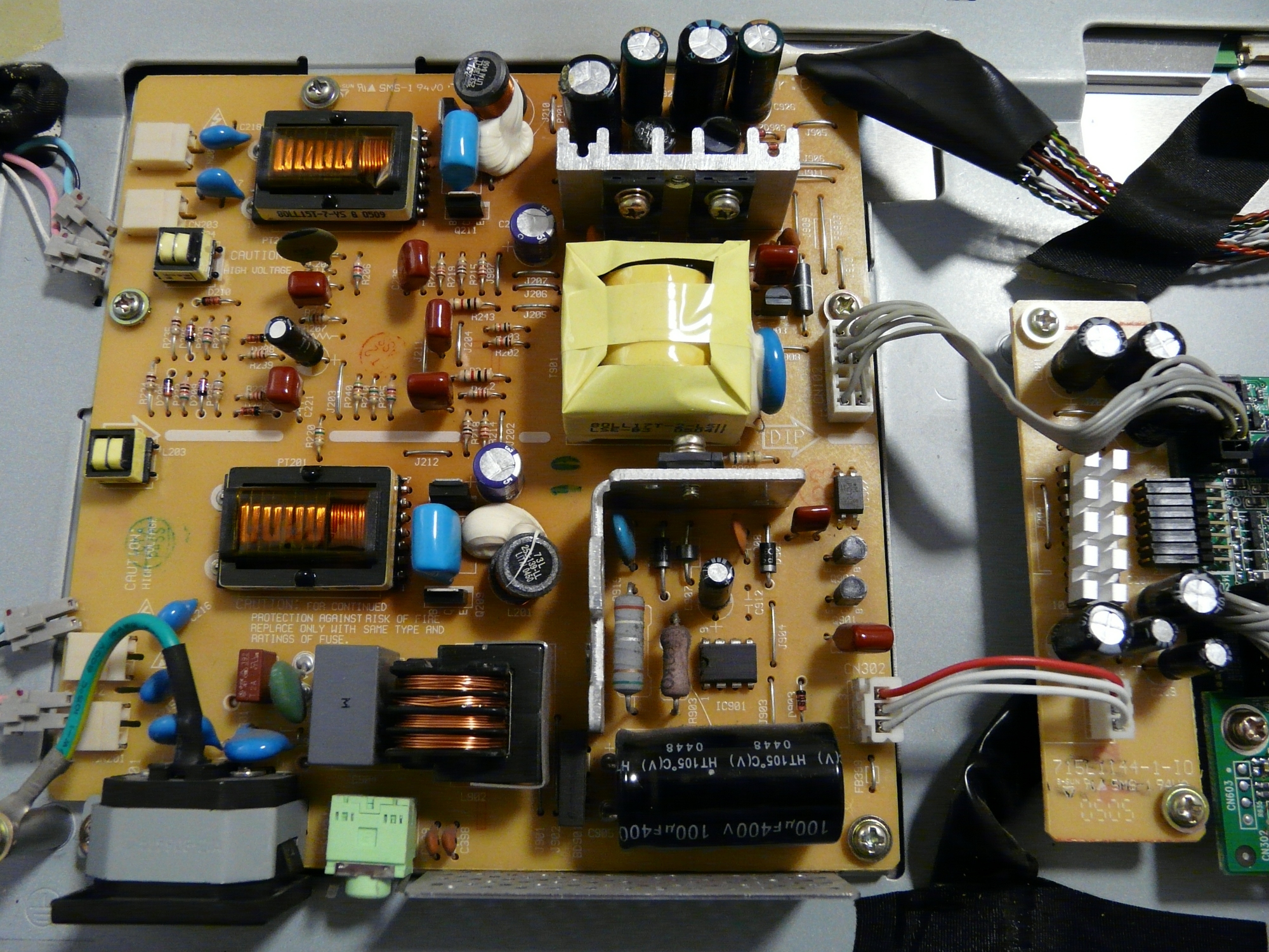

      Image of photo board now attached.
      I have replaced two 1000uF 16V caps on the top right corner of the power supply board image.
      Indeed there is a 22uF 50V cap next to the IC901 at the bottom right of the photo but I do not have equipment to test. I will find a suitable replacement to see if it solves the problem.

        Re: Iiyama Prolite E430S click sound
        Lucky guess on my part. They can range from 2.2uF to 47uF.
        This board looks Benq-ish. In particuluar, check Q211 and its partner, Q209 and its partner for shorts.
        BTW, the cap just right of J210 has the sleeve partially burnt off. Since caps are farily inexpensive (less than $1), I suggest you replace that one in case there is damage to it?

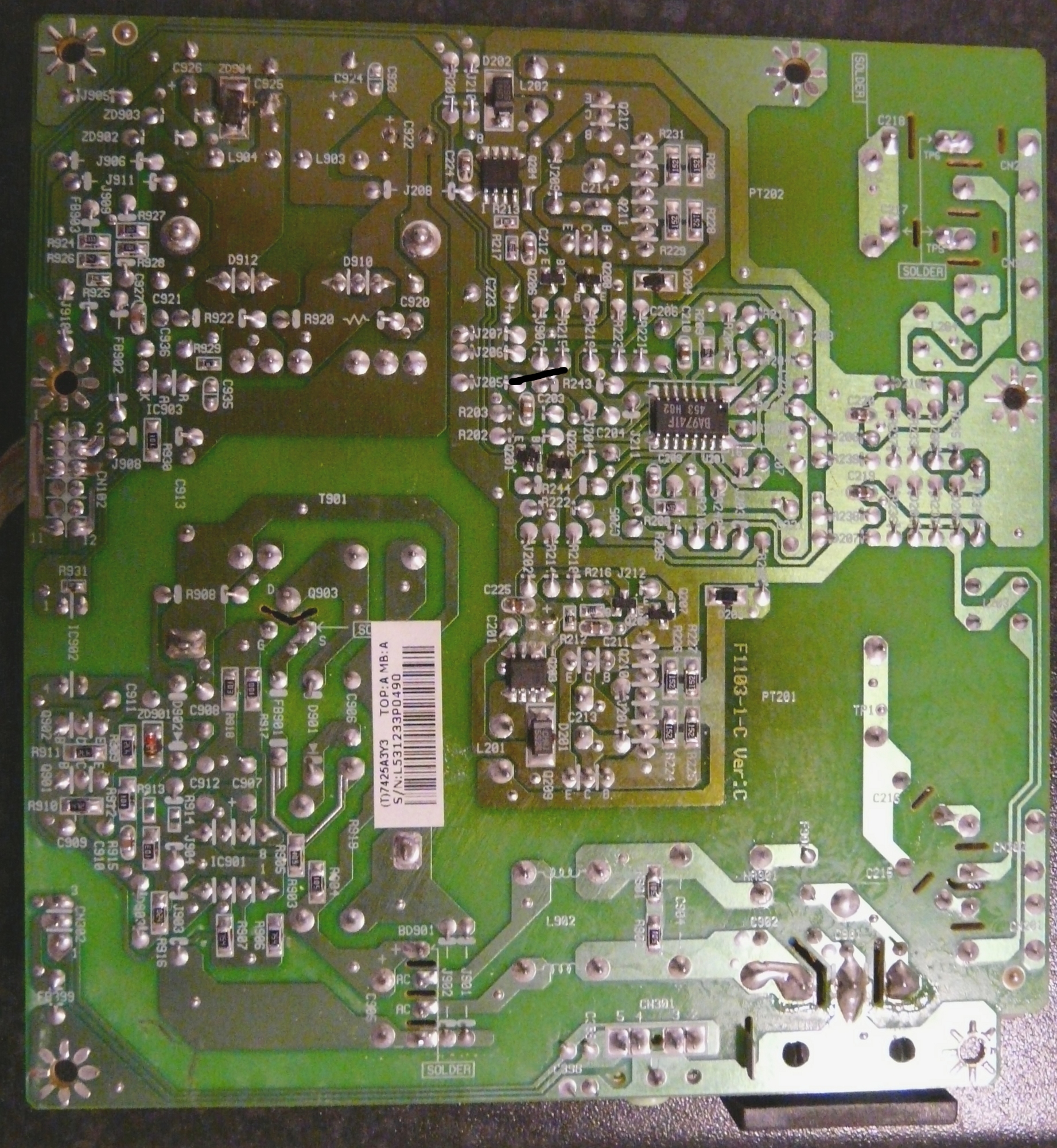

            Image of the back of the power supply board attached.
            Initially I had suspected ZD904 at the top left of the image as it looks rather burnt.
            I had just tried to measure the voltage across C907 the 22uF 50V cap. When I put a voltmeter across it the clicking sound slows down, reads around 15V steady but when it clicks (now slower) the voltage drops to about 10V.
              1) You can measure ZD904 "in circuit" with the diode check function on the multimeter.
              2) PlainBill talks about pulsing on the small cap ...
              https://www.badcaps.net/forum/showpo...48&postcount=4
