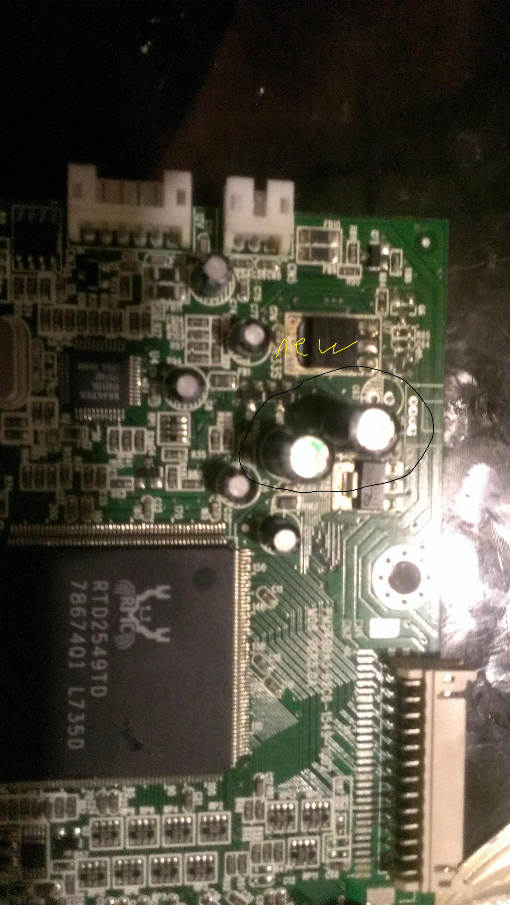

    It looks OK from the pictures. The MB is more than 10 layers board, so it will be a little easier for the main board of the monitor which may be 4 layers at most. Using extra flux also a big helps.

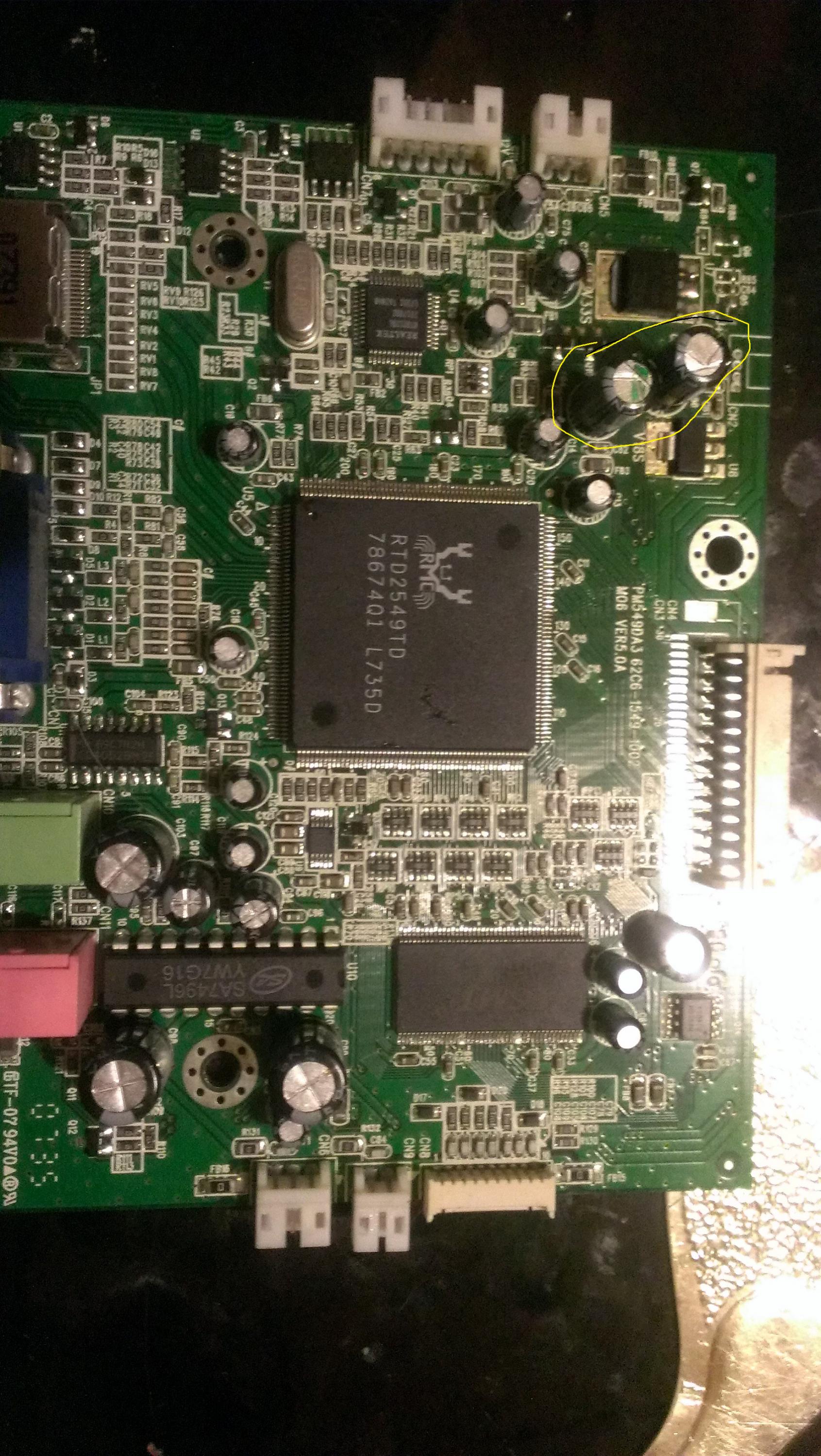

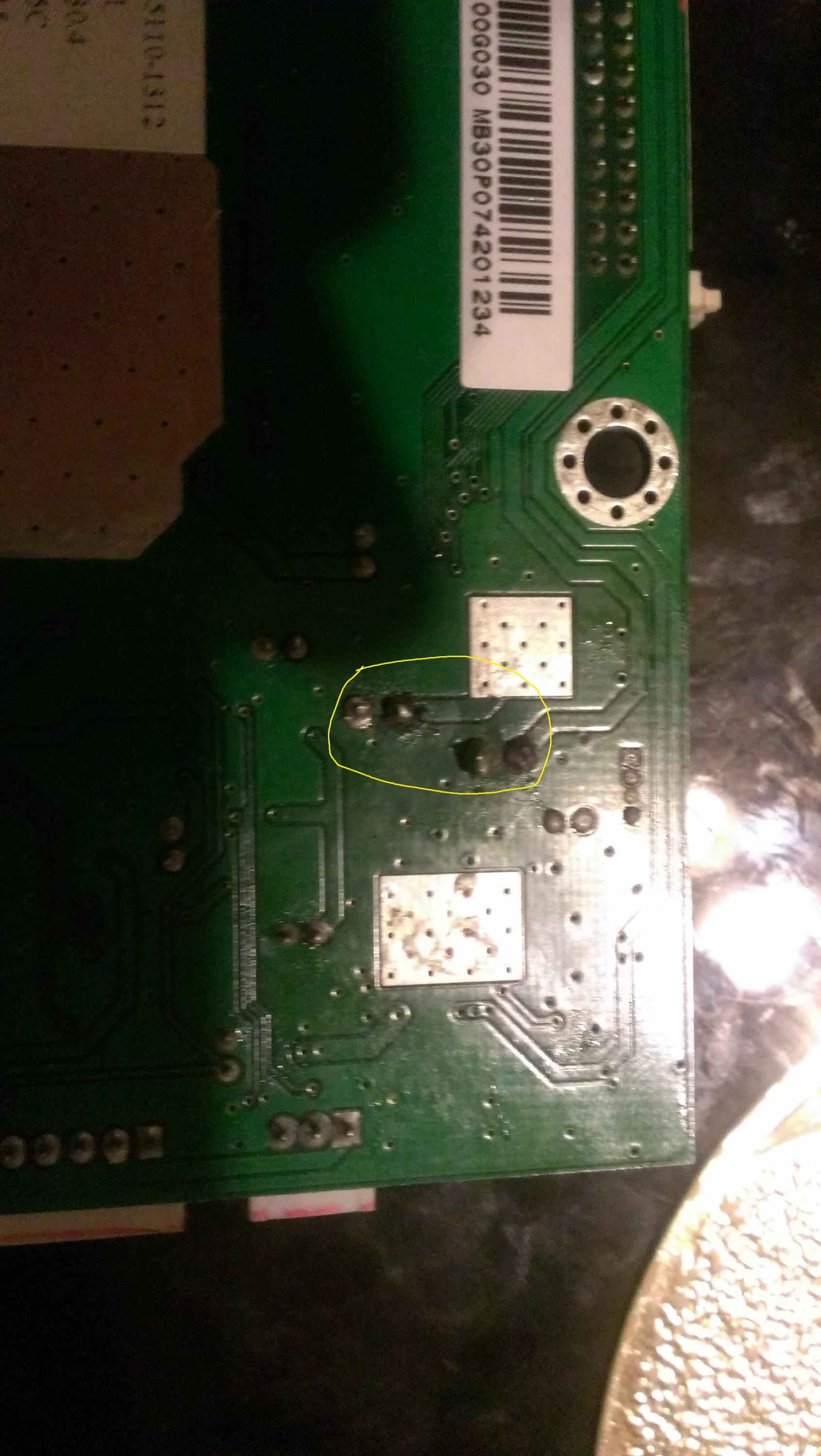

      Have great news!!!.
      Monitor works like brand new now! Was much easier than on the computer board, Every problem is now fixed the interference lines and the white dots, And also the monitor brightness controls, Now i can finally turn the brightness down now lol
      At first i thought it was something else causing that problem like the button board. But nope was those 2 caps that budm said!
      Thank you very much for the help budm!!! If it wasn't for you i wouldn't even know if the caps was even bad or those 2 was the problem ones lol
      I posted some pics and of my soldering, Not the best but i don't think its bad well i hope not lol.
