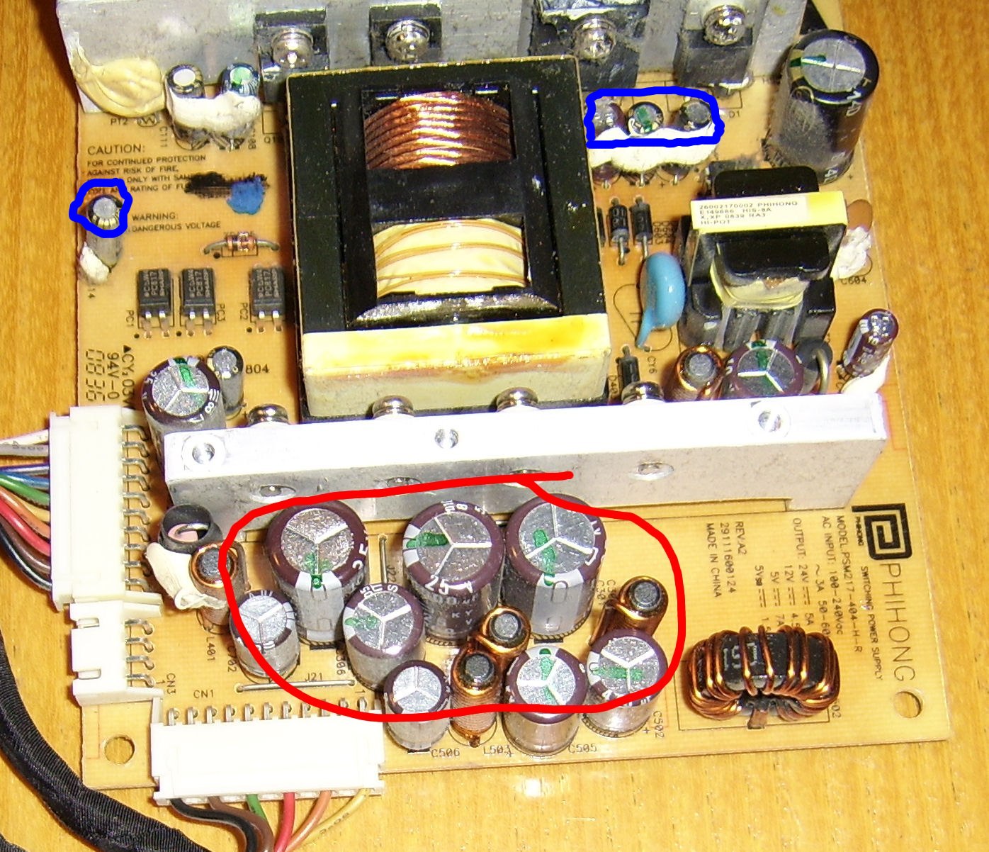

                        #111
                        Re: Hanns-G HG281D 28" TFT - Multiple Problems
                        OK Here they are
                        Sorry for the delay, had to find some batteries for my camers.
                          #112
                          No failed caps there - and they look like pretty high quality Chemicon KY. Red circle indicates the secondary caps. I think Retiredcaps said something about these Chemicons drying up because these monitors run hot, but I'm not sure.
                            "t is the startup cap"
                            Is it the one on it's own, the resin around the pins has discoloured, looks like it might have overheated.
                            Would they be different values, I think the one on it's own says 50v 2.2 uF I can't see the other values until I get them out.
                              #114
                              Yeah, it's the discolouring that has me worried - the cap may have simply been cooked (I've just had an LG TV which had a burnt area near a cap, the cap looks like it was cooked by whatever was very hot nearby.) Capacitors really hate high temperatures, especially the smaller ones, the electrolyte dries up.
                              For those as a temporary fix you can use caps from Maplin as they are less crucial. I would recommend using decent ones for greater longevity though.
                              Probably the one on its own is the startup cap, but replace all four to be sure if you can.
