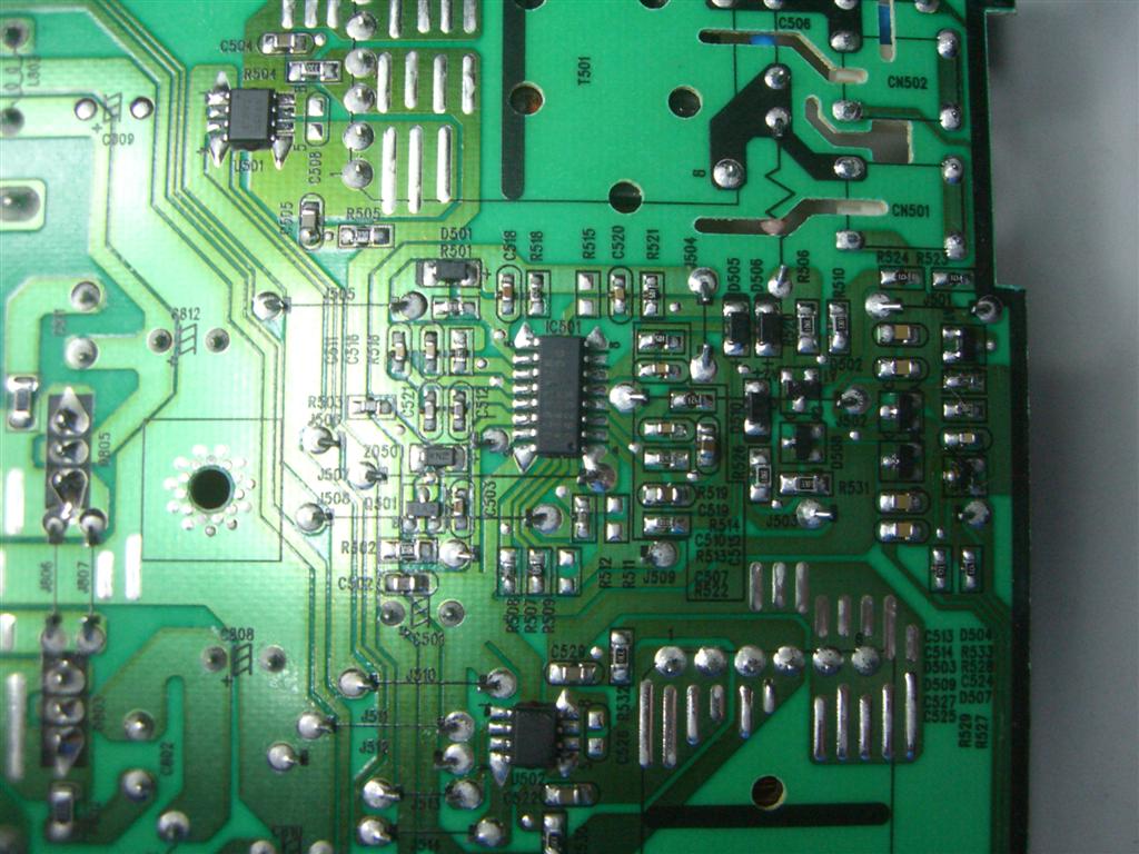

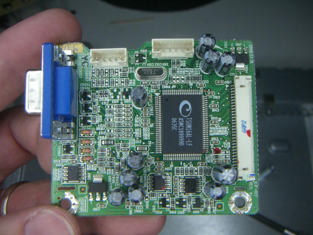

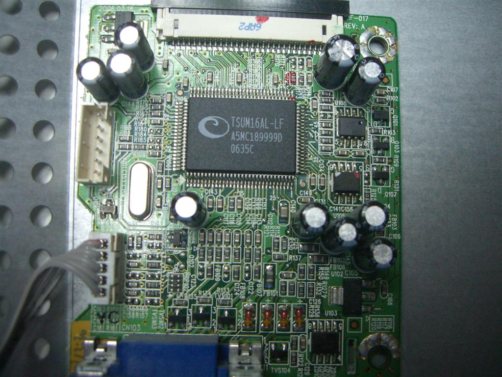

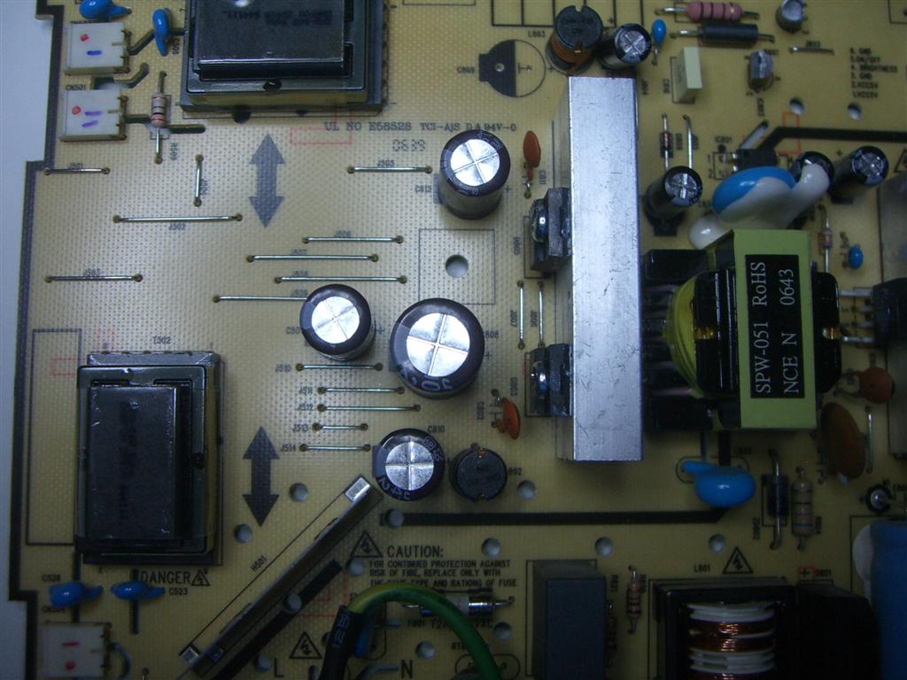

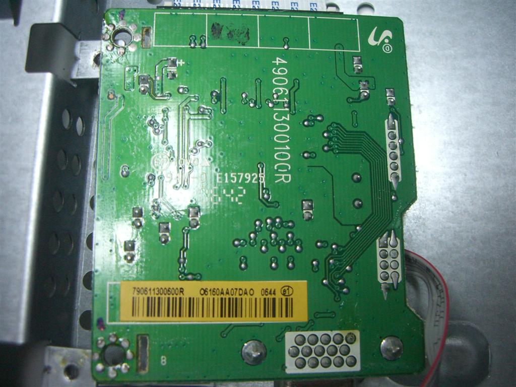

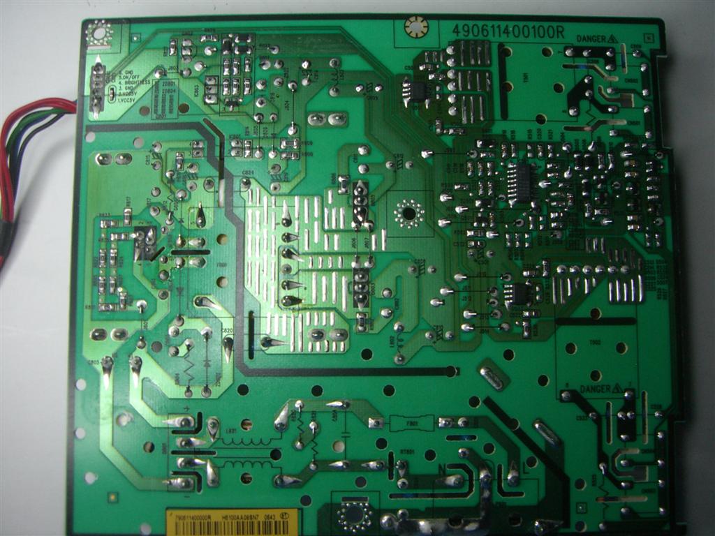

    Reflowed all (ugh) joints on the back of the logic board and the PS/inverter board. Reflowed the transistors on the front of the logic board, but other connections looked okay and those are really small even for my Hakko. Still no joy.
    Connected to a computer, I see a fabulous image with a random dance of the monitor's menu all the time.
    Tugging on the button board does nothing, reflowing the board, nothing, de-soldering the menu button and reboot, nothing; all resistors on the button board are okay; reseated all cables, nothing. Once the monitor is up, if I disconnect the button board, the menu disappears and all appears normal (I may not have supposed to do that, but so far so good). Haven't traced the continuity of the button cable while flexing it, but am wondering what I'm missing?
