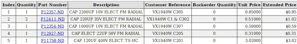

    thanks for the suggestions.
    attached is my DigiKey order... I would appreciate verification that I selected a suitable replacement for the 120uF/400V capacitor.
      Re: 2 Viewsonic VX1940W buzzing and no signal
      Assuming the diameter and height are correct, Panasonic is fine.

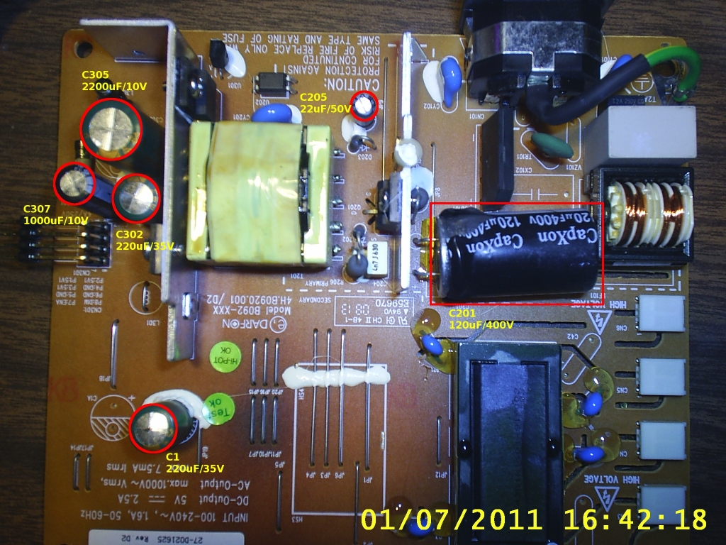

        ...for those following along at home and/or vicariously repairing monitors through my experience, I've attached an image indicating the parts being replaced.
        C1 and C302 are definitely bad (bulged)
        C201 is questionable.
        C205, C305, and C307 are being replaced in a preventative manner, as they are of the same quality as the failed capacitors (5x CapXon, 1x VENT). All being replaced by Panasonic caps.
          Post an after pic on the new ones installed.

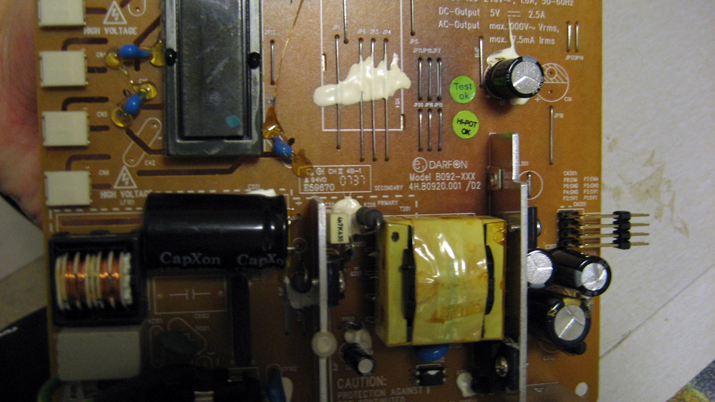

                  Recapped the monitor now. Didn't help anymore. Must be some other component failing? Don't know what. Here's image of the smps-board..
                  It's trash unless someone figures any tricks
                    Originally posted by Neobyte View Post
                    first msg on this great forum. Finally found this thread I was looking for. My monitor is model VX1940wm to be exact.
                    I have _exactly_ the same story as briand. Had VX922 and it was replaced to this monitor and it failed too. First time I changed only the 2 bulged caps, and the monitor worked like 1-2 month(s). After the first repair, one vertical cyan line appeared on the screen after heating up. By pressing the screen the line disappeared. Don't know it this is due some bad connection or connector.
                    Anyways, the monitor went completely dead. Decided to change all caps then and I'm also waiting the parts now. I will get back when I get it completed :P
                    What do you mean completly dead?Have you checked all the fuses?
