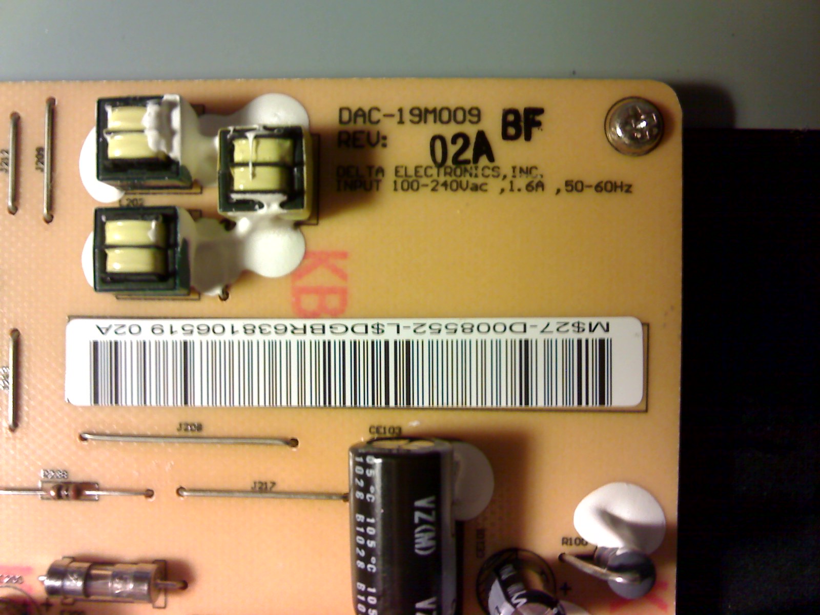

    Hi, a few weeks back I found my Chimei 221D LCD Monitor not able to power up in the morning after I left it in standby mode with my computer on. The power light doesn't light up at all when pressing the power button to turn the screen on.
    I took the initiative to open it up and have a look for blown fuses, they all checked out with my multimeter. I also noticed that the Capacitors where hissing. The power board is a DAC-19M009, and the main board is a a170e2-e03-h-s6
    I tried to test the voltages going to the a170e2-e03-h-s6 main board and they seemed okay, but then I accidentally shorted out 2 of the voltages and blew the 4 amp "W" F102 fuse nearby. So I went and bought a replacement kit for the DAC-19M009 board off ebay, it came with the 4amp "W" Fuse, replacement capacitors except for the big 120uf 400V, and replacements for the AOP605 MOSFETs.
    I waited about 3 weeks to revieve them, then took out my trusy old soldering iron and went ahead and replaced the capacitors, 4 amp fuse, and MOSFETs. I went ahead and plugged the power in and still it work power up
    The only thing I managed to fix was the hissing from the old capacitors
    Can anyone be of any help? Is it possible to use a "a170e2-e03-h-s6" main board from a different brand? because I have searched for it and have found people sell them, but they had no chimei version. If I did replace that wouldn't it just change the what it is detected as, and also change the menu etc?

    1) What were you checking when you shorted out the supply? You may have shorted one or more of the semiconductors.
    2) Did you go back and verify that you installed the caps correctly?

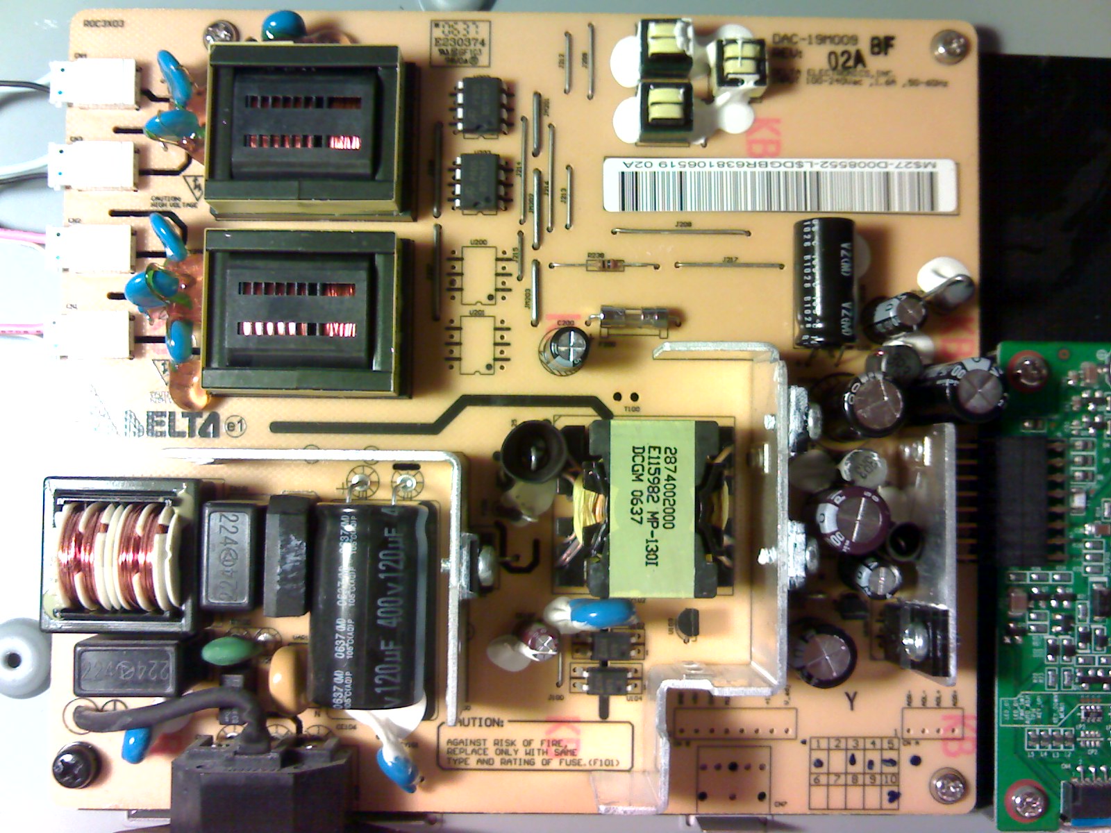

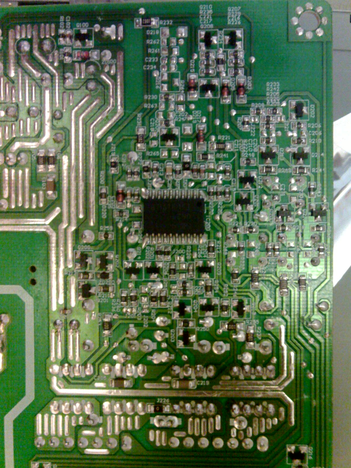

    3) I believe the Delta power supplies have several SMD fuses underneath the board. Check around and look.

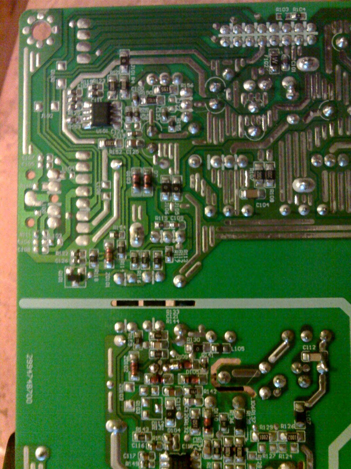

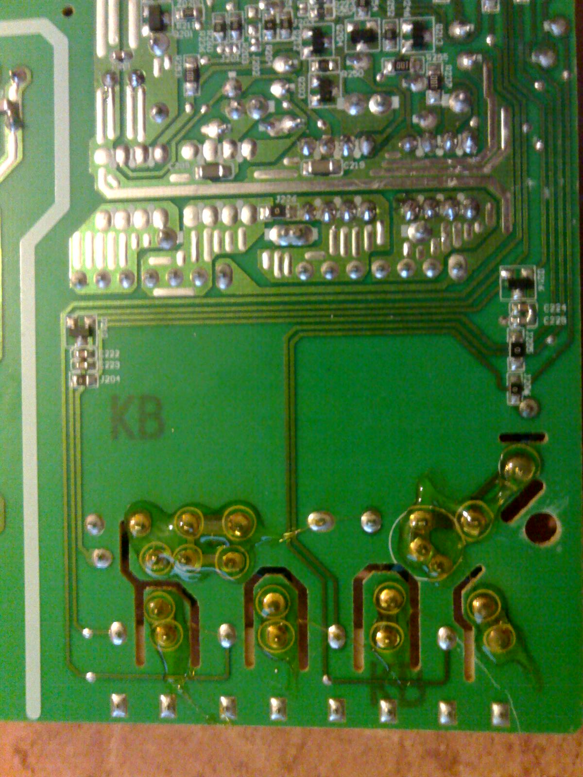

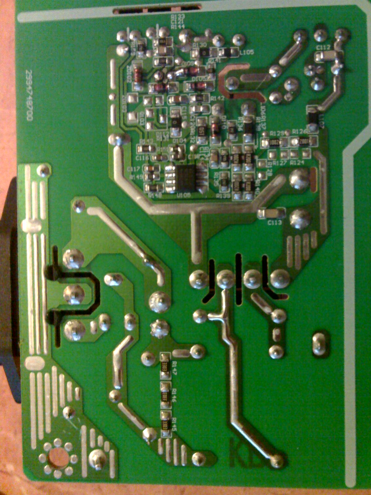

    4) Post a photo of the bottom of the power board.
    5) Do you get any activity from the power light?

        The little cap next to the blue cap near the transformer. Start up cap.
        IIRC 22uF @ 50v. Panny FM or FC.

          Firstly thank you to all who have tried to help. I will try and answer all the questions, and recommendations you gave have given me. Here are my responses.
          1) I'm not sure, but there are two voltages going to the other main board, Two +5V pins, and a +13.8V pin. I may have shorted them out togther or one of them to another pin beside it. I had replaced the F102 fuse which was underneath the board and have reverified that it's okay and the voltages are reading good.
          2) Yes.
          3) Once again I can only seem to find the F102 fuse. The other fuses F100, F101 and F200 that are on the top of the board are also okay.
          4) Check.
          5) No Power LED activity.

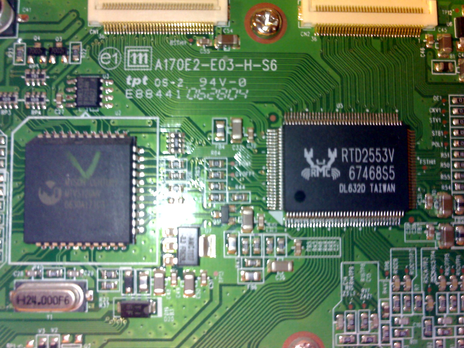

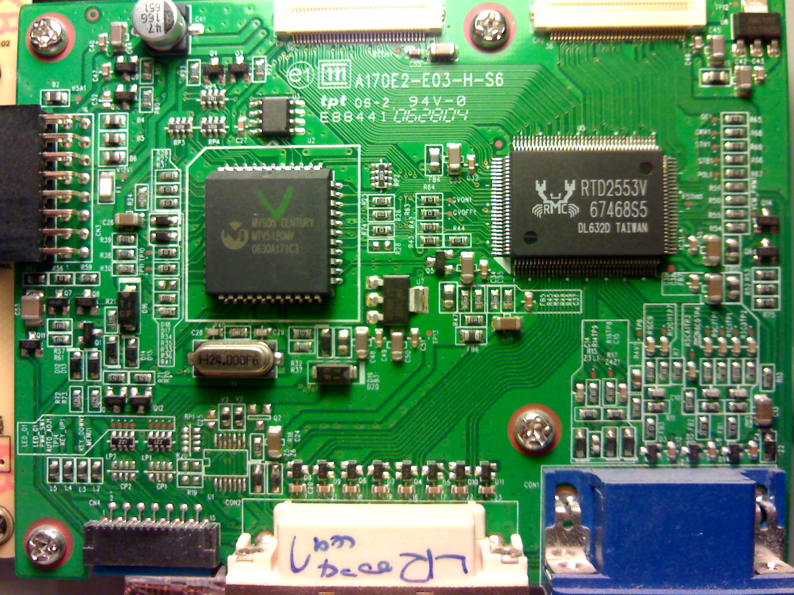

                    It very well could be a bad logic card. Before replacing it, here are some points to check.
                    F1 (left side near the connector to the power supply) Check the resistance.
                    U6 (upper left corner) What is the part number? Check the voltage on the three legs (the tab is connected to the middle pin). Use the mounting screw near the top center as ground.
                    U7 (middle of board) Same steps as U6, but voltage may be different.

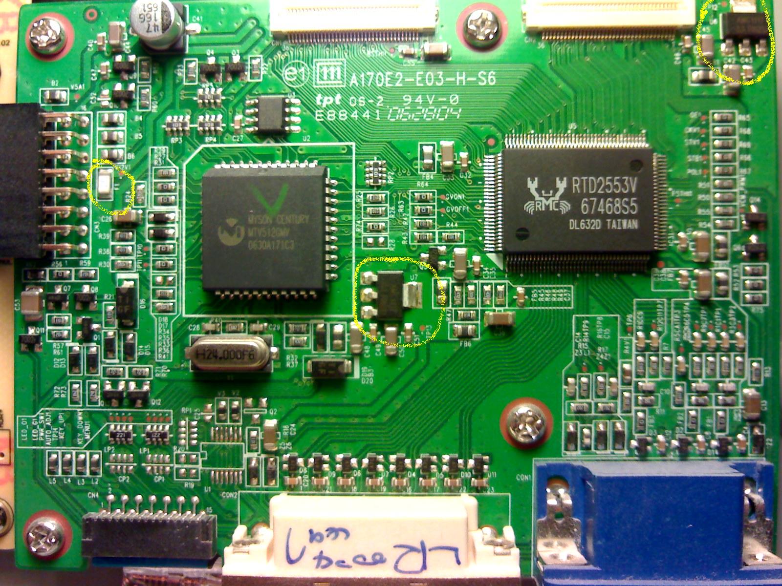

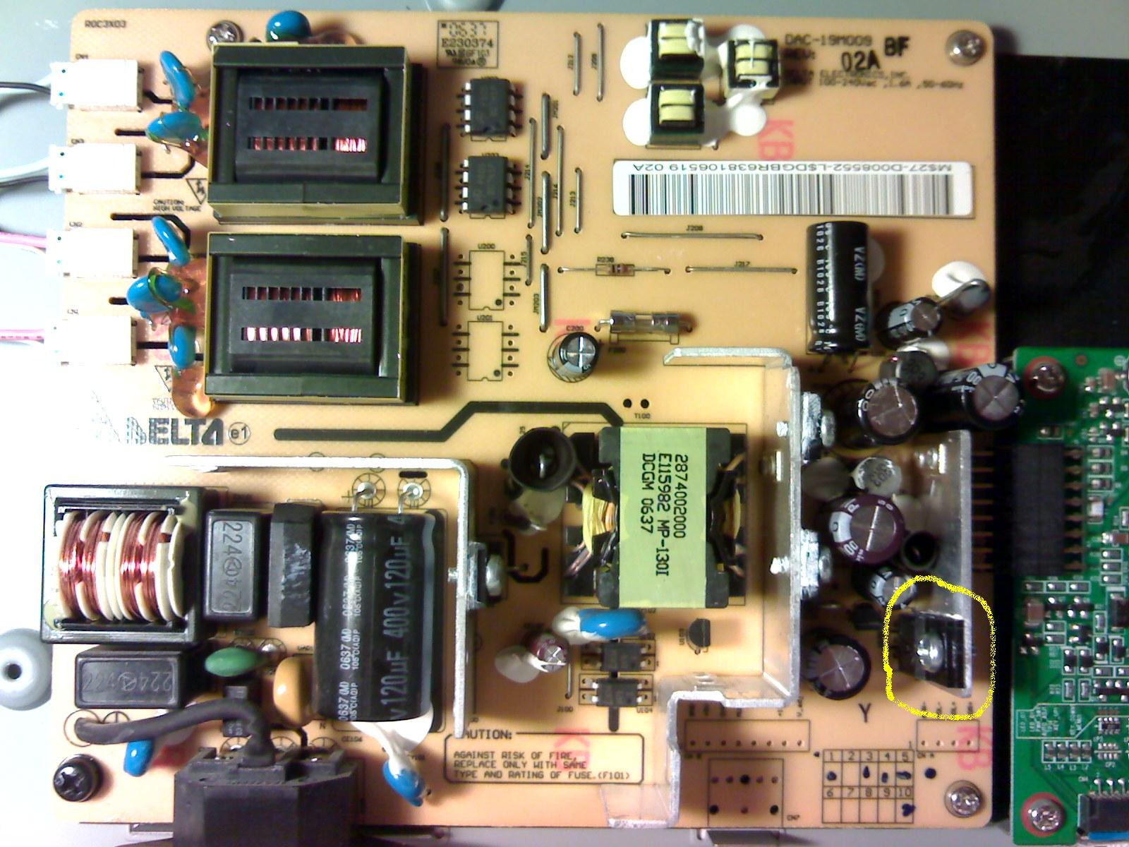

                      • jetadm123
                        • 2169
                        Re: Chimei CMV 221D - doesn't power on

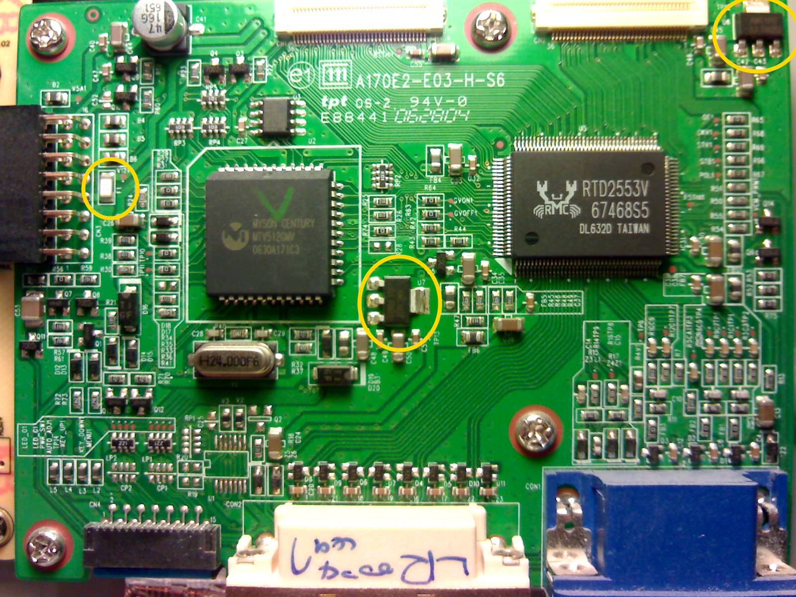

                        Can you provide the part number of the device circled in yellow?
                        • funkster
                          • Nov 2009
                          • 62
                          PlainBill
                          F1, U6, U7
                          I can't seem to find these labels anywhere?
                          • funkster
                            • Nov 2009
                            • 62
                            Yes, from the top an down, "TIP122FP" "CCODL VW" "MAR 631" and then 2 logos "ST" & "e3" with a circle around it.
                            • jetadm123
                              • 2169
                              Originally posted by funkster
                              F1, U6, U7
                              Located on the logic card

                                • Toasty
                                  • Jul 2007
                                  • 4171
                                  See circled items in attached photo.
                                    Okay after realising that I was looking at the wrong board lol
                                    F1 checks out as a short, so that must be okay.
                                    U6 Part no. is "AMC1117" "-3.3 F0628J" The voltages from left to right pins are 0V, 3.27V, 4.99V.
                                    U7 Part no. is the same as U6, voltage readings from left to right pins are 0V, 2.41V, 4.77V.
                                    • PlainBill
                                      • Feb 2009
                                      • 7034
                                      Bingo!!! That's a winner. CAUTIOUSLY check it's temperature. It's output (the center pin) should be 3.3V. Either it's overloaded, or it's defective.
                                      PlainBill
                                      • funkster
                                        • Nov 2009
                                        • 62
                                        Is that some kind of regulator chip? If it wasn't defective would it still output 3.3V even though its getting 4.77V?
                                        edit: I don't have any kind of thermometer to measure its temp, although while I ground myself and touch both U6 & U7 to compare, U7 seems ever so slightly warmer.
                                        edit2: If I was to replace it with an equivalent from on of these: http://shop.ebay.com.au/i.html?LH_Av...1&_sop=2&_sc=1
                                        Is it likeley that it could be fixed? Or is it likely that other components are fried in that circuit as well?
