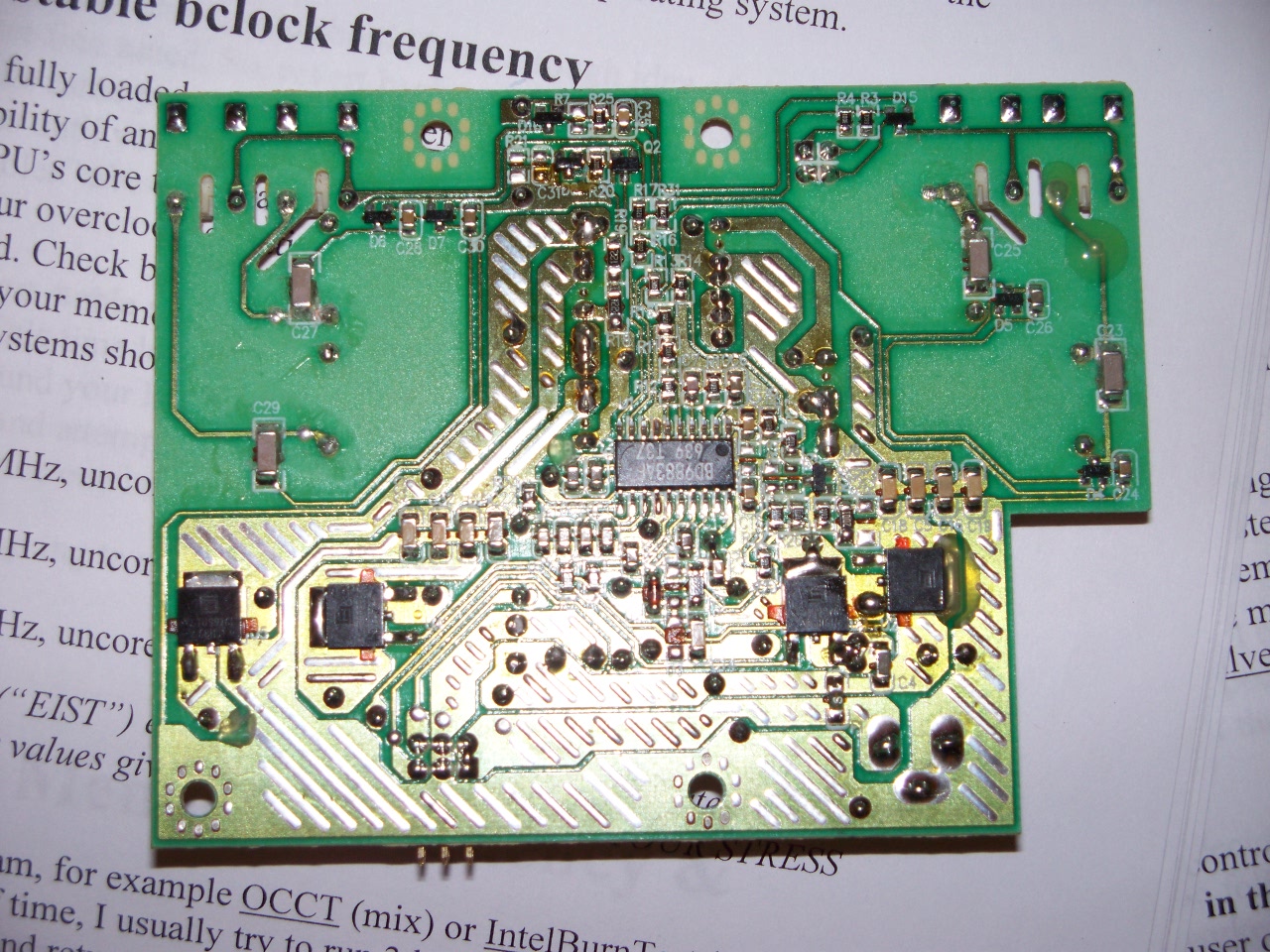

    Took it apart, and it had 3 popped 220uf 25V caps. I didn't have any on hand, so I put in 3 470uf 25V caps. It still has the same problem. Turns on for about 2-3 second, then shuts off the picture. Won't come back on unless you turn it off and then back on again.
    I'm wondering if it might be the transistors. It has 4 STU9916L transistors. http://www.alldatasheet.com/datashee.../STU9916L.html
    Or did I mess it up using too large of caps.
    Pics of the power board.

    Before you start looking at the transistors, you should take out the 470's and install 220's. Ahhhh, if it was only so easy as to replace caps with whatever we had in stock. You more than doubled the original capacitance, which is bound to cause problems (especially in the inverter section)!
        Test for shorts by measuring ohms "in circuit" between S-G, S-D, and G-D. Any ohms reading below 30 ohms suggests a bad transistor.
                  Most were well into the K-ohm range, and none under 100.

                  Secondaries were all 720 ohm, give or take 3 ohms.

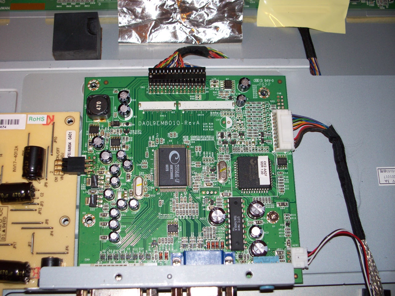

                          Ok, the caps arrived today. Swapped them out and tried the monitor. Lights go out but the graphics are visible when examined closely.
                          Tried each individual lamp. The lamps go out after about 1-2 seconds. However the one plugged into CN5 is dimmer/redder than the rest. Plugging that lamp into CN4 results in the same dim/red light. Plugging the lamp that goes into CN4 into CN5 results in normal brightness/color.
                          Left to my own devices, I'd try pulling the lamp and looking at it to see if there might be anything I could fix (broken, damaged wires, etc..). If I didn't see anything, I've got 2 Dell monitors that I can probably pull a lamp from and try using that in place of the dim one to see if that will let it stay on. If that doesn't fix it, I'm not sure where to go from there. Any other things I should try as well?
                            A pink or redish hue is an indication that the ccfl is dying. As it ages, it draws more and more power.

                              The reddish/pinkish color is a sign that the lamp is failing. You're on the right track with using a lamp from your dell for testing. Good work so far.

                                Thanks for the tip! Saved me some time. I was able to get it connected, and the other 3 lights stayed on with the 1 lamp from the Dell monitor plugged in. I'm going to pull the bad lamp now.
