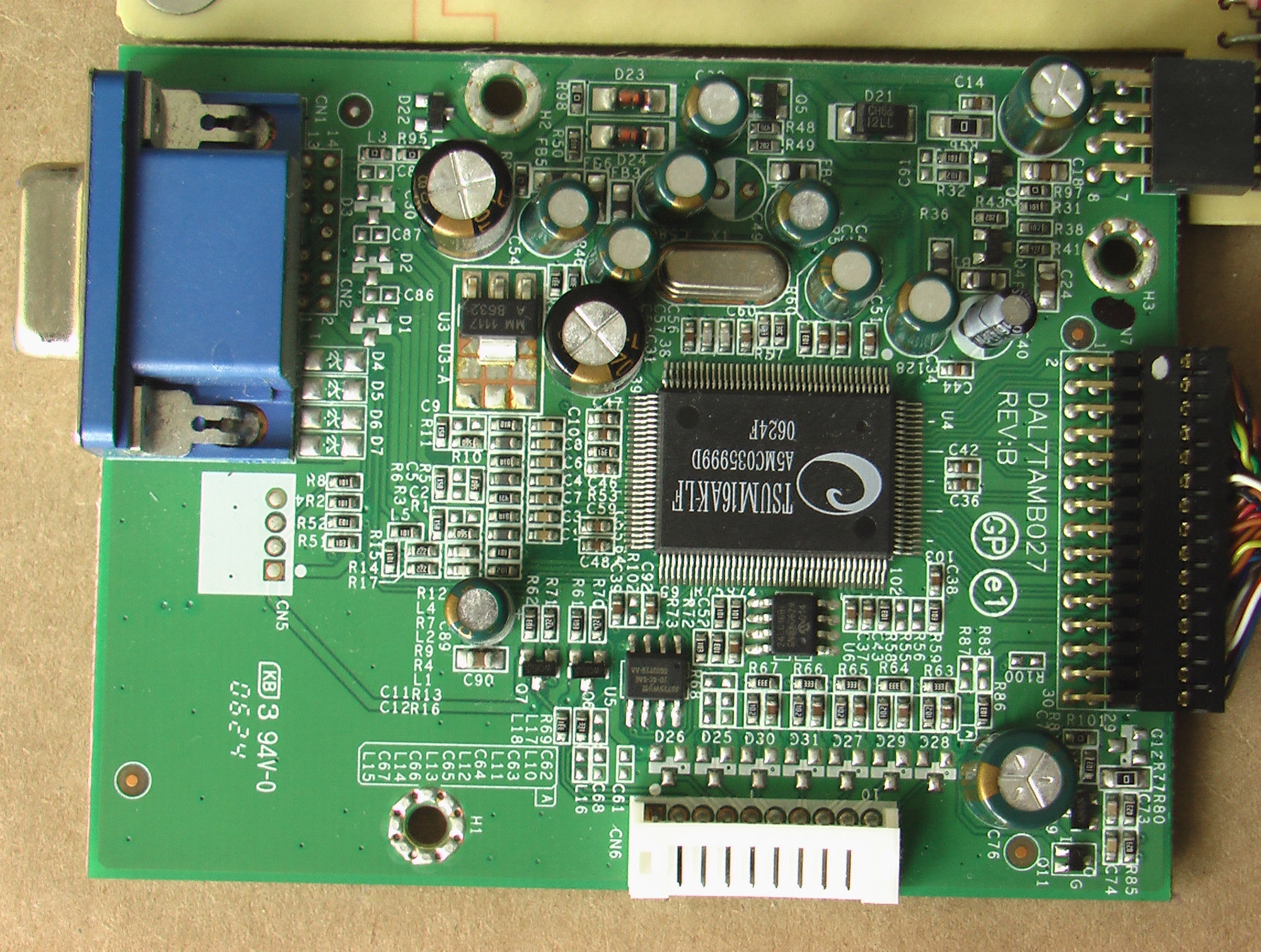

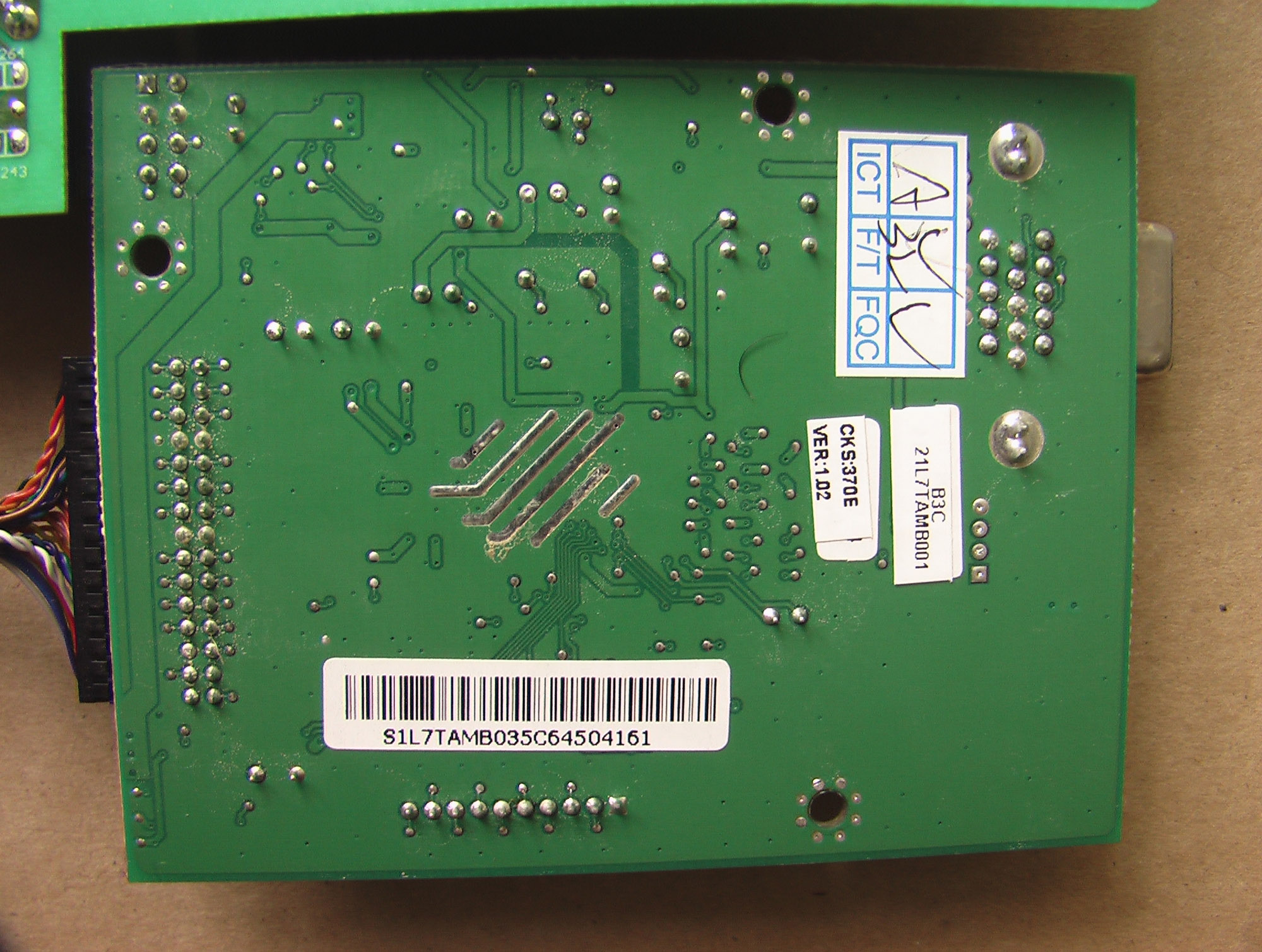

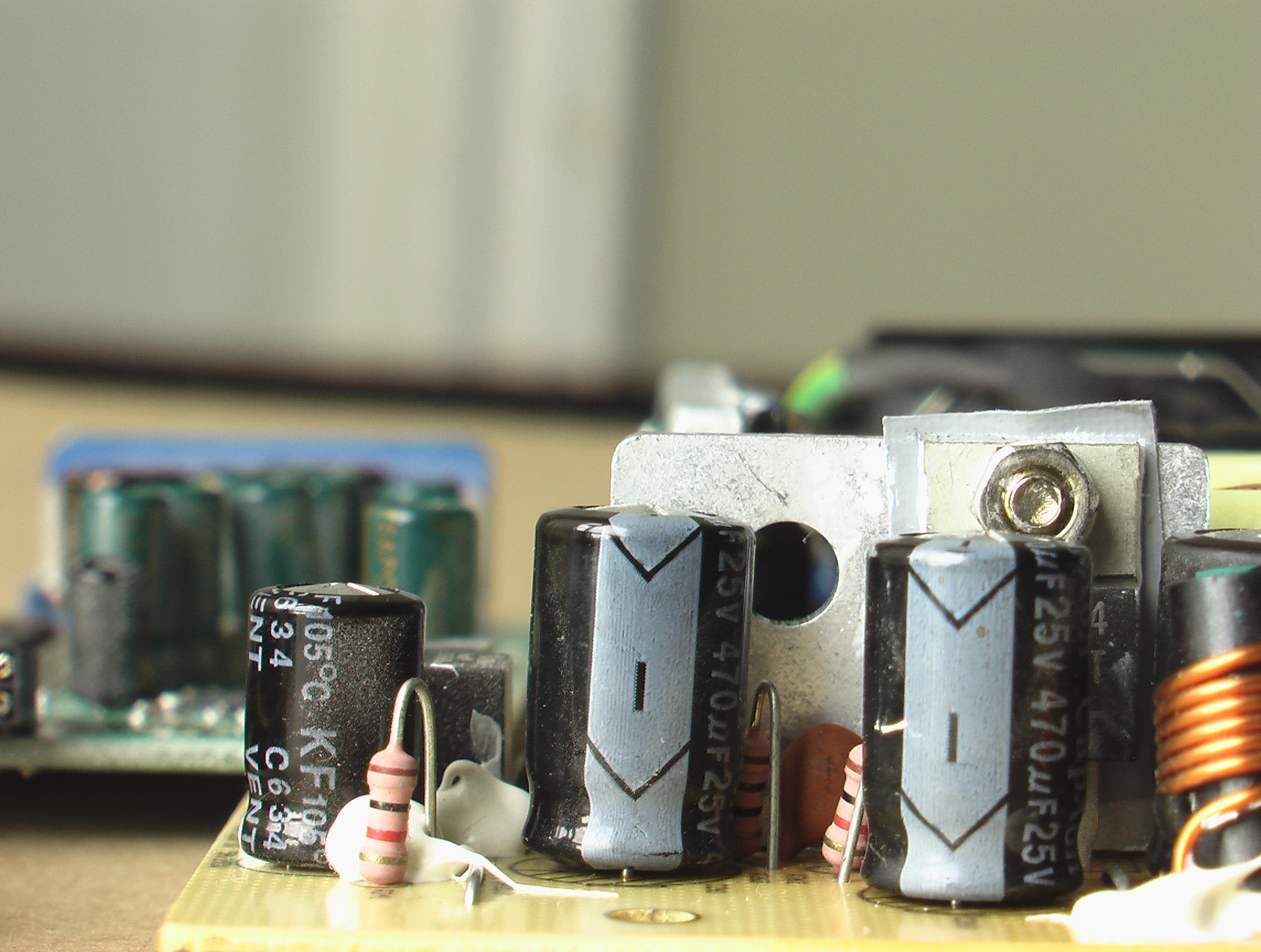

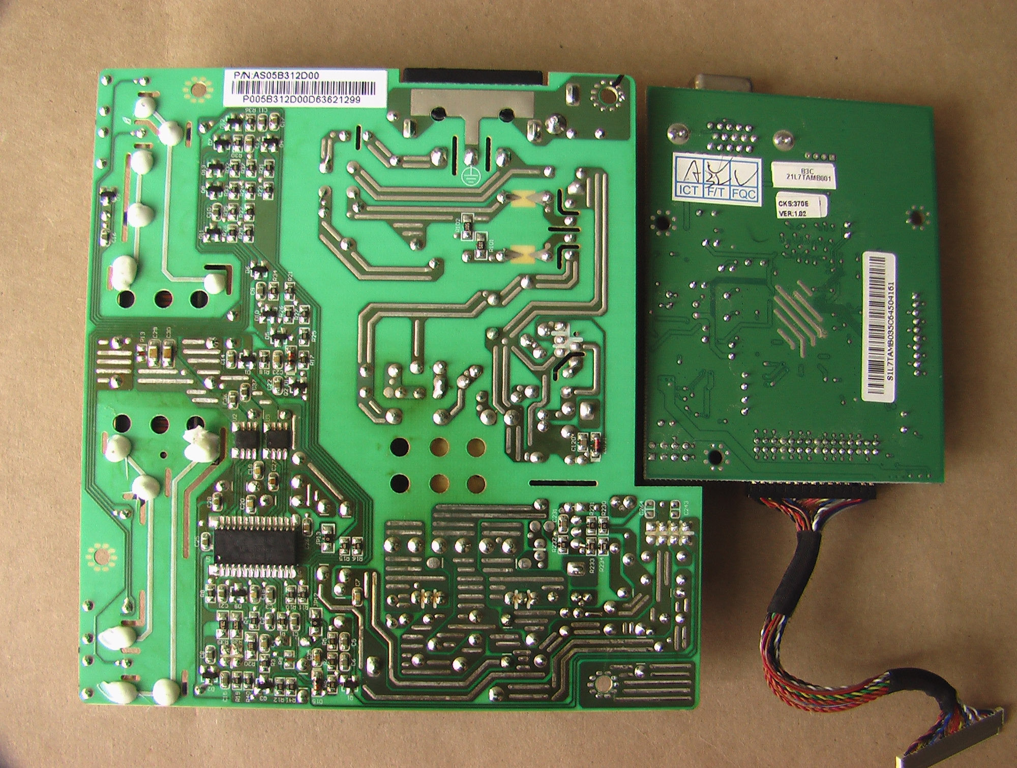

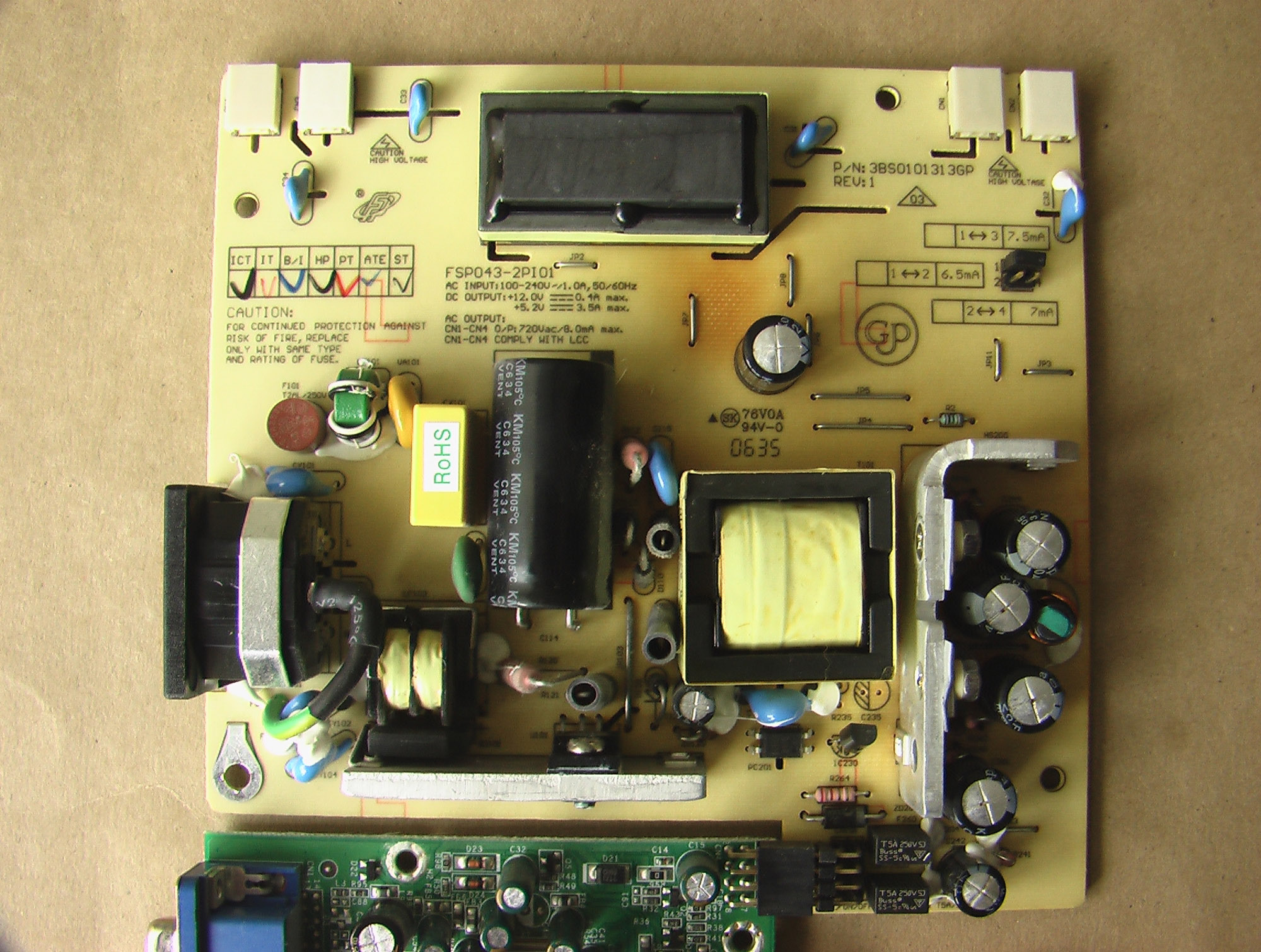

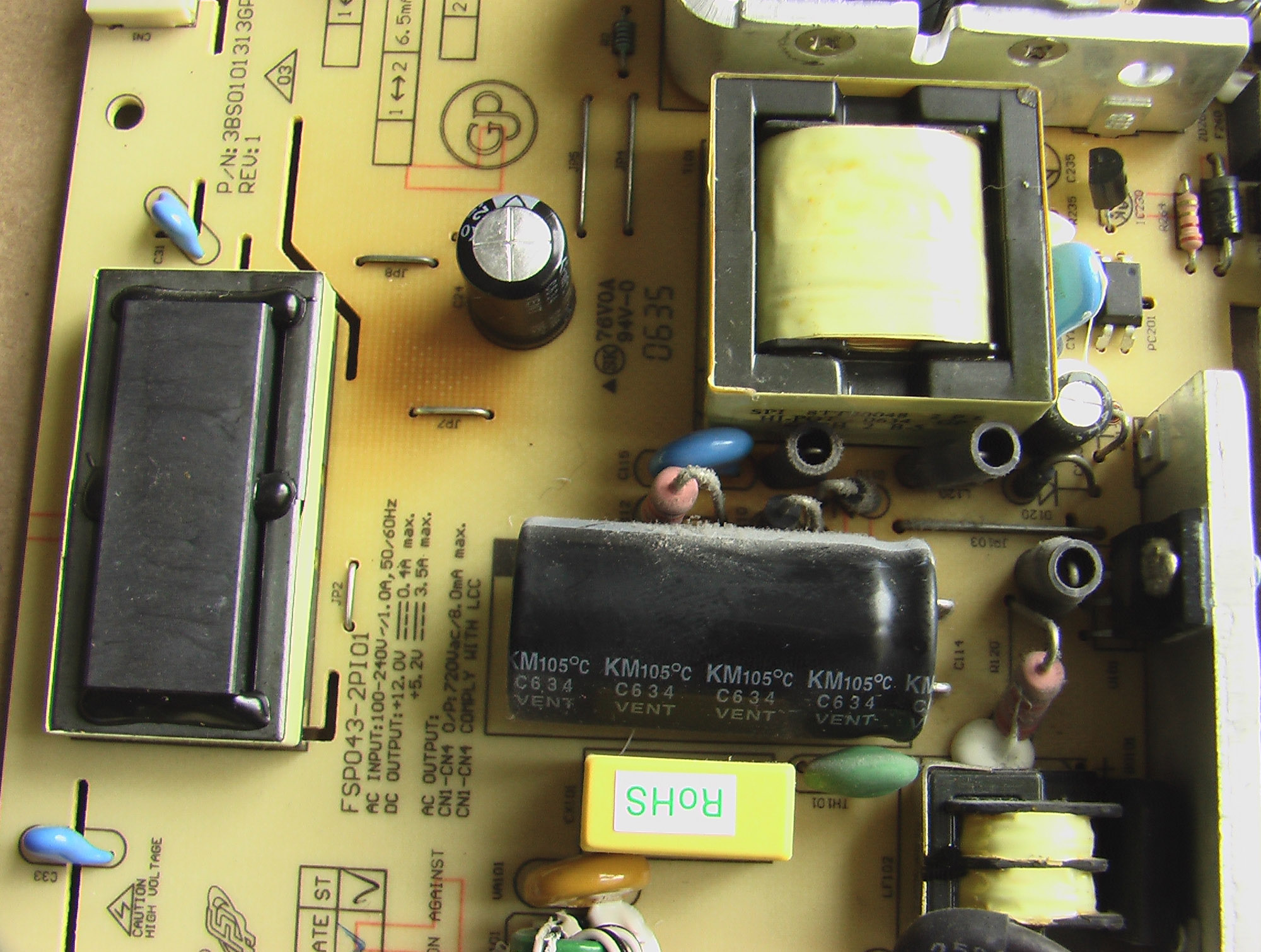

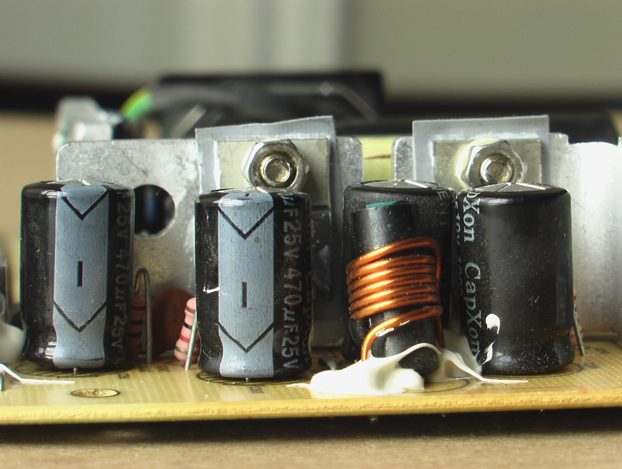

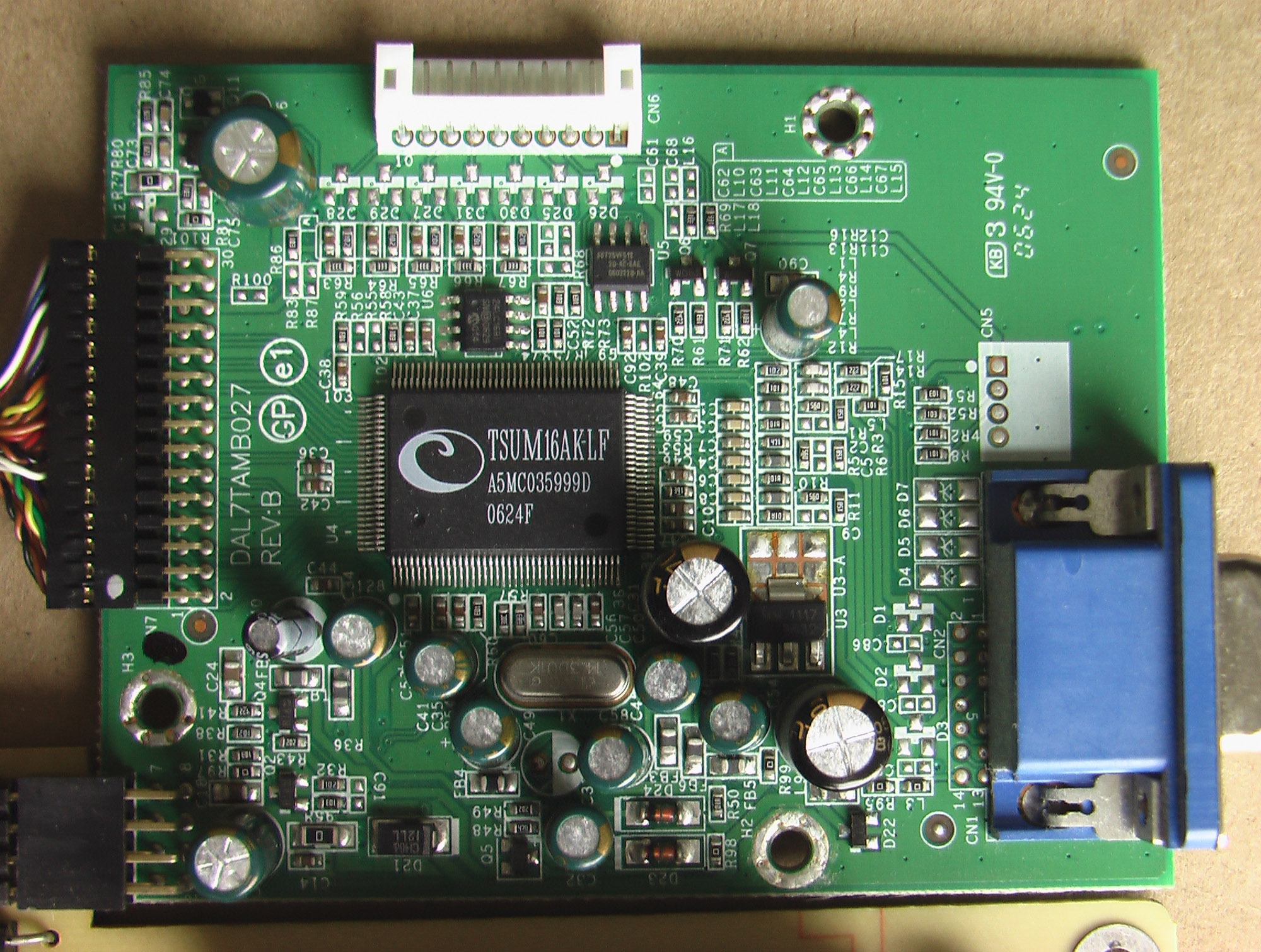

    Hi All,
    I have an Acer 1916B with the "no picture, Blinking power light" syndrome. I have minimal electronics/home electric experience (from high school one of my best courses), a craftsman 81079 dvm, and have been shocked before by home, electronics, and automotive. I am not afraid to try and fix this thing, if I can. Any help in this or any regards would be greatly appreciated. I have attached some photos, hopefully not to many.

    I did 2 of these a while ago.
    I'd replace all of the electrolytic caps (except the big one) on the power supply/inverter board to start.
    Use good quality Low esr caps (Panasonic FM are my favourite, but if I remember correctly I needed FCs for one, as the FMs were too tall, so check the specs before ordering.
    Ahh yes, looking at this thread: https://www.badcaps.net/forum/showthread.php?t=11877
    It was the 470@25 FMs that were too tall.

            Re: Acer 1916B no picture, Blinking power light
            Nice pics! And nice tutorial on the wonders of Digikey....especially the cheap USPS postage. I get my orders in less than 5 days and use the Panasonic FM types whenever size allows. I've also laid them down on their side if there's room and I don't have quite the right size...watch out for nearby conductors though and fouling the cooling of the board.
            You should be up in no time after re-capping, as the logic board looks okay (wait 'till it won't work then I'll be sorry I said that)!

              Hi all, that replied with the wonderful advice and suggestions.
              Special thanks to this forum as well.
              The monitor now works after replacing all the caps on the power board.
              How can I officially thank those who helped me personally here?
