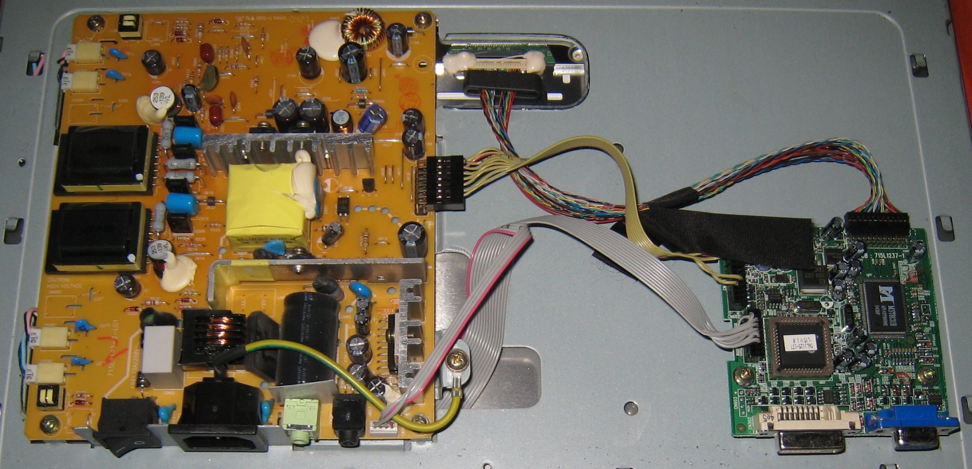

    I have an Iiyama ProLite E481S (Model name PLE481S-S1S) flat screen connected to my laptop using a VGA cable. The screen has been working fine for 3 years. Now it fails.
    Everytime I switch the flat screen on, it goes dark after a second. The power LED, however, stays on (constantly blue, not flashing) all the time.
    This posting contains 12 MB of photos to give you as much (zoomable) information as possible. Please wait for them to load and resize automatically (somehow they start loading in fullsize to be resized after a few seconds) to make your reading easier.
    The flat screen was tested using two different laptops to rule out problems originating from the laptop.
    The screen comes back to life for one second when I

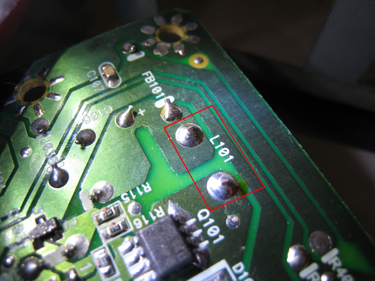

    But as you can see from the pictures below, the L101 and C905 joints look fine on my screen.

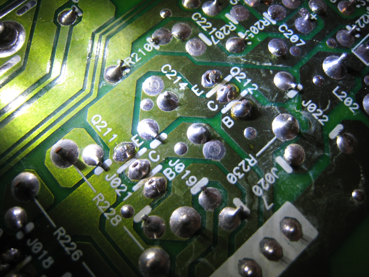

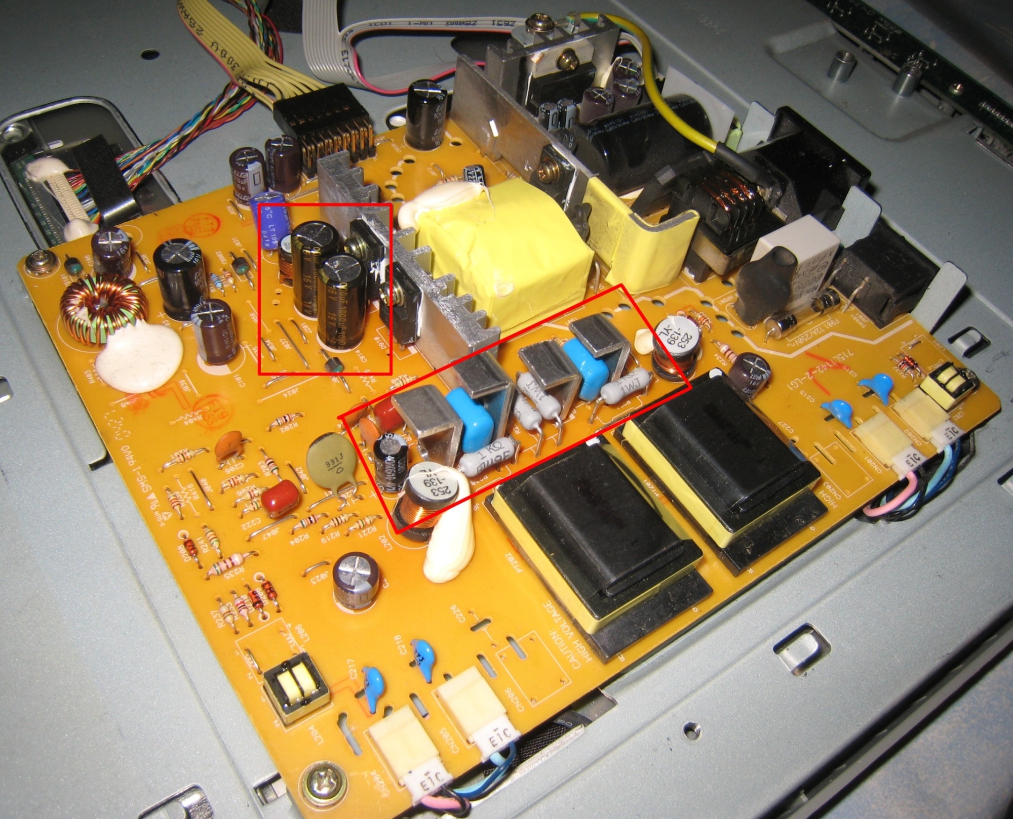

    This is what the flat screen mainboard looked like before I started changing components:

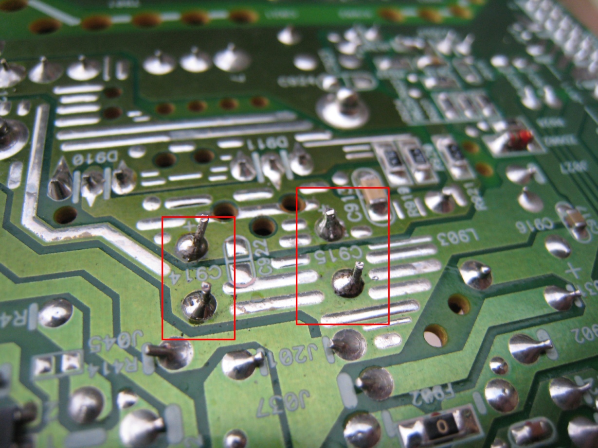

    I changed the following components:
    - two capacitors: C914, C915 (is now Panasonic EEUFM1C102)
    - four transistors: Q209, Q210, Q211, Q212 (was D1691, is now C5707)
    Note that the two capacitors did not look damaged. I changed them anyway, just to be sure.
    A brownish color can be seen where the old transistors were soldered on the main board. That color had already been there when I opened the screen
    for the first time, so it must have accumulated in the 3 years of operation.
    The new transistors were smaller than the old ones so I added some metal heat sinks to each transistor for improved heat dissipation. The heat sinks are fixed to the transistors by heat-resistant glue drops in each corner and there is a fine layer of thermal heat sink paste between the heat sinks and the transistors.
    Their soldered joints look not nearly as neat as the capacitor's joints. I measured them and there is a working contact from the transistor pins to the PCB, though.
    This is what the mainboard looks like now:

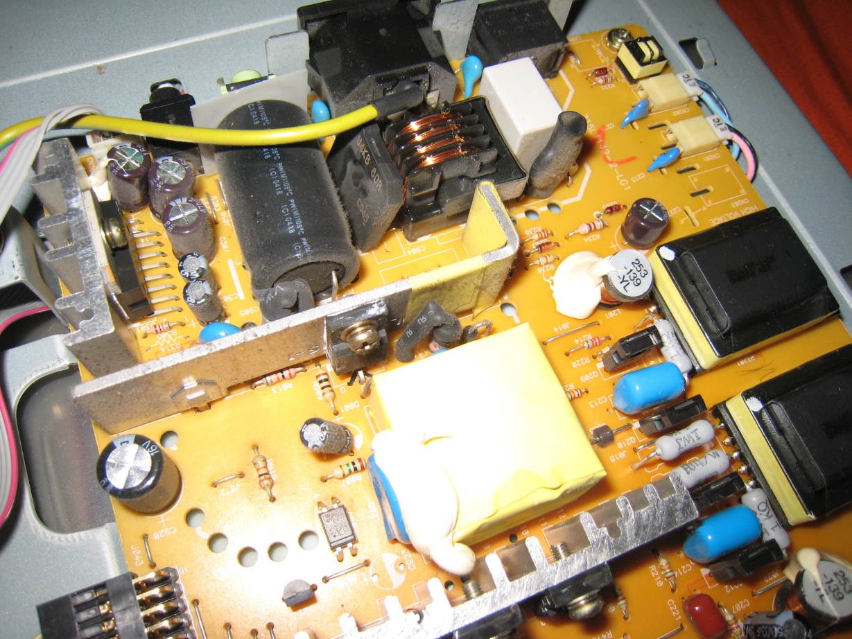

            Attached: Photos after I changed the two capacitors and the four transistors.

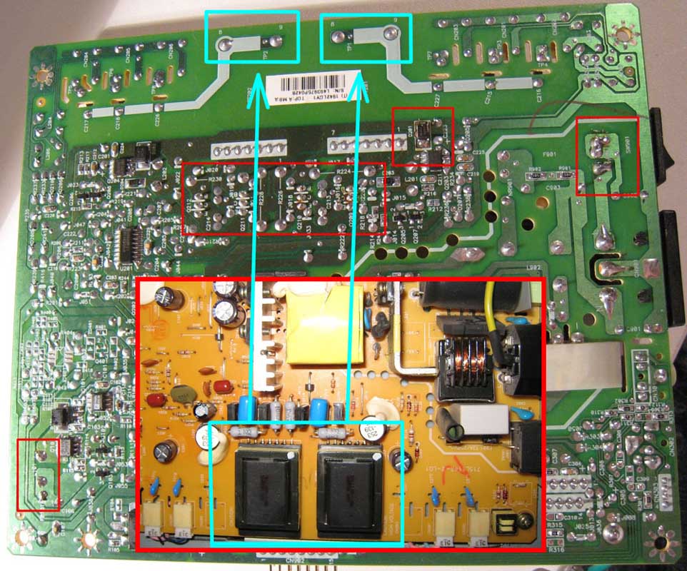

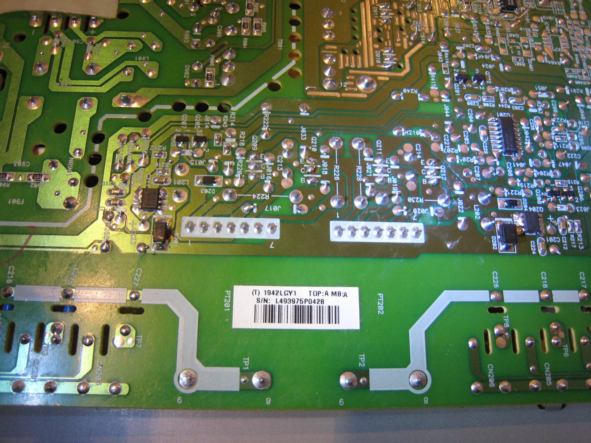

              Sorry for the late reply, haven't logged in a few days.
              Originally posted by Neon
              And regarding your proposal of measuring the inverter transformer resistances: where is that? The pink and light blue connectors to the left on the "both boards before" photo?

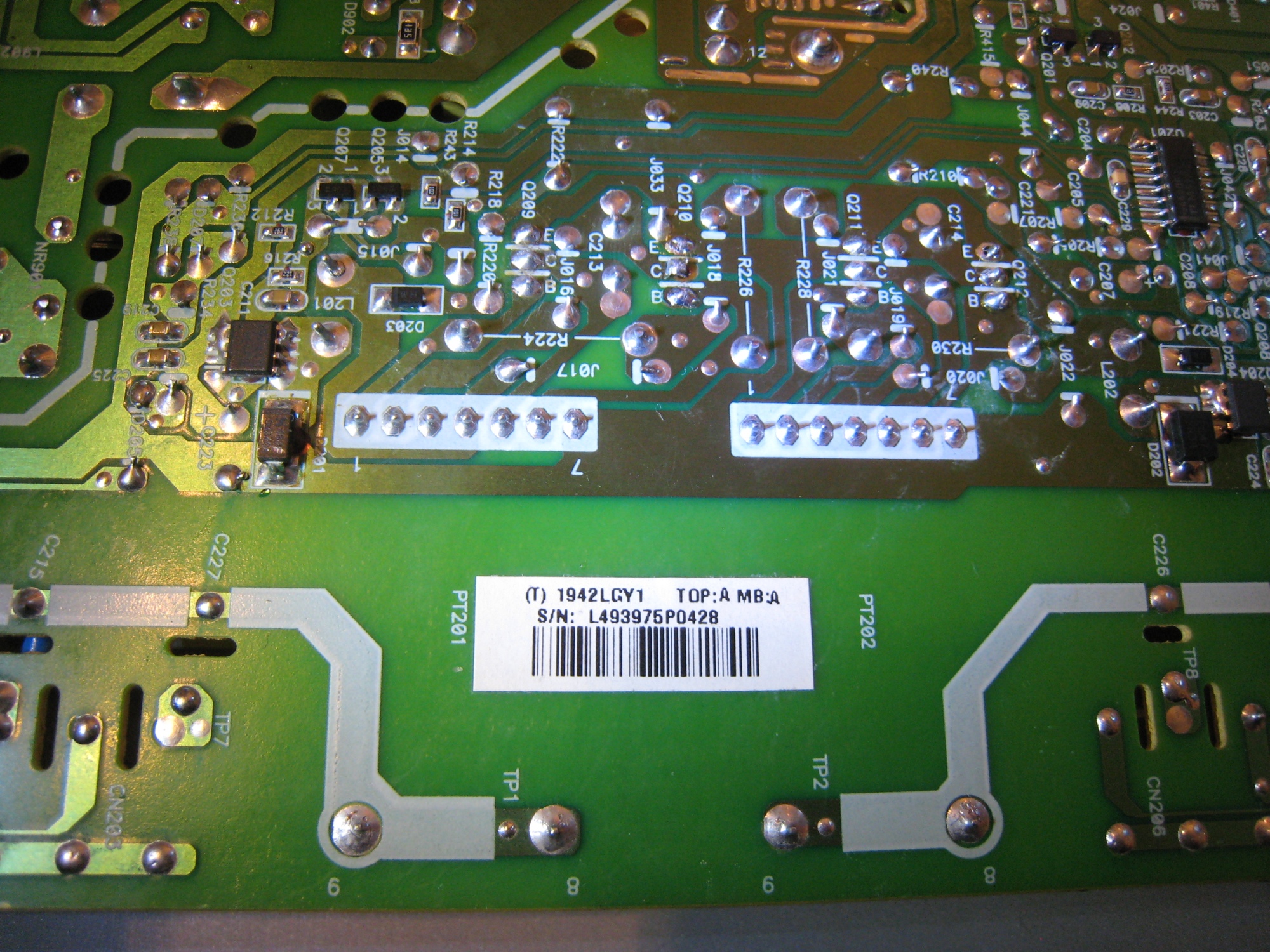

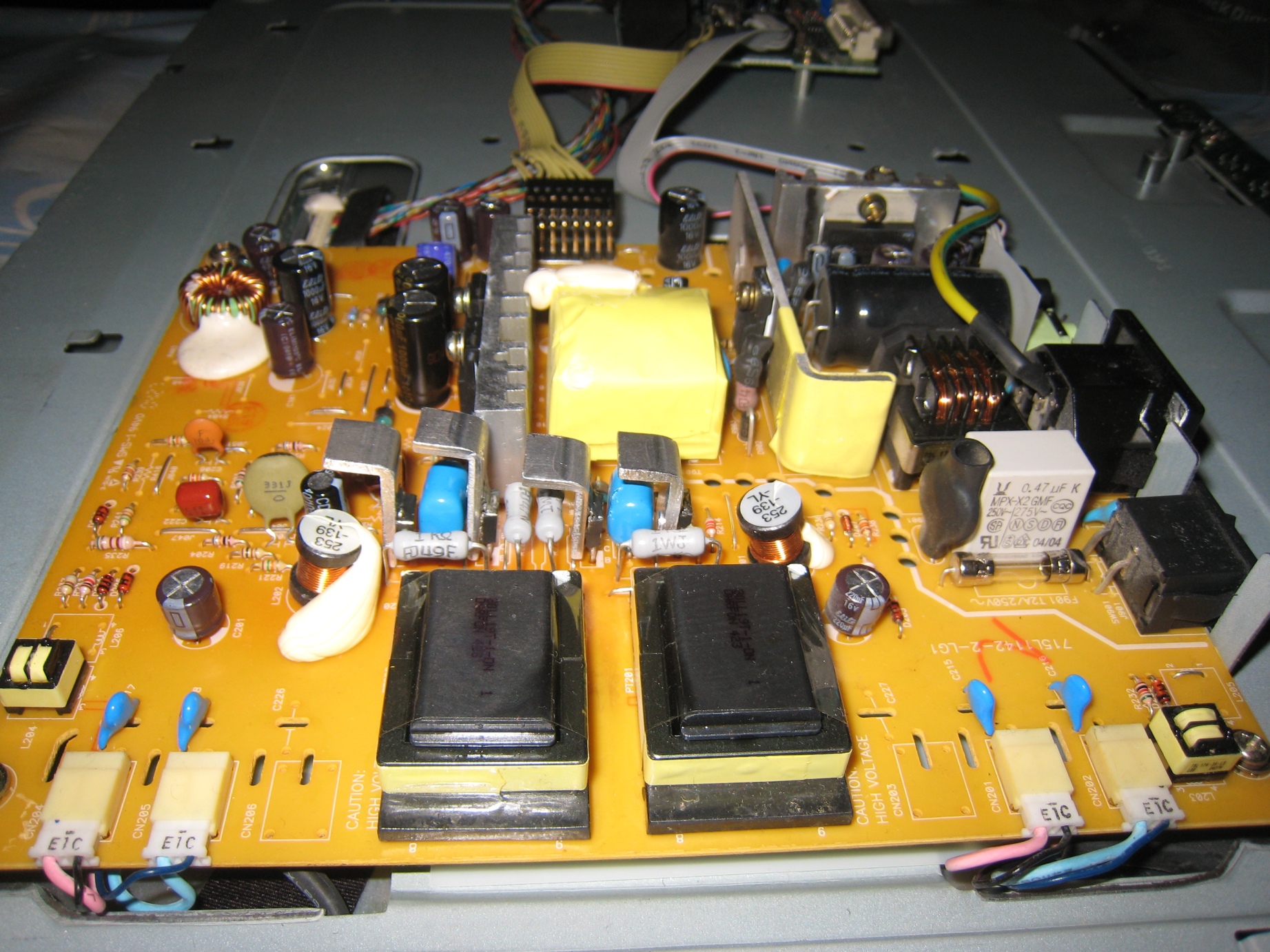

              I attached a picture with the two inverter transformers circled in cyan. With the monitor off and unplugged, use your multimeter to measure the resistance between pins 8 and 9 of each inverter transformer (again circled in cyan at the top of the picture). See what resistances you get and report back. Should be very roughly around 1000 ohms for both.
              Premium supporters get full download access and other benefits.
              • Neon
                • Nov 2010
                • 38
                Re: Iiyama Prolite E481S goes dark after 1 second, blue power LED steady on
                Thanks for the explanation.
                I measured the resistance between pin 8 and 9 of TP1: 0 (zero) ohms. Same for TP2.
                Just to make sure my DMM is working, I checked a resistor of known resistance (510 ohms) from my collection, and the DMM works fine.
                What does that mean?

                  That means that the DMM is working and you know how to use it. This transformer uses a slightly different design than most we see.
                  On TP1, measure the resistance between pin 8 and pins 1 through 7. I expect that you will find that one of them (possibly pin 7) will give a reading of around 1K. Then measure the resistance between the same two pins on TP2.
                  If you find that ALL pins on TP1 show a resistance of more than 2K to pin 8, then move on to TP2 and repeat.

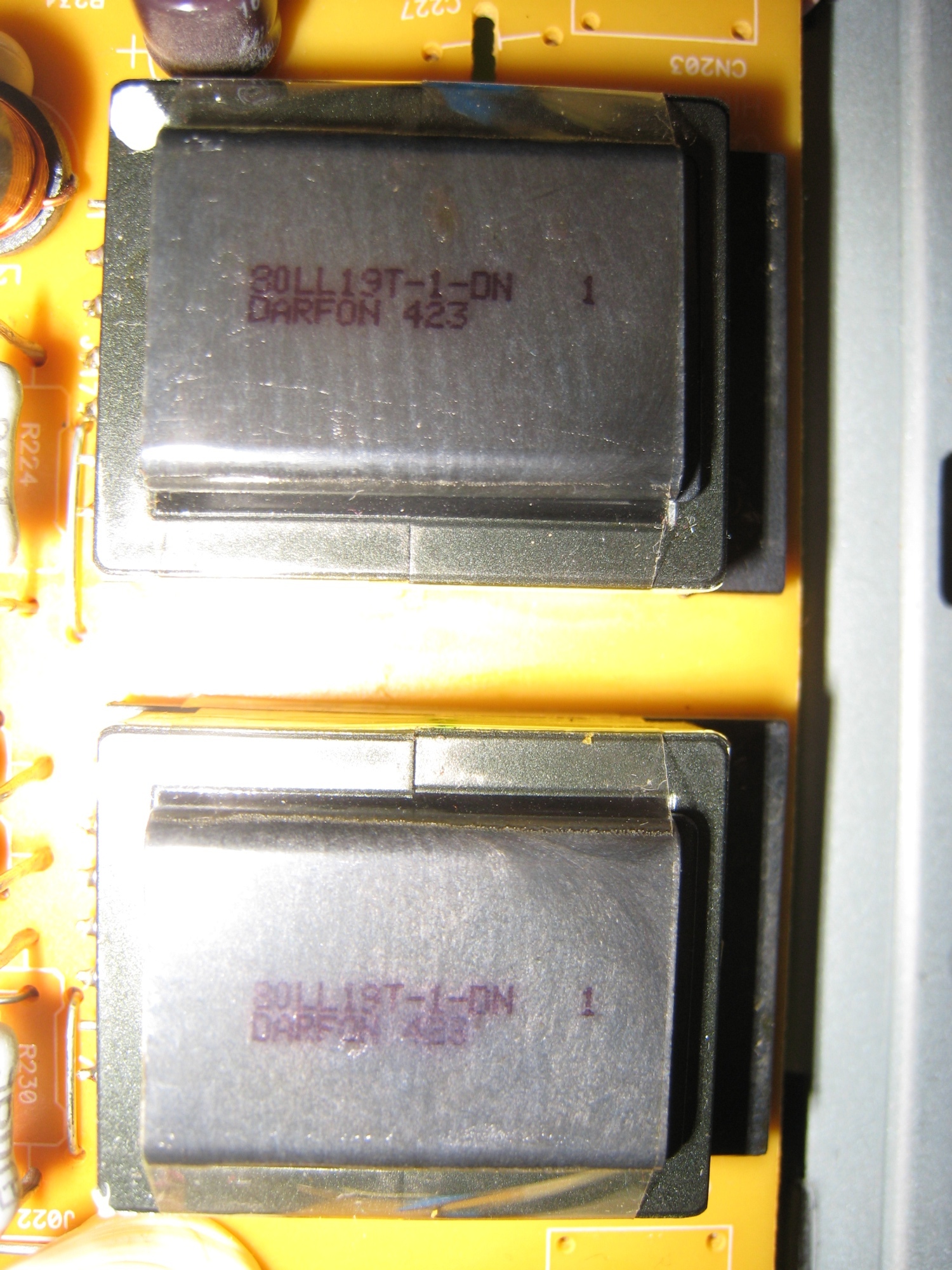

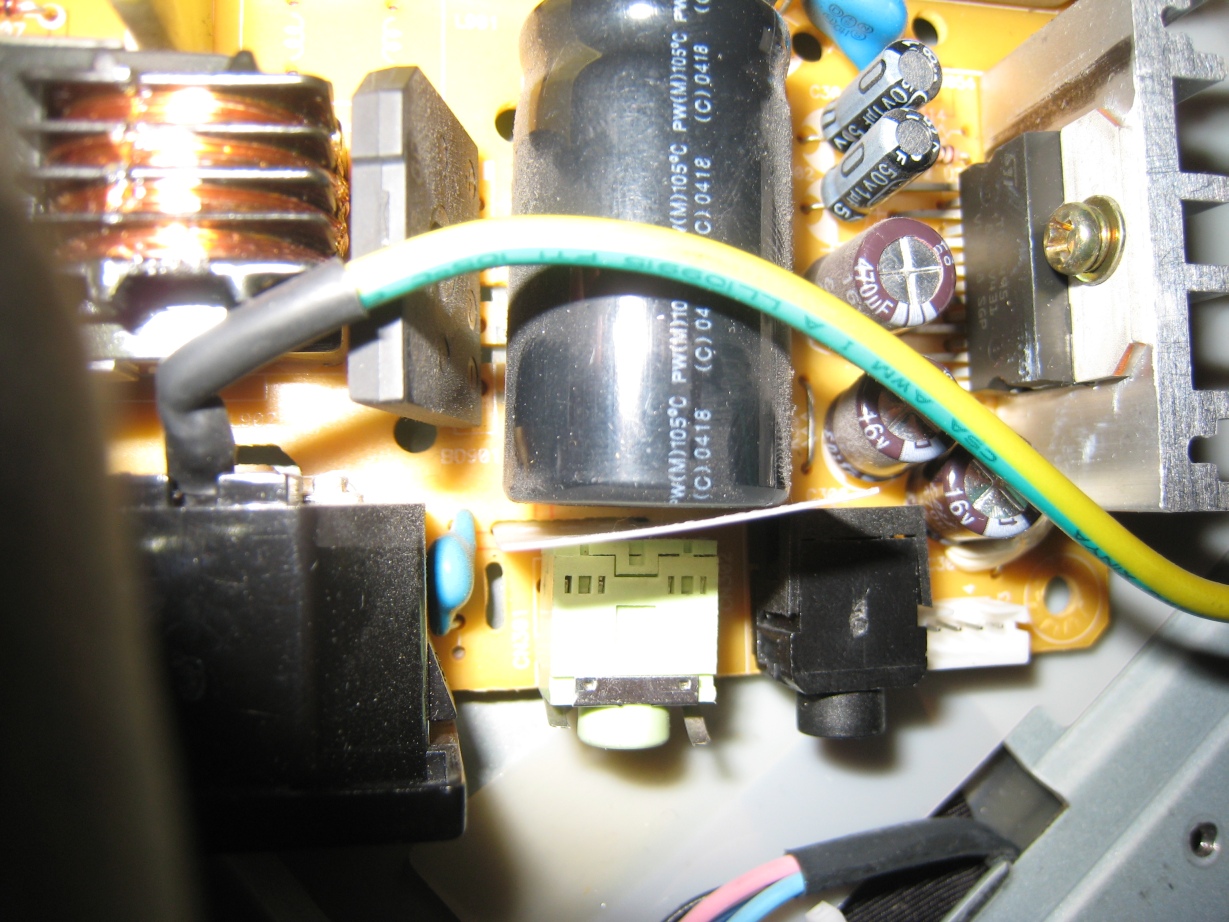

                        Both inverters are marked
                        80LL19T-1-DN 1
                        DARFON 423

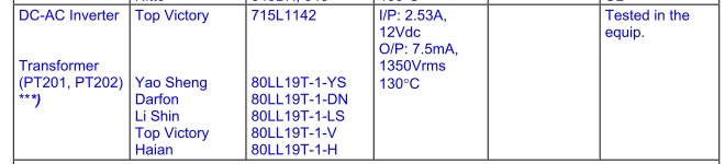

                        I can't locate a datasheet of any "80LL19T" on the internet.
                        What I've found is this PDF containing the info in the attached picture #2, and a person from Poland who managed to get a replacement (though his board looks a little worse than mine)
                        I attached two more pictures of the area around the transformers.

                          Technically those are inverter TRANSFORMERS, not inverters. I am of the opinion that they are fine. I would check diodes D201, D202, D203, D204 for shorts.

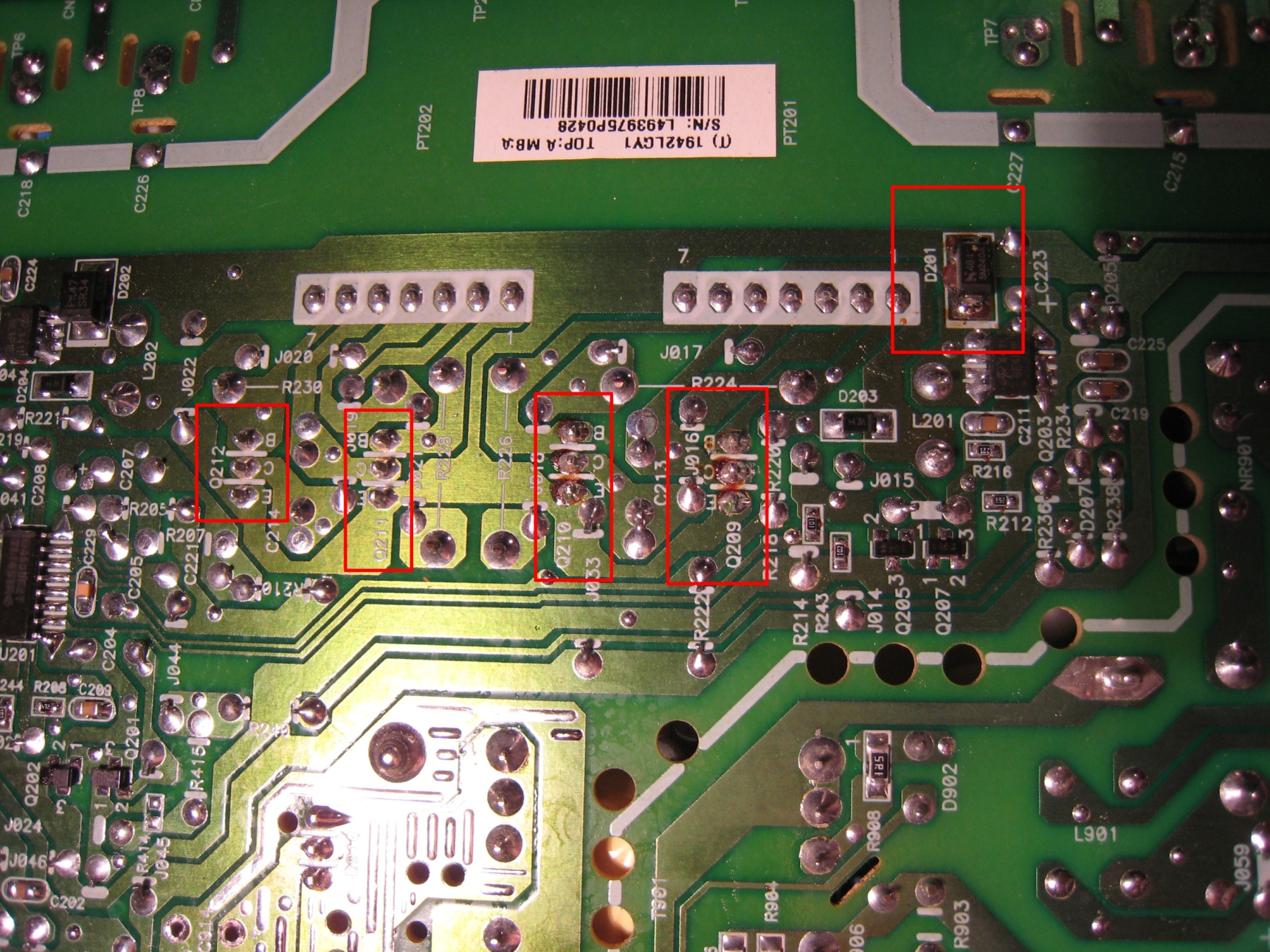

                          • alexanna
                            • Mar 2010
                            • 1346
                            • computor monitors

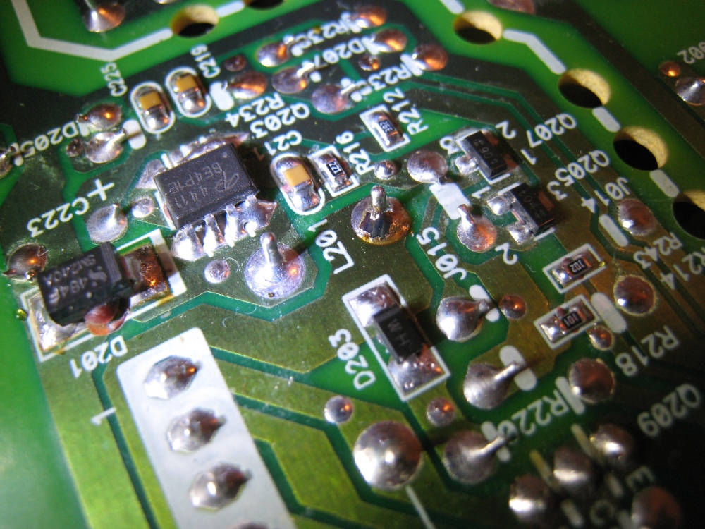

                            The solder joint on L201 looks like it could use some touch up.
                            Al.

                                  It's back to life! The slightly cracked solder joint on L201 was the problem, I resoldered it (pic attached) and now the screen works fine again!
                                  Thanks a lot alexanna for finding it and pointing it out to me! And thanks to all other helpers, too!

                                    I actually did some cheating; I was really board with all the wife's school teacher sisters here.
                                    I searched the net and there was some discussions about poor solder joints on the PS/inverter, so
                                    I looked at your pictures a little closer and L201 looked funny.
                                    In the future on pictures, a good overall shot straight down would be best.
