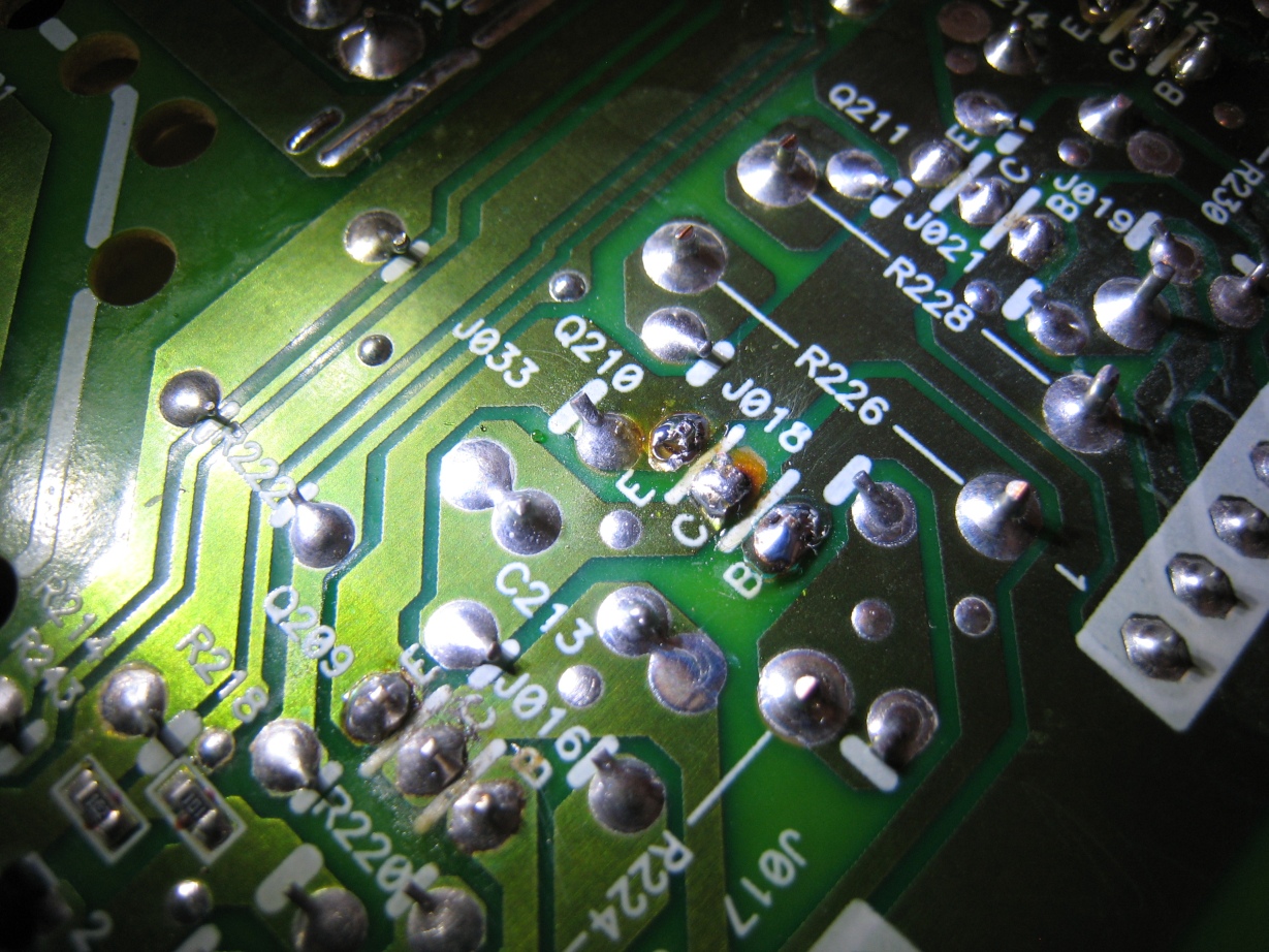

    But as you can see from the pictures below, the L101 and C905 joints look fine on my screen.

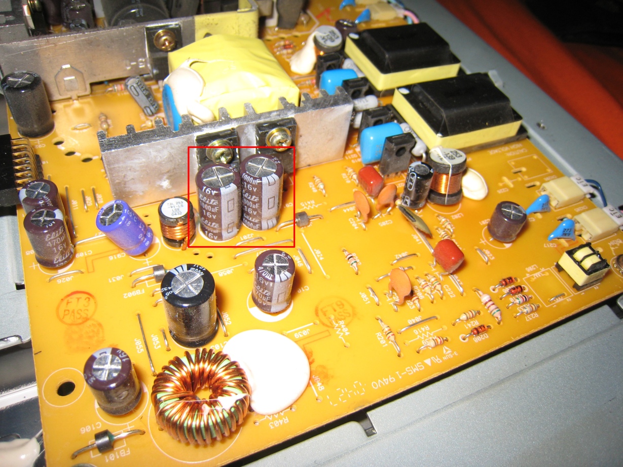

    This is what the flat screen mainboard looked like before I started changing components:
    I changed the following components:
    - two capacitors: C914, C915 (is now Panasonic EEUFM1C102)
    - four transistors: Q209, Q210, Q211, Q212 (was D1691, is now C5707)
    Note that the two capacitors did not look damaged. I changed them anyway, just to be sure.
    A brownish color can be seen where the old transistors were soldered on the main board. That color had already been there when I opened the screen
    for the first time, so it must have accumulated in the 3 years of operation.
    The new transistors were smaller than the old ones so I added some metal heat sinks to each transistor for improved heat dissipation. The heat sinks are fixed to the transistors by heat-resistant glue drops in each corner and there is a fine layer of thermal heat sink paste between the heat sinks and the transistors.
    Their soldered joints look not nearly as neat as the capacitor's joints. I measured them and there is a working contact from the transistor pins to the PCB, though.
    This is what the mainboard looks like now:

              I attached a picture with the two inverter transformers circled in cyan. With the monitor off and unplugged, use your multimeter to measure the resistance between pins 8 and 9 of each inverter transformer (again circled in cyan at the top of the picture). See what resistances you get and report back. Should be very roughly around 1000 ohms for both.

                        Both inverters are marked
                        80LL19T-1-DN 1
                        DARFON 423
                        I can't locate a datasheet of any "80LL19T" on the internet.
                        What I've found is this PDF containing the info in the attached picture #2, and a person from Poland who managed to get a replacement (though his board looks a little worse than mine)
                        I attached two more pictures of the area around the transformers.

                            The solder joint on L201 looks like it could use some touch up.
                            Al.

                                  It's back to life! The slightly cracked solder joint on L201 was the problem, I resoldered it (pic attached) and now the screen works fine again!
                                  Thanks a lot alexanna for finding it and pointing it out to me! And thanks to all other helpers, too!

                                    I searched the net and there was some discussions about poor solder joints on the PS/inverter, so
                                    I looked at your pictures a little closer and L201 looked funny.
                                    In the future on pictures, a good overall shot straight down would be best.
                                    Al.
