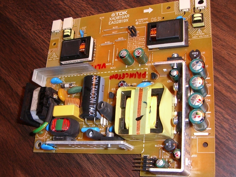

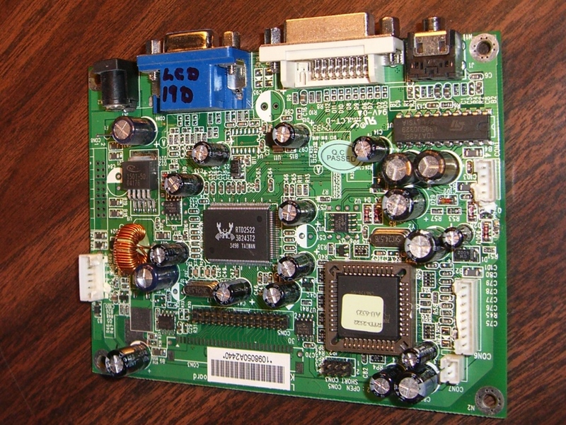

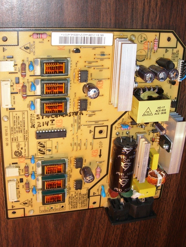

    I have three monitors, one Samsung SynchMaster 214T and two Princetons, a LCD19D and a VL1919, on the desk to recap and I would appreciate a review of my choice of replacement caps. Except for three caps I desoldered in order to read the markings I have left all the old caps in place until I have the replacements in hand.

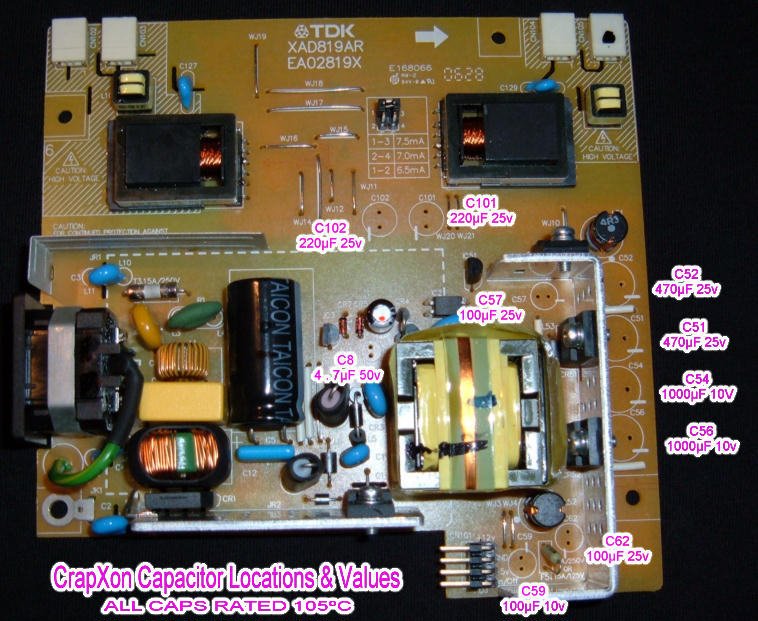

    Here are the caps I will replace followed by my choice for replacements from Digikey. Lead spacing influenced choice on several:

    Princeton VL1919
    2 pieces CapXon 1000uf 10v 13mm x 15mm
    P12353-ND
    2 pieces CapXon 470uf 25v 13mm x 15mm
    P10275-ND
    2 pieces CapXon 220uf 25v 10.5mm x 11.5mm
    P12383-ND
    c57 1 piece CapXon 100uf 25v 8mm x 10mm
    P12924-ND
    c59 1 piece CapXon 100uf 10v 8mm x 10mm
    P12919-ND
    c62 1 piece CapXon 100uf 25v 8mm x 10mm
    P12924-ND
    Synchmaster 214T
    2 pieces CapXon 820uf 25v 13mm x 20mm
    P11222-ND
    3 pieces CapXon 330uf 25v 13mm x 12mm
    P12387-ND

    For future posts, it would be helpful to have 1 monitor/thread to minimize confusion.
    Princeton LCD19D
    1 piece Evercon 470uf 16v 11mm x 12mm
    P12376-ND
    It would also help if you could provide the URL so people can just click on it to check what you are ordering like this
    http://search.digikey.com/scripts/Dk...ords=P12376-ND
    The one you chose above is 15mm height. As long as it fits, then it is fine.
    Princeton VL1919
    P12353-ND
    P10275-ND
    P12924-ND
    P12919-ND
    P12924-ND
    Same comment about height for all the above caps. All the FM caps are slightly higher by 1 or 2mm. You could be measuring the existing caps incorrectly or your ruler is off a bit?
    Synchmaster 214T
    P12387-ND
    Same comment about height.

              After Action Report:
              I recapped as I previously suggested I would and two out of three work fine. The Princeton LCD19D, as represented by the previously posted image CIMG9761, did not work. I will order the remaining caps and hopefully get that one working as well.
              I respect your recommendation PlainBill to replace all the caps. Although I had no reason whatsoever to doubt the wisdom of replacing all the caps I still like to pinch pennies and I don't mind investing some extra time in my two stage repair.
                If the Princeton LCD19D has an external power supply, use a multimeter to make sure it outputting stable power. I'm guessing the external power supply is outputs 12V DC.
                      It had not occurred to me to check that. I am forever forgetting the obvious and that was a terrific reminder and gave me hope for about ten minutes. The power supply is putting out 12.3V. Still it COULD have been the problem!

                        You might want to test the voltage regulator (IC with 1501-50). Look for the datasheet on the Internet and compare the readings with the datasheet.
                        Does the green power LED light come? Can you see a display if you shine a flashlight on it?
