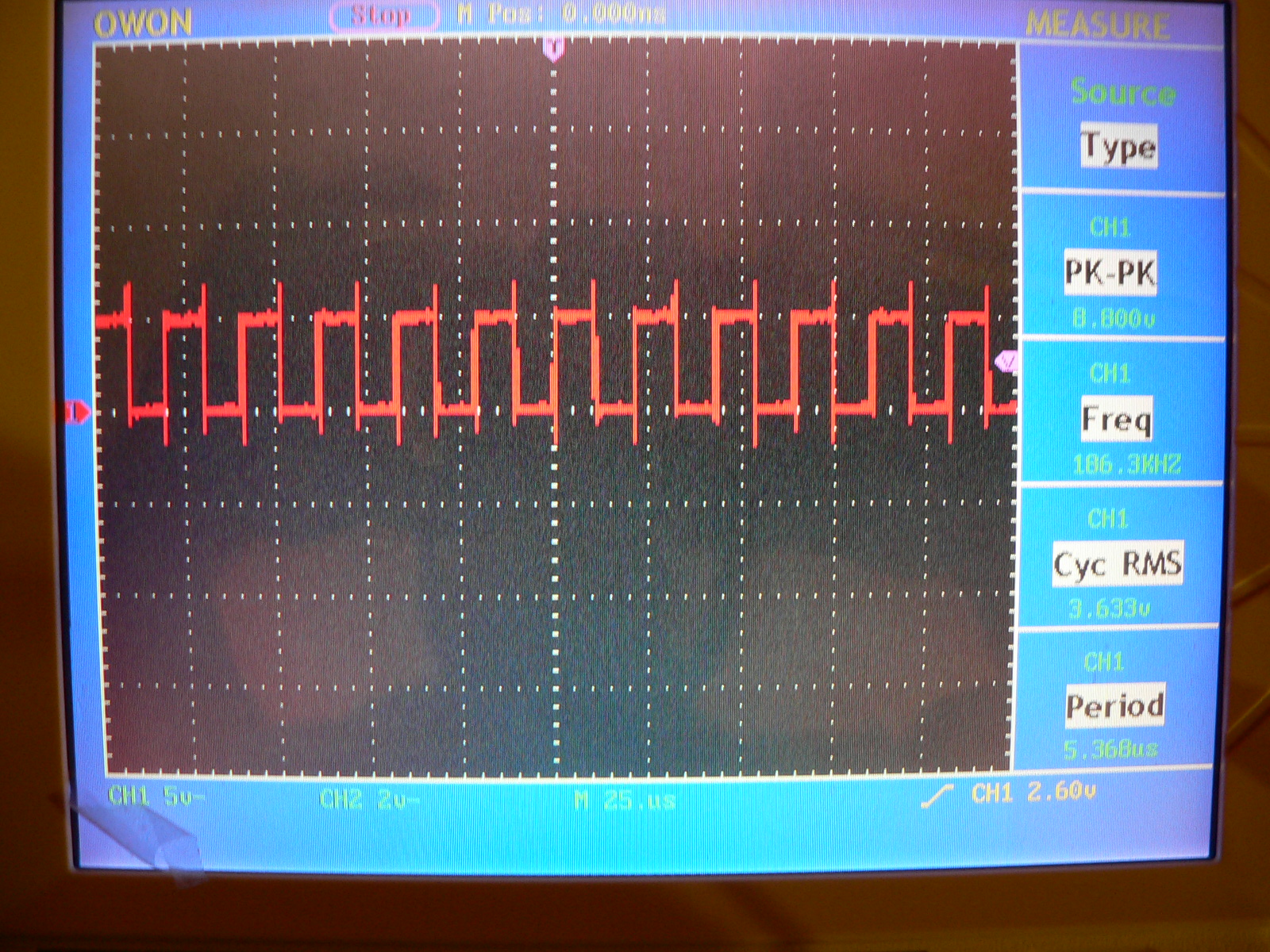

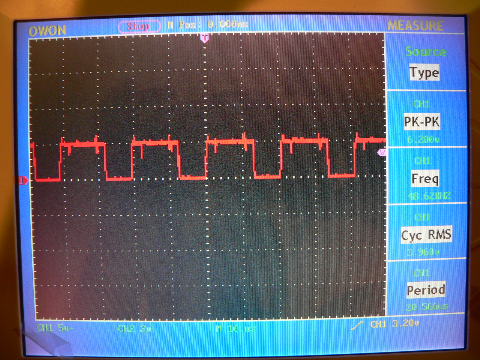

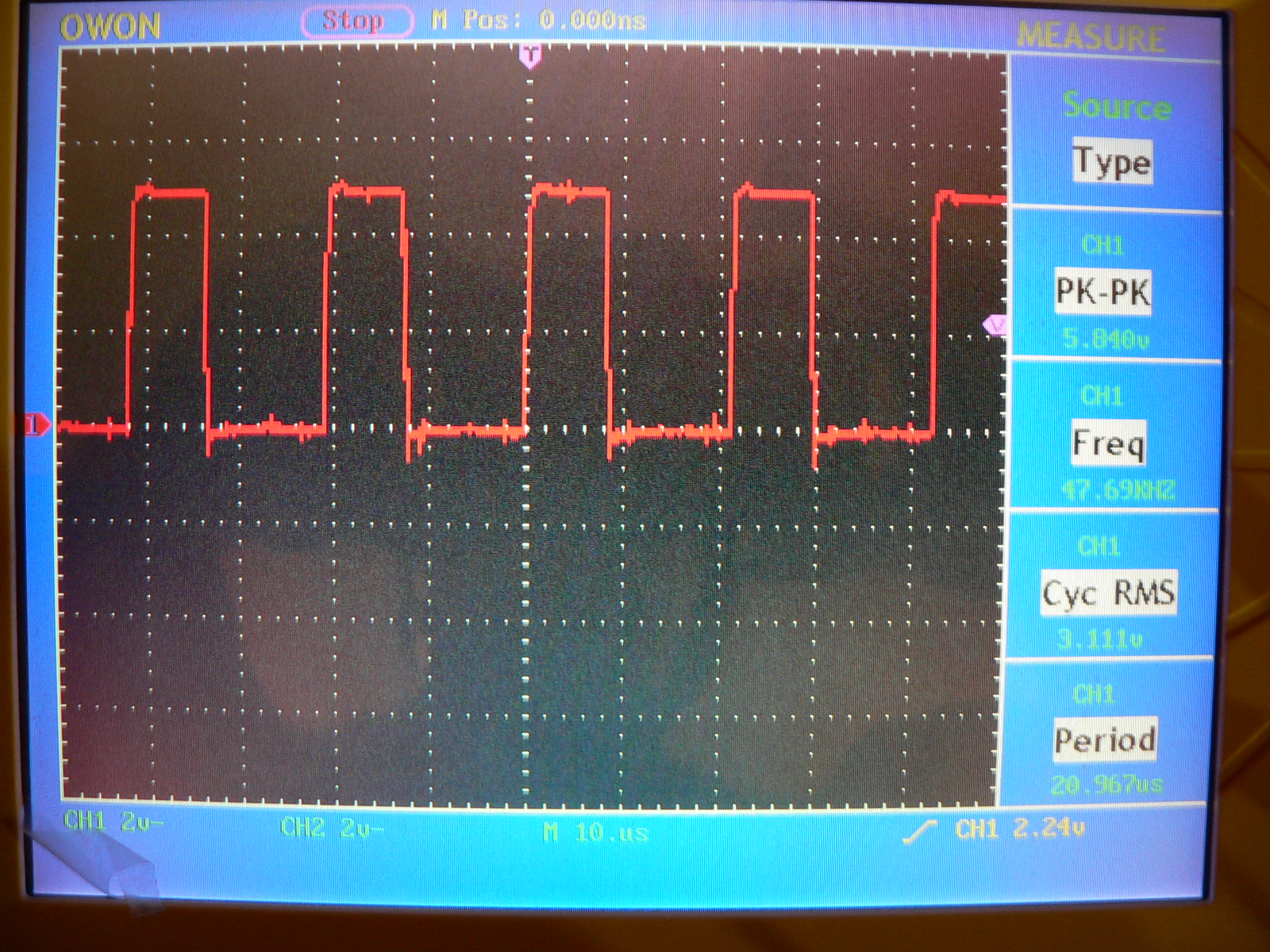

            The pictures from the working monitor look much cleaner. In particular, the output from inverter IC pin 9 on my other monitors looks way off. This monitor has bulging/leaking 820uF caps, but I'm not going to replace them until after I get the others fixed (I don't want to accidentally damage the only one of these I have that works). I also noticed that if I hold my scope probe right next to the CCFL wires, I see a nice sine wave (I didn't check this on one of the bad boards). I'll see about measuring some of the surrounding components tomorrow to see if any are different. Please let me know if any other comparisons would be useful.

              You are right, massive differences in the waveforms. I'm losing track of the details on a number of these threads. Please bear with me.
              First, I'm a little confused about the operation of the scope. Are the traces done at the same sweep rate and vertical sensitivity?
              Next, I'm uncertain about the last two traces in each set - Pin 8 and Pin 9. Are these the outputs of the inverter controller?
              The technique I prefer to use is to use two probes. Hook one to pin 9 of teh inverter controllerand sync from that signal. Use the other to probe the following points.
                The ones that have the same frequency likely are. The settings are at the bottom of each image. I've been using the auto-set button to let the scope give me what it thinks is the best image, except on inverter IC pin 9 where the frequency is way off - it only shows half of a wave there, so I zoom out a little to get a better image.
                Those are taken directly on those two pins of the inverter controller, yes.

                      Removing the FETS may work. I suspect they are the problem anyway.
                      Here is what I laughingly refer to as my thought process. The 'bad' monitor shows significant differences in drive waveforms. These waveforms are important. When the N-FET is on, the P-FET must be off, and vice-versa. Also, the N-FET is turned on by the gate going high, the P-FET is turned on by the gate going low.
                      The first step is to get a reference drive waveform. It could be the output from pin 8, pin 9, or even the oscillator pin. Let's use the waveform at pin 8, which I assume is the drive for the N-channel FET. Now we want to see the waveform from pin 9. But we want to see the two waveforms as they exist at the same instant.
                      This is important. See the crude drawing I made. If you sync on the falling edge of the observed waveform it appears both FETs may be on at the same time, this indicates a problem with the inverter controller. But if you sync on one signal and display both waveforms you see the P-FET gate drops well after the N-FET gate. They are not on at the same time.
                      Now we've established that the drive signals from the inverter controller are correct. How about the drive signals at the gate of each FET? There appear to be resistors and caps between the inverter controller outputs and the FET gates. So we observe them at the gates. It isn't necessary to move the probe that was on pin 8, we want that signal present as a reference.
                      While we are at it, we should see the signal at the source pins of the FETs. Remember, the P-FET is turned on when the gate drops below the source. If the drive waveforms only rise to 10 volts and the source voltage for the P-FET is 14 volts, the P-FET is always on.
                      Last, we want to see the signal on the drains of the FETs. Of course, they are tied together.
                      One word of caution about the text display on the scope. That represents what the processor THINKS is happening. It's very good at handling sine and triangular waveforms. It's not so good at analyzing square waves with lots of noise spikes.

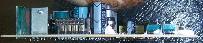

                        Since we were discussing CapXon bogus values, I was wondering about the following.
                        I am recapping an LCD and there are two CapXon KF 25v 1000uF.
                        The problem is that their measurements are around 10mm x 20mm. The closest I can come to this series considering the dimensions are Nichicon HE or UCC KY.
                        If I step down to 16v 820uf, I can find Panasonic FC or Nichicon PW.
                        Yes, I'm aware of the discrepancies in ESR for these series compared to Capxon KF's, but I must have 10mmx20mm caps precisely, or I won't be able to solder them in if they're too wide, and the PCB won't fit inside if they're too tall.
                        • Quasar

                            Re: Samsung SyncMaster 940T blows inverter fuse
                            Quasar -
                            Thank you for your helpful reply. Here are two pictures (attached for archival purposes):
                            Here are the caps by their numbers in the picture:
                            1) 25v 220uF
                            2) 25v 220uF
                            3) 25v 1000uF
                            4) 25v 1000uF
                            5) 10v 2200uF
                            6) 10v 1000uF
                            7) 25v 220uF
                            8) 50v 22uF
                            Keep in mind, caps 5 and 6 are Taicon PW and the rest (besides the tiny starter cap) are CapXon KF so they all need the low ESR KZE caps. So I assume we can't borrow from caps 5 and 6. Which leaves the 25v 220uF caps. But are they in parallel?
                            If the capacitors are in parallel I assume that if I raise the capacitance of one of them, I can diminish the value of another (Caps 3 and 4).... I can't answer what the actual voltage is, as I don't have the technical know-how to find out. As for 680uF, that would be great. If I could put 680uF there I'd put KZE as I like UCC and everything else I'm recapping with either KZE or LXZ/LXY.
                              I'd bet #3 & 4 can be 12.5 mm. You'll have to lay #2 over a bit, then #4 will fit. #3 can exceed the board edge and a little bend to the wire going to the resistor and you should be okay. Mount them a little proud of the board so you can get some movement.
                              2 things with the pics - The first one is a nice top down... on the transformer, so I may not be seeing the cap spacing correctly. Same with the second pic as it's straight on with the board edge, and not the cap tops to show the lack of clearance. It seems you have a few mm's to deal with on height.
                              Another shot of the foil side over the back of those caps area would be nice.
                              Sometimes you can move or pivot a component enough by drilling another lead hole. Then all kinds of room opens up. I do this on PSU outputs to get a -real- 3300uF cap in there.
                              Is this a customization of something? Is that wood I see over the top?
                              Q

                                I *might* be able to get a 12.5mm in there, but that would be like milking a frog. Things are just very tight over there, and that dried up toothpaste that they used aint helping things. I tried scraping some of it off but I'm afraid I'll end up cutting through the PCB or hitting something - it's some hard stuff.
                                Besides that, I can't really fiddle with this too much. The underside has lots of little fragile components and the soldering is Delta - very neat and professional - but at the same time very small and the points and traces are too close for comfort. I can't justify the effort. It's a 20" 4:3 LCD.
                                The good news is that I discovered that Samxon does indeed have low-esr suitable 25v 1000uF capacitors 10x20mm caps so I'll end up probably buying those. Thanks for your help.
                                Oh, no it's not a customization, that's the PCB out of the chassis, I'm just leaning it against stuff for the purposes of taking a pic .
