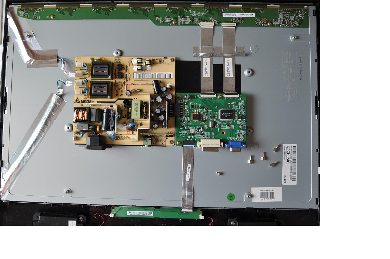

    I have a video problem with my Viewsonic 2235 and hope that some of you who have faced the same problem can help me to solve it.
    My monitor is working, no display problem. The problem is that after 30 minutes, it is switched off by itself, it is totally off, it does not stay on standby, the PC is still working. I have to wait for 10 minutes and switch the monitor on again. It's working again but for a shorter time. After a few times, the monitor is switched off by itself right after being switched on. Also it looks to be heat up quite fast.
    All the capacitors look fine, I have changed randomly half of them, the problem still persists. Does anyone have an idea of what is happening ? Do I need to change all the caps ? I have red that it could be the inverter, but I have also red that if the picture still appears on the screen so the inverter is fine !!

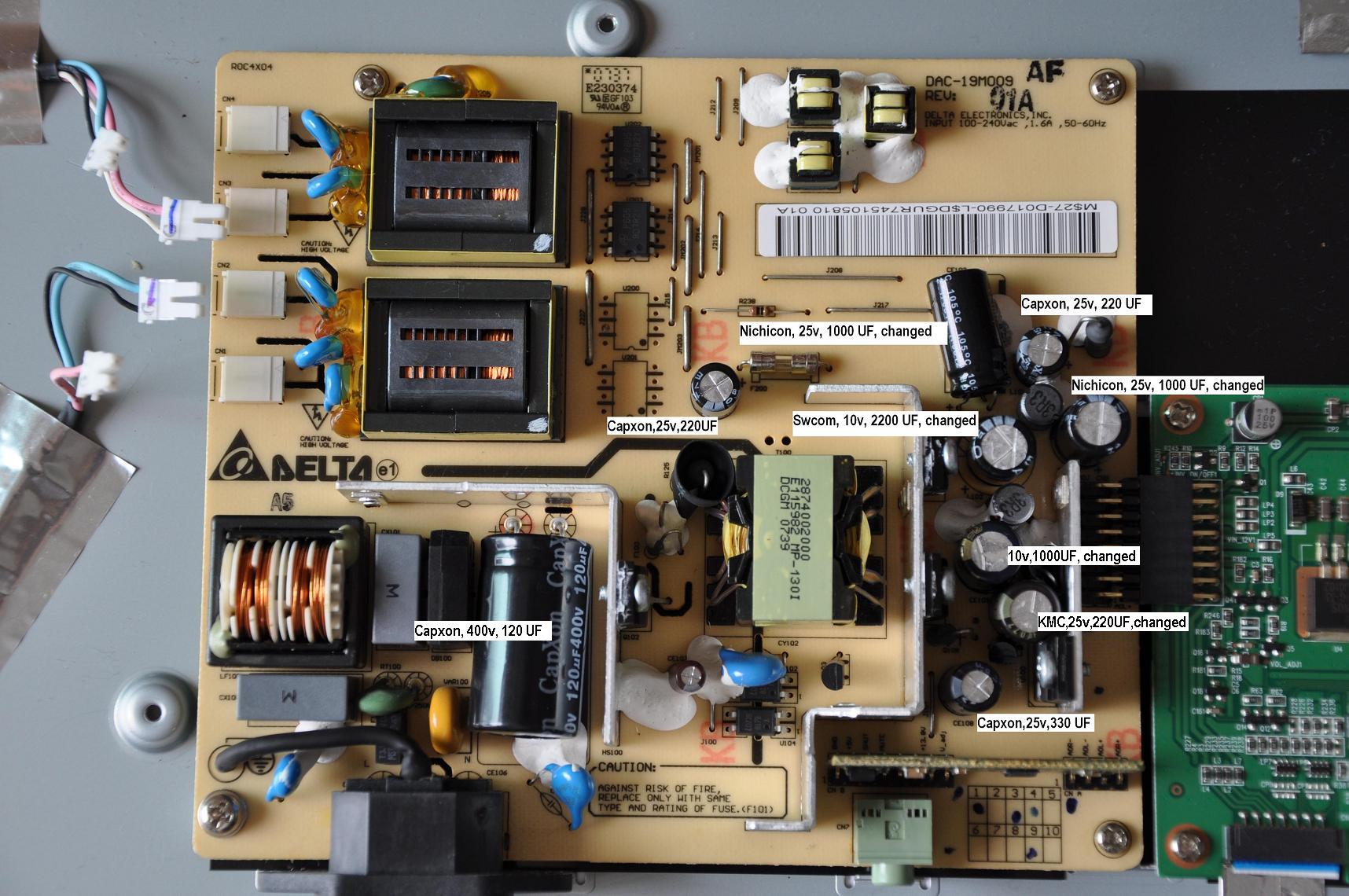

            Hello again,
            First, Your question : It is possible that plugging in the headphone/mic shorted out something?
            I don t know, i dont dare to plug the sets in another computer. So I have to buy a new set and try again on the 'problem' computer ?
            Second, I m trying to add some pics, and hope they re clear enough.
            I labeled all what i can. Sorry for the rest.
            Thank you

                Re: Viewsonic 2235 switched off by itself
                Some suggestions that may solve your problem.
                1) Capxon caps are not known to be high quality caps. The 3 unchanged caps are all Capxon and these 3 provide voltage to the inverter section of the board.
                Change out the Capxon with some quality low ESR caps.
                2) You may want to refresh/reflow the solder on the inverter transformer (the 2 black/yellow square boxes next to the ccfl connectors) pins.
                --- begin sig file ---
                --- end sig file ---

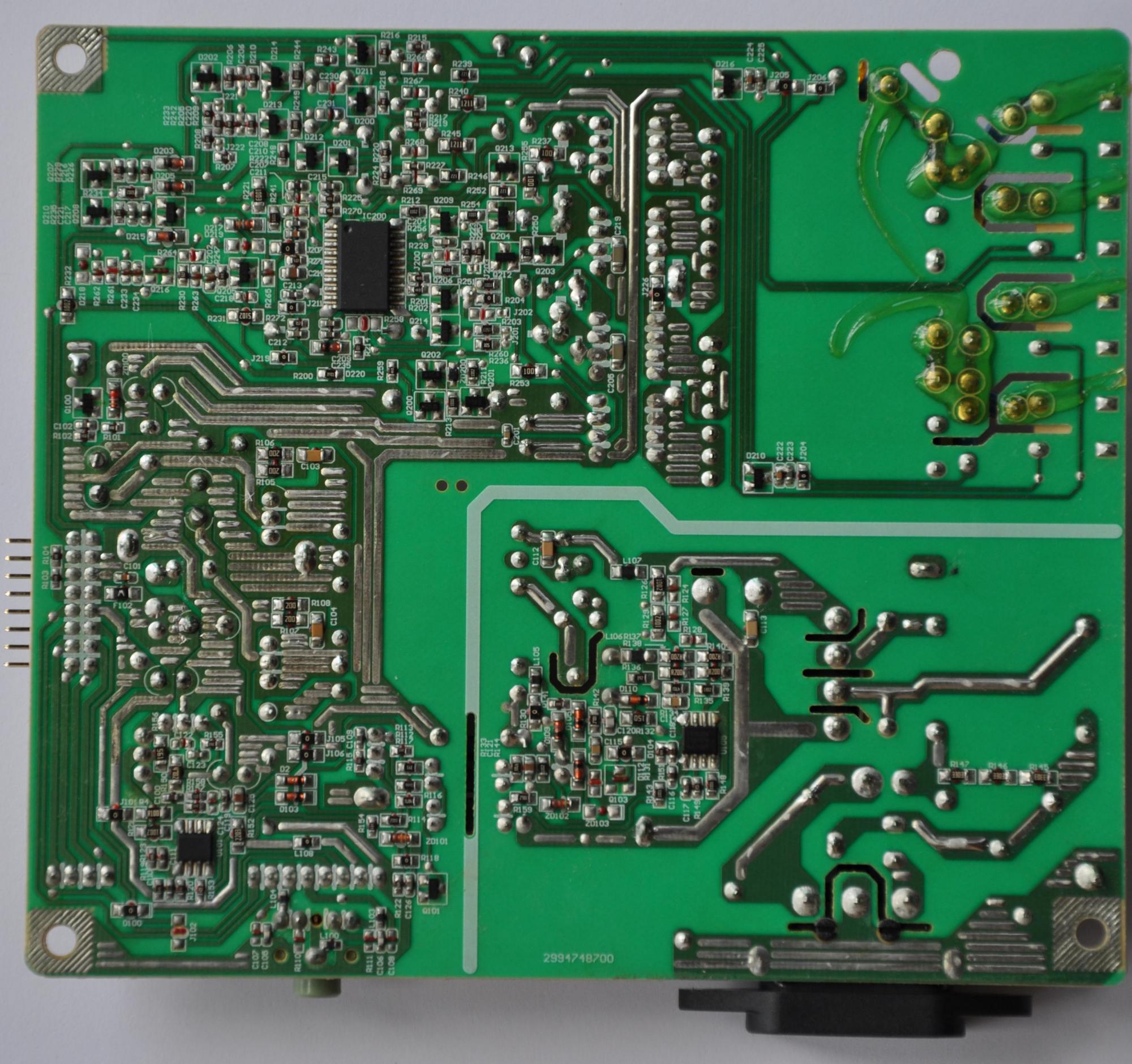

                  The 5th picture, that capacitor with a Panasonic T style vent, it looks wrong, the sleeving is wrong.
                  Whether it's pretending to be a Panasonic or something else, I'm not sure, but I am dubious.
