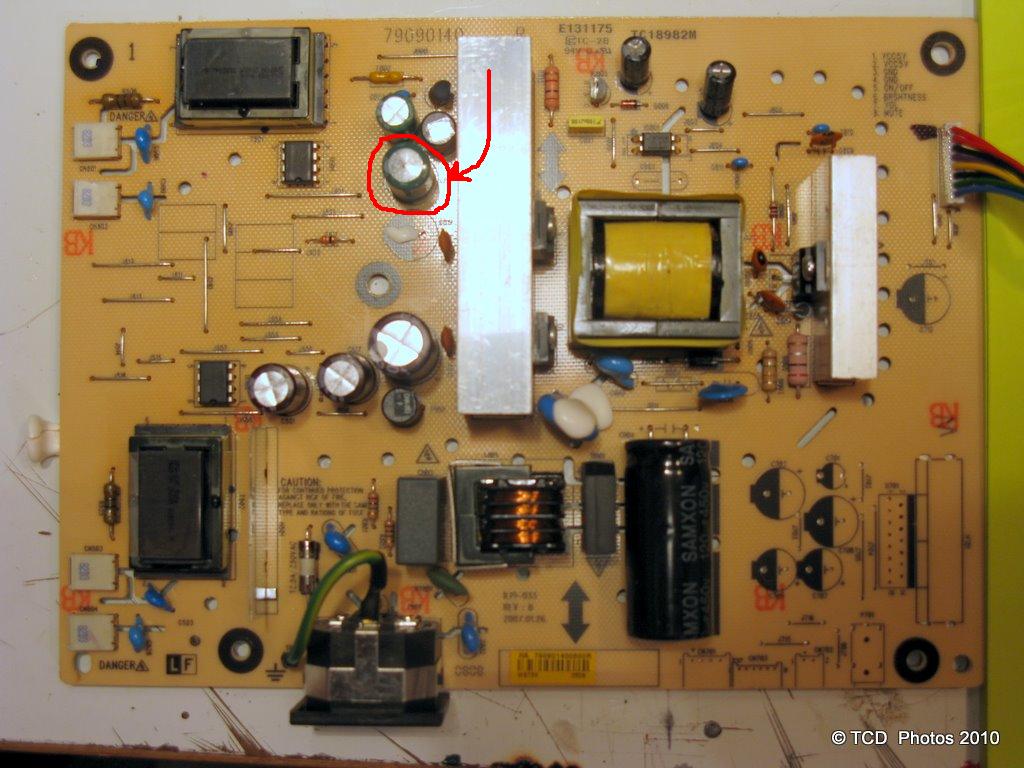

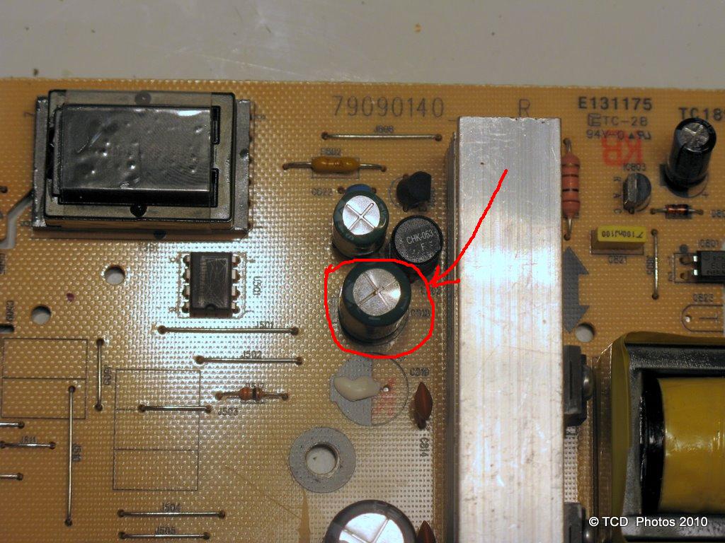

Acer AL2216W Dead!! Here we go!!
  • chinaclipper
    replied
    Re: Acer AL2216W Dead!! Here we go!!
    Thanks for the replies guys. I decided to give my business to BADCAPS.The least I could do! I got Rubycons (sp?)
    The monitor was DARK. but the power light on the right corner flashed from green to yellow/brown to green etc.
    I got all the caps except the big 450V one. Might as well be safe.
    Last edited by chinaclipper; 09-26-2010, 09:08 PM.
    Leave a comment:
  • jetadm123
    replied
    Re: Acer AL2216W Dead!! Here we go!!
    Originally posted by chinaclipper
    Well, the monitor gave up the ghost last night.
    I found BADCAP searching the 'net to find a solution.
    I FINALLY got the darn thing open, and sure enough, there was a capacitor that had swelled, and is presumably bad.
    So the plan is:
    -Buy the appropriate caps (there are eight. Do I need to replace the big 120uF 450V one?
    -Remove the old, replace with the new ones
    -Rebuild the monitor
    -Save 200 dollars!
    Sound about right?
    I will check out DigiKey etc and put in an order.
    I am a ham radio operator so I have some LIMITED electronic experience...
    More to follow!!
    Like wrog says, Panasonic FC or FM are go choices as replacements. FM has better specs and are almost the same price if purchases through digikey. Replace all 8 caps, including the smaller ones as they are part of the startup circuit. I'm including ordering instructions, since it can be a little confusing if you never order them before.
    Here's the best way to order from digikey:
    1) Go to digikey.com
    2) In the "parts search" window type: panasonic fm and select "GO" button
    3) Under the Capacitor heading select "Aluminum"
    4) The first two columns you see are capacitance and voltage. Highlight the value and voltage with your mouse and select the "Apply Filters" button
    5) You'll see several selections available. Here's what to look for:
    a) Look at the quantity available and minimum purchase. If "0" are available, then there's none to purchase. Some selections require a minimum purchase of a 1000 units, which you also don't want. I think you get the picture.
    b) height and diameter. Measure the original caps and compare to what's listed.
    6) If your value is out of stock, go back to the beginning and type in "panasonic fc" and go through the same process.
    7) During the checkout process select USPS First Class shipping, since this will give the best ship rate.
    Last edited by jetadm123; 09-26-2010, 09:09 PM.
    Leave a comment:
  • hoadle
    replied
    Re: Acer AL2216W Dead!! Here we go!!
    I fix 5 Acer AL2216W LCD monitor already, most problem same you had. I just replace the bad capacitor had swelled only is will working again.
    if safe side you just replace 5 caps on inverter side only (not 120uF 450V & 2 small caps above big cap)
    Leave a comment:
  • Wrog
    replied
    Re: Acer AL2216W Dead!! Here we go!!
    Depends -- what does the monitor do/not do? ("gave up the ghost" can mean a variety of things). Do you get a power light? Does it go into power save after 2-3 seconds of no signal even if there is a signal present? Does the screen flash its logo and then go out 2 seconds later? Does it work for awhile and then go off by itself? Judging from the photos, the caps is definitely a good starting point, but may want to check a few other things while you have it open (fuses, inverter transistors, etc.).
    To answer your questions -- leave the 450V one unless it is visibly bad. It doesn't look too crowded on that board so diameter may not be critical, but definitely double check the height of your replacements. Since you are ordering from Digikey, a popular choice is to get Panasonic FC or FM series as replacements. If you're unsure, post a list of the caps and someone will help double check against Digikey P/N's.
    Leave a comment:
  • chinaclipper
    started a topic Acer AL2216W Dead!! Here we go!!
    Acer AL2216W Dead!! Here we go!!
    Well, the monitor gave up the ghost last night.
    I found BADCAP searching the 'net to find a solution.
    I FINALLY got the darn thing open, and sure enough, there was a capacitor that had swelled, and is presumably bad.
    So the plan is:
    -Buy the appropriate caps (there are eight. Do I need to replace the big 120uF 450V one?
    -Remove the old, replace with the new ones
    -Rebuild the monitor
    -Save 200 dollars!
    Sound about right?
    I will check out DigiKey etc and put in an order.
    I am a ham radio operator so I have some LIMITED electronic experience...
    More to follow!!
  • bripoll
    Acer Veriton N4670GT Dead
    by bripoll
    Hello, I have an Acer veriton n4670GT that, due to a fall to the ground, only started if I did a BIOS reset.
    The power button ar ok, and when power off windows, then if press power button, this power on, but goes to boot loop, like press power button forever
    It crossed my mind to try a BIOS update and when I finished it turned off and no longer starts in any way.
    I have a flash programmer, but the file you download from the Acer website has a .CAP extension, it is not a .BIN
    I have programmed it, but it still won't start, it is dead
    Before programming...
    11-23-2023, 02:56 PM
    09-06-2024, 05:27 AM
    Acer Aspire Acer Aspire 7 Charcoal Black Notebook 7 Specification for Upgrade or Repair
    This specification for the Acer Aspire Acer Aspire 7 Charcoal Black Notebook can be useful for upgrading or repairing a laptop that is not working. As a community we are working through our specifications to add valuable data like the Acer Aspire 7 Charcoal Black boardview and Acer Aspire 7 Charcoal Black schematic. Our users have donated over 1 million documents which are being added to the site. This page will be updated soon with additional information. Alternatively you can request additional help from our users directly on the relevant badcaps forum. Please note that we offer no warranties...
    09-07-2024, 05:00 AM
    Acer Swift Acer Swift 3 Ultraschlankes Notebook Notebook 3 Specification for Upgrade or Repair
    This specification for the Acer Swift Acer Swift 3 Ultraschlankes Notebook Notebook can be useful for upgrading or repairing a laptop that is not working. As a community we are working through our specifications to add valuable data like the Acer Swift 3 Ultraschlankes Notebook boardview and Acer Swift 3 Ultraschlankes Notebook schematic. Our users have donated over 1 million documents which are being added to the site. This page will be updated soon with additional information. Alternatively you can request additional help from our users directly on the relevant badcaps forum. Please note that...
    09-07-2024, 05:00 AM
    Acer Nitro Acer Nitro 5 Black Notebook 5 Specification for Upgrade or Repair
    This specification for the Acer Nitro Acer Nitro 5 Black Notebook can be useful for upgrading or repairing a laptop that is not working. As a community we are working through our specifications to add valuable data like the Acer Nitro 5 Black boardview and Acer Nitro 5 Black schematic. Our users have donated over 1 million documents which are being added to the site. This page will be updated soon with additional information. Alternatively you can request additional help from our users directly on the relevant badcaps forum. Please note that we offer no warranties that any specification, datasheet,...
    09-07-2024, 04:10 AM
