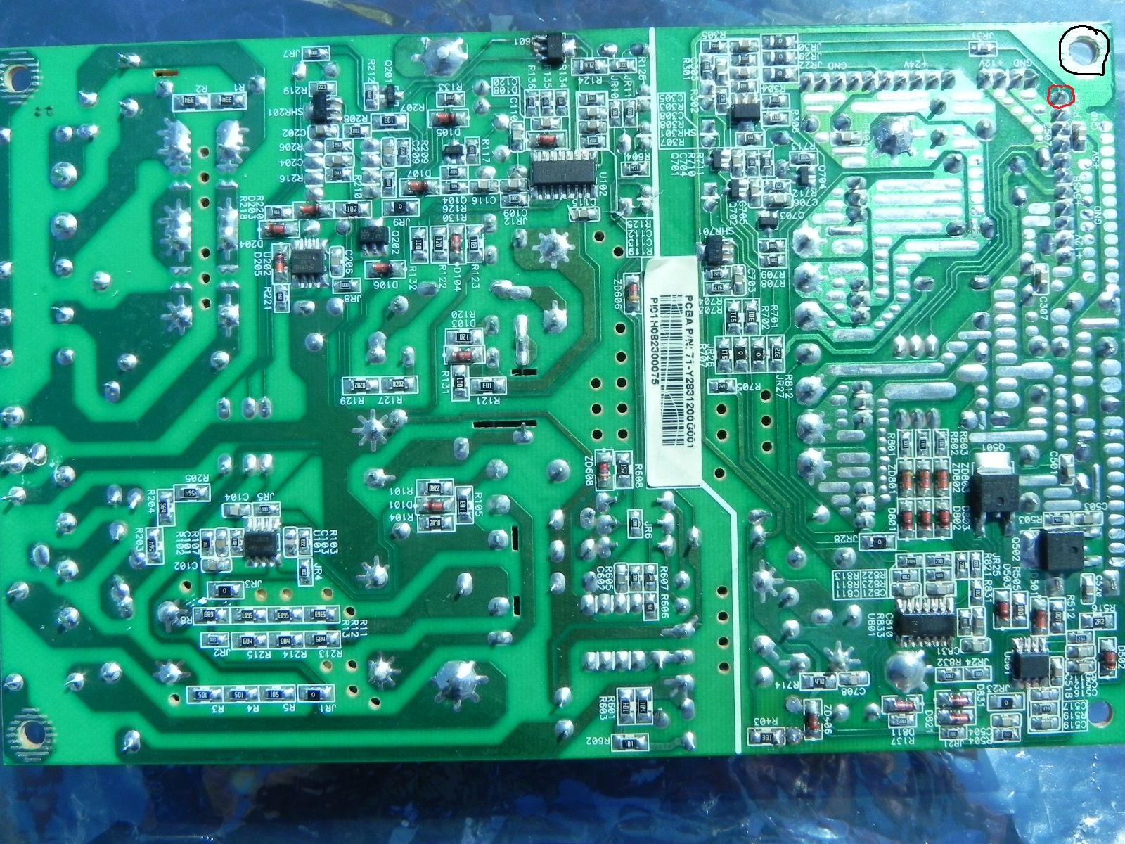

On the IC labeled u601 I got 11.5v out of pin 2, and between 163.2, and 164.2 out of pin 5.
The only pin on the output connectors that has voltage is the 5vsb, it gets 4.97v. Last time I checked the 5vsb I didn't get a reading, but I did find a place on the board where a trace to a capacitor came up. The trace was very short so i was able to just jumper it with solder.
I am going to test the monitor again tonight to see if that trace fixes anything.
Thanks again for any help.
Jason
