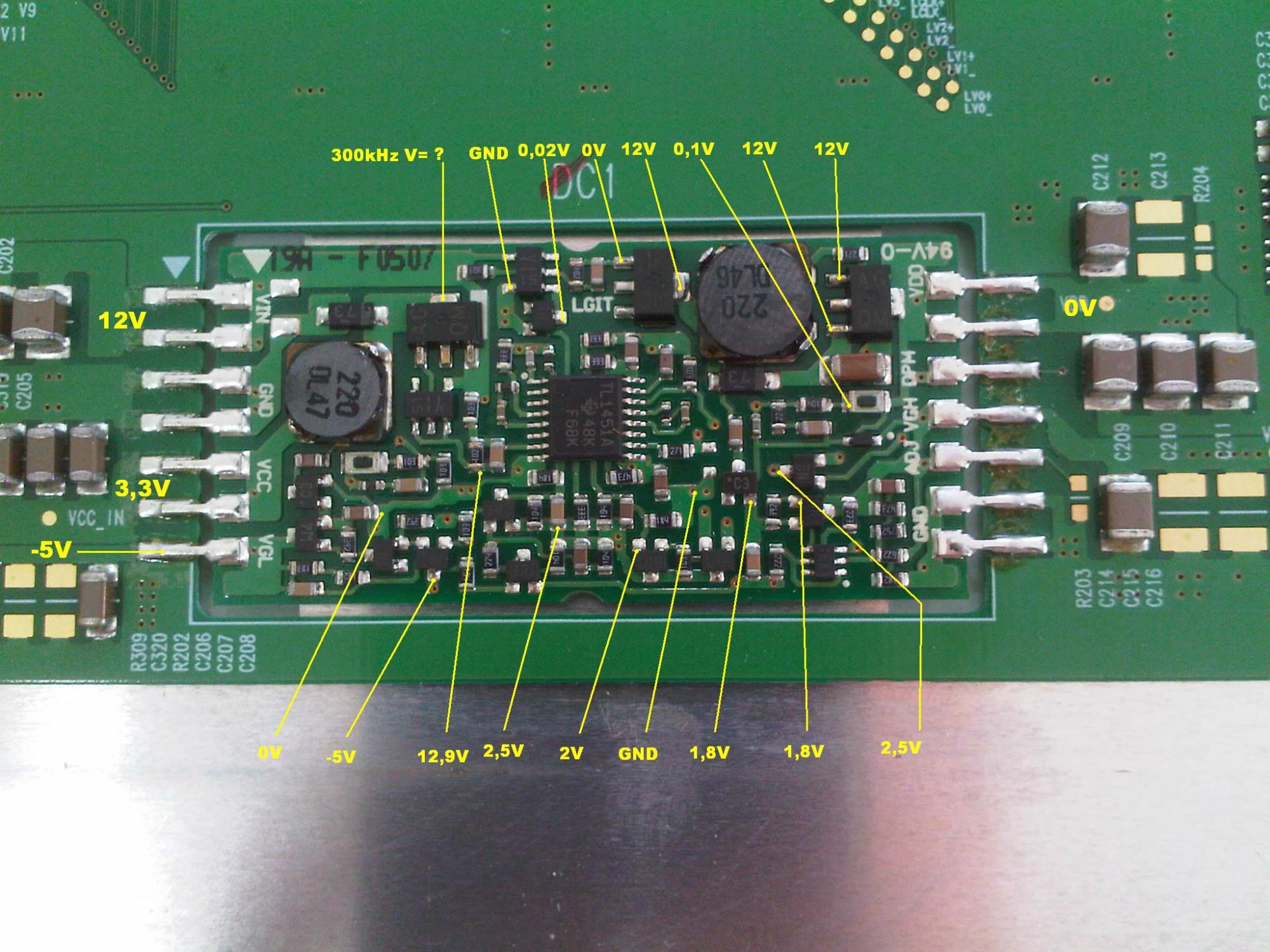

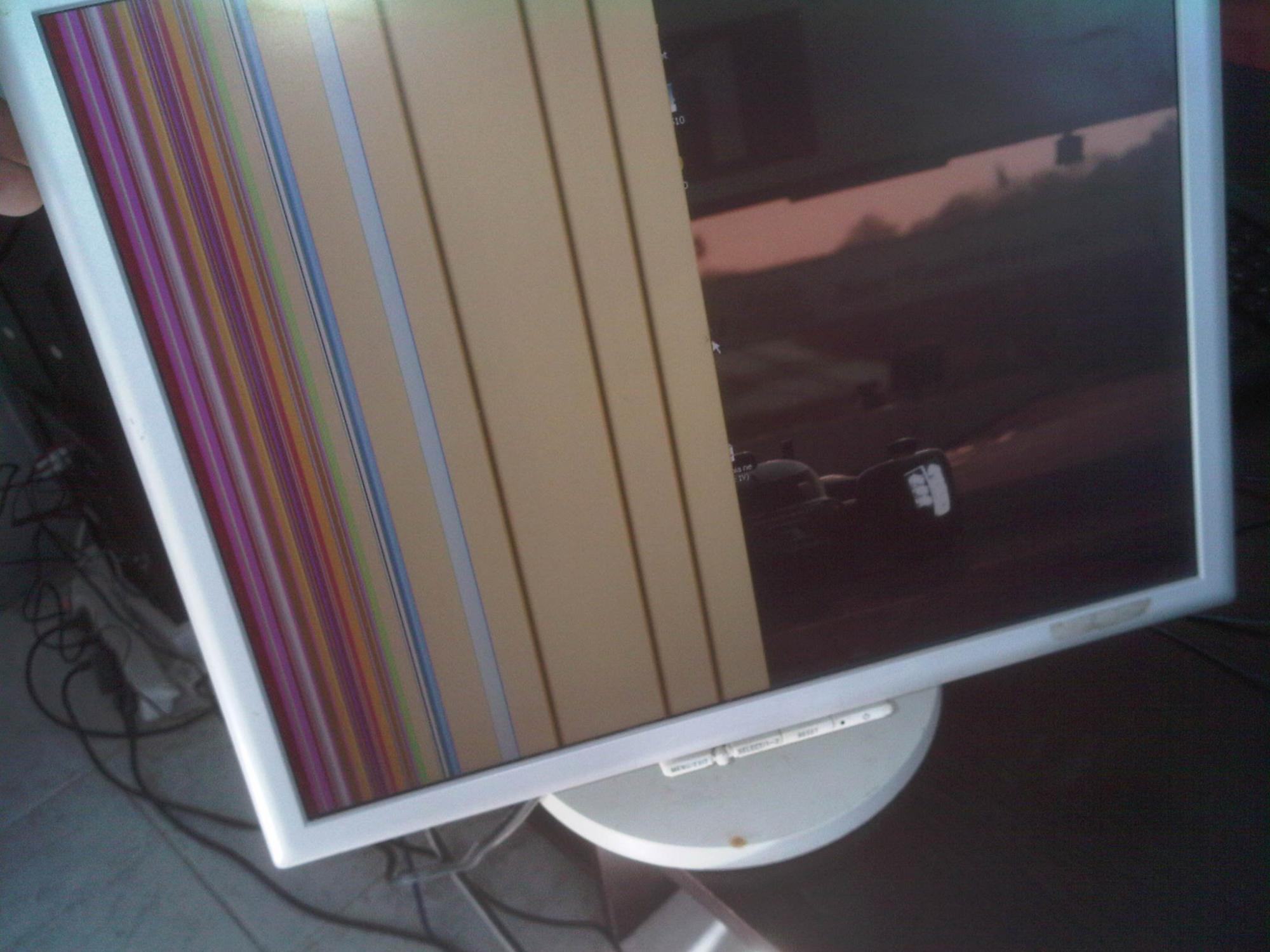

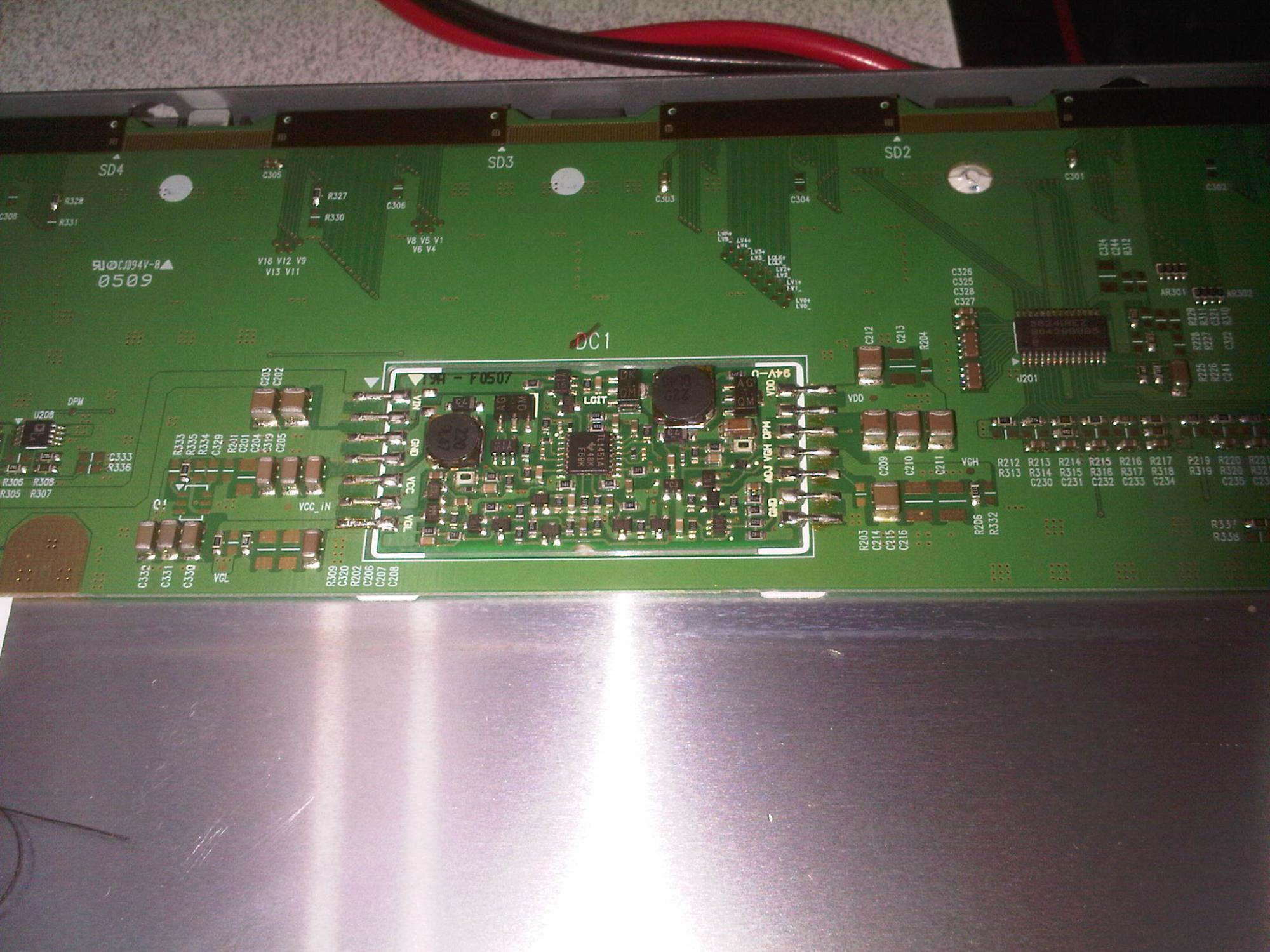

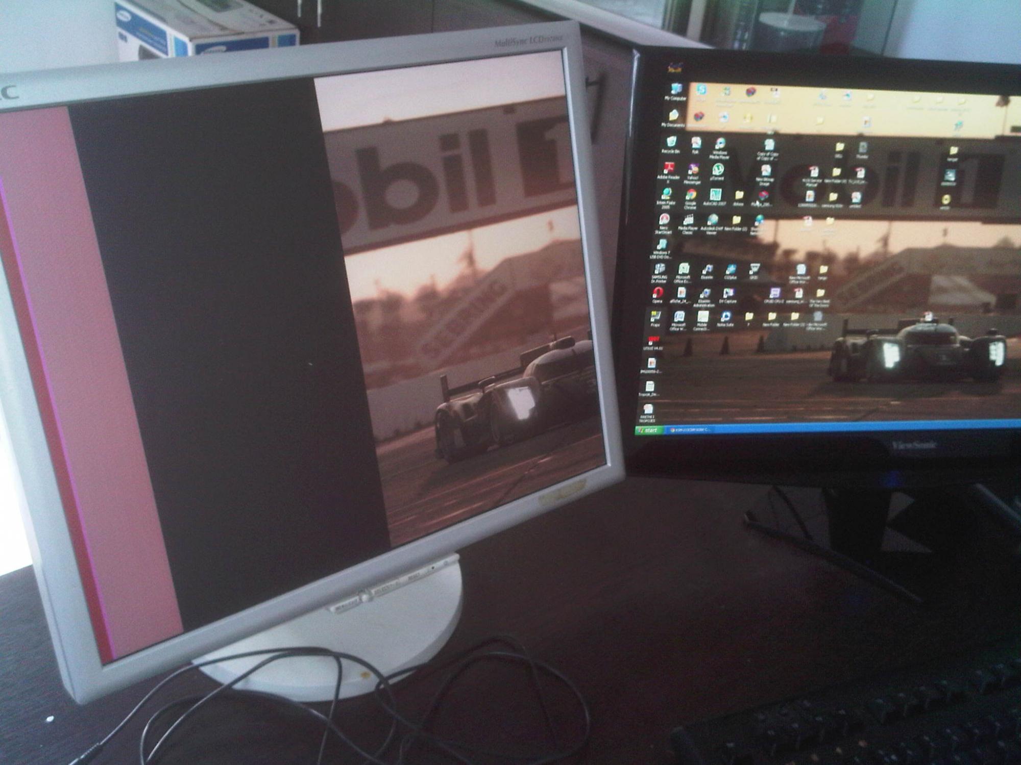

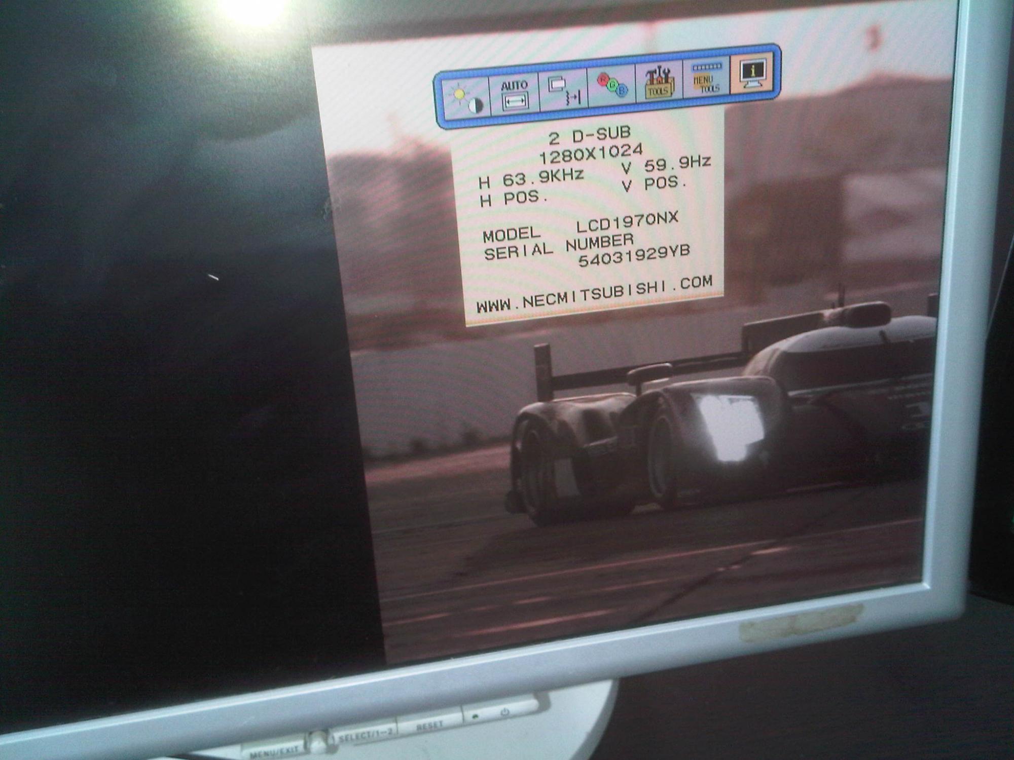

      hello. i am reviving this old thread because i have the same problem here.
      it is an "old" Nec Multisync lcd1970NX with Lg panel. googled around (because yesterday Badcaps.net wouldnt work for me) and saw other people with the exact problem. i have lot of pics, but you can also see a video on tube posted by a nec victim : http://www.youtube.com/watch?v=666WwTYU8xU
      a strange fact (maybe not important) is that when connected to the D-Sub the picture is offset (first and second pic). meanwhile in DVI connection it's centered (third pic).
      the boards are full of nichicons and panasonics, and all seem ok. measured some voltages in the t-con. any other idea?
        Re: NEC LCD1970NX vertical 2" line on screen
        Does look like a t-con issue. Have you disconnected the ribbons cleaned and re attached?

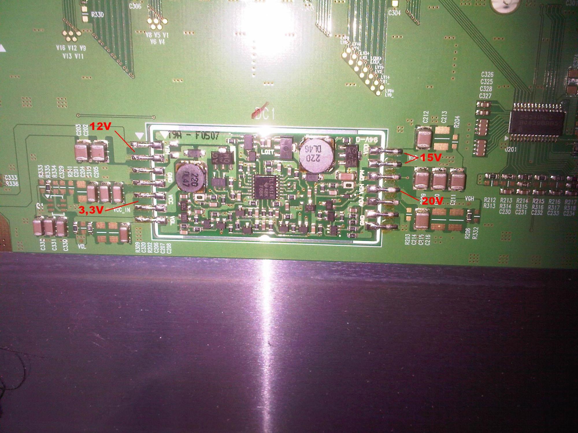

          yes, even checked every pin from the main board to the t-con. but now sth weird happened. the display is all black, doesnt show anything. measured again, there is 12V and 3.3V in the t-con but no 15 and 20V anymore. i did nothing except reseating the lvds.
            Very Strange....
            You need to trace where the 15v and 20v comes from and see if it is still supplying the T-con or if its failed before it gets there.
            There are no fuses on the board that I can see is there?

              ok, lets go further. new voltages:
                      thank you selldoor.
                      a quick résumé of the situation:
                      the NEC which came to my computer service store yesterday had vertical lines all over the left half.
                      this problem was very common among this party of NEC monitors, feedback all over the web. but no-one had ever succeeded in repairing it. next day saw this thread and thought about troubleshooting this case.
                      after playing with the lvds with my dmm, the monitor failed to show the erratic display any more. after re-measuring, the voltages werent all right.
                      i am very confident with myself that i havent shorted anything in the t-con during testing. lets call this mini-circuit a tcon-psu.
                      did i really screw it?
                      or, it was in its last hours and just died in my hands?
                      are the voltages 20V and 15V correct for a t-con?
                      if not, could they be responsible for the vertical lines, the original problem?
                      if yes, i really should repair this mini-psu inside this t-con.
                      if not, i should give up and the NEC vertical lines issue will remain a mystery.
                      thank you for your patience.
