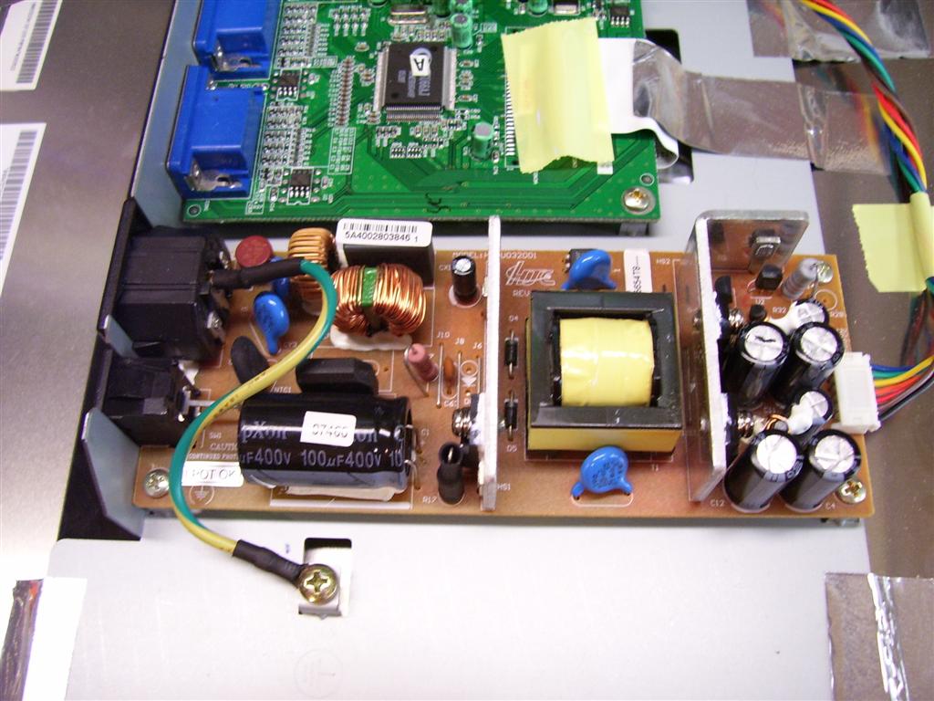

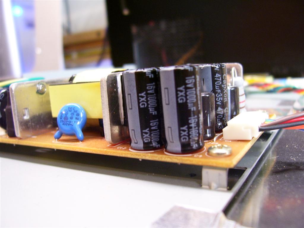

    Normally I'd order something around the MBZ series, but I had some YXG's on hand here in the correct value for the ones that were bad in these monitors (5 of them!)
    Is this going to cause any problems down the road? They're replaced and done for now, but if I hear enough negative feedback here I'll consider replacing them again.
    Also, for now, just replacing the two caps in each monitor that were bad (in all 5). I imagine I'll have to do more down the road, but at this point, since all belong to me for in-house use, it's not a big deal.
    Any feedback is appreciated.

      The Rubycon YXG series meets the minimum when it comes to the rubycon low-esr series of caps. The MBZ series or Panasonic FM FC series would have been a much better choice. I personally would have changed ALL the caps at the same time. Since you have additional Capxons in each monitor, it's probably a good chance you'll see problems in the near future. If you wait until a problem occurs, then you can change them all then. However, waiting for a problem will also increase the chances of those Capxons damaging other components.

        i have seen plenty of yxg in lcd's
        they should do fine.
