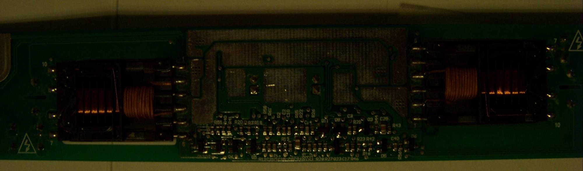

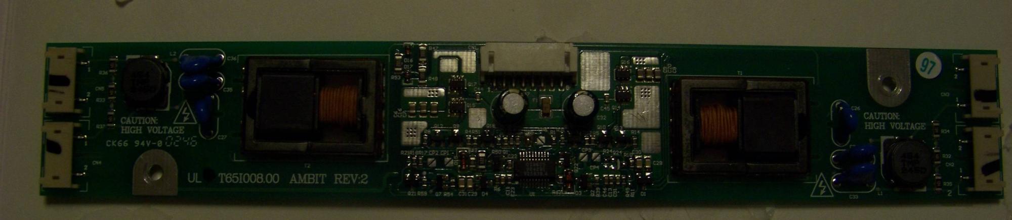

                        Re: Viewsonic VG191b
                        Here is my photos of the board...sorry so dark
                          It would simplfy the process if you had a spare good backlight ?????.The other things to try should you not have one,is to compare the resistance readings,using a 2000 ohm scale if possible, on the output pins of the two transformers.The Output pins being the ones closest to the ends of the board.Also the two capacitors behind the connector may be faulty,and of course your failed fuse.
