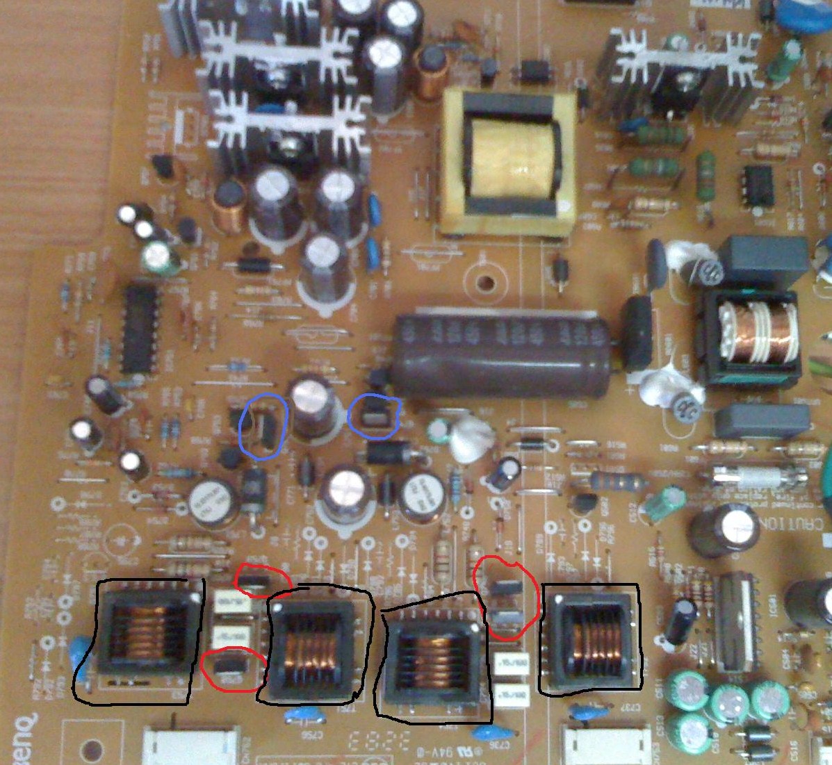

    I changed for three new fusers working but the problem is when I pull a cable jack and returns it to , the fuser screwed and no light no light

      As Plainbill said change
      4x C5707 (2SC5707) outlined in red
      2x FU9024N outlined in blue
      turn the board over and resolder 4 x transformers outlined black
      then put in new picofuse

        ok i understand you but if i replace these transistors , the picofuser will not blow up?????because i changed 3 brand new fusers

          You must also resolder the transformers
          Then that should cure the fuse prob

                ok guys i put new pico fuser and now it works without any problems
                thank you all about the help bybeybeye))

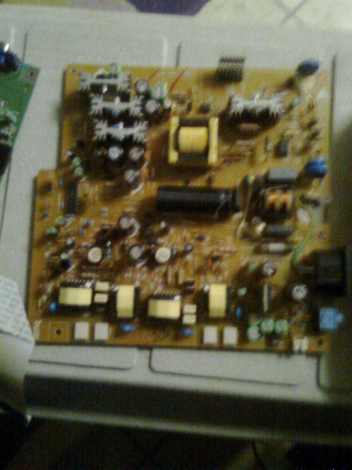

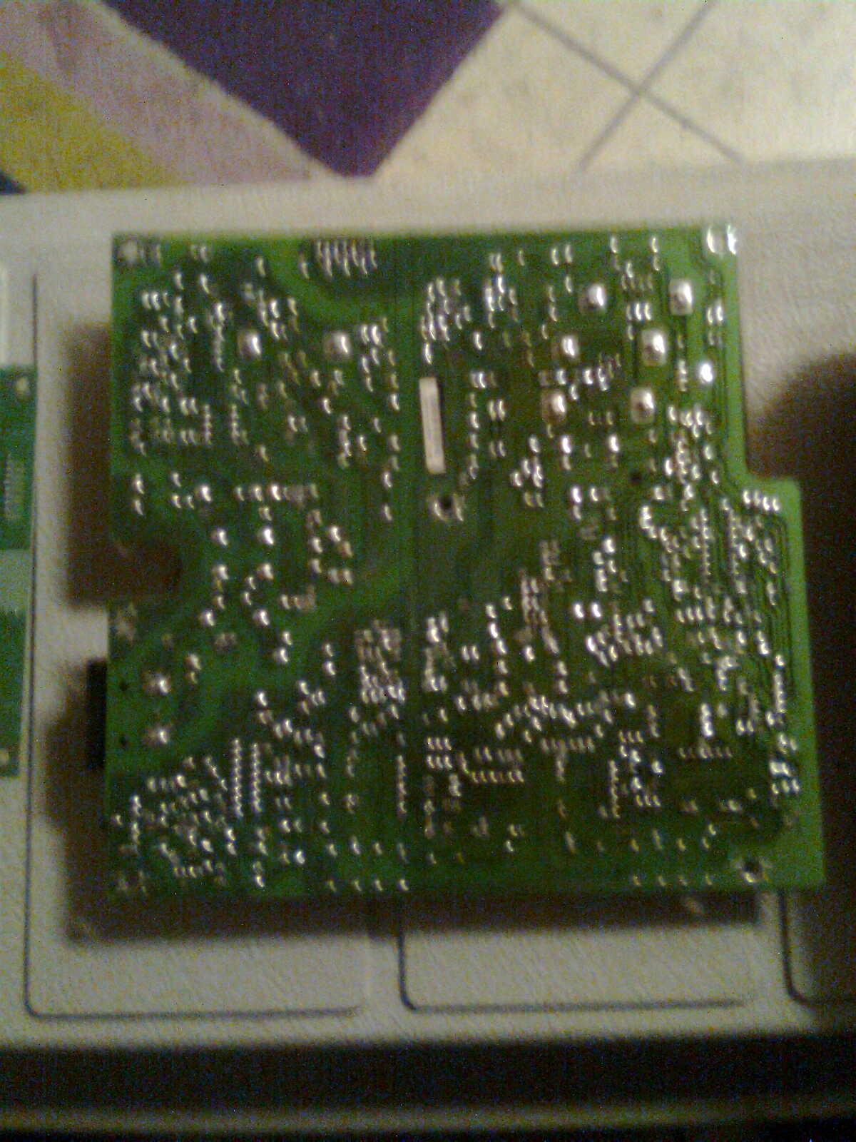

                            I have basically the same symptoms as GASAN with my benq FP767 17" monitor IE power led is on but no image on screen. I"ve taken out the circuit boards to check for anything obvious to no avail, the main fuse is good and its the only one that looks like a fuse. I only have grade 9 electronics 32 years ago so please be patient with me. 1st, I think I remember a transistor has to be removed from the board to be tested. 2nd, on your pic on pg 42, where are the picofuses? I don't even know what a picofuse looks like! I thought they would be "fu9024n" but they're marked q743 and q751 and have 3 leads so I'm assuming they're transistors. A new lcd monitor is about $100. in Toronto, Ontario, Canada So I'm wondering if I should even proceed as I don't know what the parts will cost me. I do know E=IR, LOL.

                              Are you able to provide photos of your power supply?
                              sorry I missed the pitcures I think i can see it but it out of focus
                                Hi Badbow, welcome. The last couple of BENQs I repaired cost about $6.00 Canadian. Sure monitors are cheap, but it's fun to fix 'em and good to keep 'em out of the landfill.
                                You should measure the transistors, and the pico fuse, and check the soldering on the transformers.
                                Post a good photo of the board and we'll guide you from there.

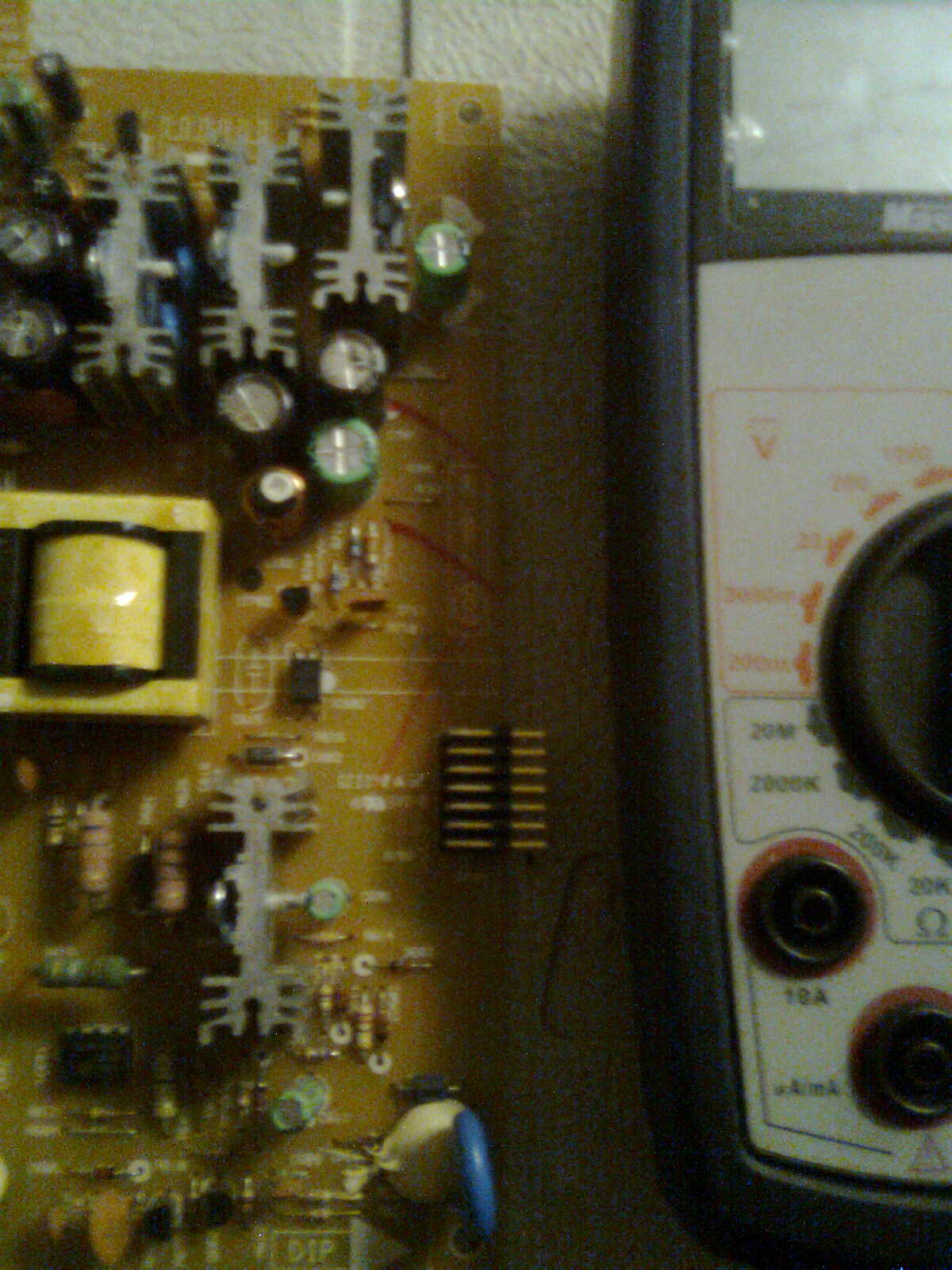

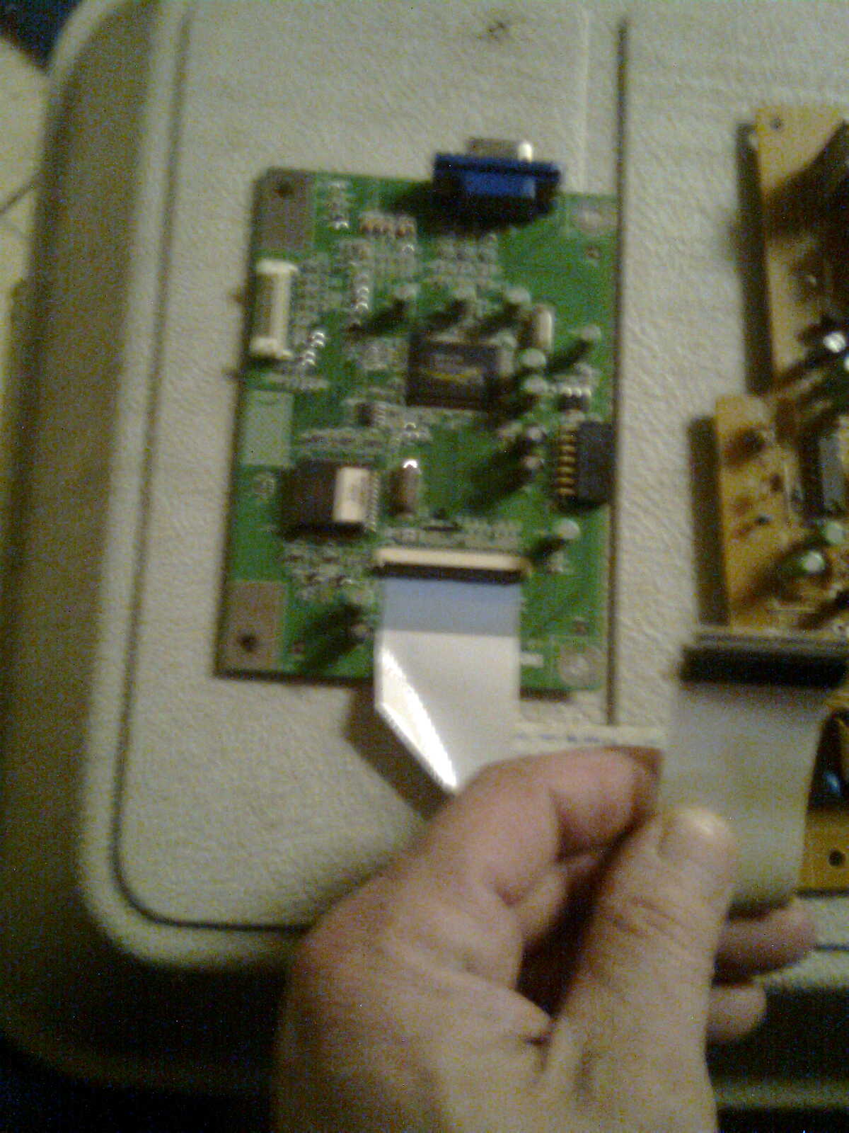

                                    As you can see from 0015 and 0076, I'm a fitter/welder so please bear with me. Photos attached. the pic you were looking at was the guy online with the similar problem with his benQ monitor. thanks, badbowtie.

                                      If you look on the bottom of the Power supply board,in the area of the 3 aluminium heatsinks, you will see a component identification 'PF' that is the Pico Fuse, probably green in colour to locate it on the top of the board.

                                        If you can't find the fuse please post some pictures that are not blury.WE need to be able to read componet numbers on the board.
