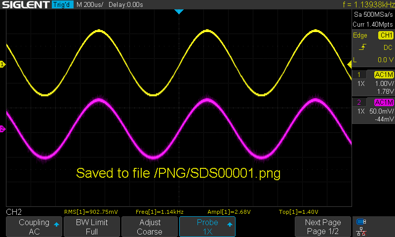

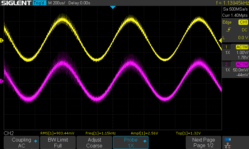

    Hi All,
    I have been trying to do some measurements on a a small TDA2030 chip amp using a Siglent scope.
    I've been powering the amp with a cheap Chinese HANMATEK HM305 bench power supply.
    The problem is high frequency noise on the output of the amp when powered with the the bench supply.
    If I power it using 2x 9V batteries the noise goes away.
    So my question is what can I do to reduce the noise from the PSU?
    Is there a filter circuit I can use to help this situation?
    Many thanks.

    could try bypass capacitors . or even better filters .. i can't see the power supply from here never mind what's inside it ..
      • 31214
      Re: Amplifier PSU & Oscilloscope Advise
      put ceramic or film capacitors across the power rail at the amp
          try 100nF ceramic or film
          AND 220uf electrolytic in parallel
          ceramic/film deal with very short high frequency noise, the electrolytic deals with general stuff
