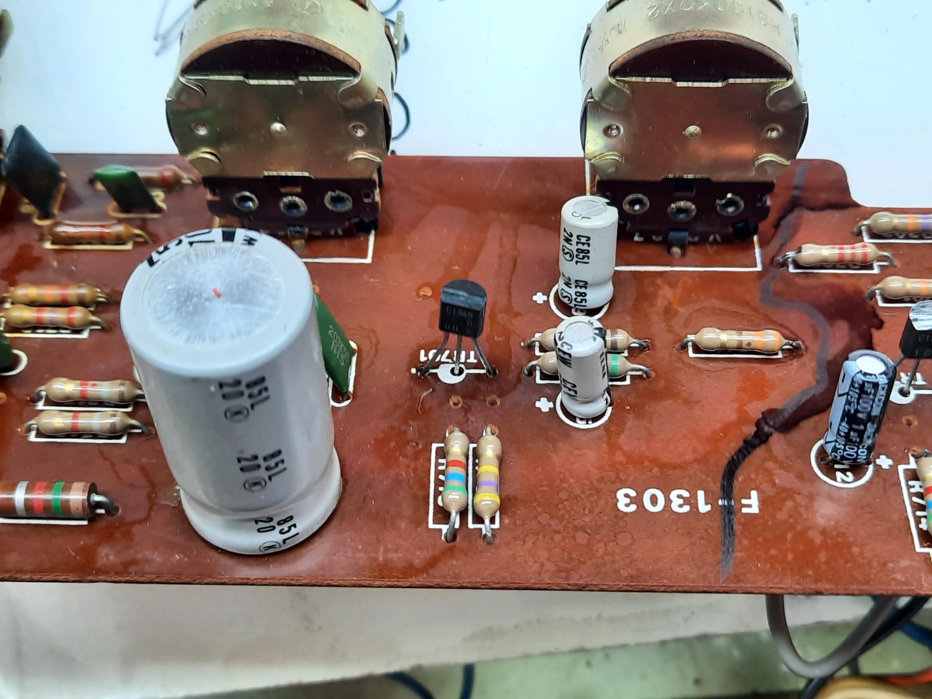

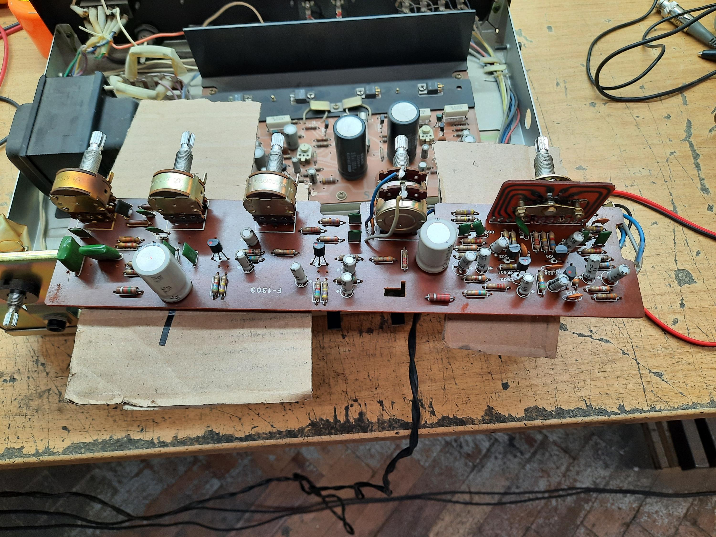

    Hi all
    Right channel works but a touch noisy .
    Left channel no audio .
    Proved issue is on the control pre-amp board , by injection an audio signal directly into the audio output / drive board
  • zen
    • 511
    Re: AU101 Sansui amp schematic please
    Schematic really poor quality ,but managed to reverse engineer circuitry .
    TR701 , 2SC871 breaking down under load .
    Replaced with 2SC1345 , which i had to fit reversed due to pin configuration .

      I find many old grey Elna electrolytics pretty much dead nowadays, they dry out and go low value. I'd replace them all.
      You can compare DCV readings between channels. Two transistors are the phono preamp, leaving just one for the control preamp.
      2SC871 is 25V low noise and high beta min. 350 typ >400. Hand selected KSC1845's or 2SC2240BL's or BC549B or C (different pinout) and lately I am using the Zetex power parts popular for low noise audio use due to their large die, like ZTX690B. But they are hard to find lately.

        Thanks Redwire , all the other electrolytic caps checked out good.
        TR701 was the issue , tested for several days & all working well .
