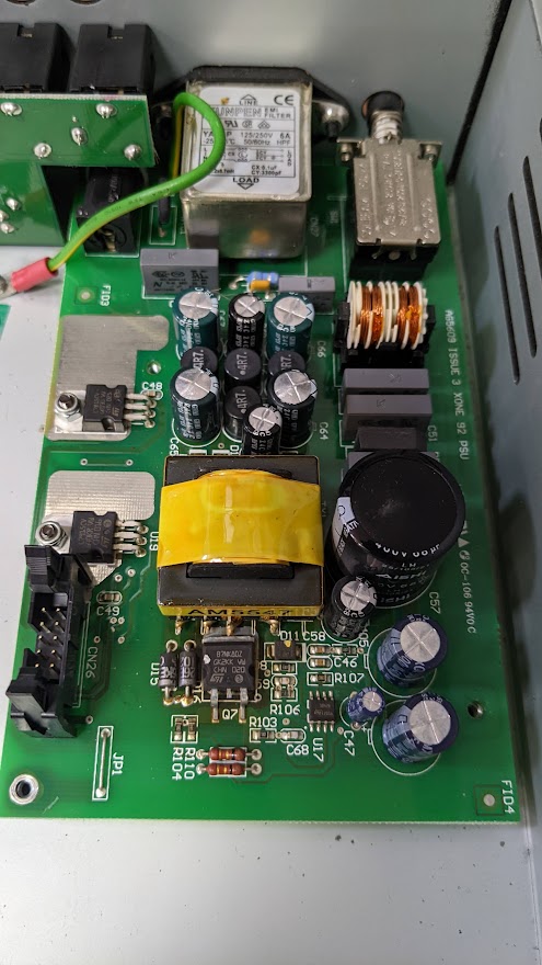

    I will post some video just so you can understand the problem, no caps with problem on the effects boards, weird is that the second filter affects the one that's assigned , hope you can notice that in the video, is it safe to just put the effects boards into the ultrasound cleaner ?

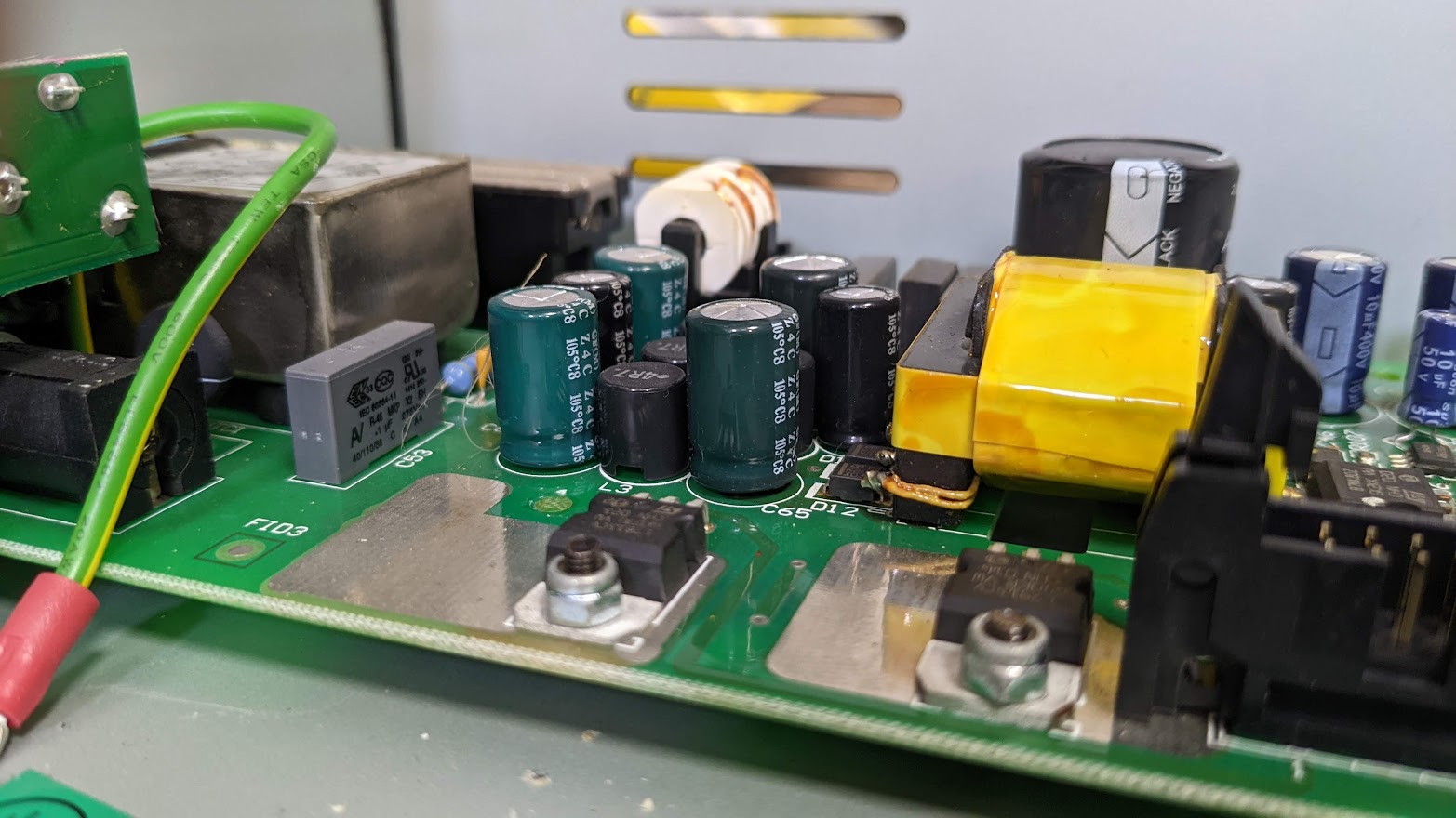

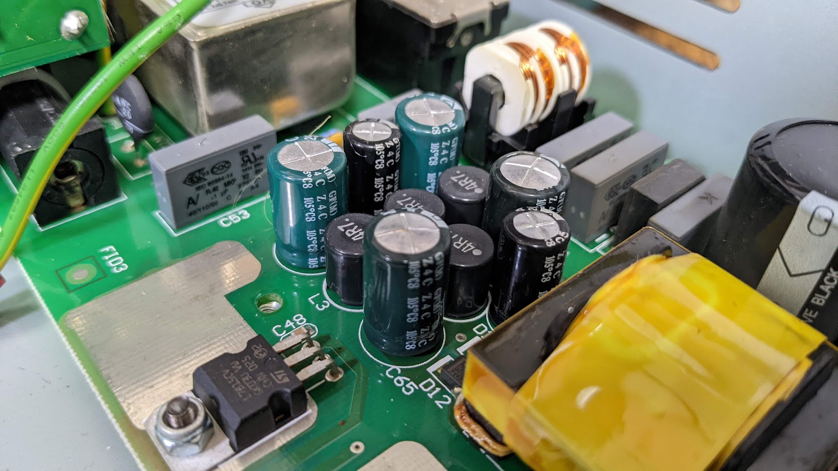

    Problem solved after cleaning mainboard and all faders i found two swallen caps 470 uF 25V on the psu, replaced them ,and everything came back to normal.
