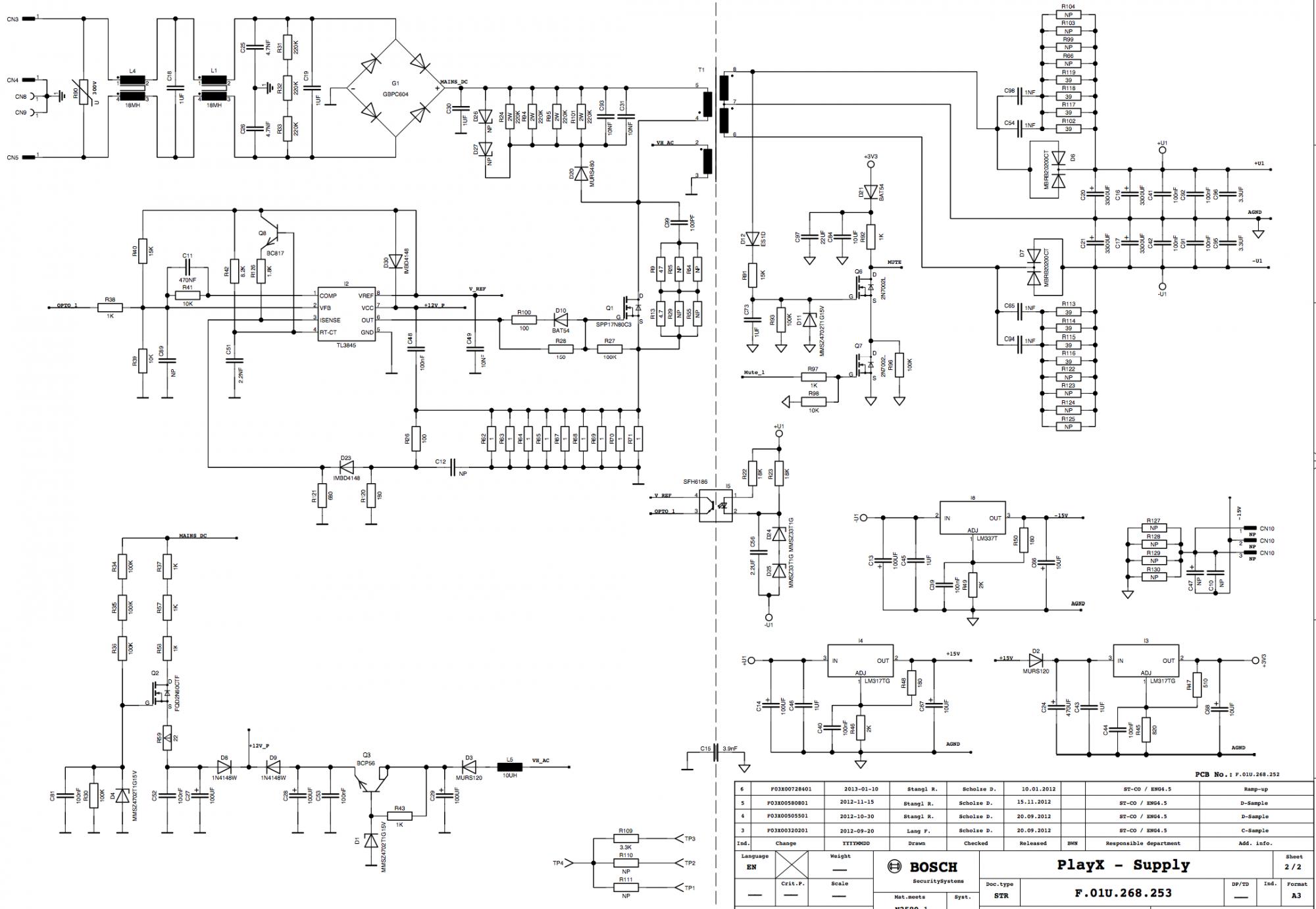

ZLX12P , Electro Voice monitor speaker schematic please

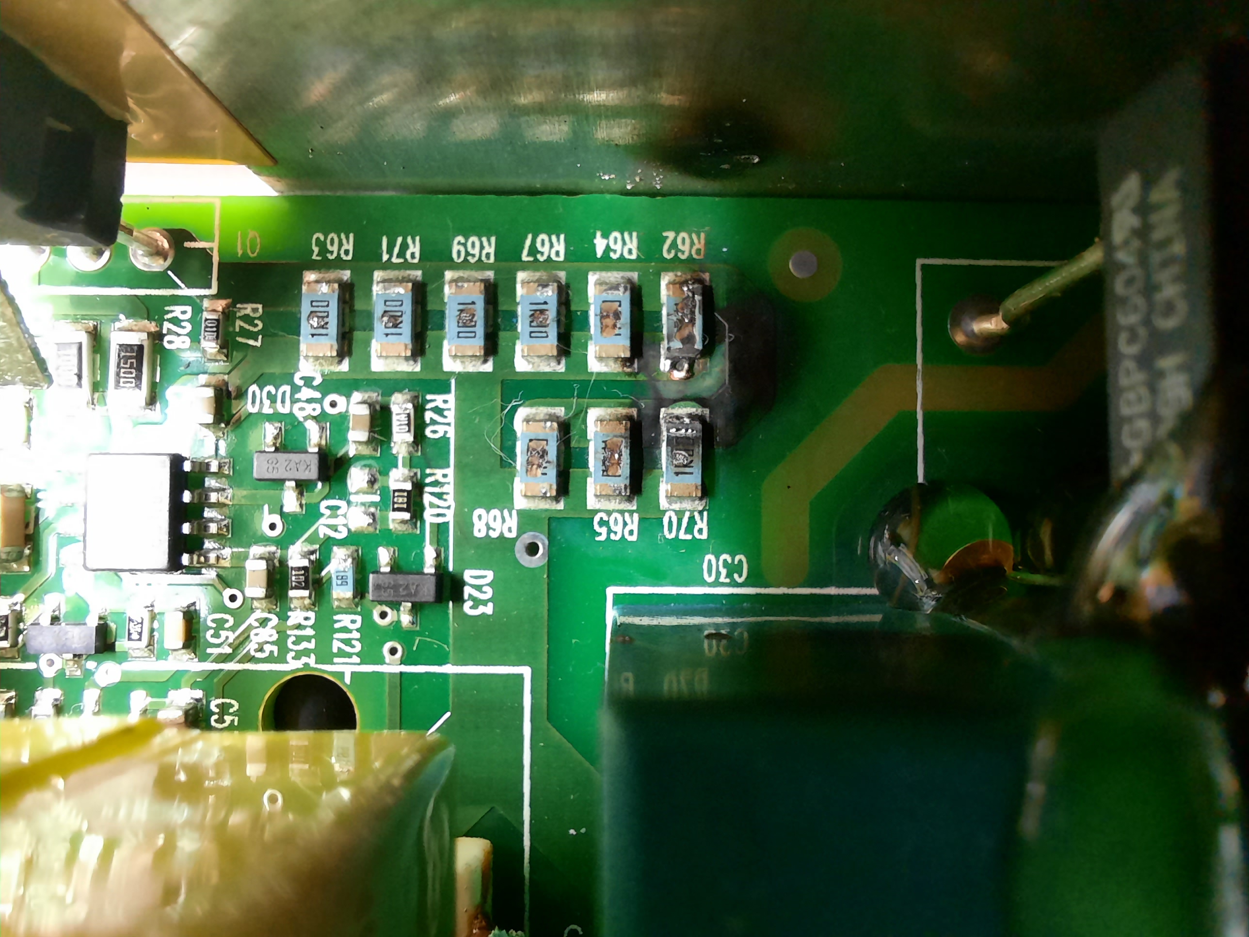

    Hi all
    This is my next repair project .
    There are a string of resistors connected in parallel that are visibly burnt . ( see picture )
    I suspect they are all 1R in value , but would like conformation before proceeding .

    Re: ZLX12P , Electro Voice monitor speaker schematic please
    Yes, all resistors are 1 ohm

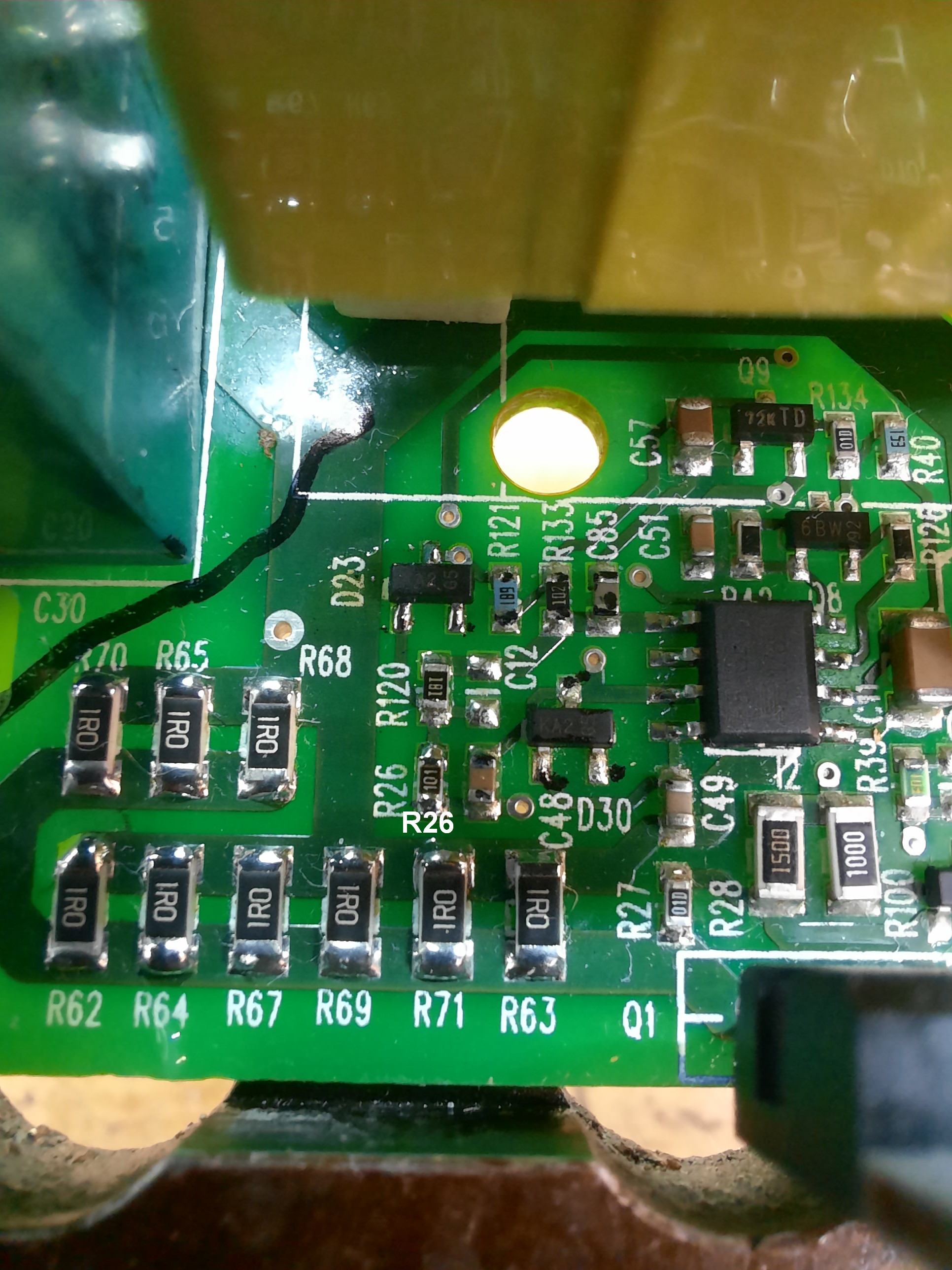

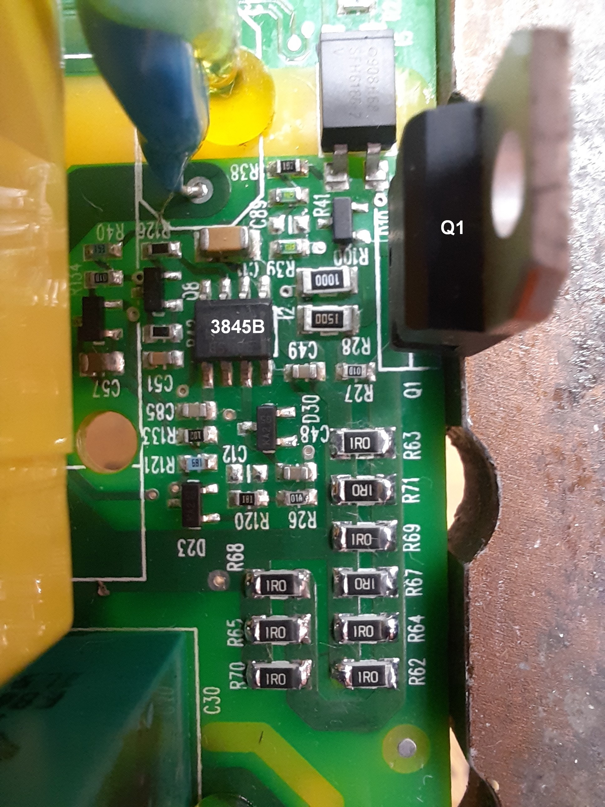

        Customer finally gave me the go ahead .
        Replaced all the 1R resistors mentioned
        Q1, ST Electronics 20N95K5 , S/C
        Also replaced control chip , Texas Instrument 3845B , with one i hope is the ST Electronics equivalent UC3845BD1.

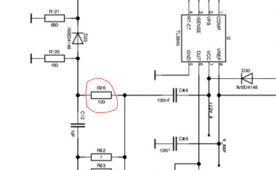

          R26 ( 01A ) O/C
          Replace with a 100R .
          Can anyone confirm this is correct ? , as schematic showing as 150R , but assume that's a slightly different revision of the board .
            R26-101- 100 Om
              Hi Lotas , thanks
              The 101 is the one i used to replace the original 01A .
                01A - 101 = 100 Om, and about which one you wrote that it was at 150 Om.
                  Ok , thanks .
                  Now working & on test .
                    Also removed cheap glue on board indiscriminately used over the electronics ,plus replaced the 2 yellow looking thermal pads on same heat sink as FET replaced , as they seemed to have started to break down , which potentially may have been the root cause of failure .
