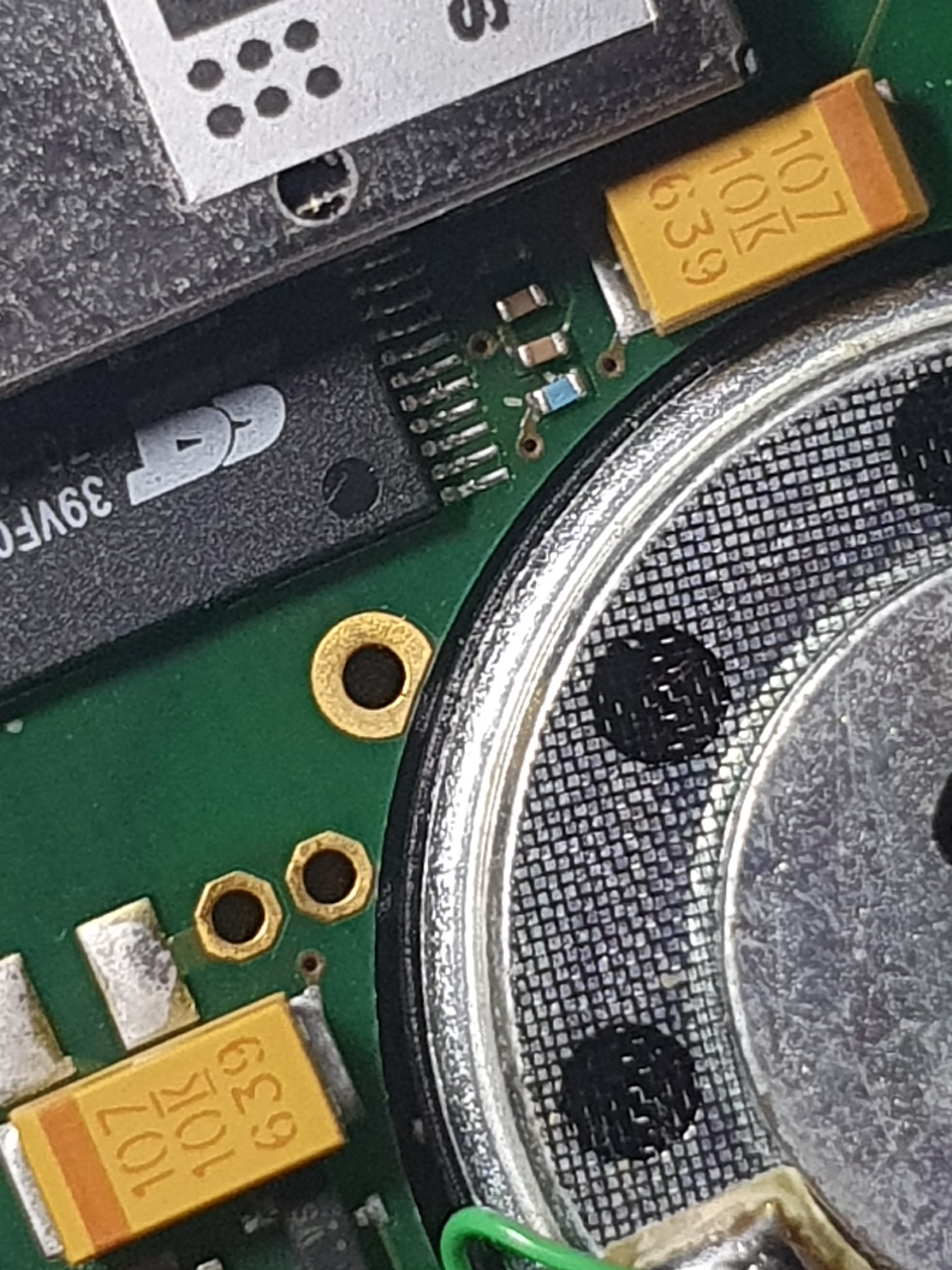

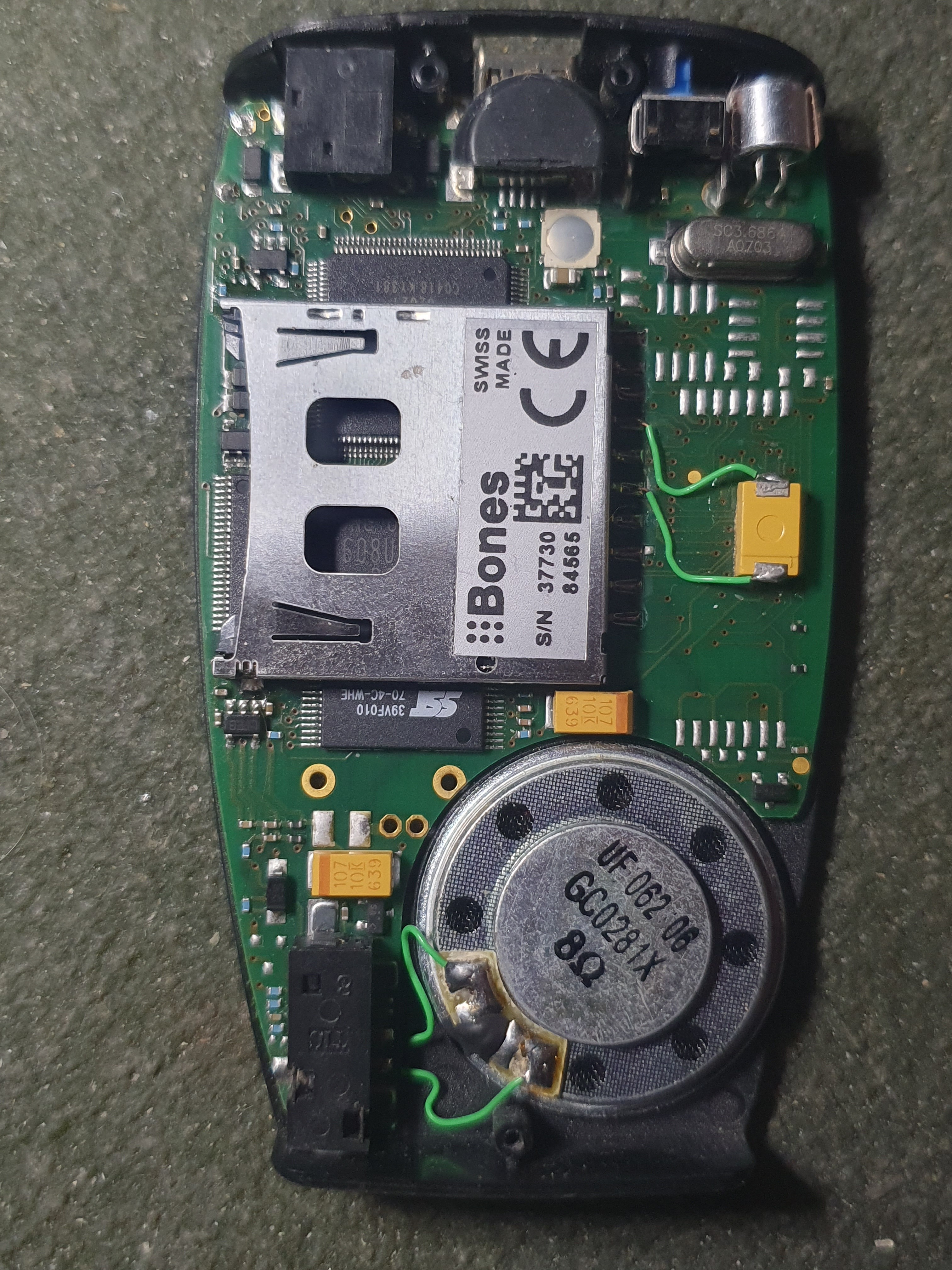

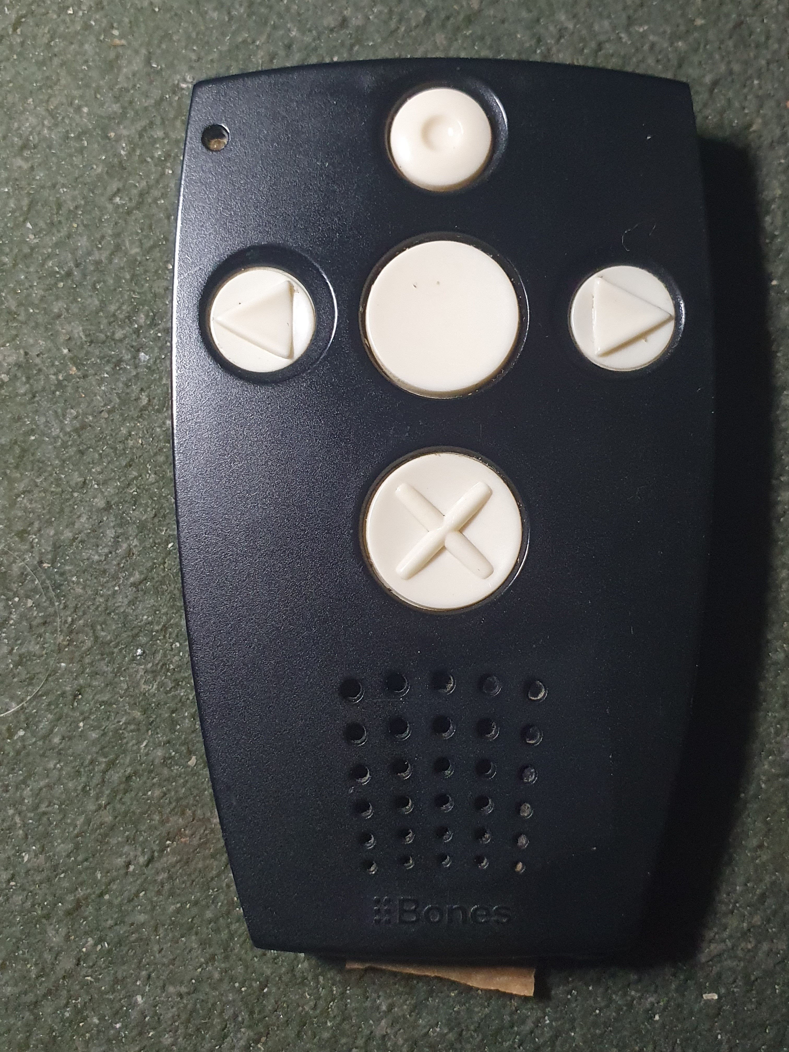

    Hello, I have 2 voice recorder to repair. Same issue : whistle in the speaker, but the sound is good with the headphones (via jack audio plug).
    Built in year 2000, I guess that could be the (yellows) capacitors ? What do you thing about that please ?
    (I found the specs : tantalum-polymer capacitors 100uF 10v 10%.)

      lower left under the card socket looks *interesting*
      maybe remove the card socket and clean the pcb

          Yes I just saw that on picture : lower left under the card socket seems could be a solder bridge with wire, but it’s only flux and dust because I desoldered the card socket (plastic stuck inside).
          I need to check one speaker state because it make a bad noise but I have 2 devices, twice make the same Whistle and it is electronic : I heard it in speakers and headphones (I restested, sorry). It is permanent, it is present in audio menus for navigate, when reading mp3 files, etc. This whistle in constant when I turn the volume up and down.
          But the whistle frequency variate a little when the devices goes on : the frequency could up to x2.
          With 25 years old, I guess that could be capacitor. But I wouldn't want to discriminate against a component community. I will remove (desolder) the speaker for test…

                Yes but we can forget the speaker now, I desoldered it (2 wires) for 2 devices, and the same. Same whistle in the headphones. The whistle frequency change a little when I push on buttons.
                These devices are too small and simple to have ground issues, I assume the problem is more likely a frequency filtering component that has changed its value. Because both devices have the same problem and are the same age: 25 years.
                I could try to replace yellows tentalum capacitors by black ones (if I have) ? Or better ones ?

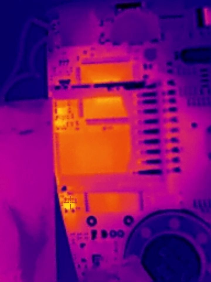

                  Charger is 6v and the internal battery is 3,7v, so buck.
                  And there is an USB connector for managing files via a computer.
                  There is 2 regulators one for battery use, one for charger use and charging mode (chips heating a little under thermal camera) :
                  LP2992
                  https://www.ti.com/lit/ds/symlink/lp2992.pdf
                  and LP3985
                  https://www.ti.com/lit/ds/symlink/lp3985.pdf
                  Those chips have output capacitor for frequency filtering, I will try to replace it by news.

                    I learned this device is mostly used on battery mode and in this mode, there is no whistle. So don’t care for this whistle witch is only on plugged mode.
                    Indeed the whistle probably come from switching power supply. Bad design ; I saw a very long track around the chip when the datasheet recommand very short track to avoid mass loop effect.
                    I found an audio chip with DAC and analogic amplifier and stuff for speaker on board, but it is good because the whistle is not amplified, it is constant. So the issue come before.

                      I have a question please ?
                      I have not trust on this device’s design (Swiss). I saw 3-4 bad thinks inside.
                      Now, I have doubt on yellow (tantalum-polymer) capacitors.
                      Why they are so big ? There is no voltage above 5v inside and the max working voltage is close 3.5v. And it is low power device.
                      The one soldered with wires (from factory) is 100uF 10v.
                      Why tantalum-polymer and not ceramic ?
                      I can’t understand this design choice ?
                        • 31255
                        ceramic are shit,
                        microphonic < look that up!
                        and sensitive to temperature.
