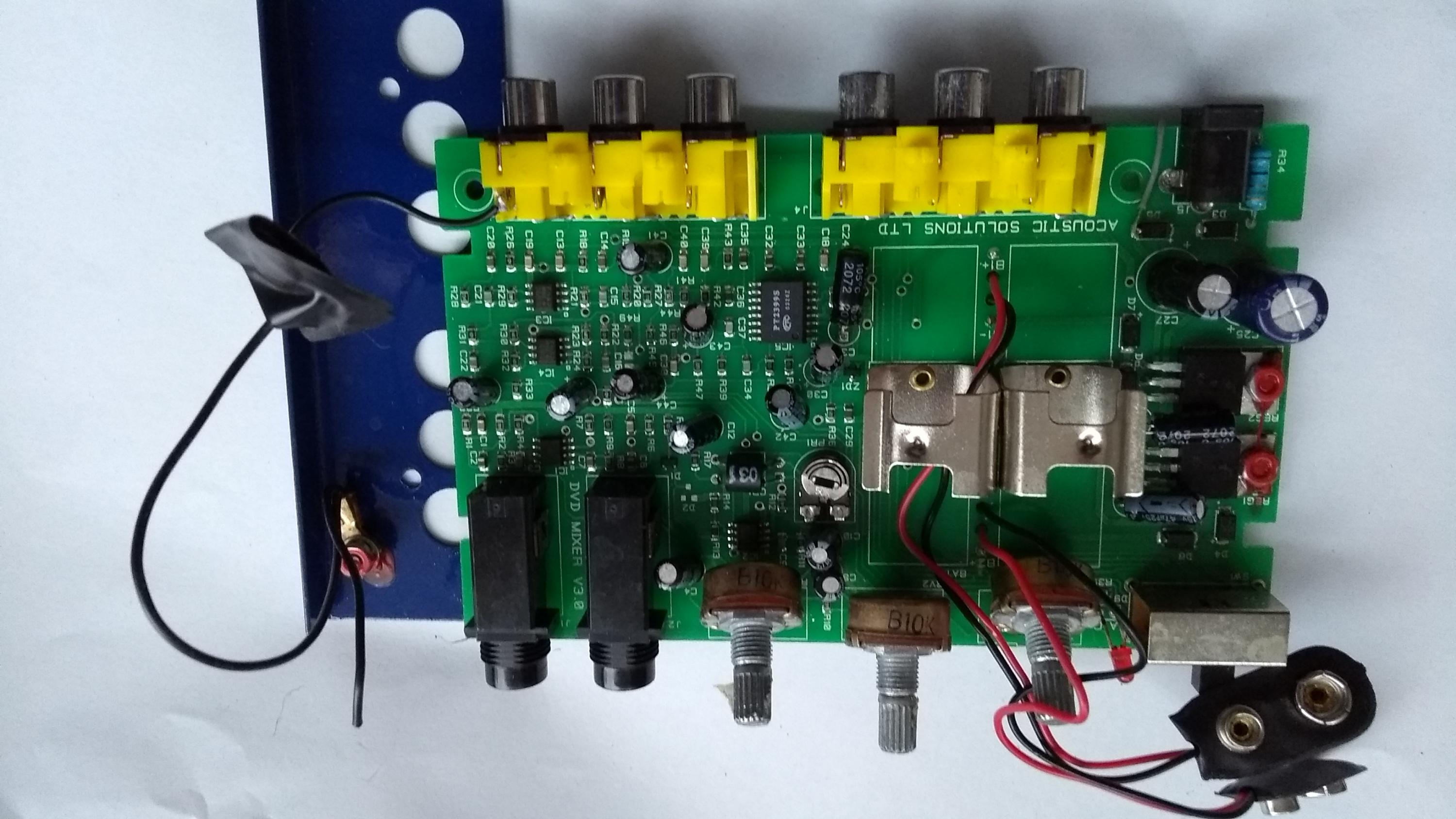

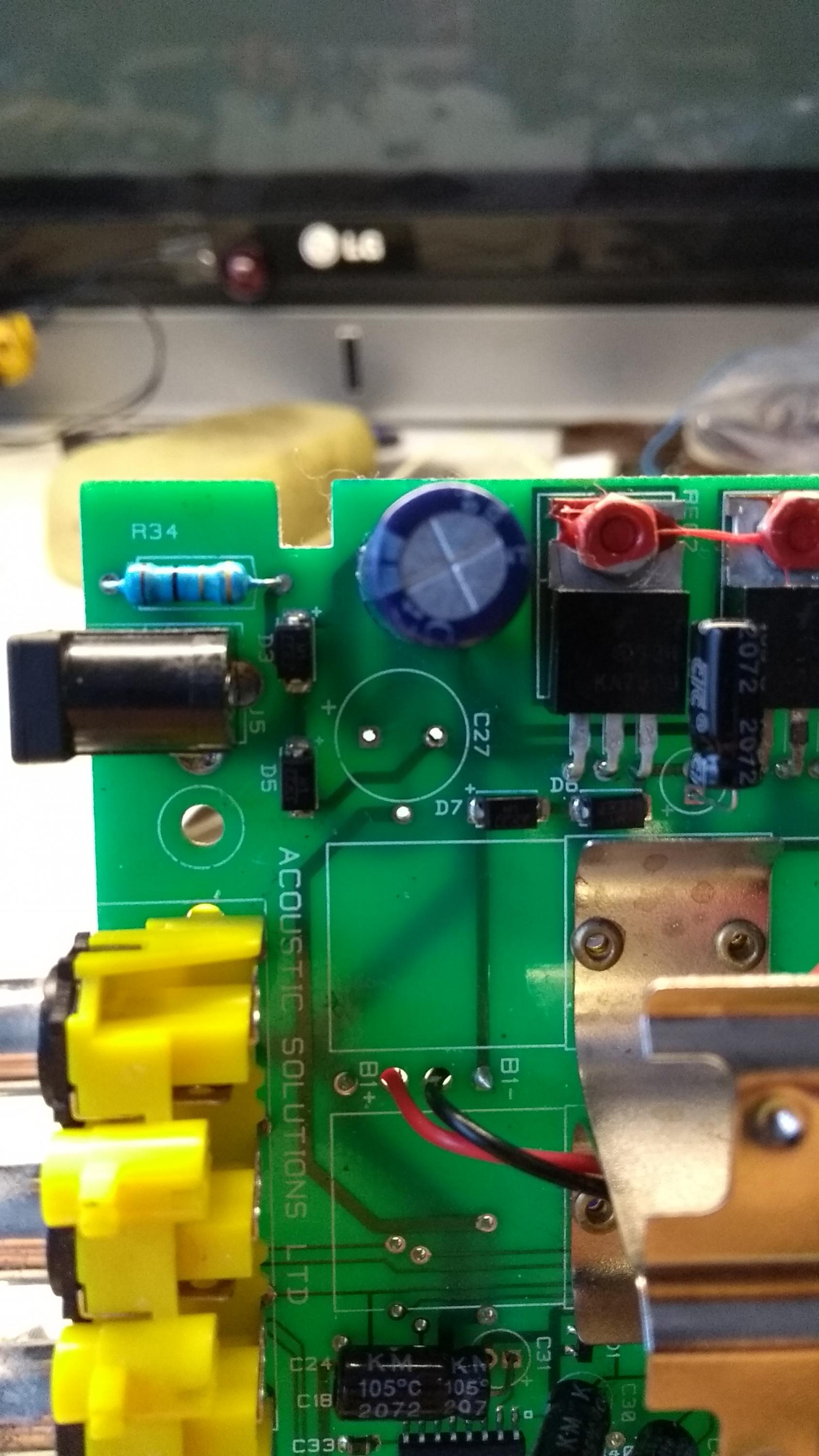

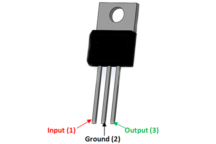

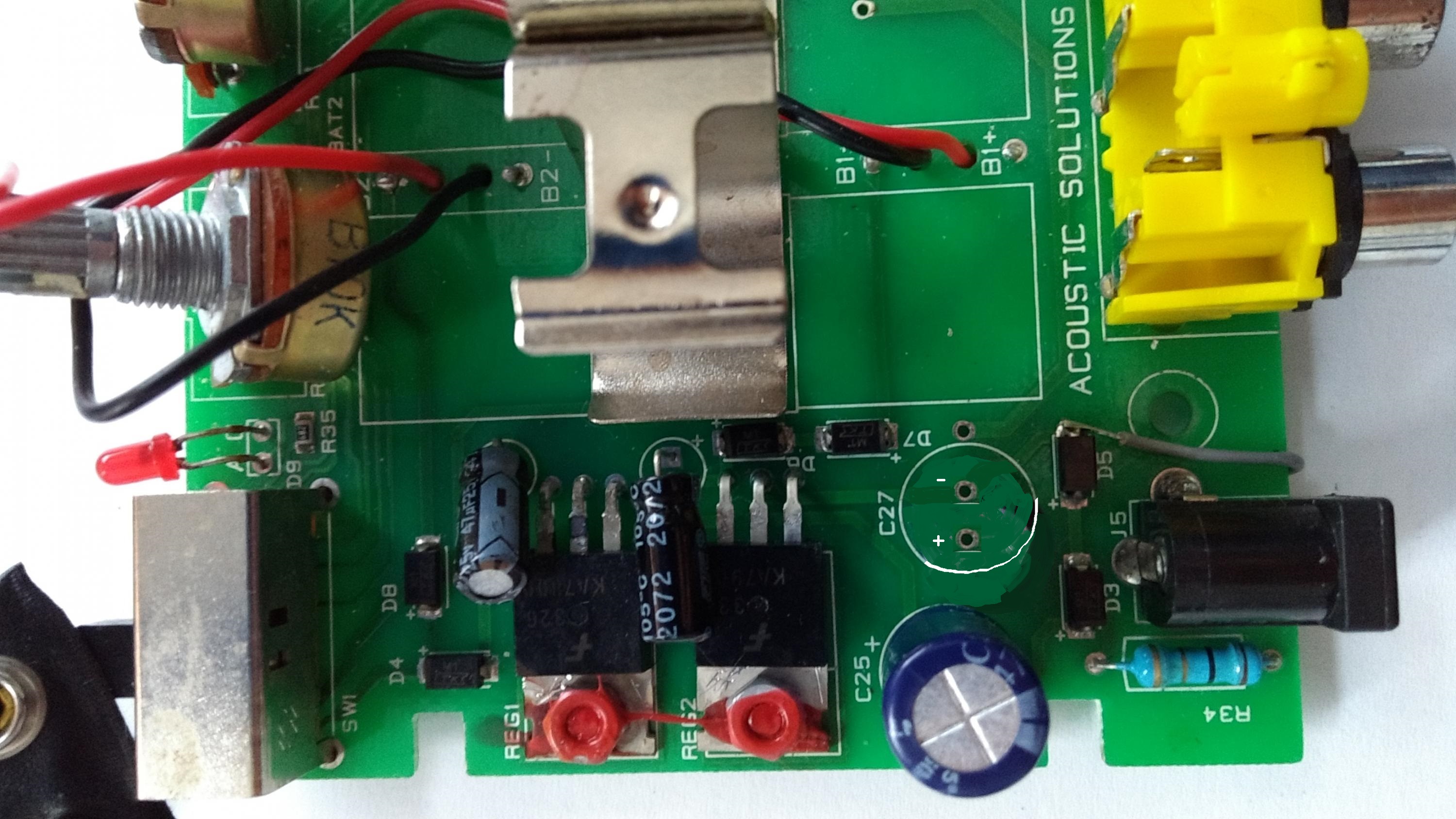

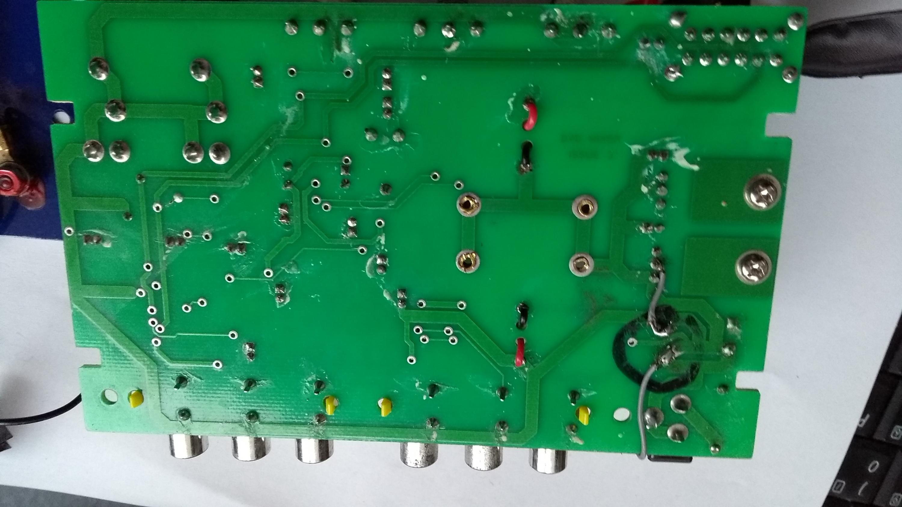

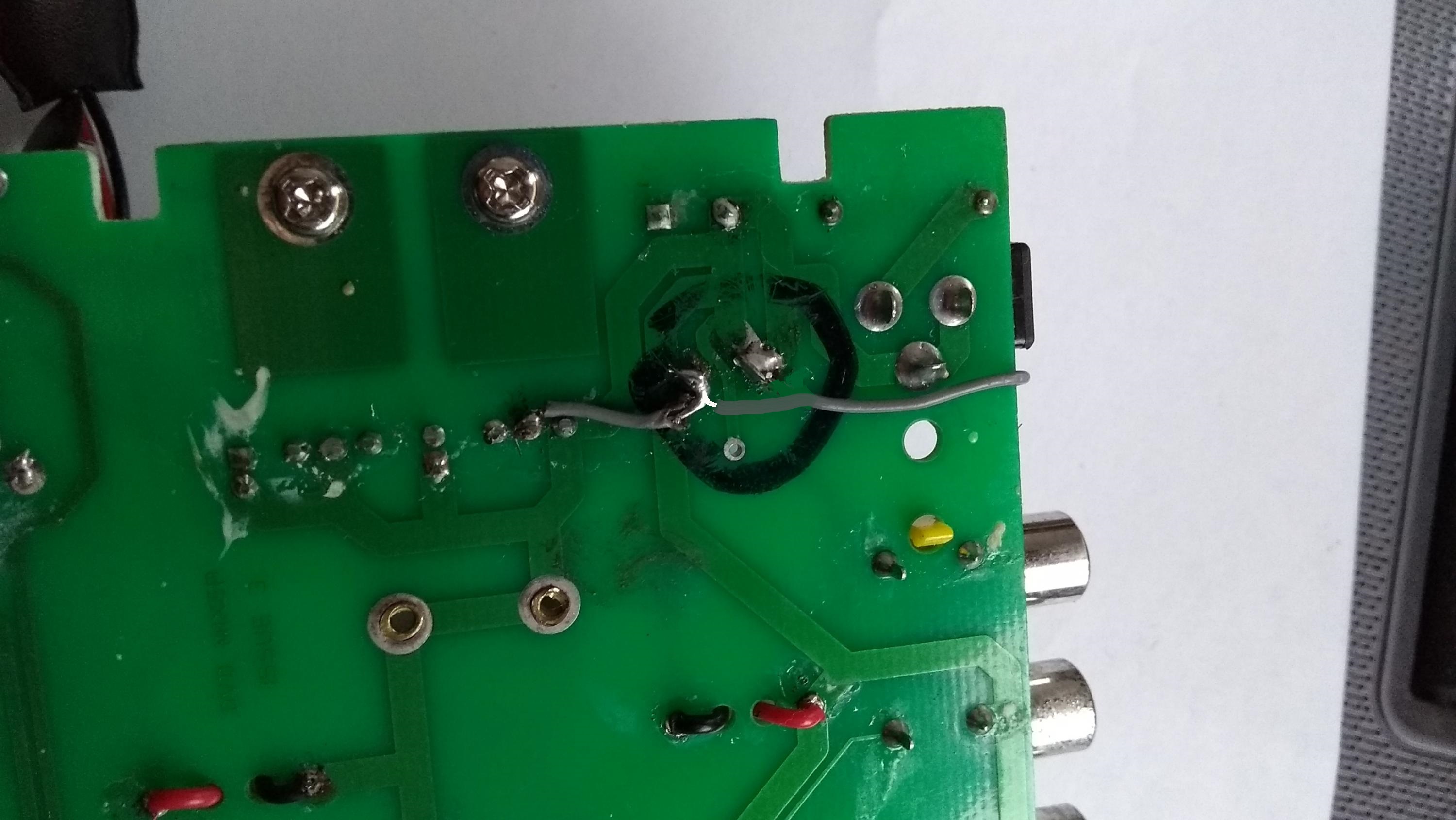

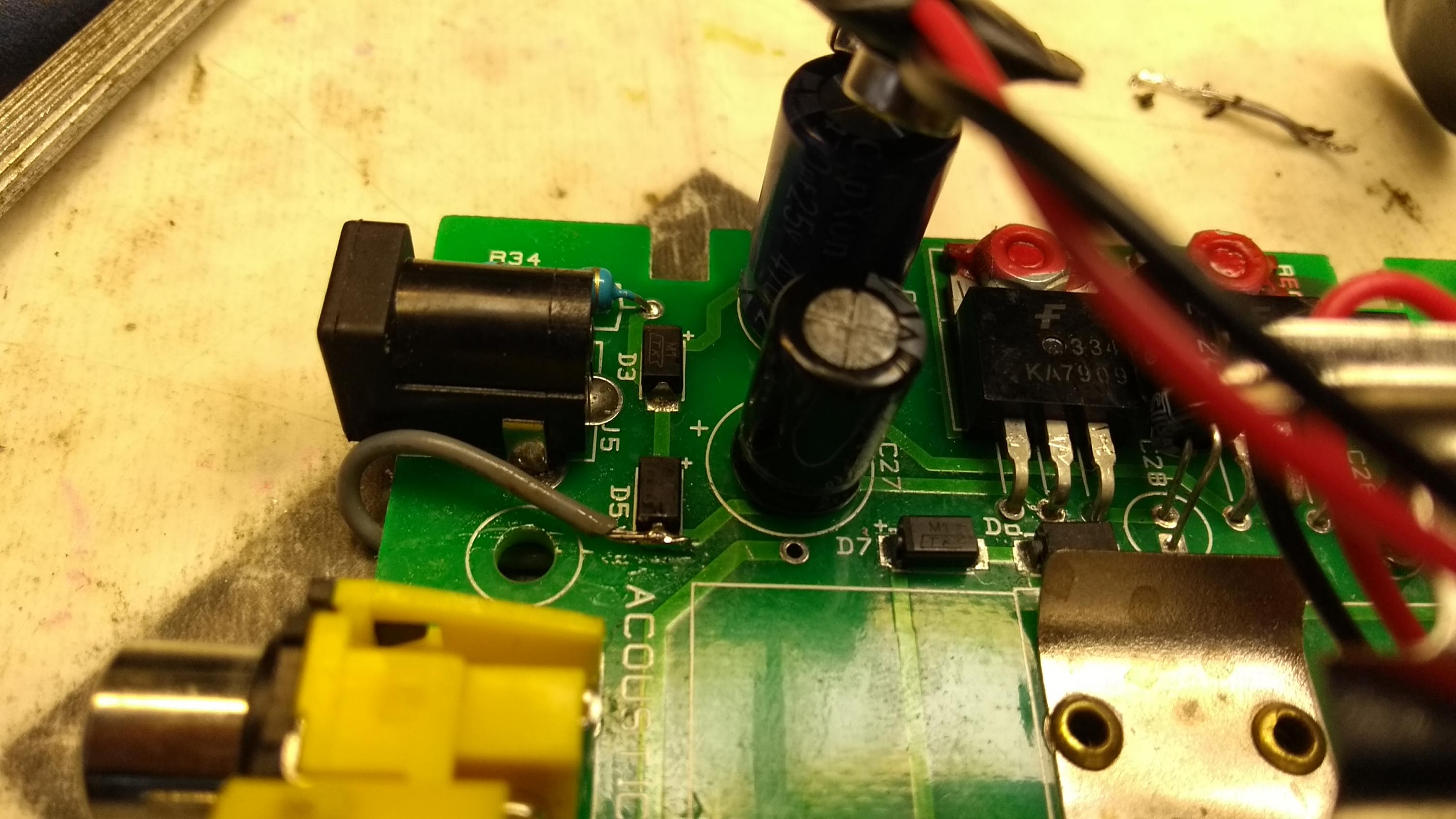

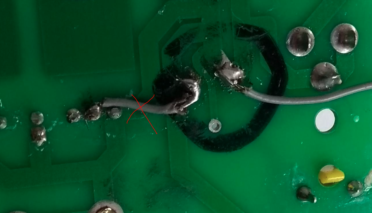

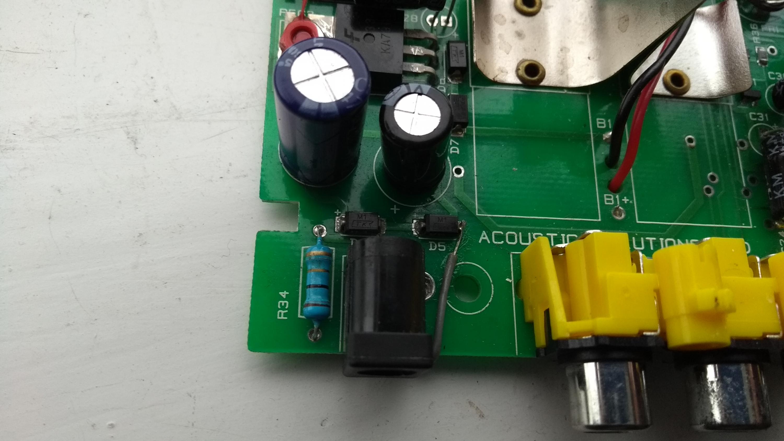

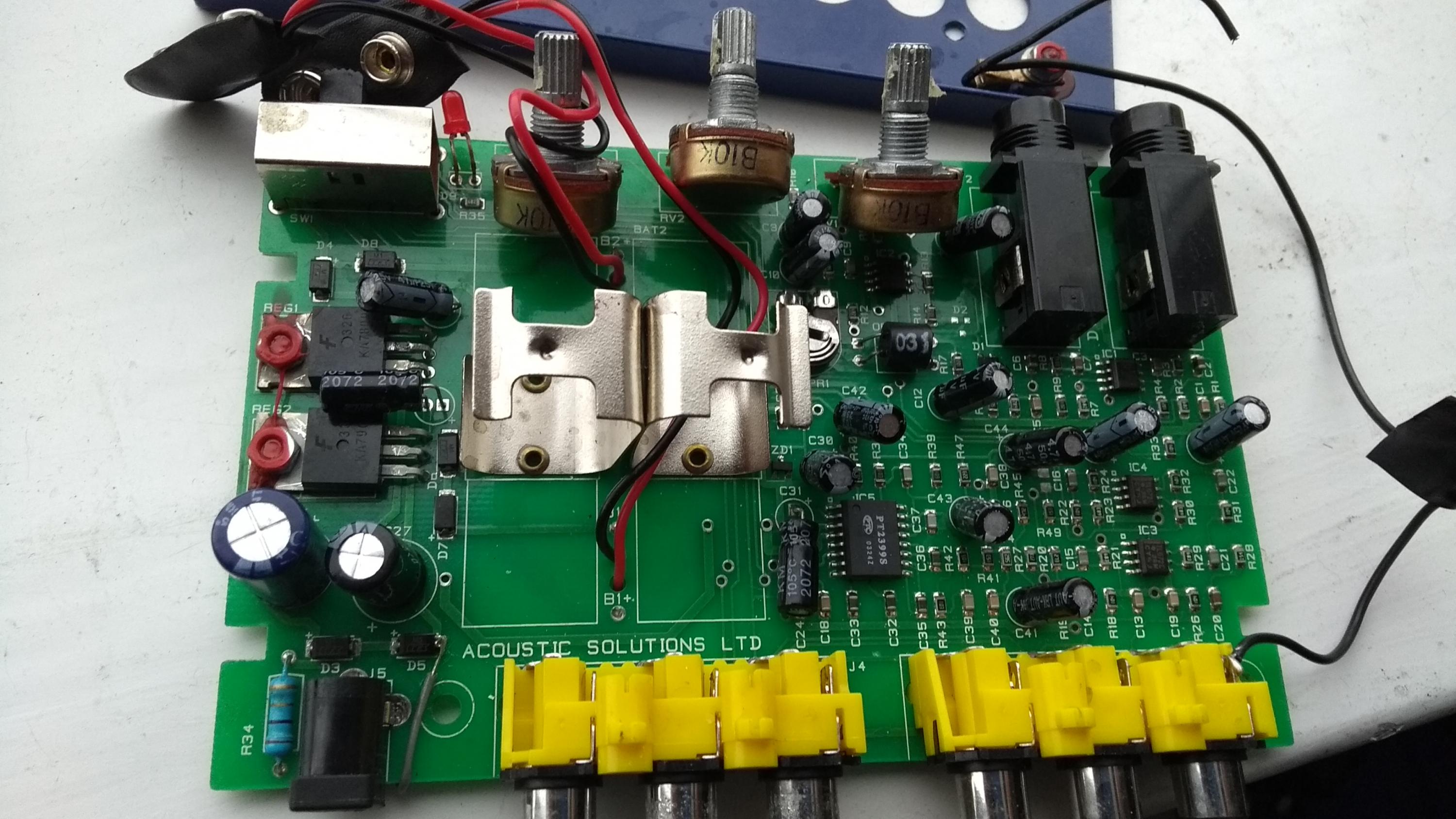

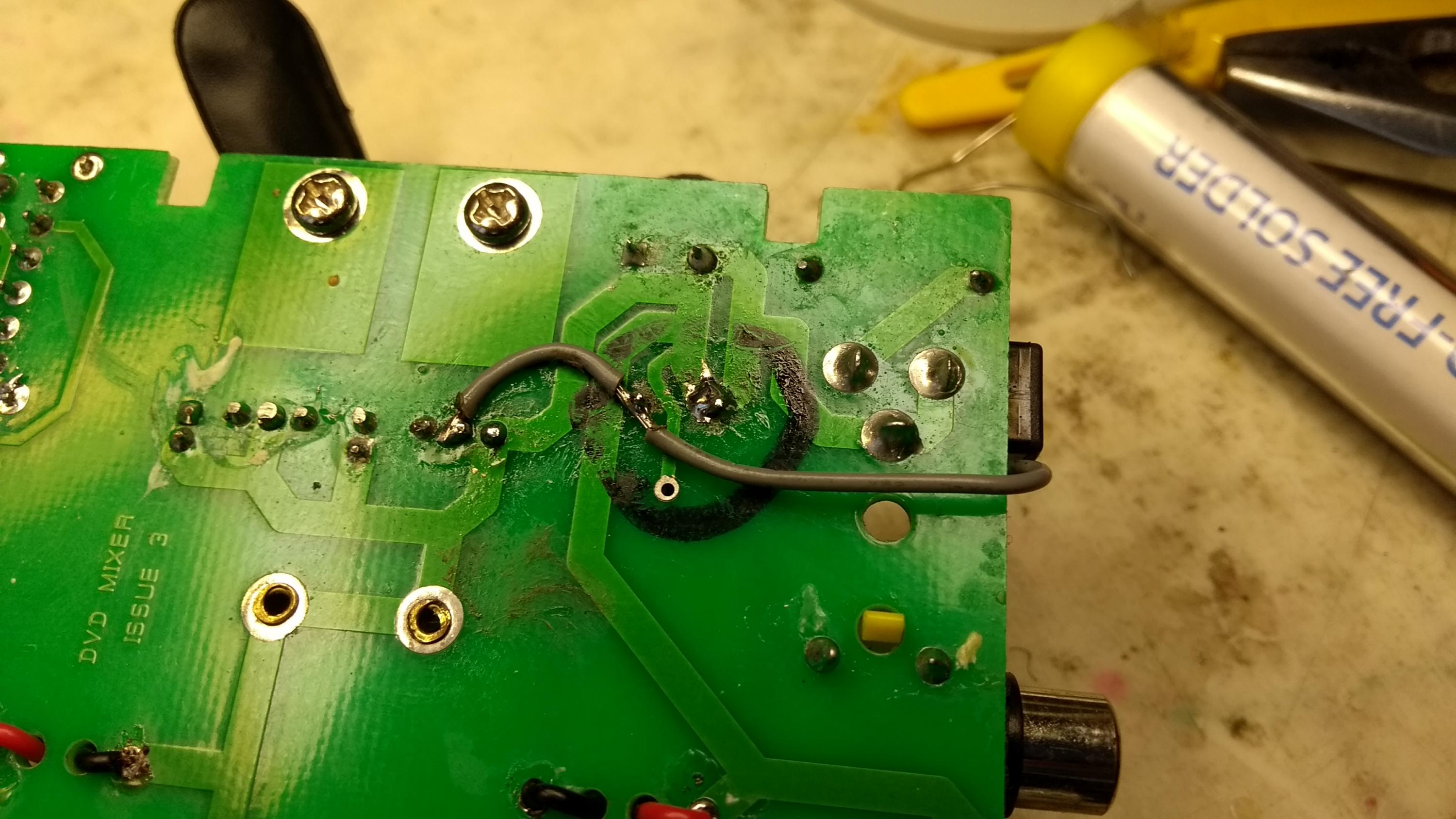

Kareokee amplifier not working
  • Cornboats
    Dave
    • Oct 2010
    • 232
    • United Kingdom
    Kareokee amplifier not working
    This has been in my pile of not working and needs fixing pile for some time.
    It works using 2 x 9v batteries plugged into the supplied flyleads as picture but the 12v Dc power supply input from mains supply doesn't work. There's 12v dc coming in from the jack and 12v between jct of D3 and D5. There's a 0.6V drop across d3 supplying positive voltage regulator KA7809 thro capacitor C25. This regulator has healthy 12v output.
    Theres no voltage drop across D5 and no input voltage into negative voltage regulator KA7909. I've changed capacitor C27 25v 450 microfarrads. Esr was 30 and capacitance was all over the place. In doing so the circuit track eyes were broken for the capictor so I've soldered in leads direct from D5 and to Ka7909.
    Still no joy- which is why I'm asking you bright fellows for help please. I know nothing about negative voltage rails or why theres here. Can someone help me solve this one please.
    Last edited by Cornboats; 02-22-2022, 04:47 AM. Reason: More pictures to add
  • lotas
    • Jan 2016
    • 4762
    • Russia
    Re: Kareokee amplifier not working
    Why did you put this jumper, you close the positive to the negative! Delete it. 7809 and 7909 have different pinouts.
    • Cornboats
      Dave
      • Oct 2010
      • 232
      • United Kingdom
      Re: Kareokee amplifier not working
      Thanks for taking the time to reply. I haven't put a jumper in, I've just followed the circuit board track exactly. To +capacitor c27 coming from -d5 M1 diode is long wire. From - capacitor c27 to pin 2 of KA7909 is short wire. I had to run new wires from both sides of the capacitor as the track terminals at the capacitor just disintergrated when I desoldered.
      • R_J
        • Jun 2012
        • 9594
        Re: Kareokee amplifier not working
        This should fix it, D5 anode needs to connect to the - of C27 not to the + The positive of C27 is connected to common ground
        I removed C27 from the picture to show how the trace is likely connected under the cap.
        Last edited by R_J; 02-22-2022, 10:03 PM.
        • Cornboats
          Dave
          • Oct 2010
          • 232
          • United Kingdom
          Re: Kareokee amplifier not working
          I made a school boy error running track to + of capacitor. Please see last 3 photos attached. I removed tracks and capacitor to show existing track, then wired in new track from D5 linking at capacitor -C27 then to input of KA7909.
          Still no joy I'm afraid.
          Voltage readings taken are;
          Across D3 0.73v, D3 + to grd 11.33v
          Across D5 11.84v D5 - to + rail 11.84v
          I'll remove KA7909 to see if was pulling down voltage.
          Last edited by Cornboats; 02-24-2022, 04:23 AM. Reason: photos attached
          • R_J
            • Jun 2012
            • 9594
            Re: Kareokee amplifier not working
            What voltage is ACROSS C27? If the voltage is 0, disconnect the power and check the resistance across C27 to see if there is something shorted.
            • Cornboats
              Dave
              • Oct 2010
              • 232
              • United Kingdom
              Re: Kareokee amplifier not working
              voltage across c27 is 0 ( this is a new capacitor), voltage across c25 is 11.22v.
              resistance across c27 is 3M and across c25 is 4M.
              I pulled the KA7909 to see if that affected the readings but there was no difference so I soldered it back.
              What puzzles me is that the negative voltage regulator requires a negative input voltage. How is this achieved from a positive dc supply?
              Thanks for taking interest.
              • R_J
                • Jun 2012
                • 9594
                Re: Kareokee amplifier not working
                I think you need an AC adaptor, not a DC one. What is the model of the machine?
                • Cornboats
                  Dave
                  • Oct 2010
                  • 232
                  • United Kingdom
                  Re: Kareokee amplifier not working
                  I think you're right. I just assumed as there was no bridge rectifier in the supply circuit it needed DC and having a battery backup hard wired into the circuit just confirmed my idea.
                  Model no is DVD K1 made by Accoustic solutions, Northampton, uk.
                  I'll dig out an ac adaptor, try it and let you know.
                  • R_J
                    • Jun 2012
                    • 9594
                    Re: Kareokee amplifier not working
                    It is just using 1/2 wave rectification so only one diode for positive and one diode for negative voltage, it doesn't draw much current so that is adequate.
                    • Cornboats
                      Dave
                      • Oct 2010
                      • 232
                      • United Kingdom
                      Re: Kareokee amplifier not working
                      Well done for that. Fitted an ac adaptor and negative voltage to the -voltage regulator is restored. Quality of sound at the speakers is not very good though. Could be the stand alone speakers. I'm going to connect up the amp thro a tv & dvd to see if its any better. There are loads of caps on the board, maybe some of those have dried out.
                      • Cornboats
                        Dave
                        • Oct 2010
                        • 232
                        • United Kingdom
                        Re: Kareokee amplifier not working
                        So I checked every single capacitors ESR and found all within tolerance. The only one I changed was C27 which was across power to negative voltage regulator. The ESR on the old one was 23.00, average for this spec is 0.12. The capacitance should have been 470 UF but measured 86.7NF.
                        The crackling and sound distortion I managed to remove by turning down the echo and microphone volumes. All in all I treat this as a result. Many thanks for the Forums help. More broken and in need of repair items coming out of the box.
                          MT3608 Step-Up Converter IC Datasheet
                          The MT3608 is a constant frequency, 6-pin SOT23 current mode step-up converter intended for small, low power applications. The MT3608 switches at 1.2MHz and allows the use of tiny, low cost capacitors and inductors 2mm or less in height.
                          Internal soft-start results in small inrush current and extends battery life.
                          The MT3608 features automatic shifting to pulse frequency modulation mode at light loads. The MT3608 includes under-voltage lockout, current limiting, and thermal overload protection to prevent damage in the event of an output overload. The MT3608 is available...
                          10-07-2024, 05:02 AM
                        • disorder
                          HP 2311 display, 3.3v regulator fried, need help to replace
                          by disorder
                          hello,
                          i have a hp display 2311 to repair, totaly dead
                          on the board, il have 2 capacitor 470µf that are dead and the 3.3v regulator : ax6630-33
                          i have no such regulator, can i replace this one with a mic5209-33 (3.3v outpout regulator too) ?
                          thank you
                          07-27-2025, 04:34 AM
                        • bilux
                          uP0109: 2A Ultra Low Dropout Linear Regulator equivalent substitute
                          by bilux
                          I want to find a replacement for uP0109 8pins, and i found this parts:
                          uP0109 is "2A Ultra Low Dropout Linear Regulator"
                          RT9199 is "Cost-Effective, 2A Peak Sink/Source Bus Termination Regulator"
                          FP6137C is "2A BUS TERMINATION REGULATOR"
                          can replace uP0109​ by RT9199 or FP6137C ?
                          11-01-2024, 12:00 PM
                        • MrCommunistGen
                          Polk Audio RTi100 Plate Amplifier won't power on and intermittently honks and buzzes
                          by MrCommunistGen
                          My childhood best friend was killed about 9 years ago. His parents are finally letting go of his things, and they offered me his Polk RTi100 tower speakers. The Polk RTi100 towers are one of a handful of designs from the early 2000s that is a full range 3-way tower with a built-in self-powered subwoofer. This is accomplished with a plate amp integrated into the speaker input panel.
                          I think they used them for a while, but they've been sitting for at least a few years now. After about 40 hours of driving to their house and back (both they and I have moved in the last 9 years) I got...
                          07-12-2021, 05:11 PM
                        • jinu_j
                          How to test Subwoofer Amplifier with only a multimeter
                          by jinu_j
                          Hi Folks
                          Need some advice on how to test a subwoofer amplifier if i have access to only a multimeter.
                          Problem
                          I have a Boston Acoustics active Subwoofer (soundware S). Its rated output is 200W. But the output i am getting is very low i can barely hear/feel it even if put the gain at max. I replaced all the capacitors in the Subwoofer amplifier but still no change.
                          Is there anyway to test this without getting an oscilloscope/Function generator to see if the fault is with amplifier, driver or the source??
                          Any advice would be appreciated...
                          08-29-2024, 02:05 AM
