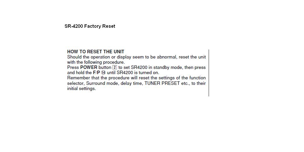

    Hello boys! I have the receiver Marantz SR5200. Could somebody tell me please how to make reser to the FACTORY? Thank you for reply. Miloslav

      Re: Receiver Marantz SR5200 - Factory reset
      Here is the procedure for the SR-4200 there is a slim chance it might work but it may not.
      F/P button on yours is (15) in the SAR-5200 manual

        Thanks, but it does not work. However I have already found out. It is needed to press simultaneously the button A/D and DIMER for more then 3 seconds.
