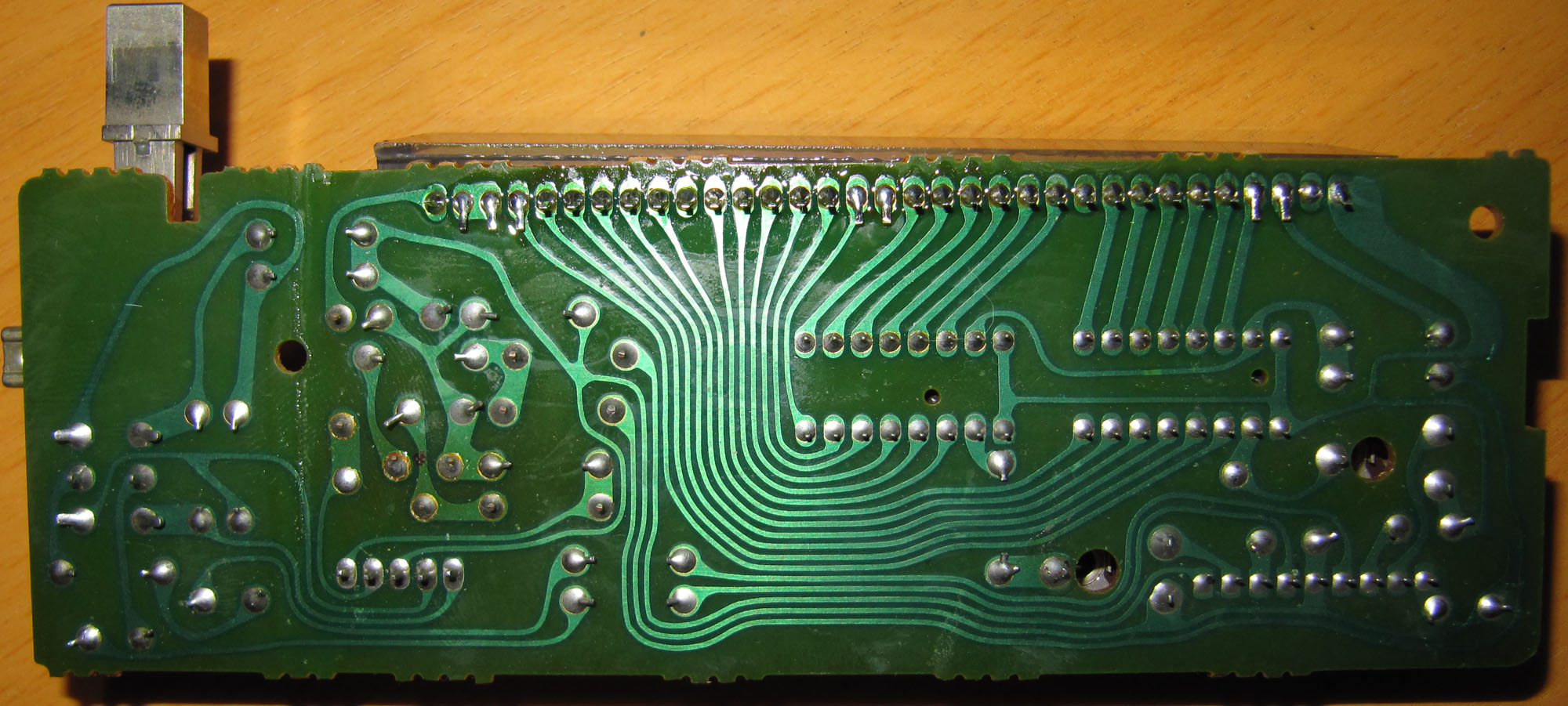

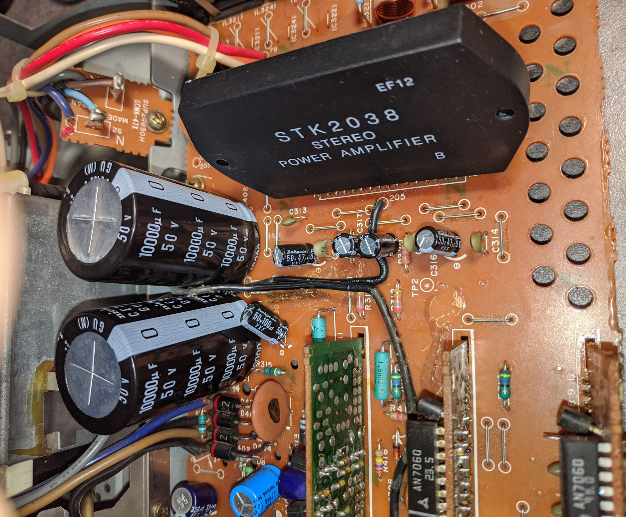

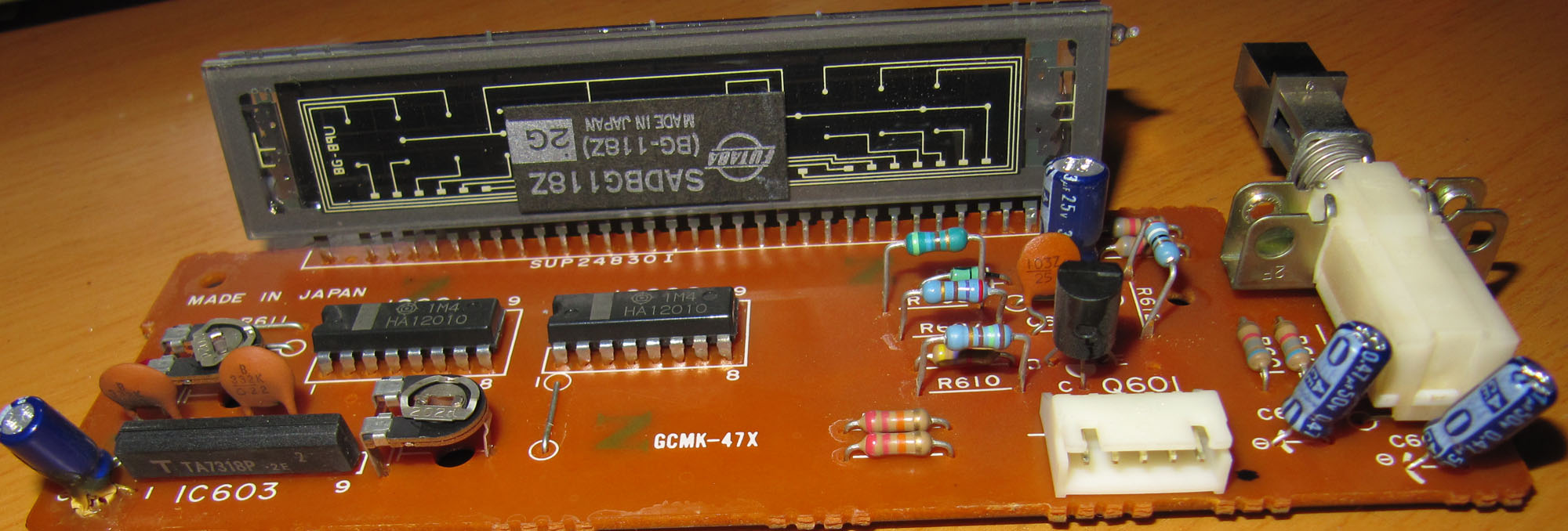

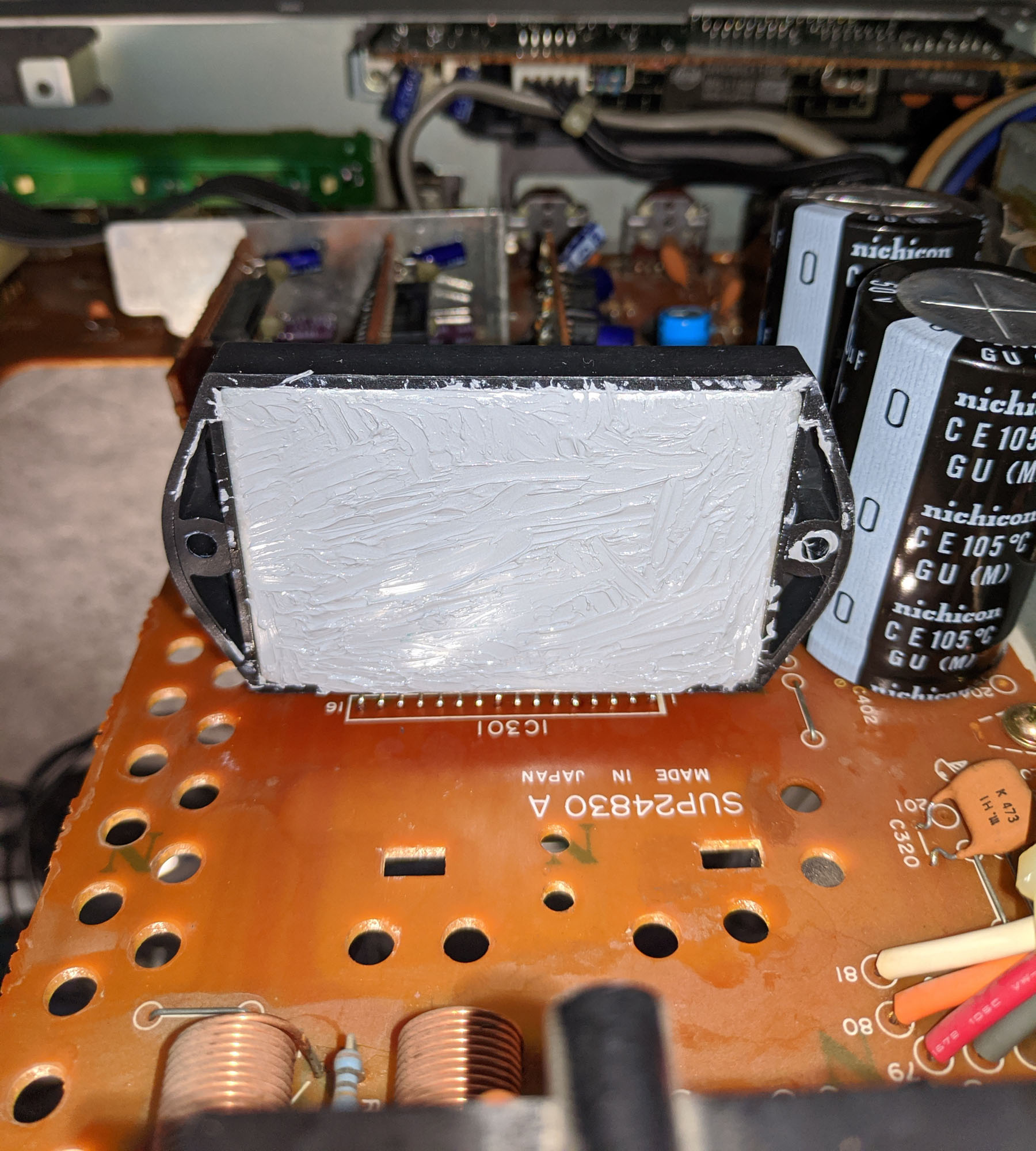

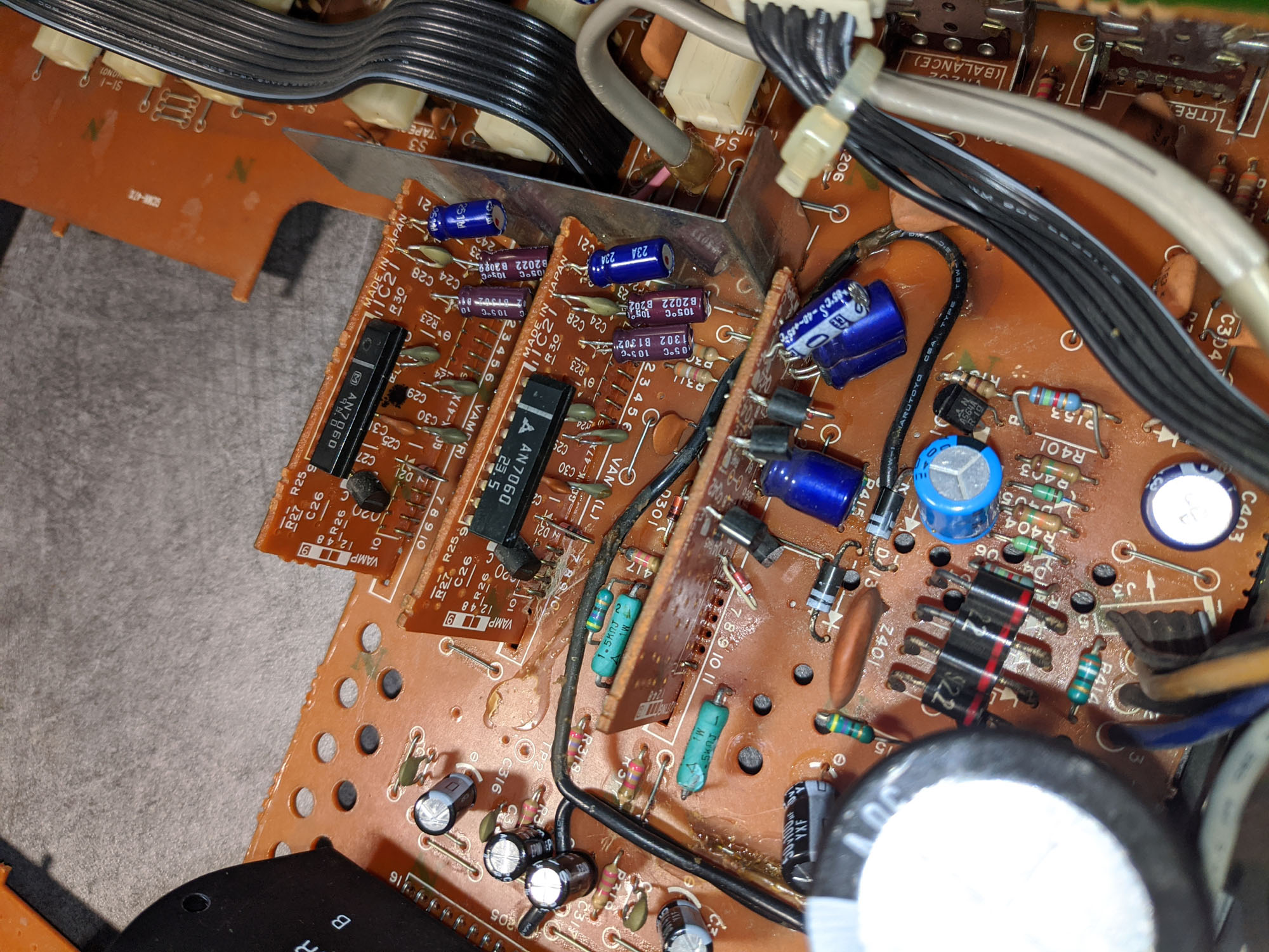

    Got this for free, previous owner said when he connected speakers on amplifier he heard very loud cracking noises and immediately disconnected it to avoid damaging speakers and he was going to throw it away.
    When I opened the case I didn't notice anything visibly burn/bulging.
    Then I connected some suicidal speakers and turned on amp. Nothing.
    Then played with volume control and heard noises that could be due to dry/dirty potentiometer.
    Then connected audio input and retried. Left channel was working but the right channel was dead and when cranking up volume, it would make terrible noises indeed, now I get why previous owner got scared.

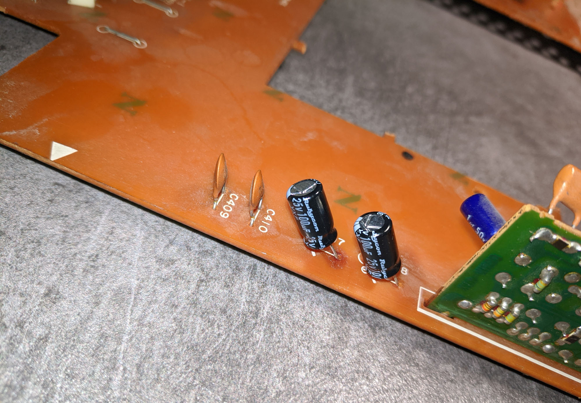

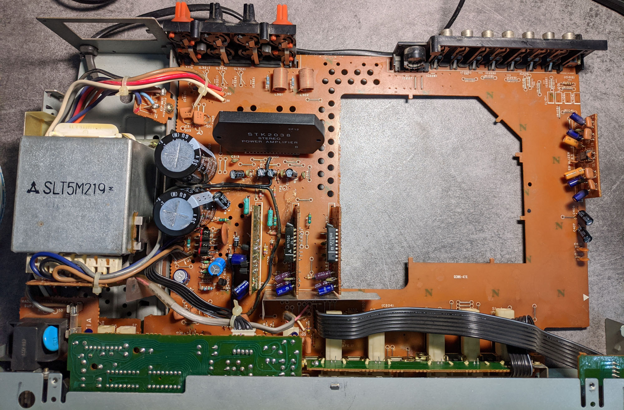

    I checked every cap and found 1 cap that has gone short circuit (0uF capacitance , 5-15 ohm resistance).

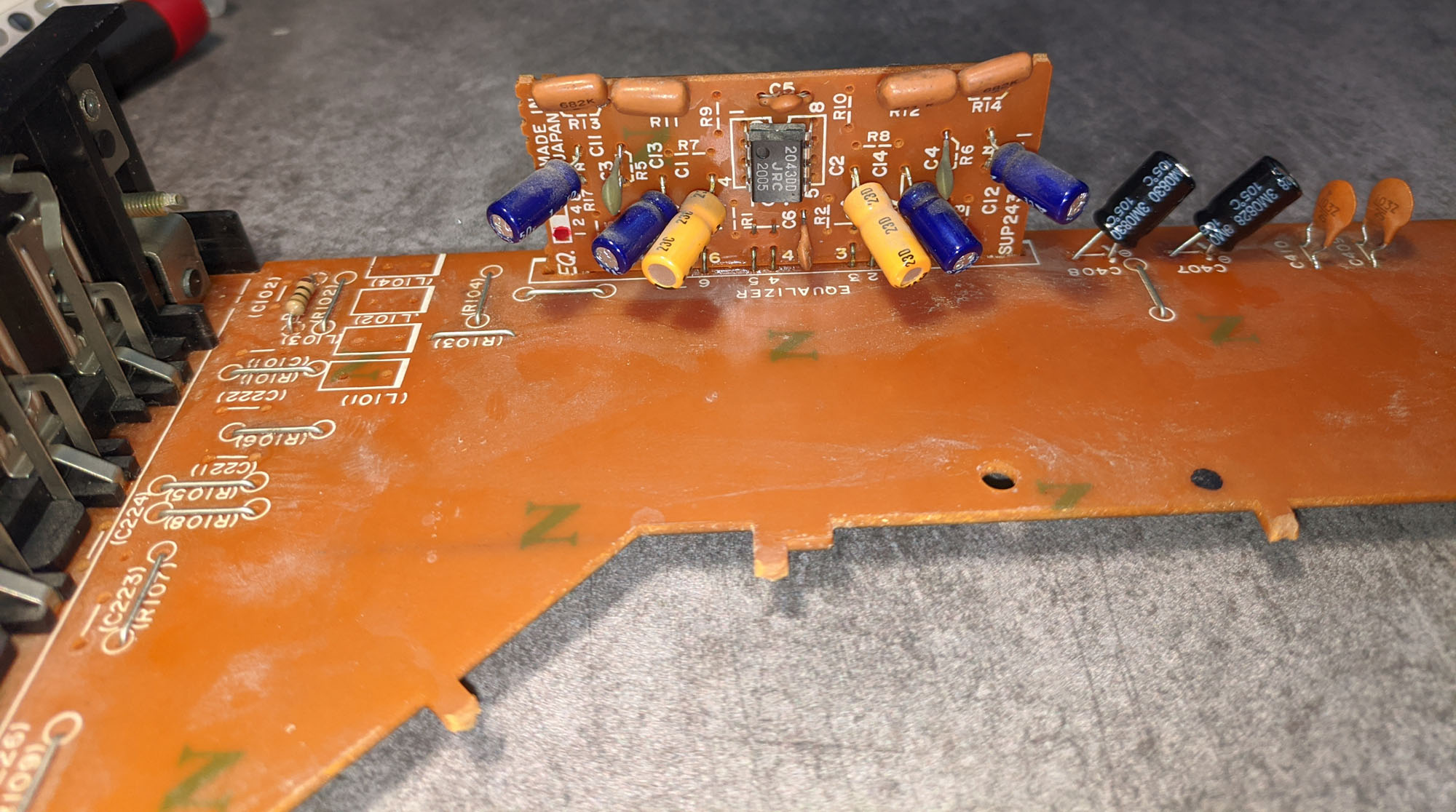

    I also found some caps that have started to go high esr.
    Caps had date codes of 1982, so I proceeded to preemptively replace most of them including the bad ones, using exclusively good Japanese brands 105c and entry level low esr.
    Unfortunately the amp uses the dreaded STK IC Here it is STK2038B (not to be confused with STK2038II , they are totally incompatible!) and the right channel is dead.
    Sanyo has stopped producing them since late 90s, so it is nearly impossible to find original ones. I was lucky to find some probably fake Chinese clone. Costed me around 10 euros and when it finally arrived, checked it and found it noticeably lighter than the original broken one
    So, I replaced faylty STK with good working one and also cleaned the switches and pots with CRC contact cleaner and the amp is working again!

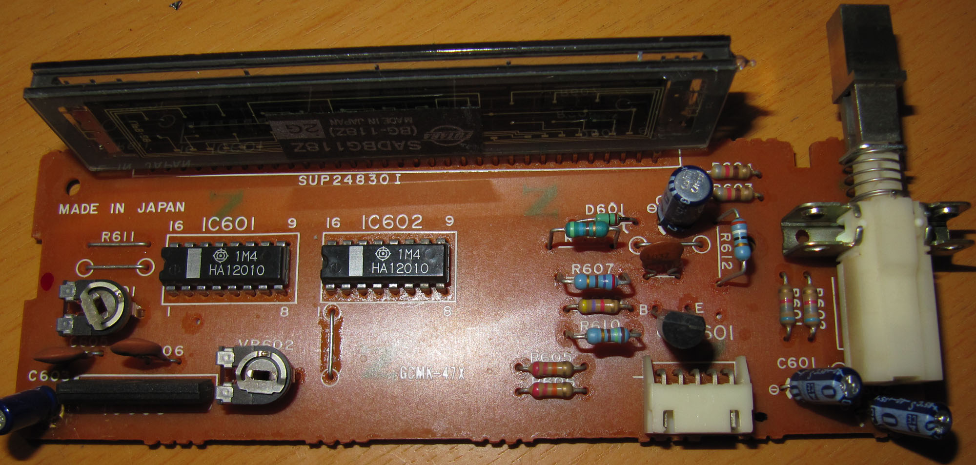

    I attach some pictures that I took during repair, unfortunately I forgot to take an overall photo of the amp before putting back the metal cover.

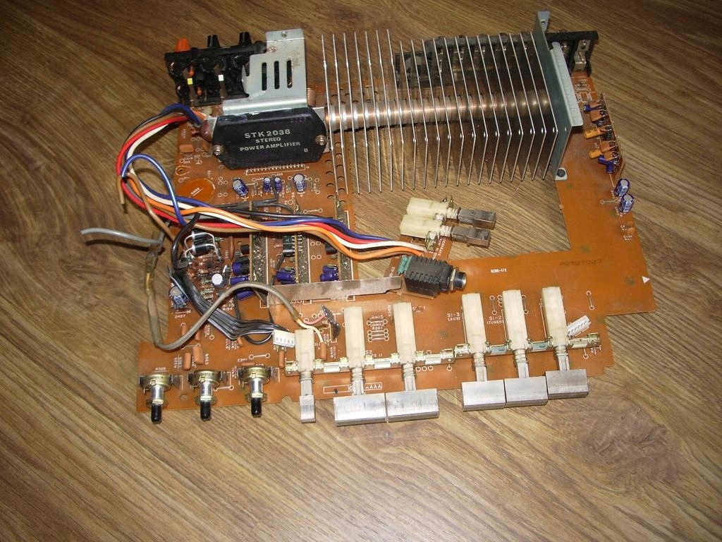

    Here are 2 photos from the internet:
    http://nvivo.free.fr/Site/Technics_SU-Z45_files/3_1.jpg
    https://www.avsite.gr/forum/proxy.ph...f9819d9d5638a6
    I also replaced the 2x 6800uF main caps with 2x 10000uF 50V Nichicon GU 105C

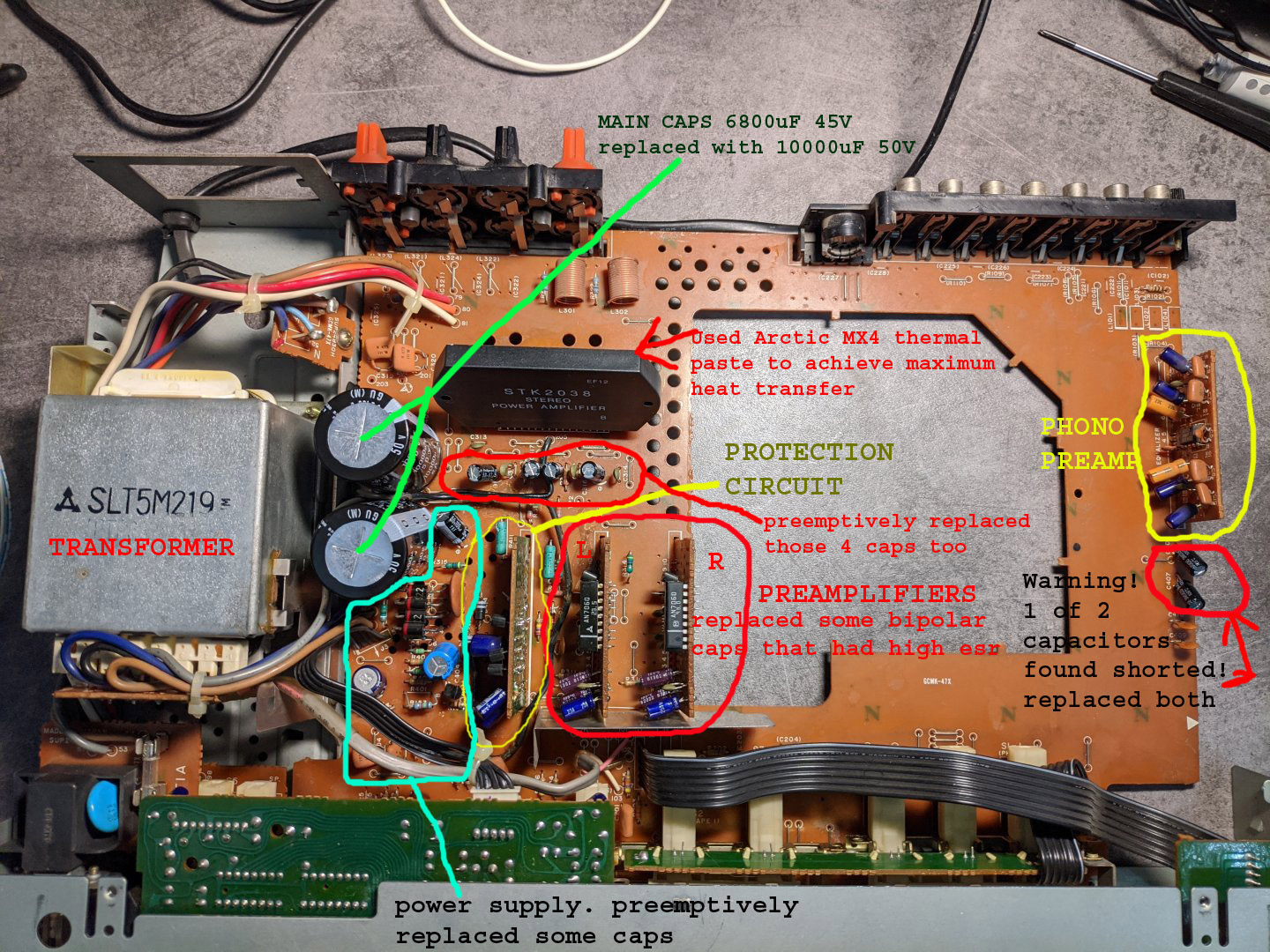

    Here is a pic that tries to include every improvement/repair that I made on this amplifier:
    https://www.badcaps.net/forum/attach...1&d=1642275924
    Any comment is welcome

        If I remember correct it has trim-pots to adjust watts level on left and right channel. Mine, always shows one channel watts lower than the other but I didn't feel like disassembling it again.
        Another unresolved issue is that the bass level adjust trimpot is not working even though I tried to thoroughly clean with CRC Contact Cleaner. I just let it in 0 position and don't want to mess more with it.
        Ok, also uploading every pdf I have, related to the amp
        AN7060 is the preamp IC. The unit has 2 x AN7060, each one on an identical daughter-board.

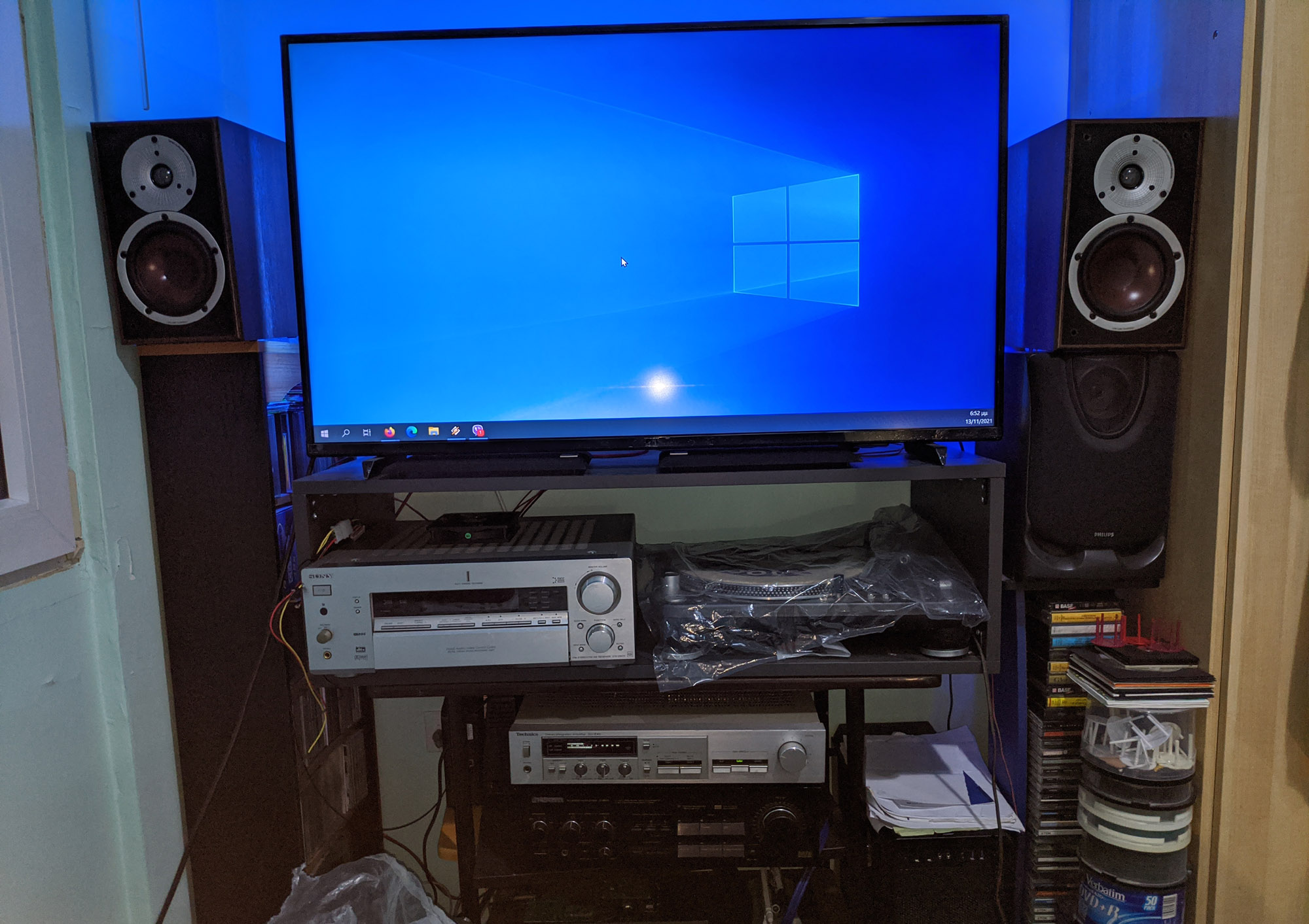

              So, the sensitivity is just 84.5 dB and they are 6ohms speakers. I cranked the volume as high as I could stand but the system was in my bedroom that is too small, so I guess it is easier to fill with sound.
              Took a pic while testing:
              https://www.badcaps.net/forum/attach...1&d=1643660536
              The case of the amplifier just got warm during this. Maybe the 10000uF caps helped the unit, same with MX4 applied as thermal paste. Don't know, but it sounded good!

                Neat little speakers!
                Yeah, despite the low sensitivity, I'm sure they were plenty loud. After all, you have them very near the corners of the bedroom, so that probably helps a lot, especially with the bass output.
                They might be 6 Ohms, but the fact that they have lower efficiency and smaller cone size actually makes them "easier" to drive for the amp. Smaller and lighter cones mean less mass to accelerate and stop, which means lower transient currents for the amp. And low efficiency generally goes hand-in-hand (though not always) with lower back-EMF generation... which again means lower transient currents from the amp trying to dampen cone movement (though the low efficiency does go both ways, in that the amp also needs to provide more power to drive the speakers to the same volume as more efficient ones.) But in general, this will usually make the speakers more consistent (linear) in terms of power input.
