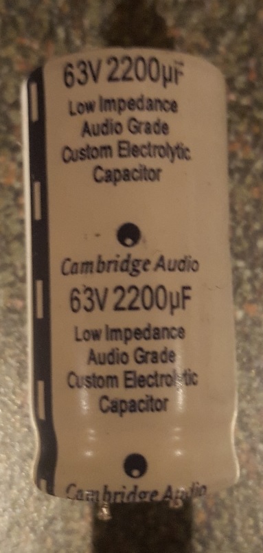

    I isolated a power supply failure in my Cambridge Audio Azur 550A to a shorted filter cap (C42, page 37 - see service manual attached) on the +45V supply of the right-hand channel PCB. The faulty cap is a Cambridge Audio branded "Audio Grade" 2200uF, 63V, 105°C 18mmx35.5mm (see attached photo), for which CA have refused datasheet information and the supply of a replacement(s) as they advise they do not supply these items to "end users".
    Since audio grade caps rarely appear available at more than 50V (105°C) it has me wondering whether or not a couple of decent quality non-audio grade Nichicon or Rubycon caps will suffice in the C41 and C42 positions (my intention is to replace both +45V side filter caps to reduce any untoward imbalances between original and non-original caps).
    Given that audio grade 2200uF, 63V, 105°C capacitors appear to be a rare item, I am looking for suggestions for potential replacements (brand and series) that I can use in place of the original CA caps. I would think that low ESR, high ripple would the guiding parameters, but the latter can be quite a range. In other words, what is considered too low, high enough or even excessively high ripple current for a cap for this particular purpose?
    So far I have been looking at the caps below, with the last two (Rubycon and Vishay) having quite substantially higher ripple current figures than the other three. Are these suitable/compatible? I am also wondering if leakage is a particularly important parameter to pay attention to for this usage:
    Nichicon UVZ1J222MHD
    Nichicon UVY1J222MHD
    Panasonic ECA1JHG222
    Vishay MAL214258222E3
    Rubycon 63ZLJ2200M18X35.5
    Thanks in advance for any advice and suggestions.

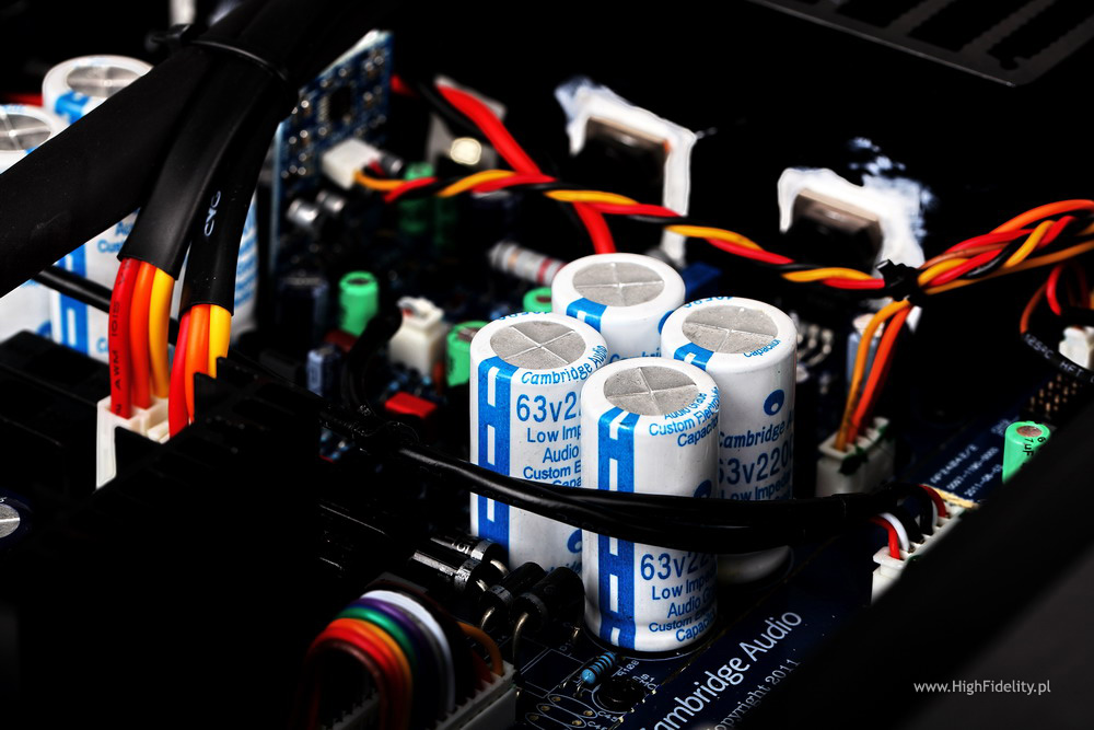

      Re: Cambridge Audio Azur 550A Power Supply Cap Replacement
      I would say the custom capacitors are for marketing wank and wooing reviewers, and for having a poor lifetime... strange it shorted.
      Sonically, low ESR and high capacitance are audibly better. I think Cambridge Audio saved money by keeping them relatively small value.
      Note the capacitors experience audio-frequency ripple currents (as well as mains) - so look at the 10kHz ESR spec as well for a figure of merit.
      So I think an SMPS-grade capacitor is more what these are.
      If it was my amplifier I would upsize the caps as 2x2,200uF per rail per channel is a bit lean, not the greatest. If you have the height see what might work.
      pic from Azur 651a
      edit: the problem is the small height.
      Nichicon UFW1J222MHD "Audio grade" 2,200uF 63V 2,000Hrs @85°C but more of a placebo.
      Taller, like 37.5 to 41mm MUCH BETTER:
      Nichicon UHW1J222MHD 20mohm 3.86A @ 100kHz ripple. But 18x40mm high.
      United Chemi-Con EKYB630ELL222MM40S 10,000 Hrs @ 105°C, very low ESR 16mohm 3.67A @ 100kHz ripple. Nice. But 18x40mm. I would stuff them in lol.
