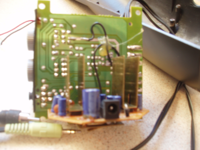

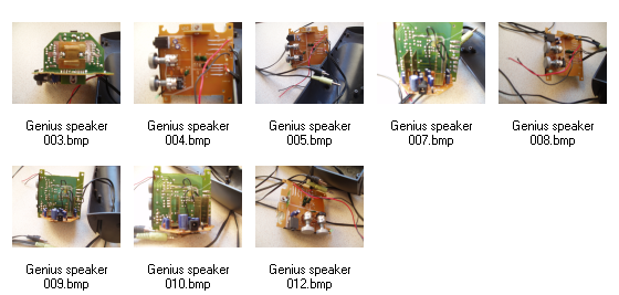

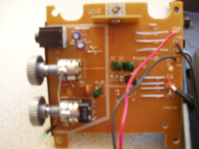

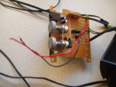

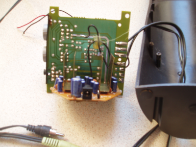

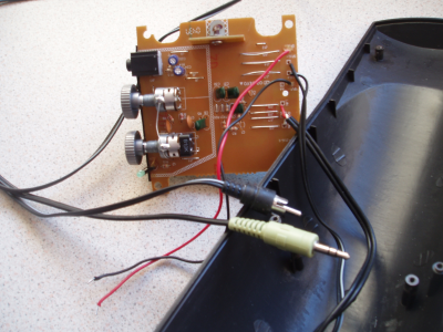

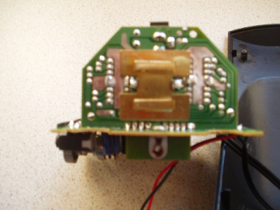

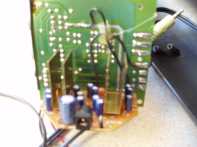

            Hi Guys ,
            I have tried a continuity test on the wires and they seem to be fine ..So i uploaded a few pics..
            I think its one of the ic chips that might have blown .. Trouble is not sure which one tried to follow the wires but they don't give me a clue to which chip..The photo in pic 9 has the ic2 chip next to the on off vol and control knobs.
            If i manage to take out the right chip with some help from you guys ( if you can tell from the pic lol) would the 1 speaker still work with just the one chip in place ( i'm guessing yes but i may be wrong) .
            I know i could buy another cheap pair of speakers but i like the idea of trying to see if i can get it to work ..The red and black wires that are on the pcb are for the speaker and i have tried them on both speakers and the speakers are fine. This is the main housing that supplies both speakers.
            Hope you understand me
            Thanks in advance.

              Re: Genius desktop speakers
              If the wires check out, its either a bad amp IC (they are cheap) or perhaps a bad coupling capacitor. THe coupling caps are small, 2.2uF or less wired in series between the input and the amp.
              If the amp is single ended, ie, the speaker - connects to ground and the speraker + connects to the amp chip there will be an output coupling cap in series between the speaker and amp, usually on the +. This cap is larger, 100uF or bigger. If this goes bad the amp will not work either.
              Bridge tied load (BTL) amps and amps with dual rail power supplies do not use output coupling caps.

                    Just an update as i have only just managed to desolder the ic tonight due to other things..Now the ic is a TEA2025B AUDIO IC ..Now i have found one Which matches this but there is a second number underneath..
                    Mine says on the ic ST TEA2025B,W990335 Malaysia..The one i found says the exact spec as mine apart from the W990WO346 is this number just part of the manufacturer and does it matter or not about this last number.
                    Looks like i'll have to get a couple from abroad as i cannot find one here on the web for uk. unless i have missed it lol.
                    Thanks ..also this had a heat sink soldered on the ground pins numbers 4 and 5 on both sides..Is it ok to use some thermal grease that i have as this looks like it had some on.
                    Thanks in advance.

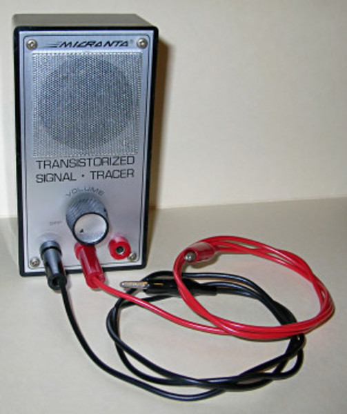

                              Before I could afford my first oscilloscope, I used to use a Micronta Transistorized Signal Tracer. It was simply a sensitive audio amplifier built into a small plastic box with a volume control & small loudspeaker on the front.
                              It came in real handy for fault finding radios & amplifiers. I have still got it actually. I must have bought it in the late 70's from Tandy (Radio Shack in the US).
                              Don't know if you can still buy them, or it might be worth building one if you cannot afford a scope.

                                Well i got the ic audio amplifiers from the U.S and solder it in tonight ( been busy recapping monitors lol) Well i put the thermal paste on top of ic amp and heat sink and soldered it to the pcb..Well i plugged her in and all works fine ..so jobs a good one
                                Must say these speakers were not that much to buy but i wanted to see if i could fix them ,rather than throw them away and now they are back to life again (plus i have spare ics if they ever go again ,for just under $5 inc shipping)
                                Also did a few tests on the good ics with ohm meter and tested the bad ic ,all the good ics had same reading and bad one had 2 places where the ohms were really low..So i guess you can tell if you have a new ic to compare.
