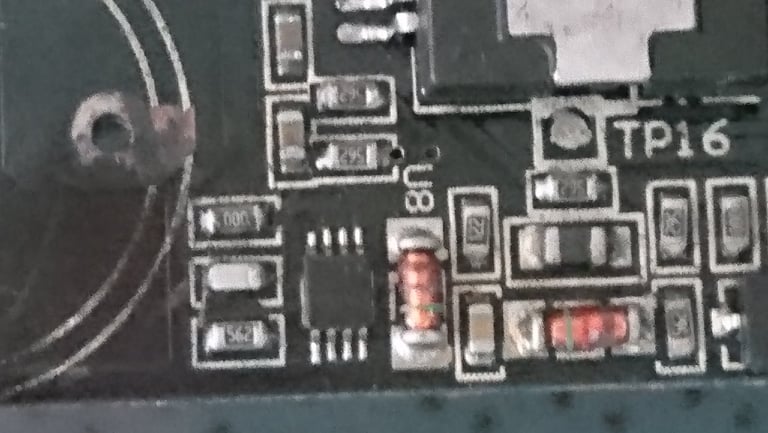

Db Technologies Cromo 12 amplifier no audio
  • system100m
    replied
    Re: Db Technologies Cromo 12 amplifier no audio
    Hi, I also have an issue with my Cromo 12.
    When powered up, the red led would constantly blink. It will play and sound fine for 10 minutes, and then suddenly the sound would stop and you'd hear some kind of crackles instead. It has two TDA8950TH on the board, is one for the tweeter and one for the woofer? Should I assume if both act the same, then these chips are fine? any other idea?
    Leave a comment:
    replied
    Re: Db Technologies Cromo 12 amplifier no audio
    Originally posted by falcontech
    the man of the video explained to me that he put that resistor to bypass this small integrated in the picture (sorry for the resolution) which is a C04R that usually gets damaged, I don't know whether to try to do the same thing, he says that a 3.3Kohm 1/4 watt resistor, looks like 2 watt to me but maybe the video deceives me
    That IC is Triple inverters, so I have no idea which one he bypassed and I also have idea how the inverters are being used in the circuit. He must have known how inverters are being used in that amplifiers.
    His video also shown a handful of the amplifier IC's, so did he also replace them.
    This is tough unit to troubleshoot.
    Leave a comment:
  • petehall347
    replied
    Re: Db Technologies Cromo 12 amplifier no audio
    if there was a schematic it would be easier to say where the signal path is .
    Leave a comment:
  • falcontech
    replied
    Re: Db Technologies Cromo 12 amplifier no audio
    the man of the video explained to me that he put that resistor to bypass this small integrated in the picture (sorry for the resolution) which is a C04R that usually gets damaged, I don't know whether to try to do the same thing, he says that a 3.3Kohm 1/4 watt resistor, looks like 2 watt to me but maybe the video deceives me
    Last edited by falcontech; 10-30-2020, 05:12 AM.
    Leave a comment:
  • falcontech
    replied
    Re: Db Technologies Cromo 12 amplifier no audio
    do you think I can enter the audio directly to the IC input and bypass the preamp to understand if the problem is at the beginning or at the end of the tracking?
    Last edited by falcontech; 10-28-2020, 04:39 AM.
    Leave a comment:
  • falcontech
    replied
    Re: Db Technologies Cromo 12 amplifier no audio
    I found this too
    https://music-electronics-forum.com/...equests/35910-
    Leave a comment:
    replied
    Re: Db Technologies Cromo 12 amplifier no audio
    I do not know why he shows TWO removed IC's and the filter caps for the power supply, and why removed the filter chokes and mount it off board. Nothing show about the Tweeter amplifier either, that added resistor for whet purpose?
    He should at least put the details in the description.
    Leave a comment:
  • falcontech
    replied
    Re: Db Technologies Cromo 12 amplifier no audio
    Originally posted by falcontech
    If it helps this is a video of the same amp that has been repaired
    https://www.youtube.com/watch?v=pB_XobWmlp8&t=72s
    This
    Leave a comment:
  • falcontech
    replied
    Re: Db Technologies Cromo 12 amplifier no audio
    i figured i have to follow the audio where it starts and where it stops right? but those amps have an audio signal input? to understand if it gets there. then I wanted to ask you if you have seen that YouTube video that I linked at the beginning of my request, where that guy makes a similar repair and makes a bridge with a resistance and I don't understand why
    Leave a comment:
    replied
    Re: Db Technologies Cromo 12 amplifier no audio
    Read this post about audio probe/tracer.
    https://www.badcaps.net/forum/showth...ht=audio+probe
    Leave a comment:
  • petehall347
    replied
    Re: Db Technologies Cromo 12 amplifier no audio
    you could make a signal tracer easily . all you need is wire . an audio amplifier or headphones . a small capacitor something like .1uf . a chopstick or similar . electrical tape .
    Leave a comment:
    replied
    Re: Db Technologies Cromo 12 amplifier no audio
    Originally posted by falcontech
    I had badly seen the measurement on the tester, the value is 4.9 on all pins 6
    According to graph as shown on page 7, pin 6 needs ot be >4.2V to be in operating mode, so at 4.9V the IC should be in operating mode.
    You now need to find out if you do have audio feeding the IC or not, but since you do not have the scope or Audio tracer, plus we do not have the schematic to help troubleshooting which is making remote troubleshooting very difficult for me.
    Leave a comment:
  • falcontech
    replied
    Re: Db Technologies Cromo 12 amplifier no audio
    how do we proceed now?
    Leave a comment:
  • falcontech
    replied
    Re: Db Technologies Cromo 12 amplifier no audio
    I had badly seen the measurement on the tester, the value is 4.9 on all pins 6
    Leave a comment:
    replied
    Re: Db Technologies Cromo 12 amplifier no audio
    OK, that cap is connected the same way as CVP caps on page 22 of the application circuit, each pin of VDDP1/VDDP1,VDDP2/VSSP2 should also have one cap to ground for each pin. So look at the VDDP1 or VDDP1/VDDP1,VDDP2/VSSP2 pin cap that is connected to circuit ground.
    Leave a comment:
  • falcontech
    replied
    Re: Db Technologies Cromo 12 amplifier no audio
    one side of the capacitor is connected to the vddp pin and the other (the internal ones) to the vssp pin I found this in the previous measurement
    Leave a comment:
    replied
    Re: Db Technologies Cromo 12 amplifier no audio
    Originally posted by falcontech
    are you talking about the ceramic condenser that initially burned?
    Yes, one of that cap is connected to circuit ground.
    Leave a comment:
  • falcontech
    replied
    Re: Db Technologies Cromo 12 amplifier no audio
    are you talking about the ceramic condenser that initially burned?
    Leave a comment:
    replied
    Re: Db Technologies Cromo 12 amplifier no audio
    Originally posted by falcontech
    I used ground circled in red
    I cannot tell from the pictures to know what that is connected to.
    Thew blown up cap has one end connected to the circuit ground so yo can try using that leg of the cap as circuit ground.
    Leave a comment:
  • falcontech
    replied
    Re: Db Technologies Cromo 12 amplifier no audio
    tomorrow I will do the test again, I would not like that I have set the tester wrong
    Leave a comment:
  • samson7point1@yahoo.com
    Help troubleshooting an audio problem with an RCA SGT-250 CED Player
    by samson7point1@yahoo.com
    The Problem: This player has a toggle switch to select between Stereo, Mono R, and Mono L. Regardless of the setting it outputs the sound to both the L&R audio jacks. In the Mono R position, the audio output level is normal (from both the L and R audio output jacks), in the Stereo position the audio output is about half the volume, and in Mono L, it's about 3/4 the volume. Something about putting it into Stereo mode is causing the volume to drop significantly and I can't figure it out.
    The player processes the audio signal using two different reference frequencies. The "R"...
    04-30-2024, 11:22 AM
  • eccerr0r
    Frying amplifier finals... audio, not rf...
    by eccerr0r
    Well for RF transmitters, transmitting without an impedance matched antenna and if the transmitter doesn't have automatic limiting... kiss the final transistor goodbye and chalk one up to something you killed.
    But that's not the same way with audio amps for the most part, well, at least the wavelength of audio on copper is so long that you get all of it back anyway but the transistor is fine with it...
    So how are people destroying finals in their audio amplifiers then? Heh.
    Are people shorting their outputs or something, overdriving output to a too big speaker?...
    11-27-2021, 12:30 AM
  • Babbar
    Argon SA1 audio amplifier power-supply - fuse blown after fixing the short?
    by Babbar
    I found a project in the electronics trash yesterday. A nice Argon SA1 audio amp with some electrical issue. Took it apart and saw that the 4A250V fuse was blown so started lifting components to find the short. Eventually got to two MOSFETs (model FTA14N50C) that are shorted and when i took them out the short was gone.
    Now i didn't have any replacements of the same model of course but i found a couple with pretty similar spec i thought (K10A60D & K12A50D) and put them in. Also replaced the blown fuse with a 3.5A250V one. Checked another time for short circuit and plugged it in....
    04-12-2024, 01:12 AM
  • MrCommunistGen
    Polk Audio RTi100 Plate Amplifier won't power on and intermittently honks and buzzes
    by MrCommunistGen
    My childhood best friend was killed about 9 years ago. His parents are finally letting go of his things, and they offered me his Polk RTi100 tower speakers. The Polk RTi100 towers are one of a handful of designs from the early 2000s that is a full range 3-way tower with a built-in self-powered subwoofer. This is accomplished with a plate amp integrated into the speaker input panel.
    I think they used them for a while, but they've been sitting for at least a few years now. After about 40 hours of driving to their house and back (both they and I have moved in the last 9 years) I got...
    07-12-2021, 05:11 PM
  • RetroComputingGrotto
    TDA2030A Audio Power Amplifier Question
    by RetroComputingGrotto
    My boss always says "the only stupid question is the one not asked" so at the risk of asking a stupid/obvious question I'm going to one any way...
    I've got a pair of speakers with an amp built in to them in for repair and on inspection I can see the TDA2030A amplifier ICs have blown (so I've ordered some spares which should arrive soon):
    My quesion is with regards to the white paste you can see on the TDA2030A and heatsink, I'm assuming this is just some thermal paste and if so is it a special kind or will the grey thermal compound that I have...
    10-29-2024, 08:25 AM
