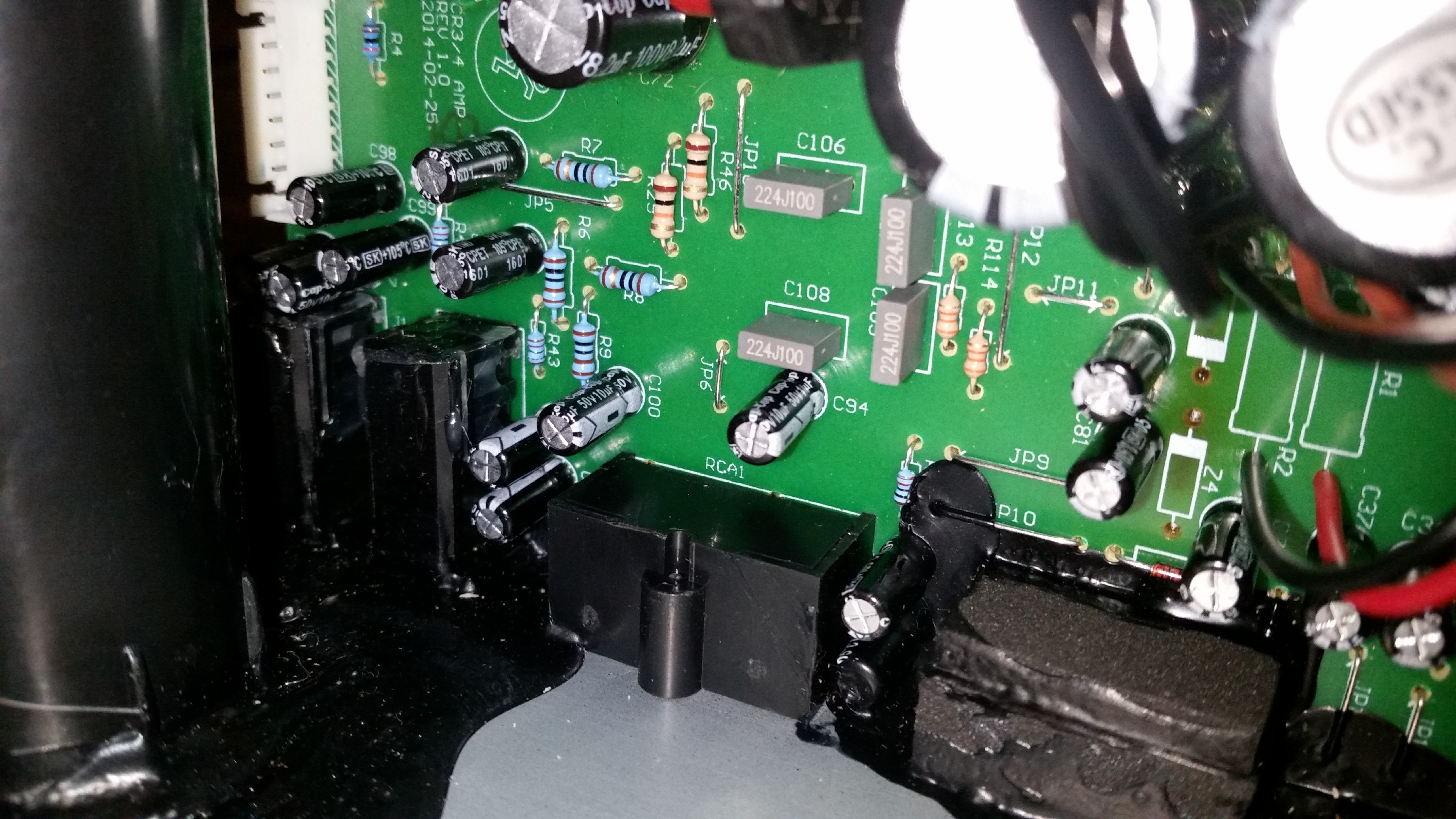

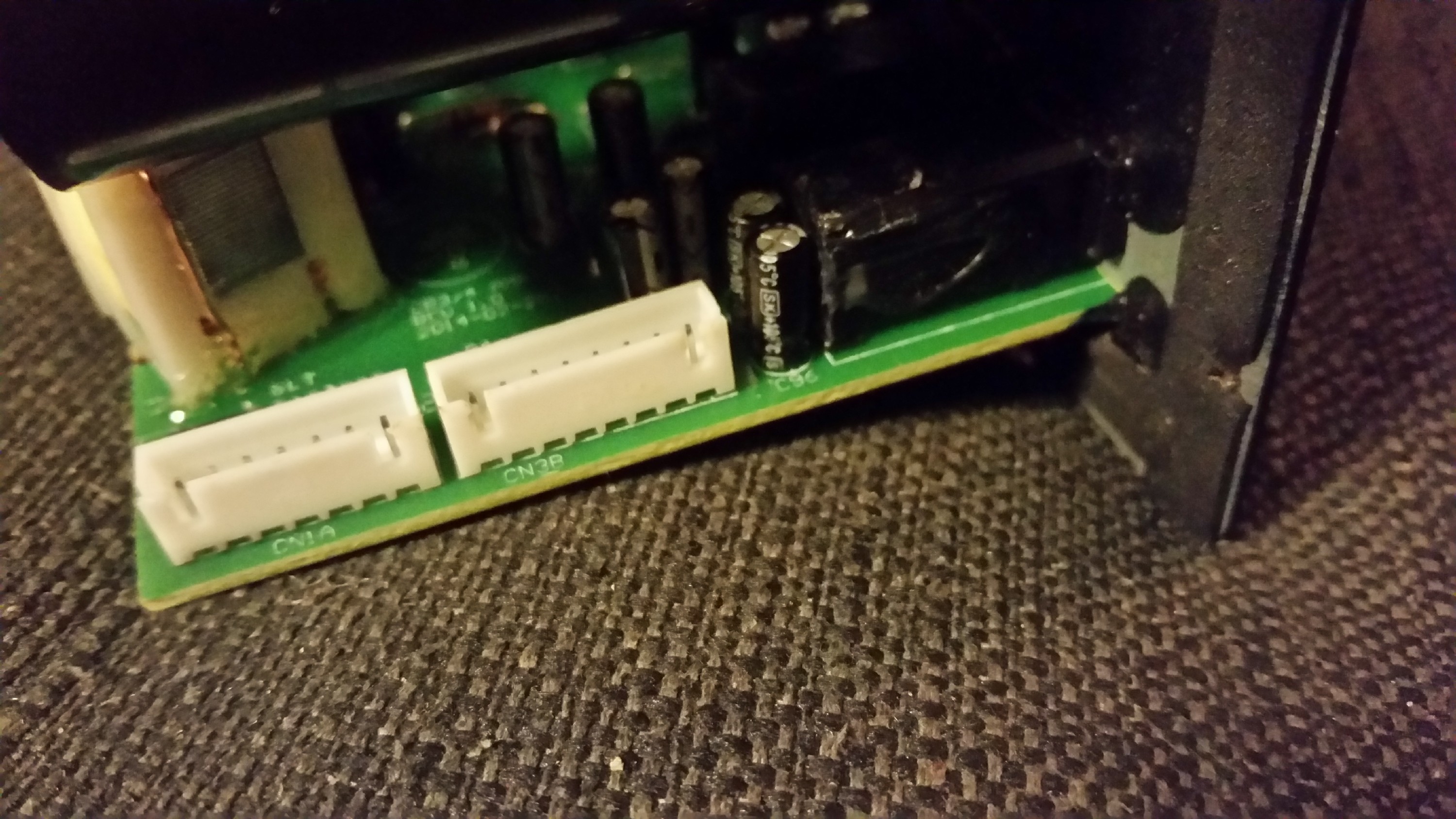

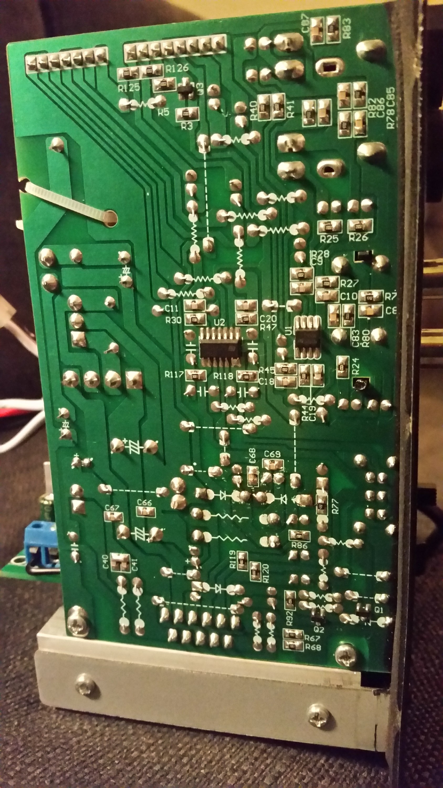

    Re: Mackie CR4 amplifier no sound

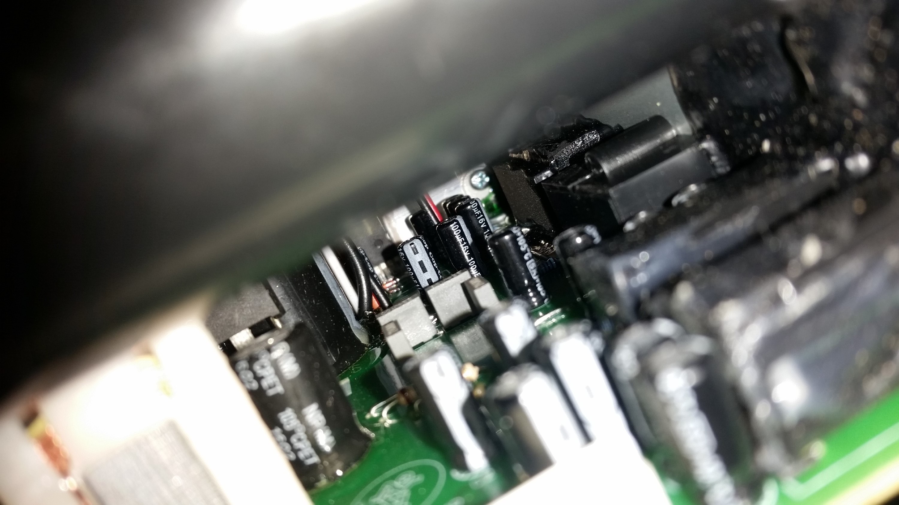

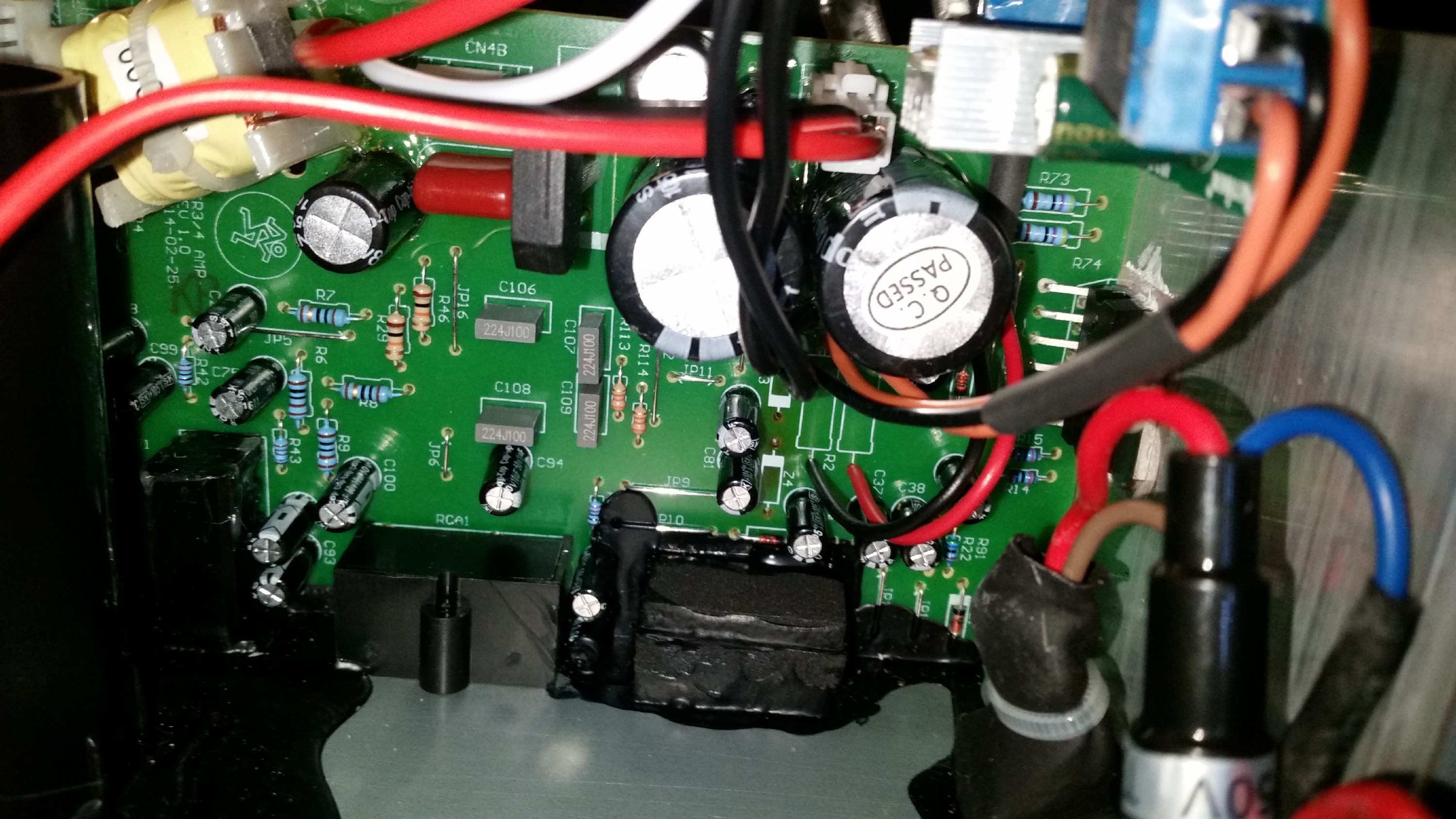

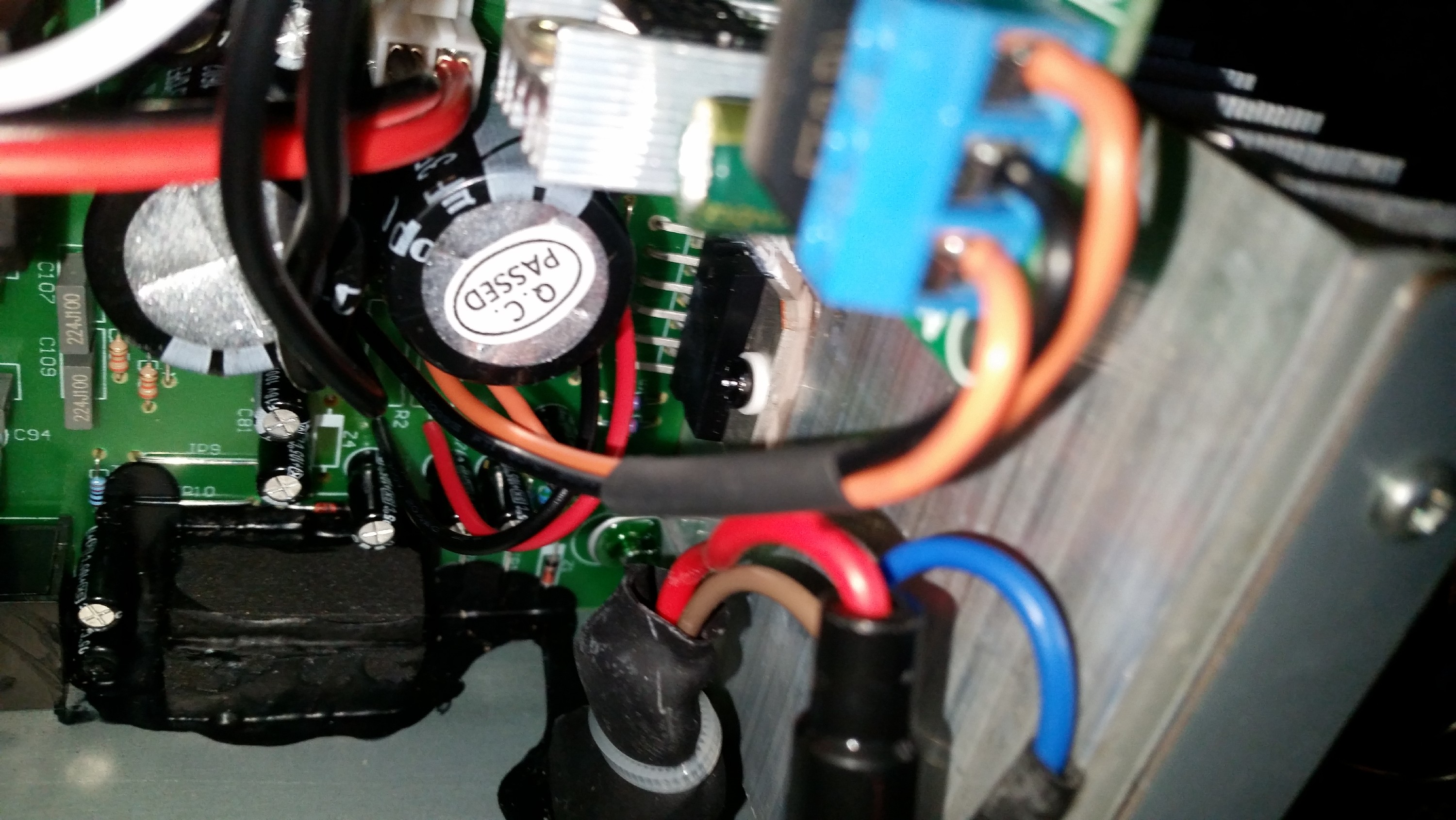

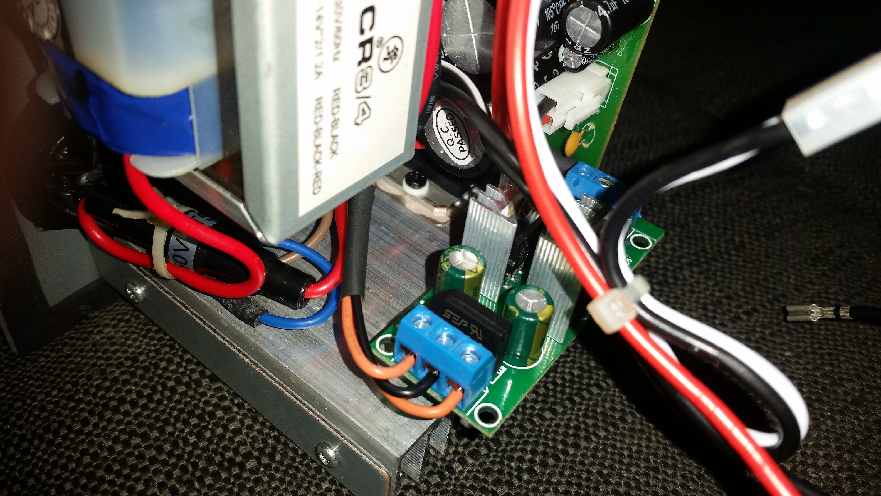

    Here are some pictures of this amplifier unit.
    I tried replacing the zener/resistor 12V regulator circuit on this unit as well like I did on my set of CR4s, but it didn't help. I mean, there is power and everything, but the unit still doesn't produce sound.
    Now, as you can see in the photos, the PCB looks quite clean. The "green" side of it is also superb. It cannot be seen in these images, but I've inspected all the caps inside and they look normal, the date code on all of them is 2016. The area on the PCB that usually gets hot is also pristine green, no overheat or burn marks, it's like it has never been used.
    Do you havy any suggestions on what could cause this sudden "muteness"? It's as if the amplifier got stuck in the mute or standby mode, and does not detect that the input signal is coming in.
    Please, any help would be appreciated. I do have a multimeter, I would just welcome any step-by-step instructions on what to measure and where/how.
    Thank in advance, stay safe.

                  A bit hard to tell what's going on from these pictures alone. Would be nice if we can get straight shots from the top and bottom side of all PCBs.
                  That said, are there speaker output relays? If so, check those to make sure they make good contact when they switch. Although it's unlikely that they can cause audio to slowly fade away, they are worth checking out. I've seen speaker output relays with bad contacts cause somewhat similar issue (with audio sounding weaker than normal, then going back to normal, then disappearing, and etc.)

                      The amplifier is based on the TDA7265 chip which is mounted on the big heatsink (you can see it in one of the images). Unfortunately, the PCB cannot be detached from the backplate because it is glued with that black resin, that's why it's under these weird angles in the photos. The way the speakers faded out looked to me also as if it were a discharged and not recharged capacitor. But the fading from a full normal volume to a complete silence happened in maybe less than 10 seconds, the sound literaly withered away and remained silent. Is that time symptomatic of a specific capacitor failiure or a power loss to it?

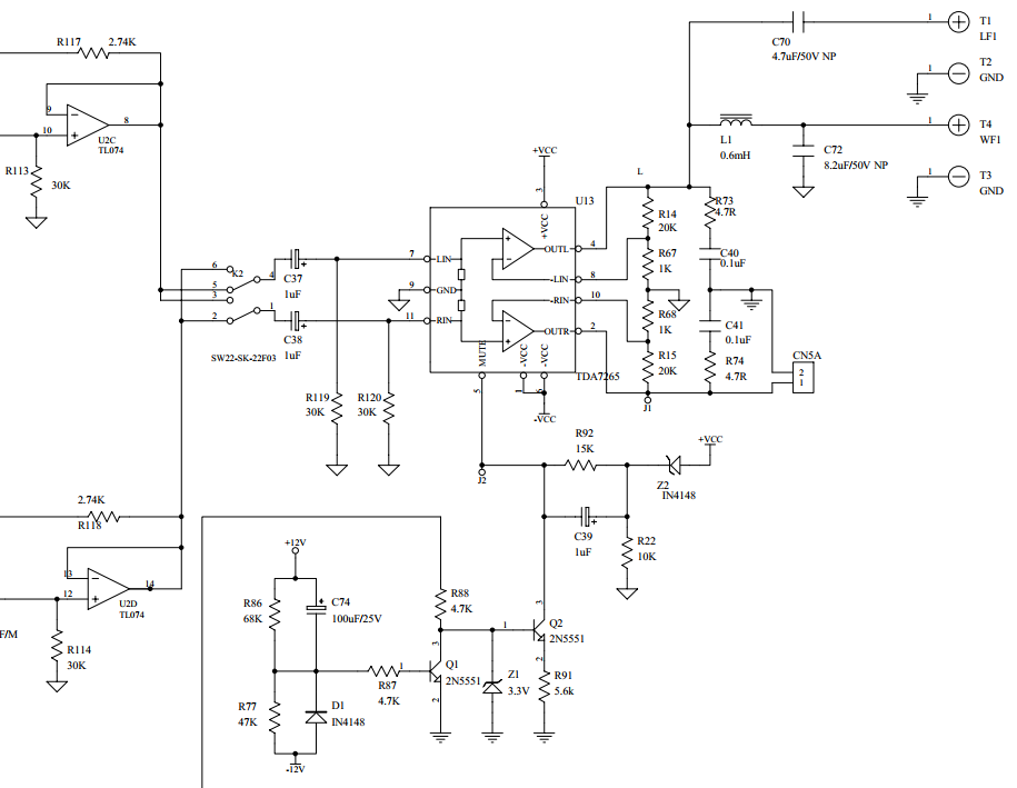

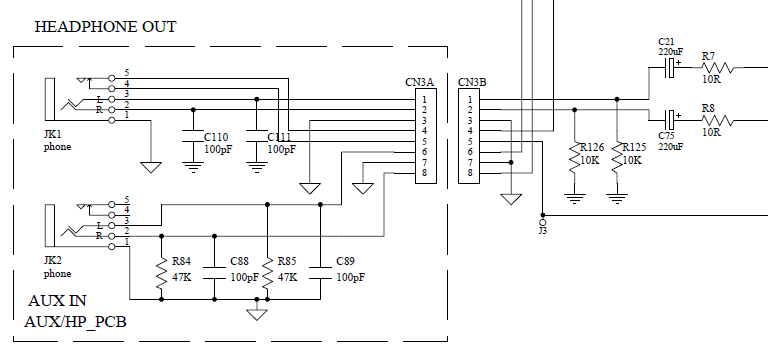

                        This is what I got from a Mackie service guy in the email:
                        "I suspect that the problem lays on the headphone mini jack placed on the front panel. We've seen before that this jack gets damaged, so the amplifier remains in the mute state". - This is probably not true because the headphone jack works normally on my original CR4 speakers PCB.
                        He also mentioned the L/R switch, which I determined is not the cause also.
                        Then he added this and included a photo I am attaching here:
                        Let this get checked by your service guy - short pin 4 and 5 to unmute amp.

                          TDA7265 pin 5 is the mute pin .. some people have cut this pin and restored sound ..i would be checking its voltage first rather than cutting it . or i might desolder the pin .
                          • petehall347
                            • Jan 2015
                            • 4450
                            • United Kingdom
                            https://components101.com/ics/tda726...udio-amplifier
                            pin 5 is pulled low to mute it . see if that is the case here .

                                If you look at schematic the headphone jack JK1 switch pin 4 and 5 which are used for muting when headphone is plug in, you will get the sound through the headphone OK but when the headphone is removed but the pin 4 and 5 are not making contact, the amp will stay in mute mode. So verify t hat pin 4 and 5 are making contact.
                                BTW, you should ask for full schematic since so may people out there have so much problem with these unit.

                                  Yes, it does make contact because the original amplifier PCB has no problems with the phonejack. It enters the mute mode when headphones are plugged in, and plays the sound again immidiately after the headphones are removed from the jack - just the way it is supposed to. So pins 4 and 5 obviously make contact on headphones plug removal.
                                  Everything mounted on the front panel of the powered speaker works perfectly with the original amplifier.
                                  When the same front panel is connected to the "new" amplifier, there is no sound. Therefore, it must be something on this new amplifier's PCB that's bad. The phonejacks are fine.
                                    Then you have to verify that pin 4 and 5 are making contact all the way to the amplifier mute pin by checking Voltage (Black probe on circuit ground, red probe on pin 5) on mute pin of the IC when phone jack is in and when removed, it should change state.
                                    Having full schematic will also help.

                                      The voltage on pin 5 of the TDA7265 is around 21V when 4 and 5 pins if the phonejack make contact.
                                        It should change state when headphone is plugged in and out.
