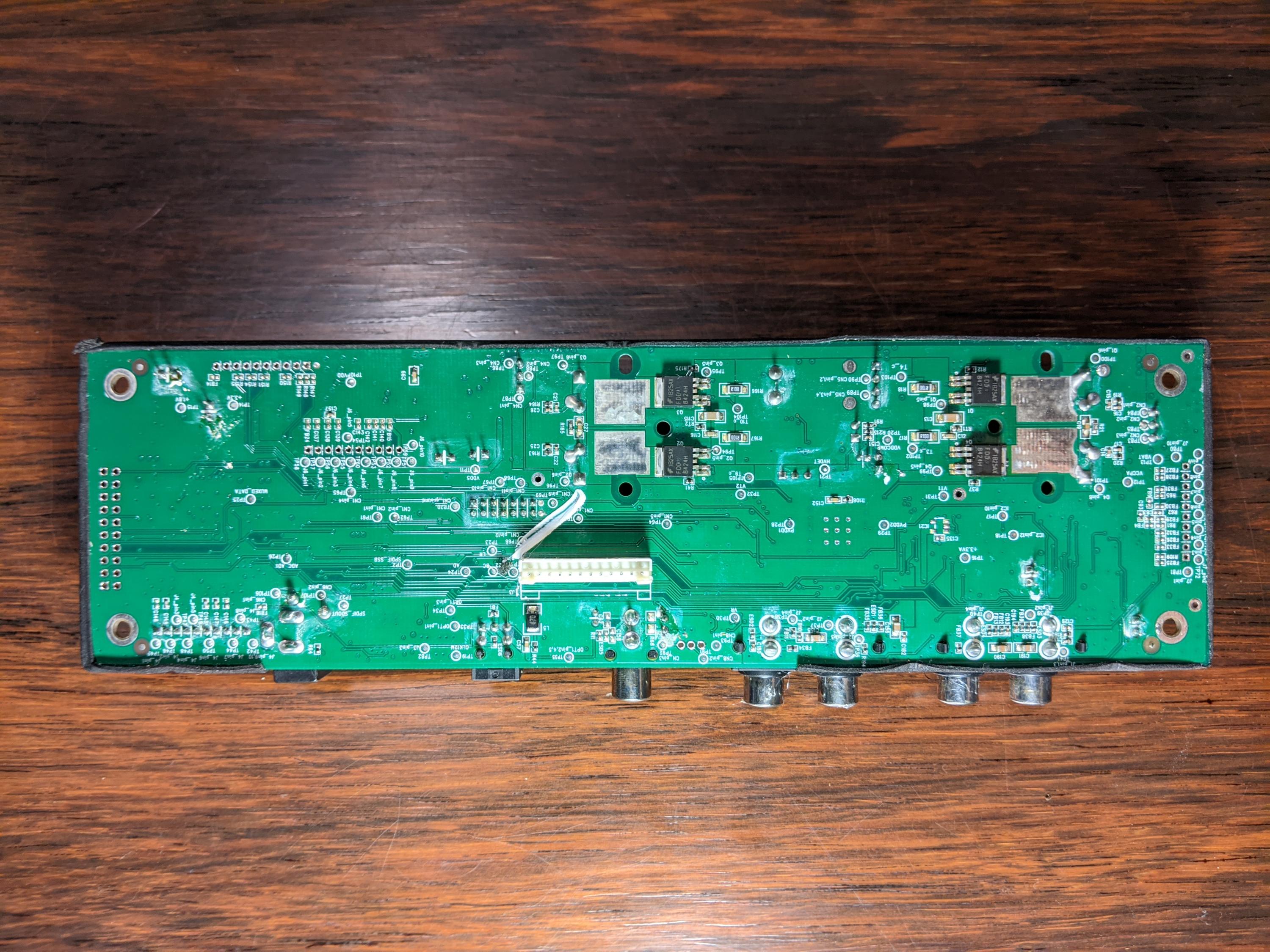

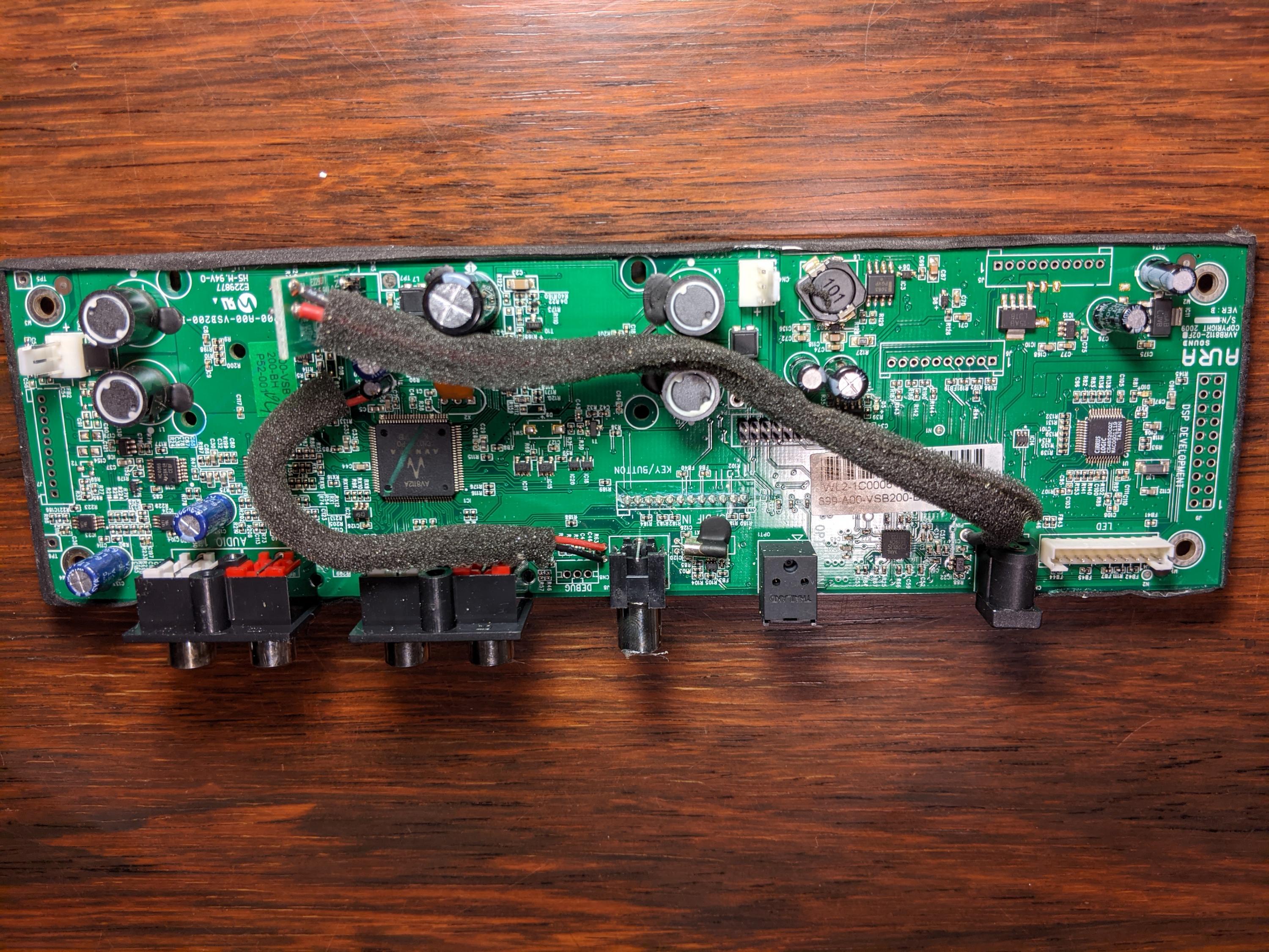

      Re: Vizio Soundbar VSB200B Overheating
      Here are photos of the top and bottom of the main board.
      You are correct, there is no bluetooth capability.
      The power output seems to be from dual FDD8424 Dual N & P Channel MOSFETs on the back side of the board. No external heat sinks, so likely a Class D as you speculated.
        Hmmm...
        I'm a bit split where to start on this one. Indeed nothing looks obviously bad or overheated.
        Since the unit seems to be consistently indicating over-temperature, perhaps you can check if any of the ICs or MOSFETs are getting extremely hot during operation (i.e. run the unit without covers and check temperature by hand or perhaps with something more fancy, if you have any such tools.) I see the input power supply on this unit is listed as only being 24V DC, so that should make it pretty safe to probe/touch inside the device. See which parts (if any) get so hot that they feel like they are burning and note them down.
        The right side of the board where MOSFETs Q1 and Q4 are seems ever so slightly darker, perhaps indicating one of these is running hot (Q4 in particular.) But that could also be the lightning of the picture, of course.
        In any case, if you do have a multimeter, you can check these MOSFETs with the power off (and PSU disconnected) for any potential short-circuit or low-resistance readings between Gate, Drain, and Source for the MOSFETs in each package - i.e. measure resistance on the lowest scale on your multimeter between the following and post what results you get:
        MOSFET XX
        Resistance between G1 and D1
        Resistance between D1 and S1
        Resistance between G1 and S1
        Resistance between G2 and D2
        Resistance between D2 and S2
        Resistance between G2 and S2
        Then repeat that for the other MOSFETs. Perhaps we can get a few quantitative readings that way to help us see which readings may be normal and which may be "outliers".
        Another thing I can't help but notice is the cheap electrolytic cap brands used in this unit. I don't expect them to be the issue here, but with cheap cap brands it's never certain. If any of these are letting through too much noise from one of the voltage regulators on the board, that too could be causing the IC to malfunction/glitch or not communicate with other components properly, thus triggering the issues we see. So replacing the caps (with good quality Japanese low-ESR/impedance ones) is another option to consider while troubleshooting this.
        I also can't seem to find a datasheet that exactly matches the package for IC10 and IC11, but most datasheets suggest these are LE15AB voltage regulators (for 1.5V output.) With power plugged in, check what voltage you are getting on each of the pins (relative to ground) on these two ICs. Try both while the soundbar is Off/standby and when turned On.
        I suppose that would be all for now. Let's see what results/info you come out with, and maybe we can use that to guide us further.
