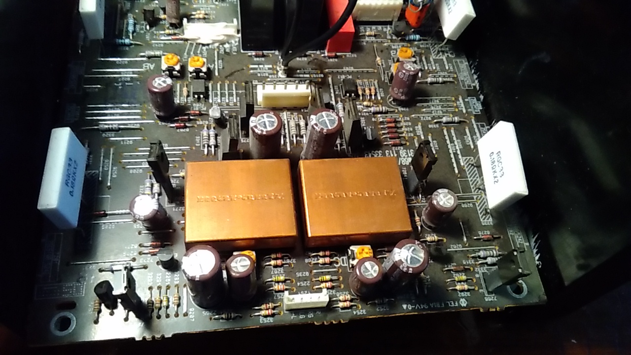

    After i repaired the speaker protection board of that amplifier, all was ok.
    So I then proceeded to adjust iddle current, got it, then DC offset. Oh, bboy.
    At that stage, on the left channel, after first seeing normal readings while moving the trimpot to get to the correct setting, suddenly readings were all over the place and did not respond to my turning the trimpot.
    I played music to earphones, to find that there was no sound on left channel. Only distorted crackles on peaks.
    I took out the board and took out the trim pot, measured it as being ok from end to end and from the moving wiper. Cleaned it anyway and retested as OK.
    And, i resoldered 7265 that had broken solder joints. That component was probably the one acting up (relays clicking) when i pushed away the supply wires (touching 7265?) to have access to the trimpot.
    (BTW why do these (TO126?) stand so high on their legs, wrapped in shrink tubing??) I also reflowed the connector for the supply lines, just to be sure.
    I reinstalled the board. The audio is now heard on left channel. Distortion is hard to qualify on cheap earphones and with my old ears and in haste not to blow anything up.
    But: i can't adjust either Iddle Current (.2mv) or DC Offset (160mv). Trim pots have no effect. With power off i rechecked that DC offset trimpot and it was still behaving correctly.
    I probed the supply lines as deep as i could, including around some transistors (results i should not quote now, but maybe of interest: 7261 is E 53.2V, B -52.7V, E -53V). All seemed normal in my limited understanding of those circuits. I tested in circuit the first components branching out of + and -VB, and double diode tested 7265 and 7267. I did not probe under the copper shield (housing 7251, 7253, 7255, 7257, 7259) yet.
    I hope there is an obvious "classic case" component causing that anomaly, which some knowledgable and experienced person here will point out to me.
    I saw that i can unsolder (update: not easily!) that copper shield and probe those components. If someone points me to what i should measure there?
    BTW all i have is a digital multimeter. It can test semiconductors. It also has capacitance capability but seems unable to measure >20?uf . To find good units in my NOS stash i rely on reading DC volts, discharge, remeasure DC volts, do long Ohms test, and remeasure DC volts to see if it went up. Served me well to date ;-)
    Thank you all for your insights and help.

    have you gone through class A and AB adjustments ? have you tested the switch ?

      You may still have some bad component, in the amplifier that has caused the issue.

        Yes i did adjust Bias for both Classes, before trying to adjust DC where it went crazy. And after resoldering 7265 i could not adjust either DC or Bias.
        I did not go back to try and adjust Class A Bias because of fear of letting the blue smoke powering all electronics get out.
        But as mentioned the 56V suplies are present as deep as i could probe.
        Am now in the process of removing the copper shield (i'm just about ready to try with a torch) over the first stages to probe around there.
        You mean the Class A switch? It's relay clicks and led lights up...But next powered tests will include that Bias. After i get the copper shield off and probe under there, and resolder 7267 that i took out to test.

          Ah, well... i am really looking for that bugger.
          Would you have an idea of the more likely guilty party??
          I did spot 2 slightly bulging caps, but on the right side! (yes they will get replaced), but the described trouble is on the left.
          Will be probe happy for a few days...

                  Yeah, i read about the light bulb safety device. I did not expect to go look for incandescent bulbs again ...
                  And there are no FETs around. I kind of scrutinized that schematic trying to figure things out, i would have noticed
                  Ordered an ESR/component tester today, and a solder sucker to replace the shopvac
                  Next steps are: finish removing that damn copper shield, testing the fusibles, and probing that first stage.
                  thank you both. To be continued...

                    I ordered a mega328 esr meter, and a solder sucker. 1 week?
                    I tested a lot of a lot of diodes and fusible resistors, those i thought could be tested in circuit. All tested ok.
                    A lot more tests to do, especially after i remove the copper shields. I at least succeeded in tinning the old butane irons (ECG J-500 and big tipped Portasol T1), those could help.
                    So i plan to annotate a .pdf with my readings and post it, hoping someone more experienced than i will be there to read it and advise. :scared:

                        I got the meter and solder pump today.
                        I calibrated the meter, rigged pins and alligators to extend the ZIF socket, tested a few cans in my NOS and 7267 of the Marantz that i had taken out (it's good :-().
                        That puny meter looks useful.

                          Summing up how that problem was resolved (thank you to all who contributed!!):
                          I replaced fusible resistor 3315 that had gone very high.
                          And lowered 3301 (and 3302) to 220R to bring DC back within adjustable range (7267 and 7268 having drifted?)
                          Now will be replacing lots of electrolytics, all other fusibles, and putting back 7289 that i blew up (remember: discharge those Caps!), to reenable Protection. Looking for that 2SA970 and other through hole legged critters i discovered that these are now really scarce, like in hard to find.
