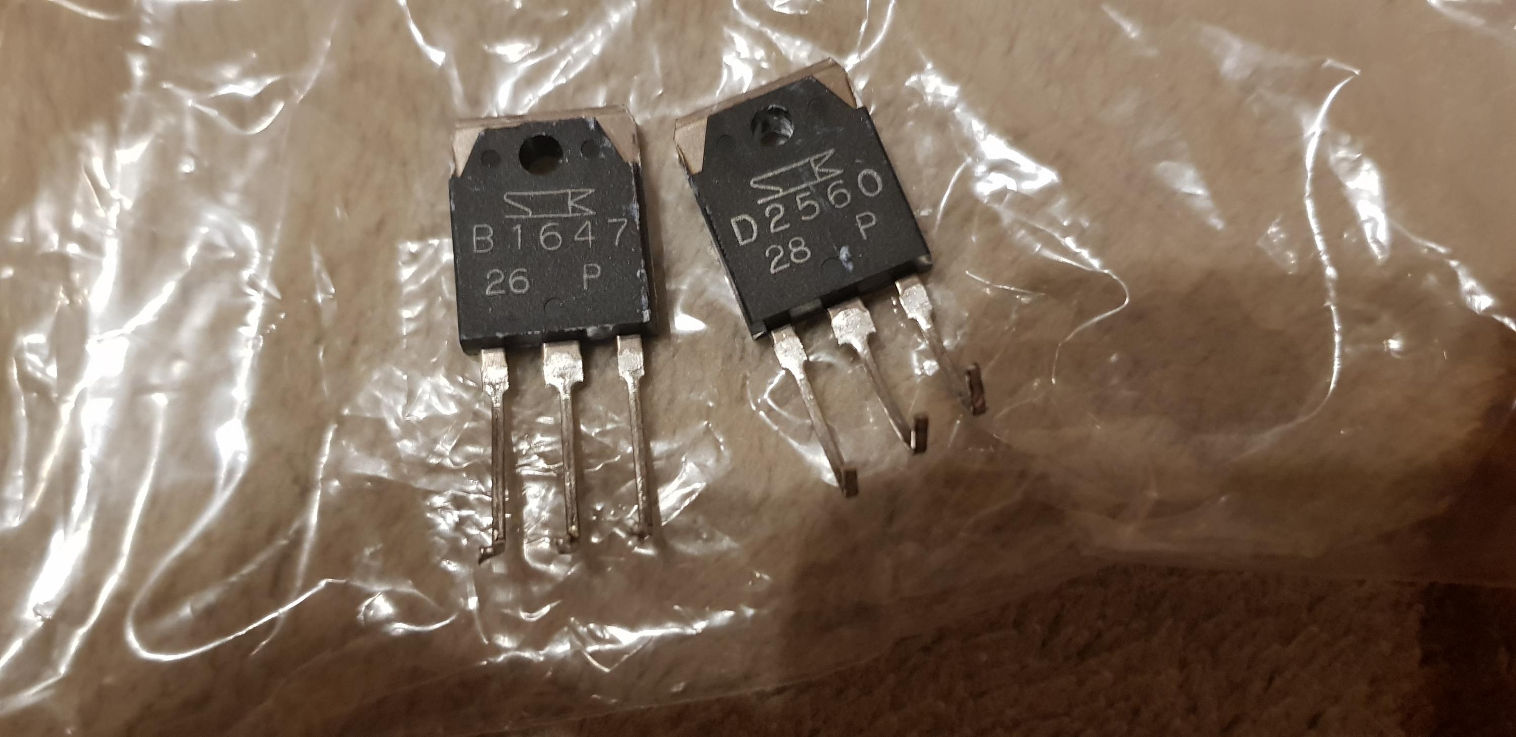

                    Re: Harman Kardon AVR 370
                    I checked and no sound.
                    I think I have already found the reason for the short circuit at the SURR LEFT speaker output after turning on the power was 54v and dropped to 27v as in the photo after desoldering 2 ends B1647 and D2560 the amplifier works and I think I will order these 2 parts burned tomorrow

                      Make sure to check the dual emitter resistors and also the 3.3Ω base resistors. If the base resistors are open, you would need to check the driver transistors also. You should also check R821 & R822 (18Ω) If you are lucky only the outputs are bad

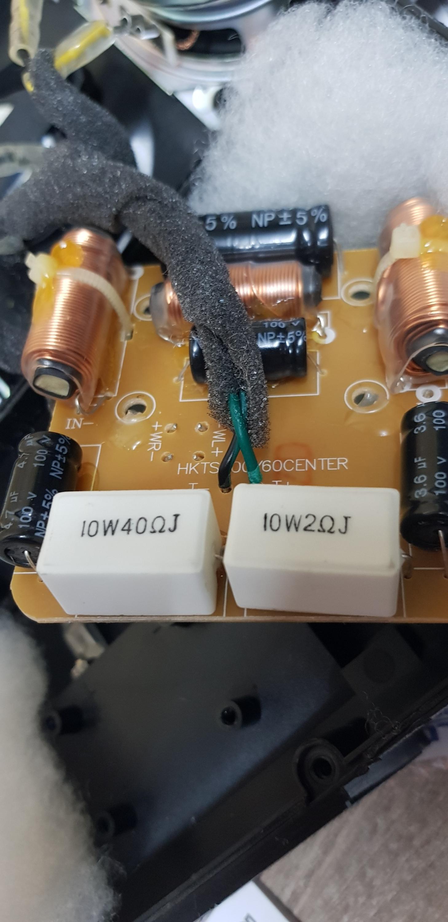

                          Through these 54v I have damaged the central speaker CEN-TS60 and the loudspeaker already has someone else suggest what could have fallen in the inverter?
                          Such parts are there:
                          3.6uf 100v
                          2x 4.7uf 100v
                          26uf 100v
                          200uf 100v
                          10w40ohm
                          10w2ohm
                          • Technik92

                            Hello, I replaced these damaged parts now starts and after 10s turns off by itself

                              What damaged parts did you replace? Did you just replace the 2 transistors?
                              Check the voltage on pin 1 &2 of CN66? This is connected to the emittter resistors, check this voltage before the amp shuts down.
                                So I replaced 2 transistors B1647 and D2560 + R817 3.3Ω.
                                Voltage on pin 1 & 2 CN66 = 17,2V

                                  That voltage on CN66 should be close to 0 volts.
                                  If R817 was damaged (open) then you need to check all the driver transistors and resistors. Check Q856,Q876,Q886,R786,R776 and all the the other transistors and resistors in that part of the circuit. You can compare values with a working channel.
                                    ok Q856 is broken tomorrow I will buy these hi the rest seem ok
