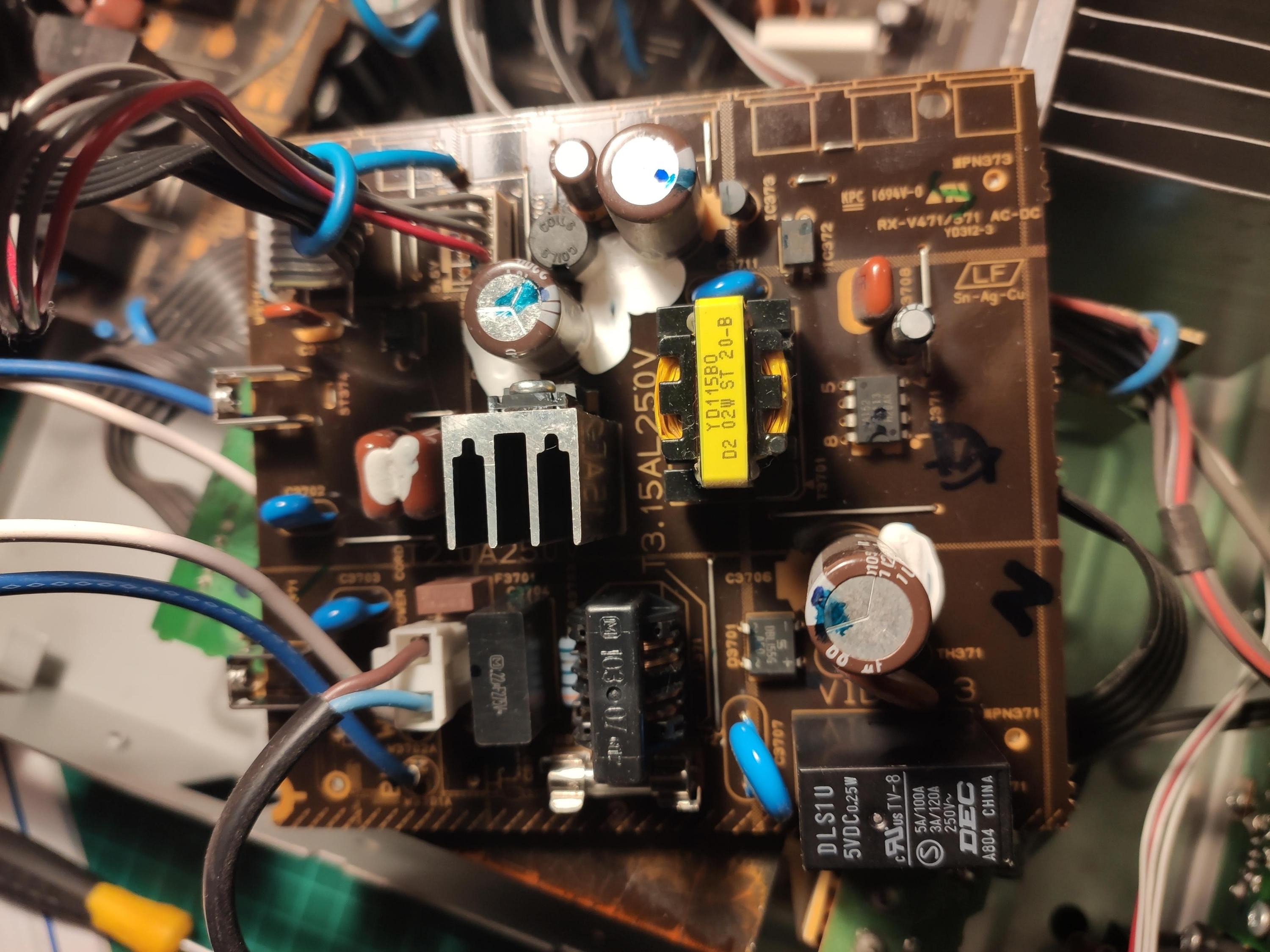

        Hmm let me check the SM... meanwhile, can you post some pics of the power supply board ( the one with the relay for the primary side of the transformer )?
        Alright, I guess this yama uses different board.. anyway, do you have the 5.5V standby rail?

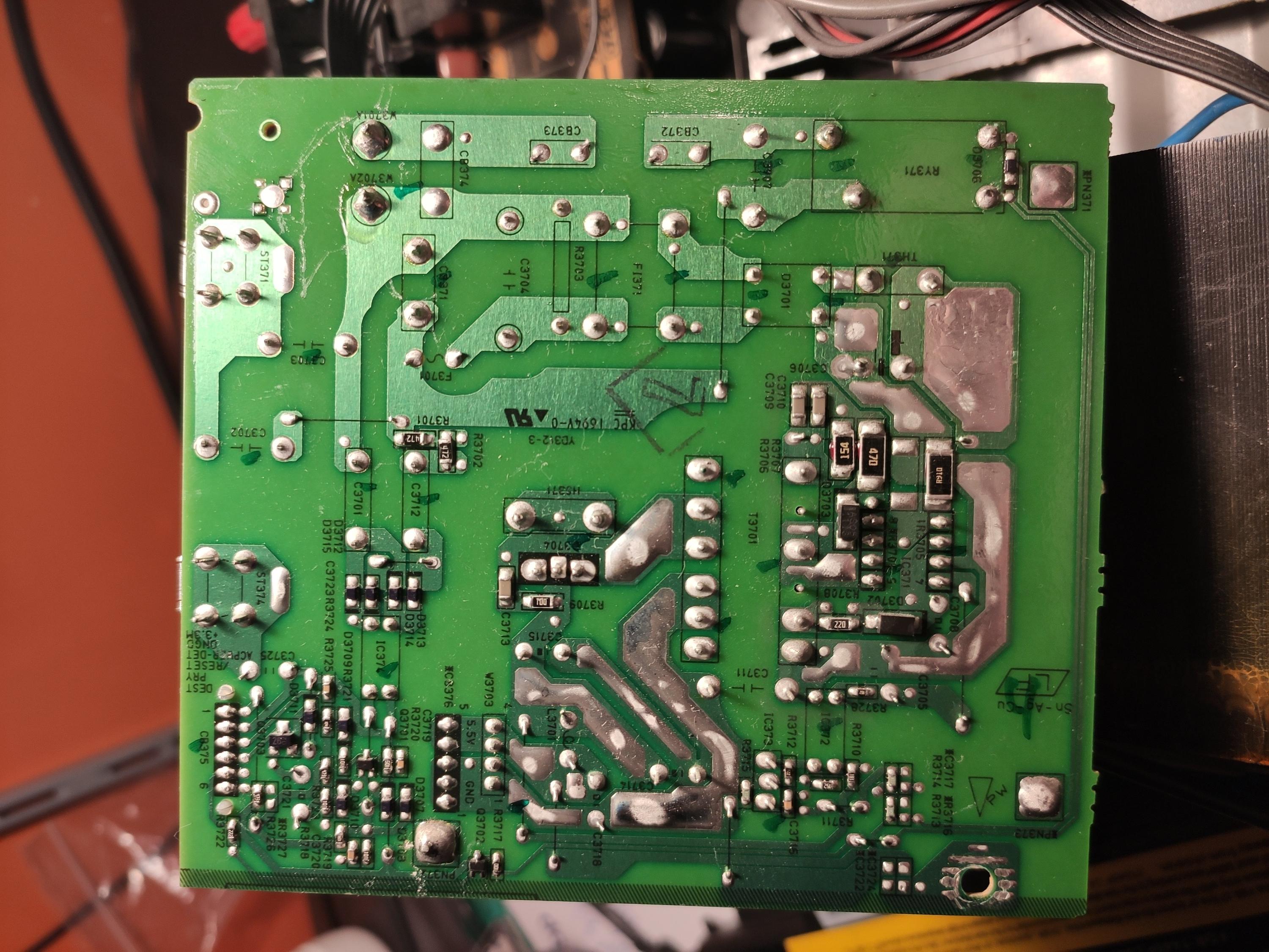

          Re: Yamaha RX-V571 No Power, no screen
          Yes I do have the 5.5v, I guess the fault may be in the regulators on the amplifier board but I don't know how to test it because it doesn't turn on.
          Here is some photos of the power board.

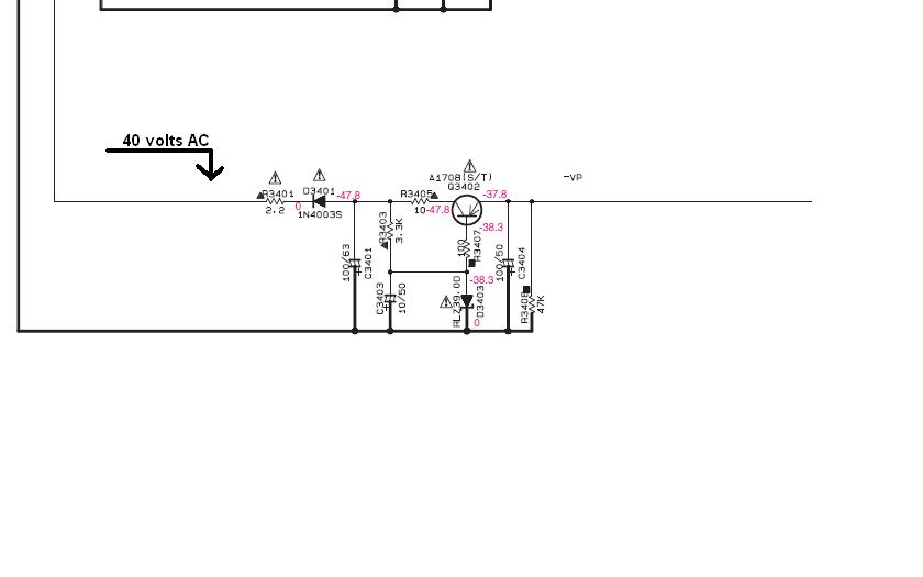

                                  • R_J
                                    • Jun 2012
                                    • 9594
                                    Ok, so +5VA and -5VA are ok, -VP is needed for the display, You will need to check Q3402 collector to see if it has -48 volts, if not check for an open R3401 (2.2Ω). R3401 will have about 40 volts AC on both sides, this feeds diode D3401, You should have about -48 volts across C3401
                                    I think you are getting close to the problem.
                                    • bermo96
                                      • Jan 2019
                                      • 45
                                      • Belgique
                                      I have -37v on -VP... I think last time my oscillo was set to trigger at 5v. I was hoping that -VP was bad, but it's my fault. I don't know if this will help, but the output relays are constantly turning on and off.
