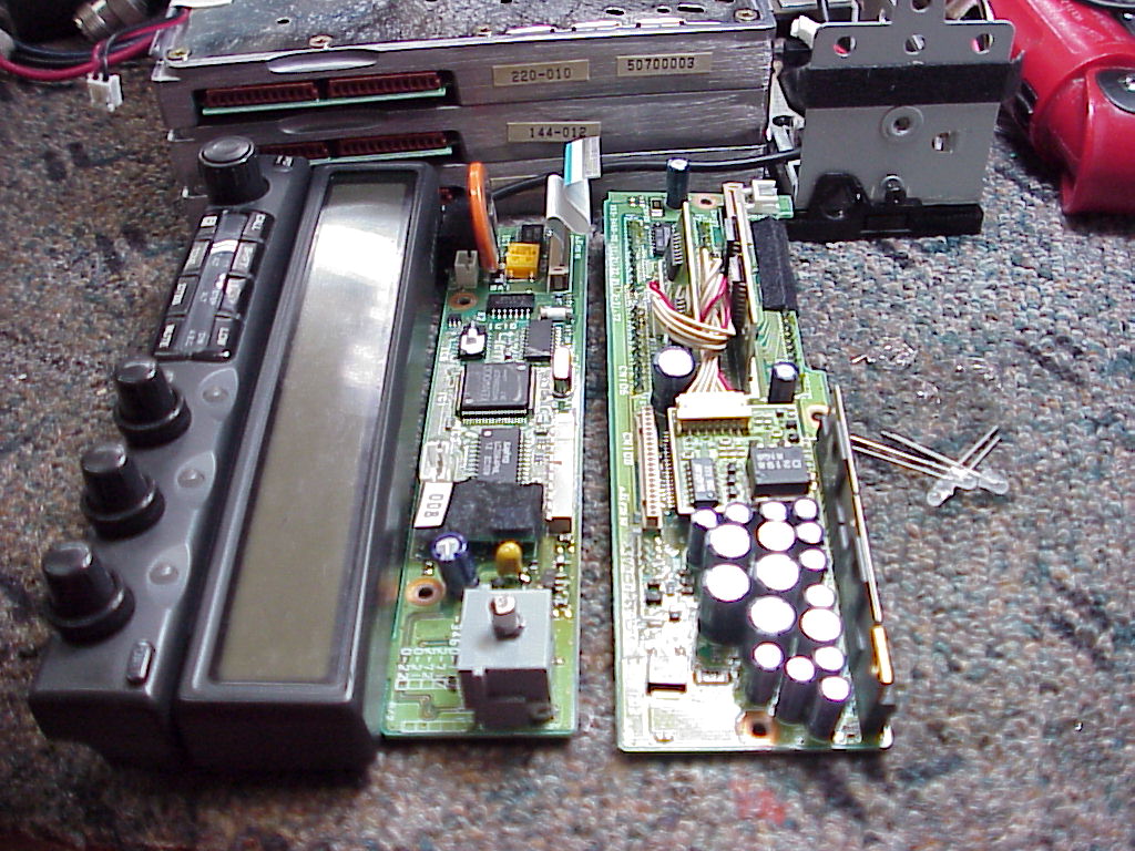

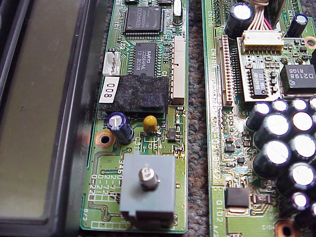

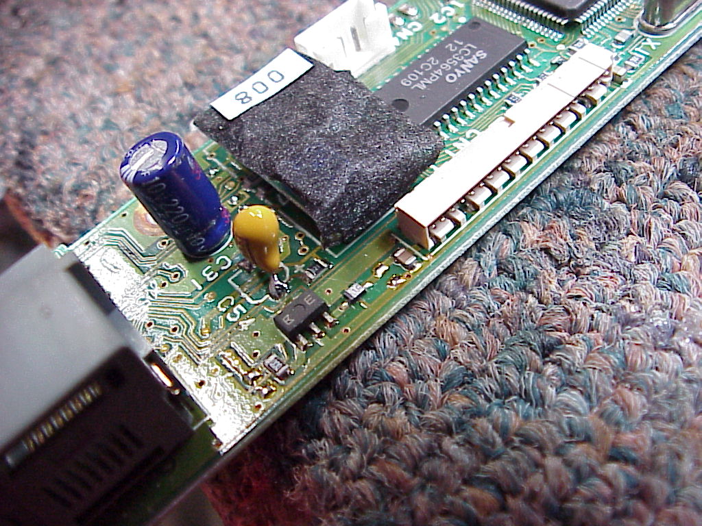

kenwood tm-742a tx lockup due to one bad cap
  • kc8adu
    • Nov 2003
    • 8832
    • U.S.A!
    the only sm lytic in the rig and its bad.its c54.i had replaced with a tantalum before taking the pic.
    rig would power on and get hot.
    it was coming on in tx with no mic attached.
    had burned out display lights so i replaced with white led's.
