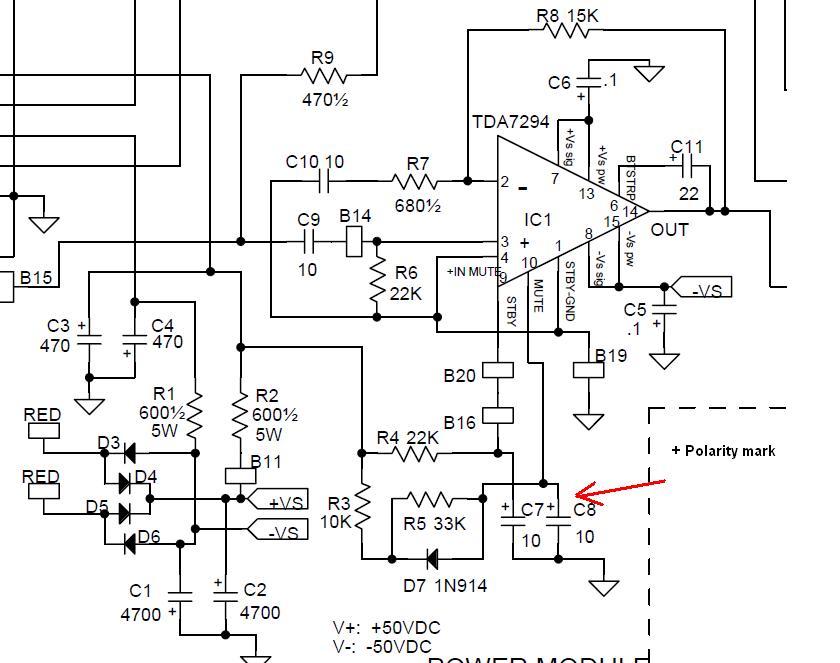

    I have a Carvin AG100 Acoustic Guitar amp bought new 1997 ish. so yeah around 22 yrs old now. It's been a great Amp but best I can tell so far is the Power Transistor blew and I have a new replacement. I am considering replacing all the Caps just on the Power Board for now. The Caps are testing good except one is half it's rated value, so that one for sure. No leakers, all look good.
    But here's question #1 for now. I have one Cap that does NOT match what is on the schematic, Should I replace it with what is actually there or follow the Schematic? It's been working this way for 22 yrs...:-)
    Schematic calls out C10 = 10uf 63v Electrolytic Cap what is actually installed at C10 is 104K 100v Film Cap. There are multiples of both on this board but all are in the correct locations.
    This circuit board has not only printed C10 there is a printed Round Circle where to install it as is with the other Electro Caps. The other 104K Cap locations are printed as a Rectangle same size as the 104K, I assume to help make it a no brainer installation.
    This board happens to be Rev A, I also found three later very similar version schematics that all show C10 to be 10uf 63v. After that there is a whole new board with different components. Sure doesn't appear that Rev A was a typo.
    C10 104K also tests as good. What to do.....

    I just looked at the schematic (revA) and it shows C10 as 10, same as C9 Not an electrolytic. C7 and C8 are listed as 10 but are identified as elcectrolytic. I would leave the original in place.

      C10 says 10 and is a 10uf 63V Electrolytic with a printed Circle, C9 also says 10 but that is where the 104K Film is and there is a printed Circle
      Also, if you look at C6 = .1 that is a decimal, and that is the same as 104K , right? That is what is there, same as what is in C9 So this is how they were showing 104K
      Yes C7 & C8 are listed as 10 and are, but how or what are you seeing that tells you they are Electrolytic or what do you see that says C9 is NOT an Electrolytic?

        I was looking at the polarity symbol. 104 = 0.1µf

          I will assume you see the + signs on the Schematic and none for C9 or C10. Is that why you say Not Elcectrolutic? I even looked at the next Rev and no + signs there either. I then looked on the board itself and both C9 & C10 have a + with the circle printed.
          I also just put 2and 2 together and realized it's C10 with the low value. should be 10uF and it's 5464nF ESR 2.7 ohm V-loss 2.9v. It's also right in front of the Power Transistor, wonder if that is why it went boom.
          FYI - symptoms of the sudden failure. I normally play with Headsets no amp speaker, Acoustic Guitar , mic in Ch2 and I had just started plugging my Tablet in Ch 3 ( drum loop, maybe 6 times ). All was well as I had been playing for a little while no drum loop and I had just plugged the Tablet, hit play and nothing. I then strummed the guitar and nothing. THEN I unplugged the headset so main speaker, amp barely at #1 and the HUM was so load the windows were vibrating. I shut it down as fast as I could.
          Shame that Carvin Audio divn shut down last year. Before it would be send them just the Amp section with $ 200 and they would fix or replace. Oh well.
          There is another small Circuit board where the Headset and FX loop jack are. This is the only place I found visual damage. I would have to look up the Resistor number it's right at the Headset Jack and it was fried. I looked up the Resistance, replaced it and watched it smoke and fry itself when I turned on the AMP so... right now I am blaming the TDA7294 Amplifier, I have a new one but not installed just yet.
            Re: Cap differs from Schematic Carvin AG 100
            Cp is the audio signal coupling cap feeding the non-invert input of power amp IC, if the capacitance goes down in value, you will lose low frequency response. C10 should also be bi-polar, it is for negative feedback, you also lose low frequency response if the capacitance goes down in value
            Since the output of the Op amp that drive the power amp IC has +/- output swing, then it good to use non-polar cap for that C9 coupling cap.
